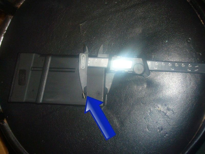

Making the Thermold FAL metric magazine fit the SCAR 17
New thermold FAl metric magazine unaltered

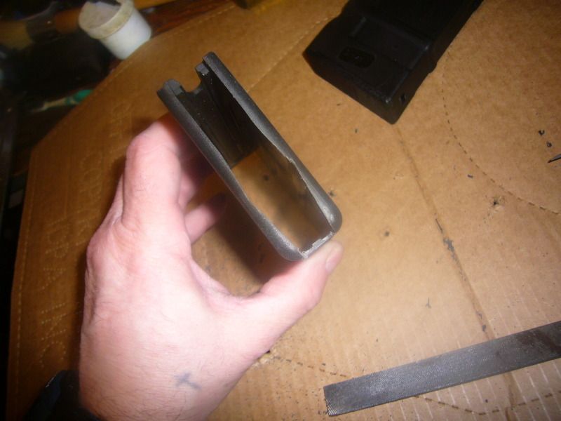

Remove the tabs on the front with a file, make them flush with the body
File the feed lips straight as shown

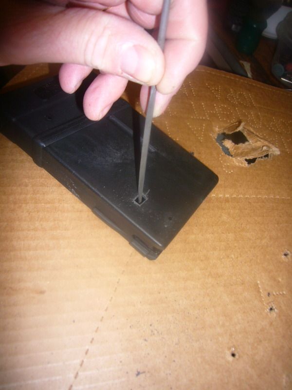

Make a hole in the side of the magazine, I use a dremel
Start cutting the hole with an exactor knife to 90%, (caution) as you start getting it close to done check it frequently in your lower, the top of the hole is the most important, if you go to high it will not hold the bolt open on the last round
Use a needle file for finishing
That’s it you now have a SCAR 17 Mag
