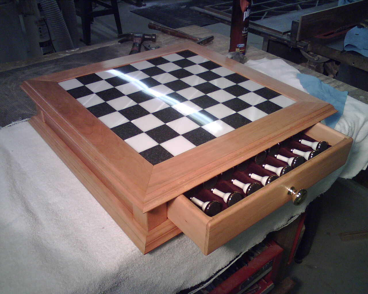

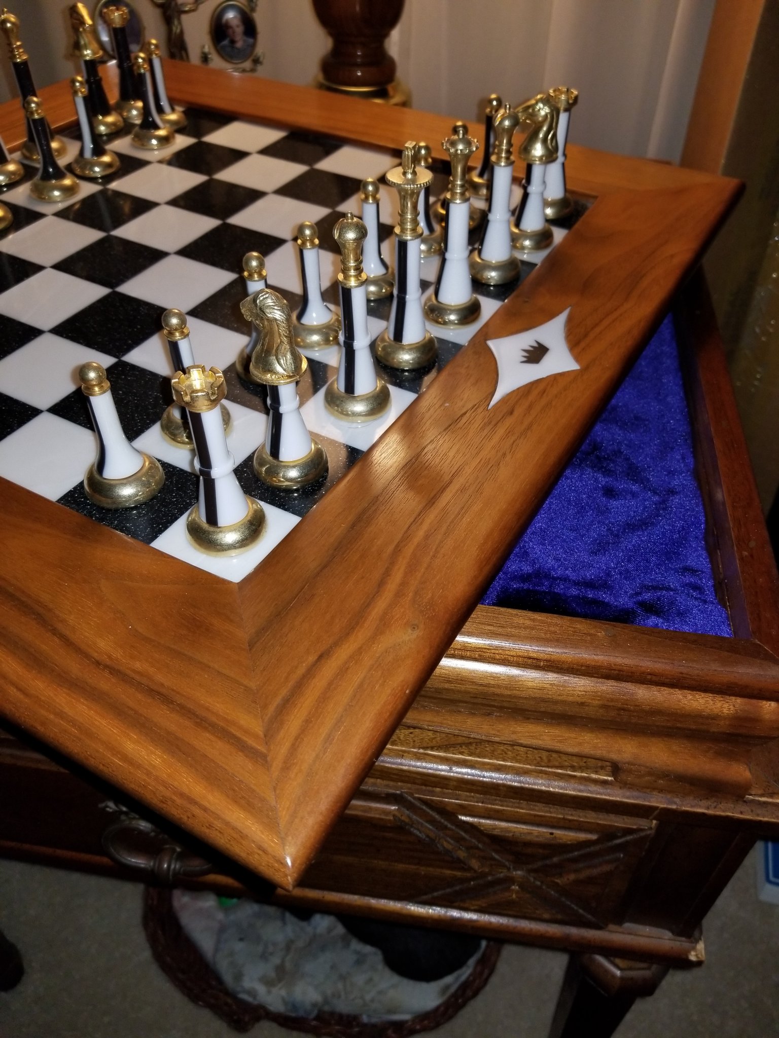

I made my own chess set a few years ago. Here’s a shitty video of a pawn in the process of being created.
O00792(PAWN)
(G54 STOP)
N5 G54 T0404
N10 G00 X0.63 Z0.01
N15 M00
N20 G00 Z5.
N25 G28 U0
(ROUGH)
N30 G54 T1010
N35 G50 S1500
N40 G97 S500
N45 G96 S600 M03
N50 G00 X1.1 Z0.1 M08
N55 G01 Z0. F0.006
N60 X-0.06
N65 G00 Z0.1
N70 X1.1
N75 G71 P80 Q140 U0.03 W0.005 D0.05 F0.010
N80 G00 X0. Z0.1
N85 G42 G01 Z0.
N86 G03 X0.394 Z-0.552 R0.276
N90 G01 Z-0.788
N95 X0.788 Z-0.985
N100 Z-1.064
N105 X0.708 Z-1.142
N110 X0.788 Z-1.220
N115 Z-1.424
N120 X1.05
N140 G40 X1.1
N145 G97 S500
N150 G00 Z5. M09
N151 M05
N155 G28 U0
N160 M01
(FINISH)
N165 G54 T1010
N170 G50 S2500
N175 G97 S500
N180 G96 S750 M03
N185 G00 X1.1 Z0.1 M08
N190 G70 P80 Q140 F0.006
N195 G00 X1.1
N200 G97 S500
N205 G00 Z5. M09
N210 M05
N215 G28 U0
N220 M01
(GROOVING)
N225 G54 T404
N230 G50 S1000
N235 G96 S300 M03
N240 G00 X1.1
(PART OFF)
N245 Z-1.424 M08
N250 G01 X0.0625
N255 G00 X1.1
N260 G00 Z5. M09
N265 M05
N270 G28 U0
N275 M30
O00792(PAWN)
O00792(PAWN)

also how one creates pawns.
