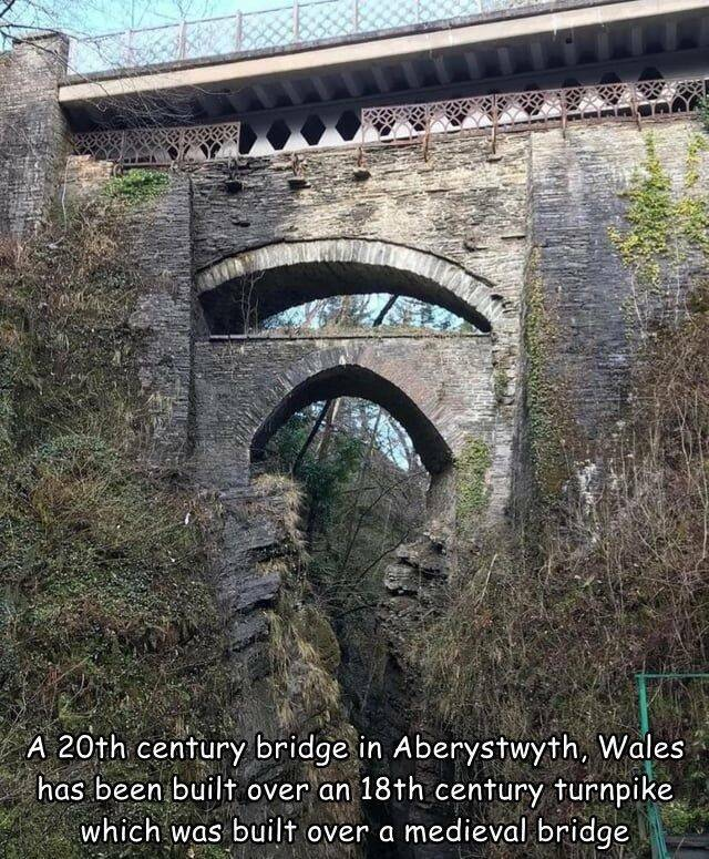

Which one did the gumpy troll live under? Perhaps three generations of trolls, one under each bridge.
On the way up was a bridge over a cascading stream they had to cross, and under the bridge lived a grumpy troll, with eyes as big as saucers, and teeth as long as a billy goat's leg.
