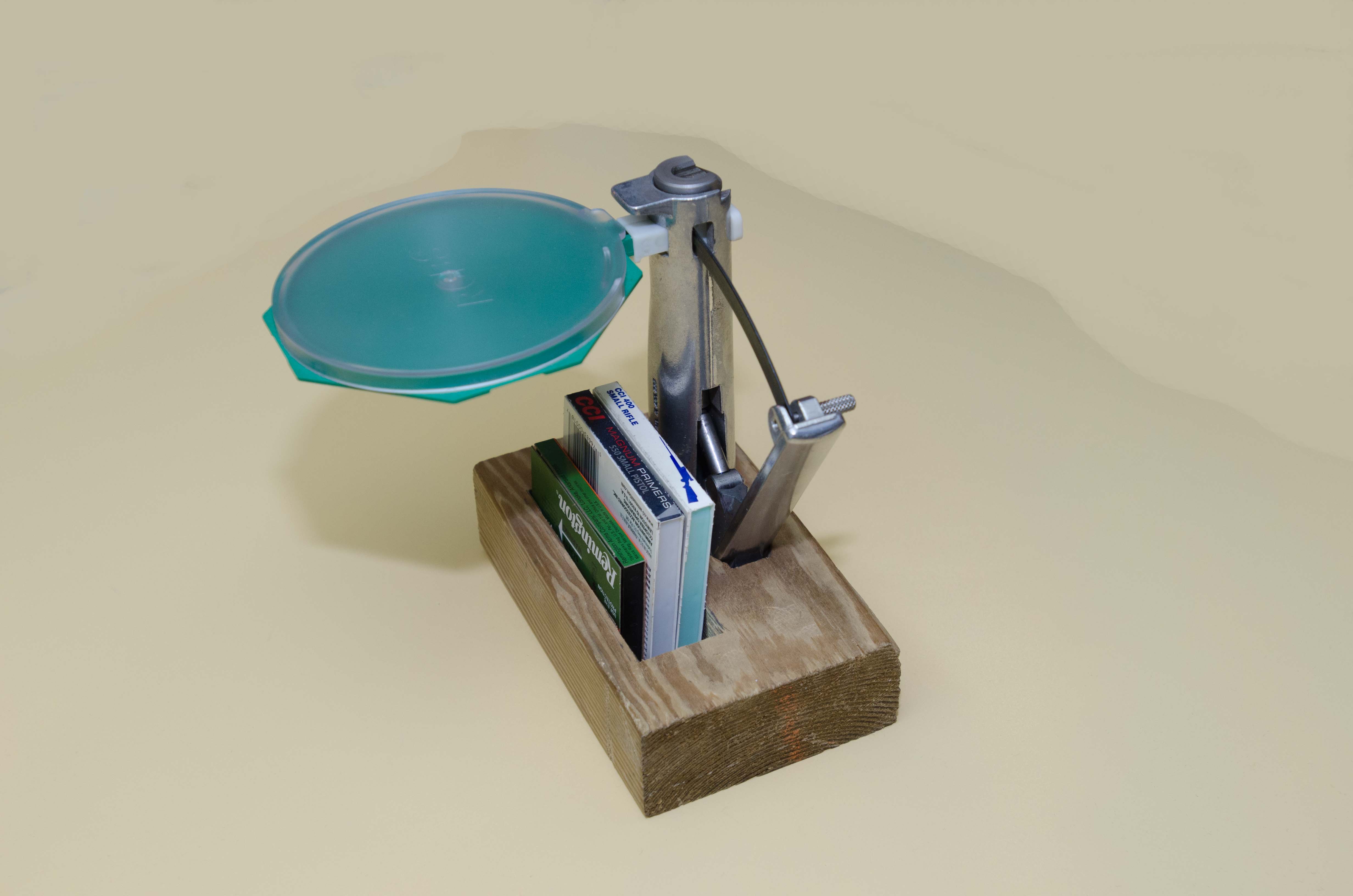

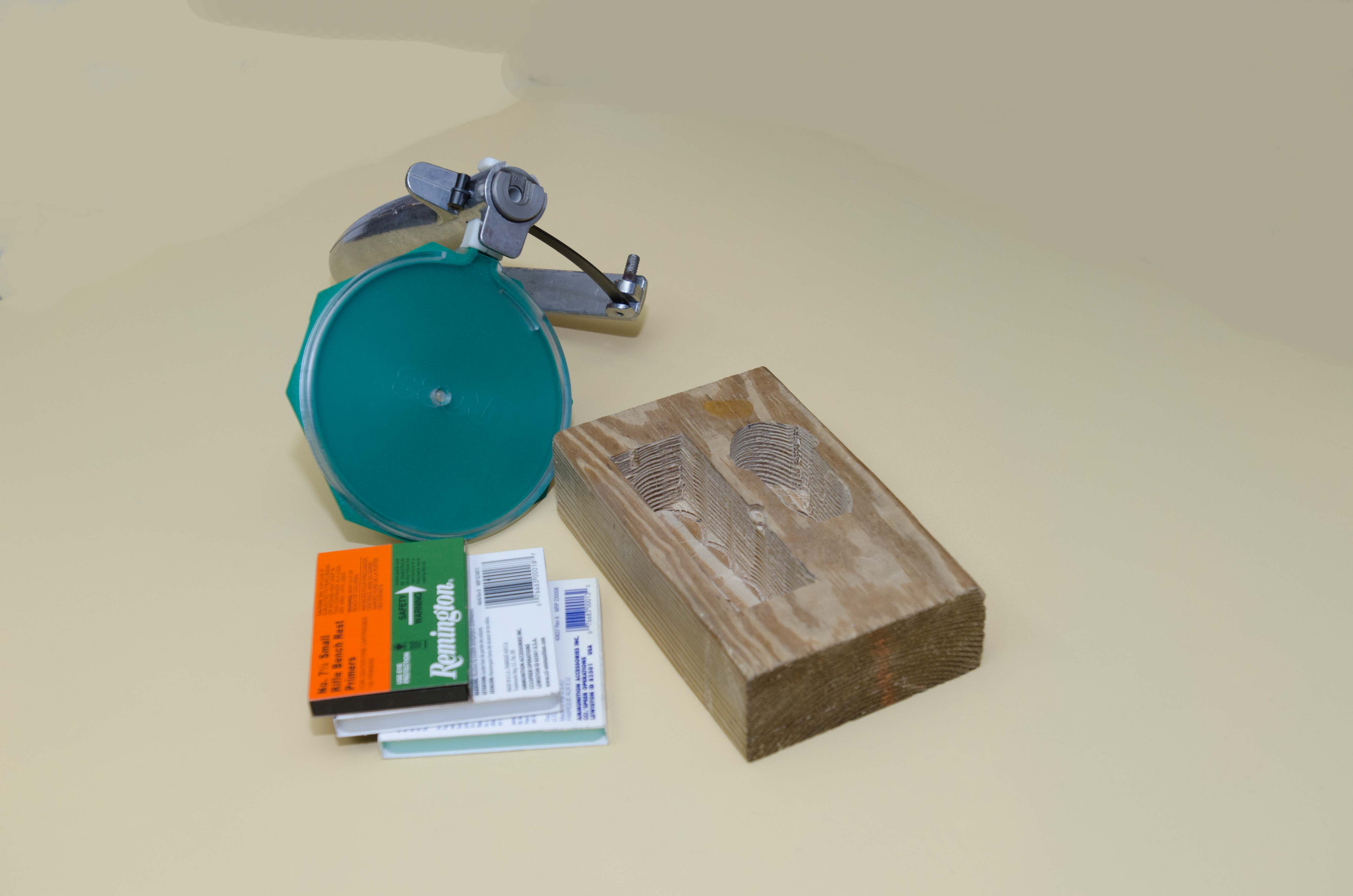

    For those of you who use tube fed tools and don't want to spring for a Dillon electric tube filler, here's an article on how to make a (relatively) rapid tube filler using the tray from a Lee hand primer. Primer tube filler for about $10 - non-Dillon Reloading Equipment - Brian Enos's Forums... Maku mozo!
