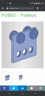

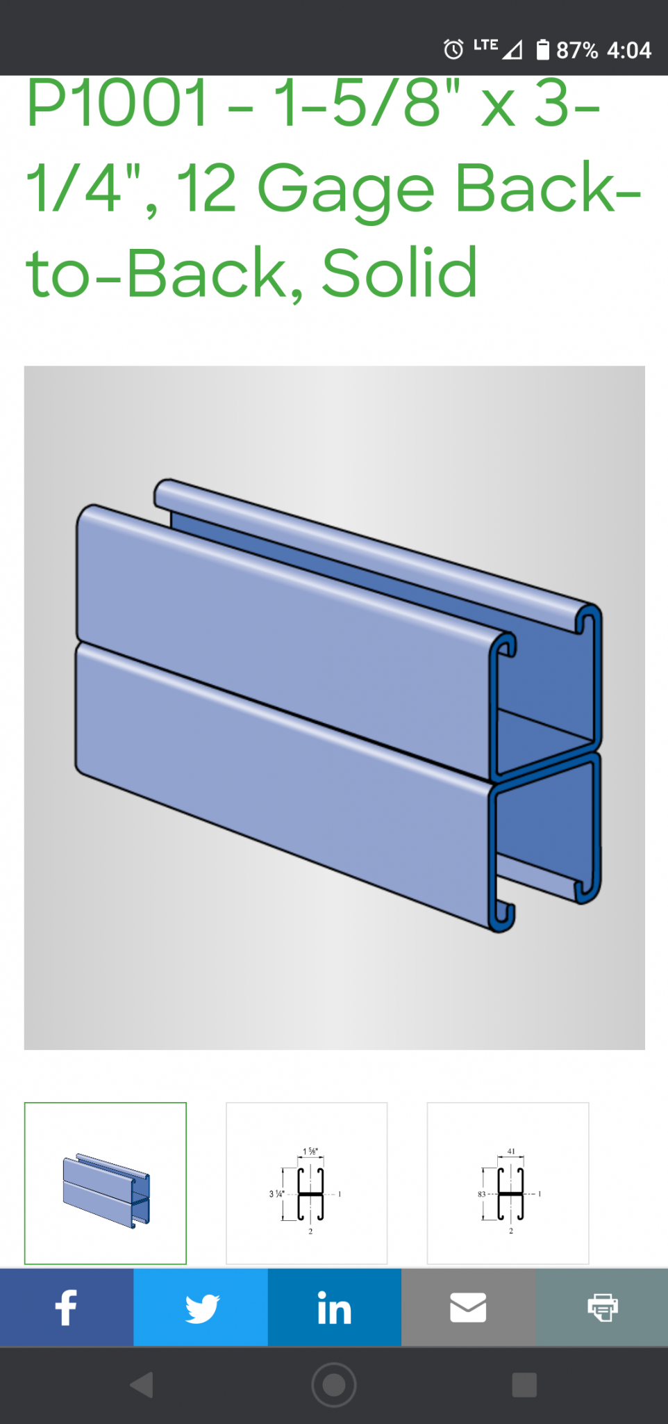

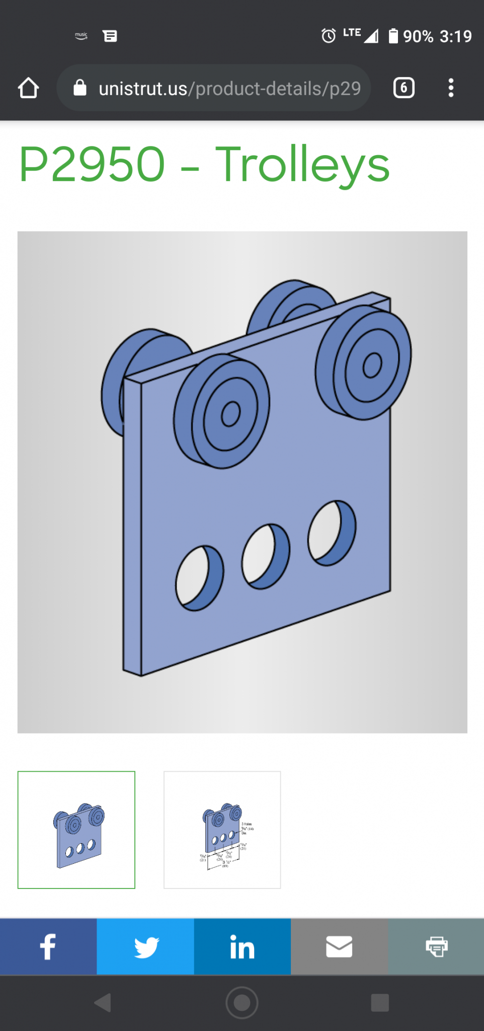

We're working on one for the .22 bay, 20' double strut to run the chain, with a trolley in the bottom side to hang a plate and roller on the dead end. Keeping that one 120v and we'll adjust speed with gearing. 1200w generator hides behind a 1/2" ar500 plate.

Strut and trolley

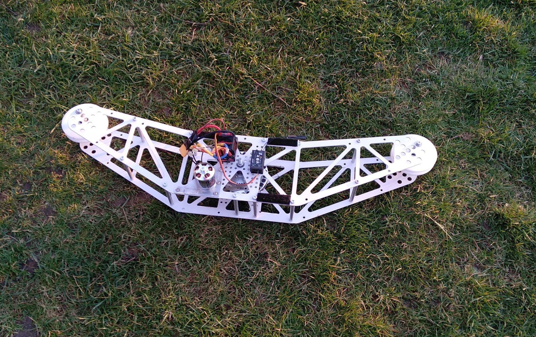

Never built a mover, but had a friend that could build pretty much anything I could think of including a runner. It could be used in any direction on the compass. Could even set up with a plate behind the target that knocked it over with an A zone hit, I will give you tips I learned from him...feel free to ignore.
- Depending on terrain, the rails need to be off the ground...or keep a broom handy
- Use bearings rather than bushings if possible
- Keep the vehicle as light as possible
- Have a braking method...keeps the target from ripping through the staples
- Don't let rookies shoot "at it"
This guy built a drop turner with two presentations. Each presentation activated another mover. Both of those movers could activate another
Shooting five movers not inline is...character building.
