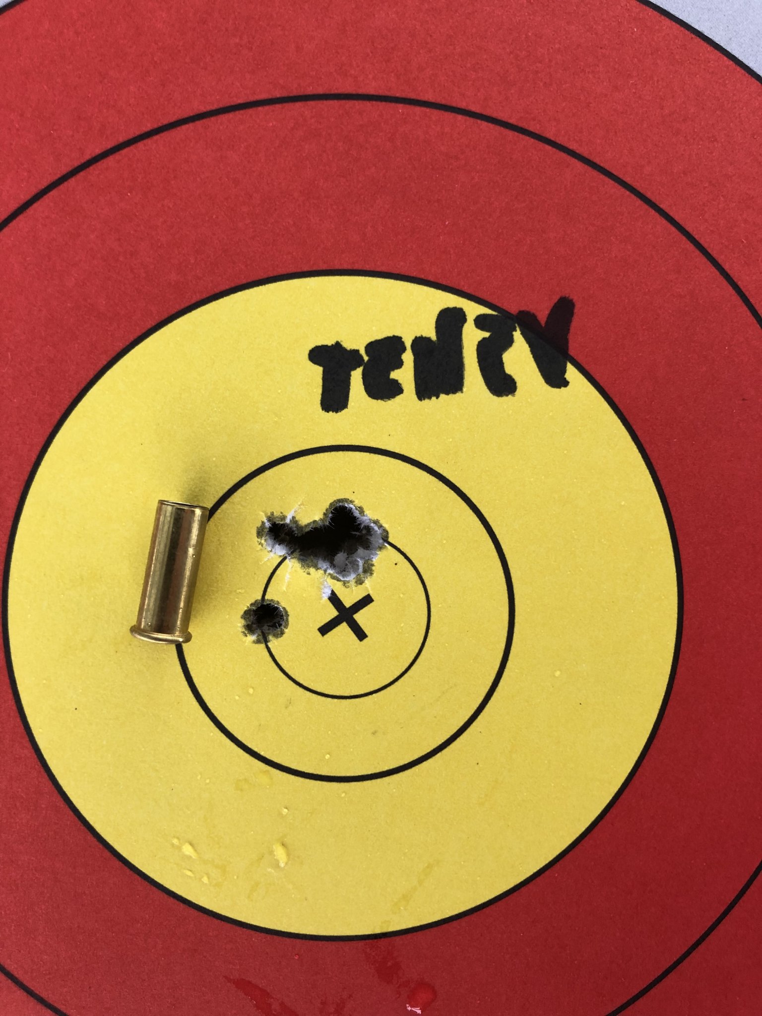

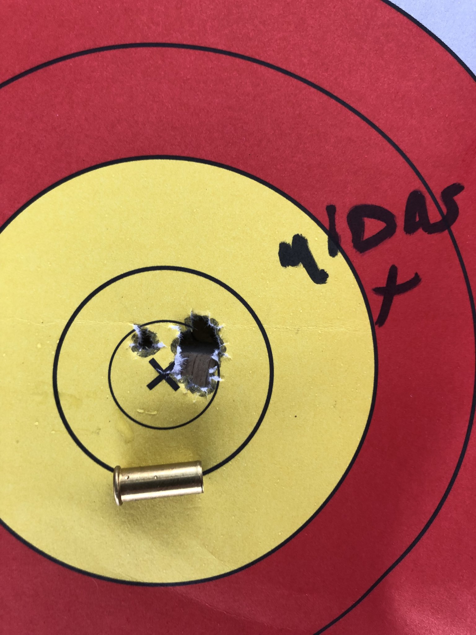

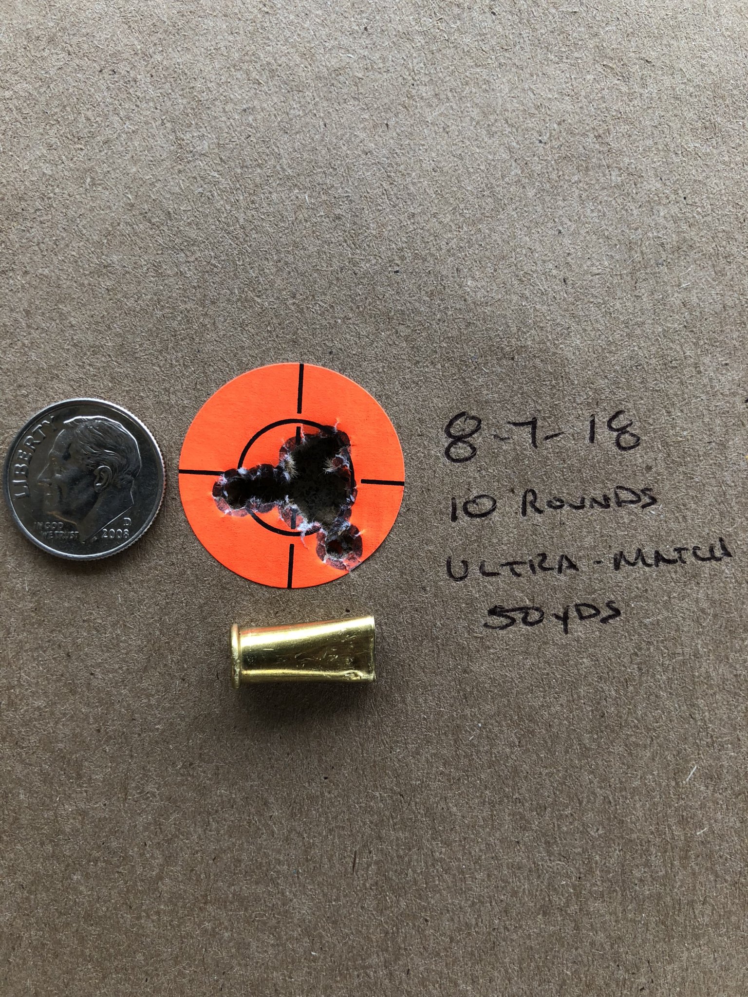

I’ve been running the MPA 22BA since late last summer and have been happy with it. I primarily shoot Federal Ultra Match, but have tested Lapua Midas +, Eley Tennex and several others, but the Federal Ultra Match has been the best thus far. Unless it’s really cold (below zero temps) then I might as well throw rocks at the target.
