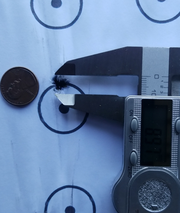

    Thought I'd add my 2 cents here. Bought an MPA BA22 and have been able to put about 1200-1500 rounds through it. My best group so far has been .35" edge to edge with Federal GM target (711B). On the other hand, my worst groups have been a cause of frustration. That being said, I am a relative novice to precision shooting, and still trying to find that perfect barrel/ammo/position match. I have NOT been able to repeat that group, and im trying various positions to try and increase accuracy (sandbag vs bipod, table vs prone, sling vs no sling, etc). Anyhow, 18" barrel, screws secure it in, and are set at an inward angle. I'd be happy to answer your questions if I can. I tried to attach a pic, not sure if it took.
    Reactions: BlastersAreCool
    5 rounds, .35", edge to edge
    Thanks David T! what would you say you are seeing on average out of it? UNLESS you are having consistency issues with the groups then explain that more. (i.e; group starts out looking good but the nave "x" fliers every other group, etc)
    So here is another pic. Most here will probably know the circles are an inch, the dots a bit less than a 1/4". I wont say this is typical, but pretty close. On the third row, I adjusted my scope. All are 50 yard shots, 5 round groups with Fed GM Target, same as the pic above. My cold shot was aimed at the upper left circle. If i remember right, all these were off an Atlas bipod with a sling and on a bench. No wind. Like i said, im still learning, but when the trigger was squeezed, my reticle was centered.
    David, it appears a random collection of scatter-groups, vertical groups , “3 and 2” groups. General thoughts: 1) your rifle may dislike Federal 2) something could be loose 3) cleaning regimen could need a change 4) could be a quirk in your delivery 5) perhaps a lemon. You might clean it spotless paying particular attention to the throat, try some CCI SV/ SK standard plus/ Tac-22, adopt a bipod and rear bag no sling setup or try bare rifle on sandbags off the bench, try a different scope, have a buddy video you. This should narrow the search. Seymour
    I'd say definitely try some different ammo and season the barrel after switching brands. My CZ with a Fedderson barrel hates Federal. It shoots in the avg .4's with SK and in the .3's consistently with Center X. It hates Eley, even Tenex, averaging in the upper .5's. The Federal GM that I used was like a shotgun pattern.
