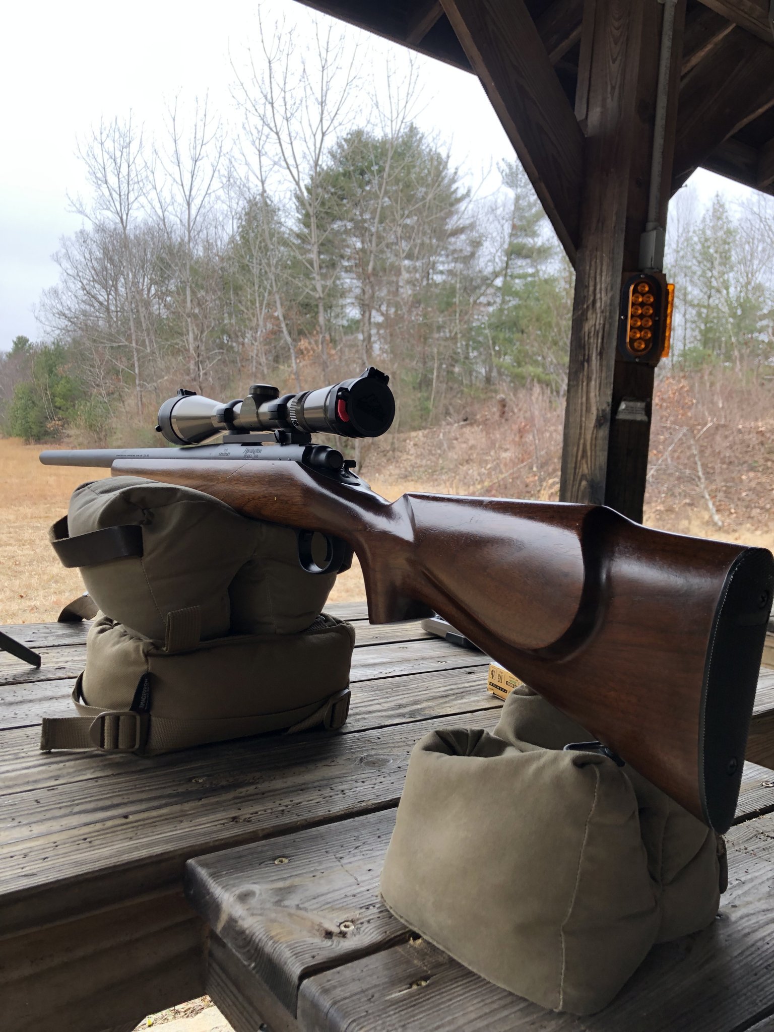

Beautiful rifle. Who made the stock?
Guy on Ebay look up Beever and Remington 700 stocks.
It was the first part of the build and the cheapest part I bought at $150.00

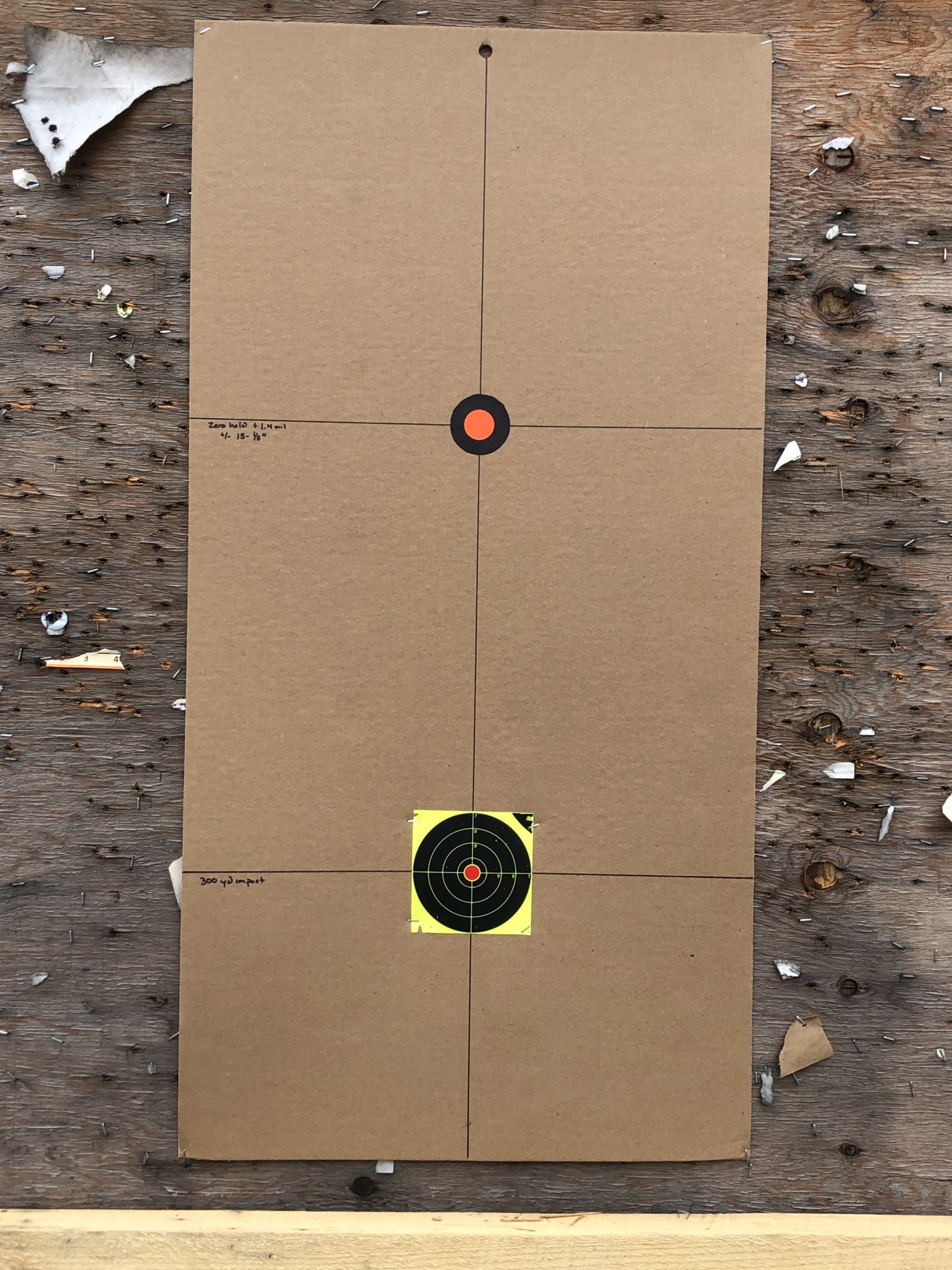

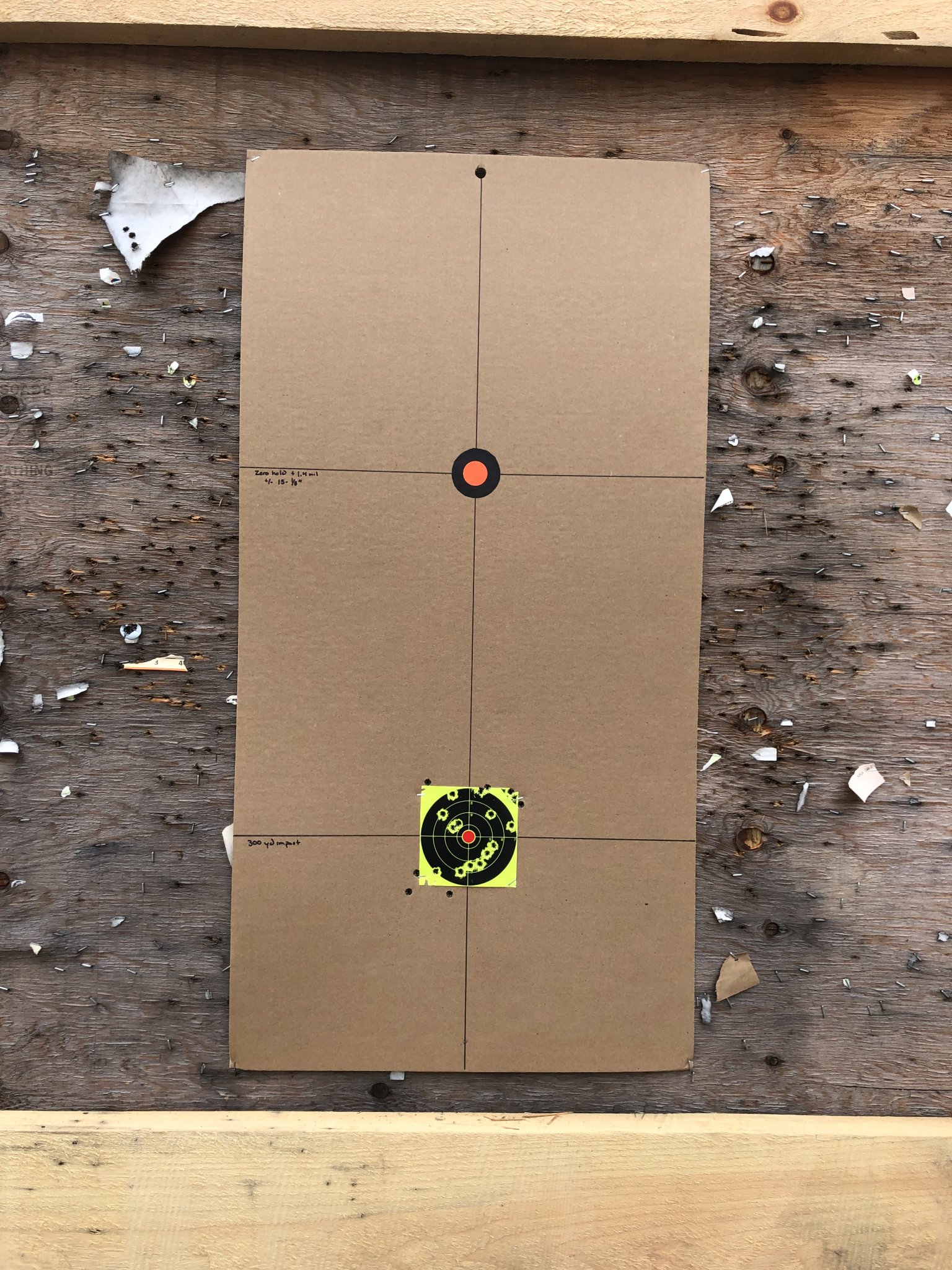

First shots were falling low.

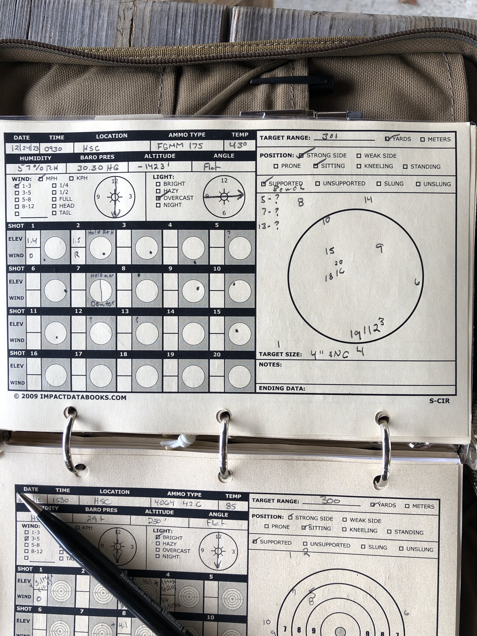

I had to go 1.6E/.1R and started grouping. @Nik H will say that is way too much E for 175FGMM and I agree. I will have to check my 100 yard zero.

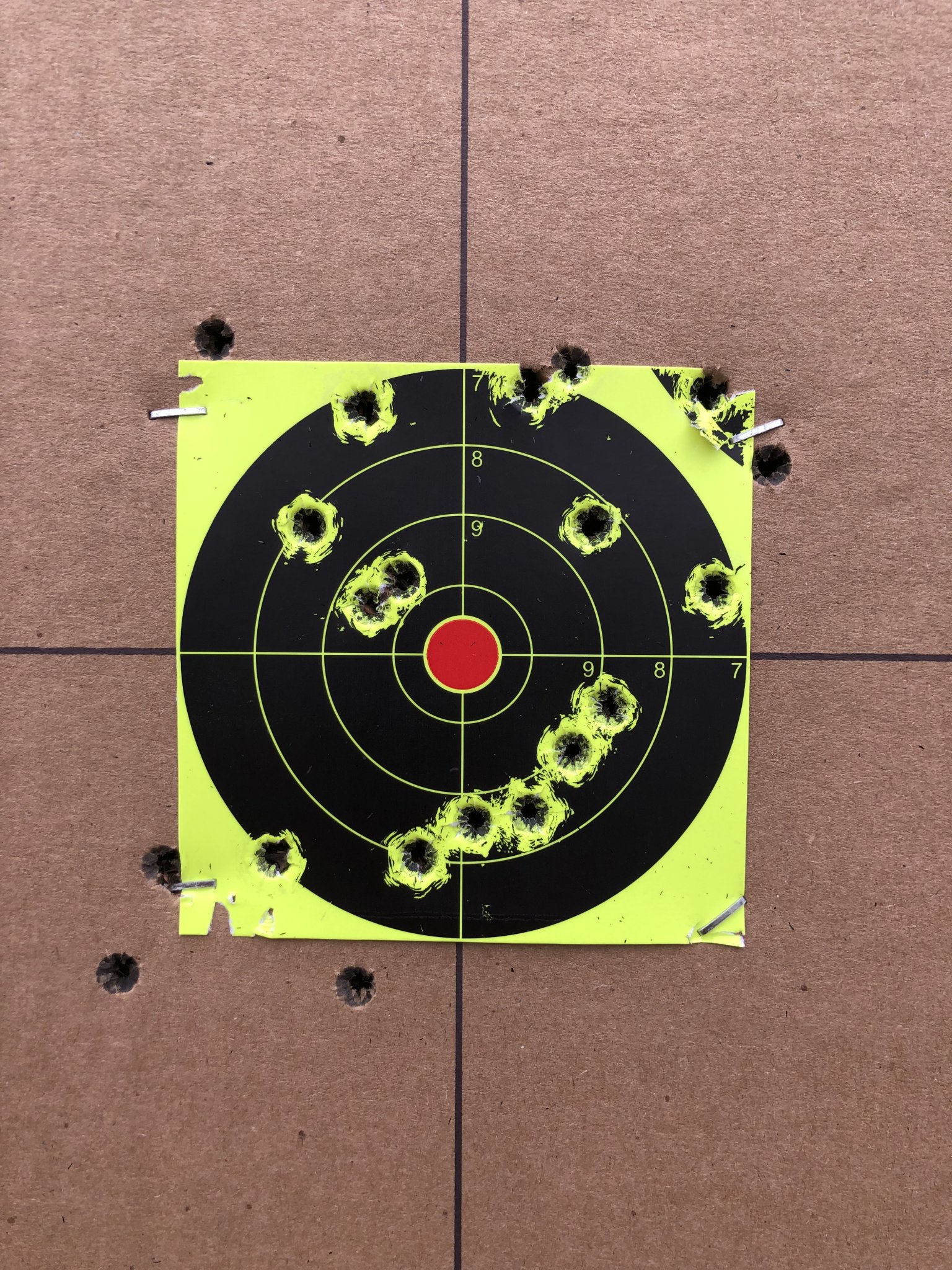

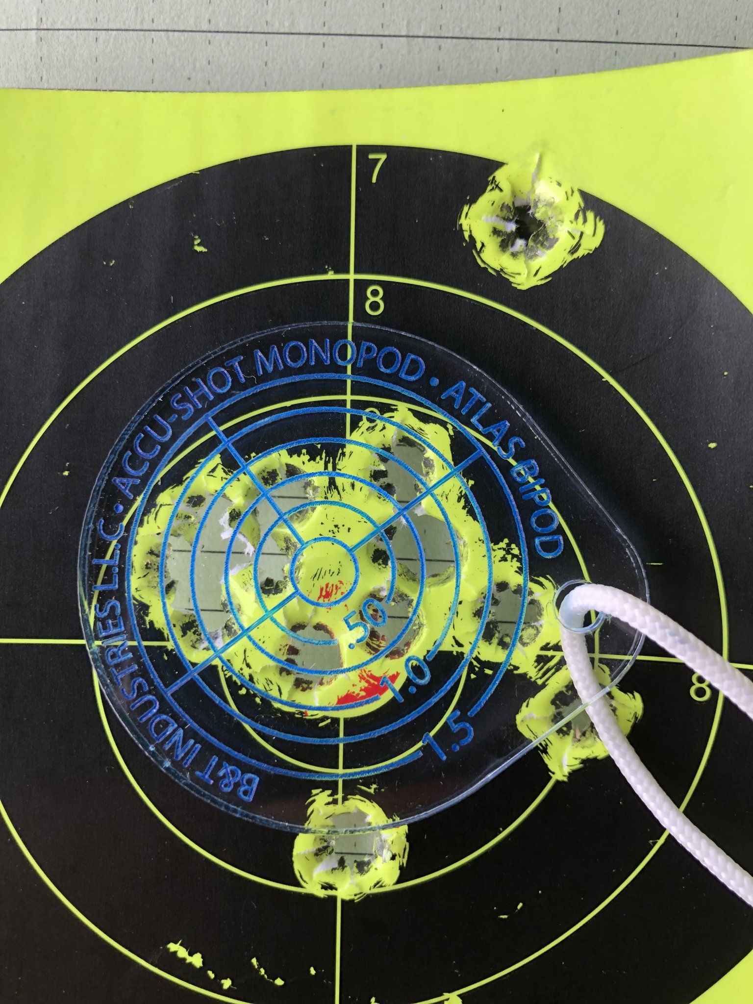

12 shots are within a 1.5 inch ring….
2495 with 175 FGMM and about 40 rds on the barrel.Something is up for sure....earlier your Kestrel showed 1.58 mils. What MV are you using?
I should have tried new variables slowly, one at a time but I decided to jump in the deep end.Look at you, rocking a gain twist bbl!
I use 2625 for an MV but it is estimated just based on true DOPE2495 with 175 FGMM and about 40 rds on the barrel.
Things may have “settled” in after 200 rds but I’d be expecting less E need than more.

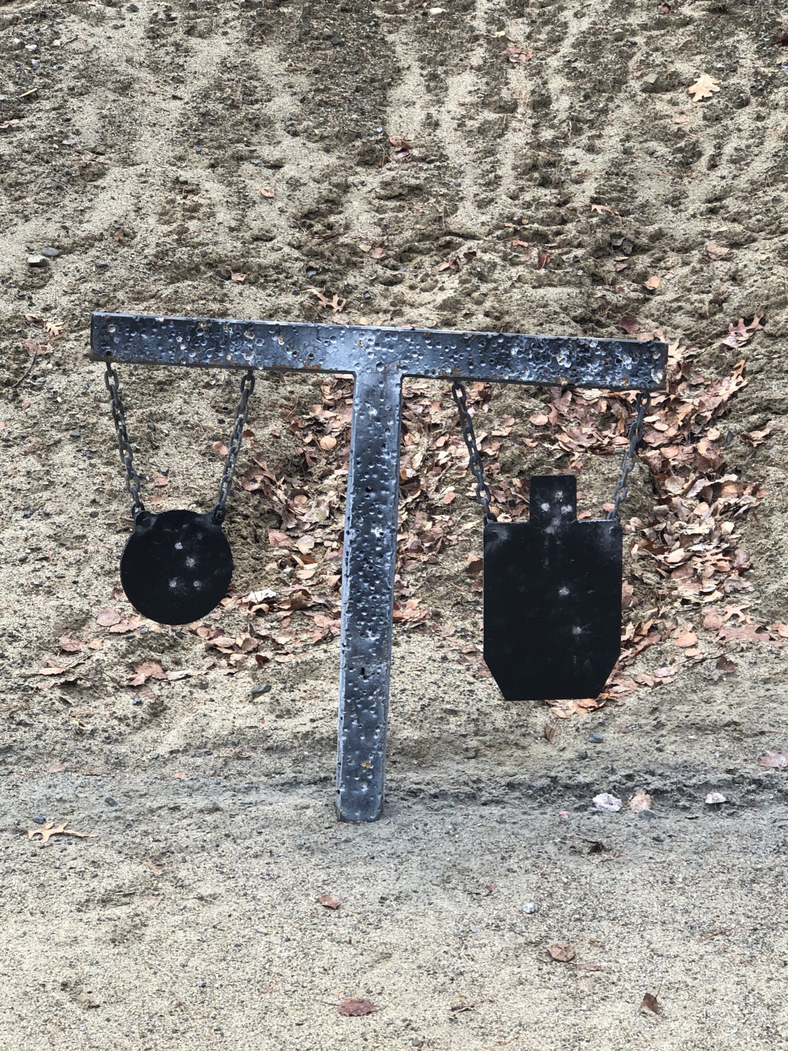

At 750 yards I was using 6.4E/.1L to bang steel.I use 2625 for an MV but it is estimated just based on true DOPE

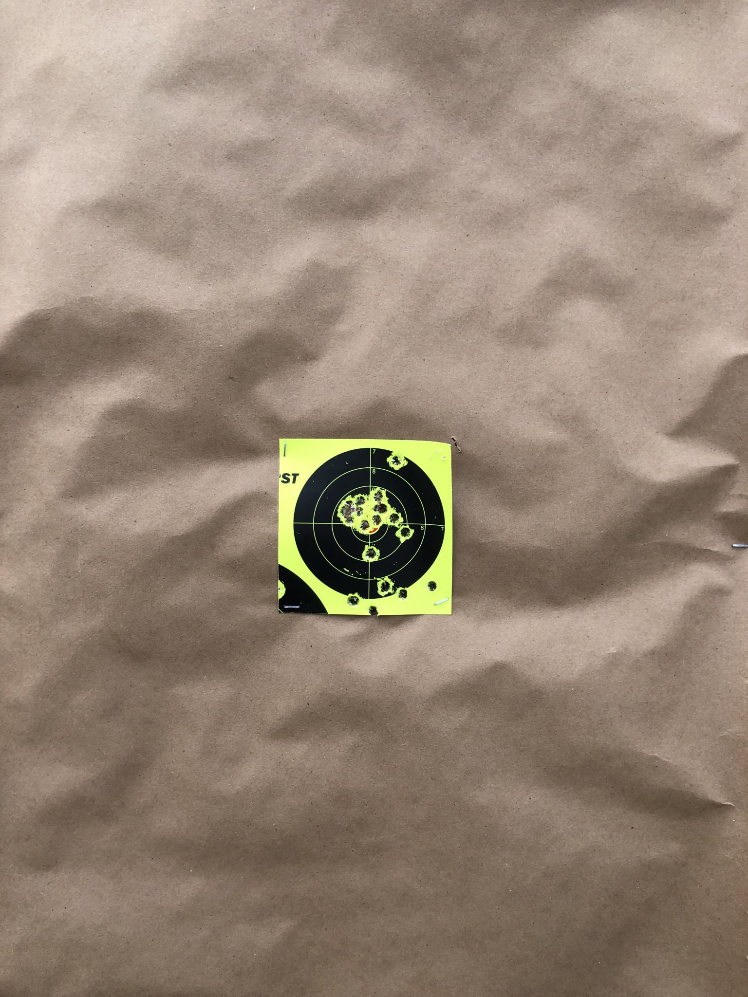

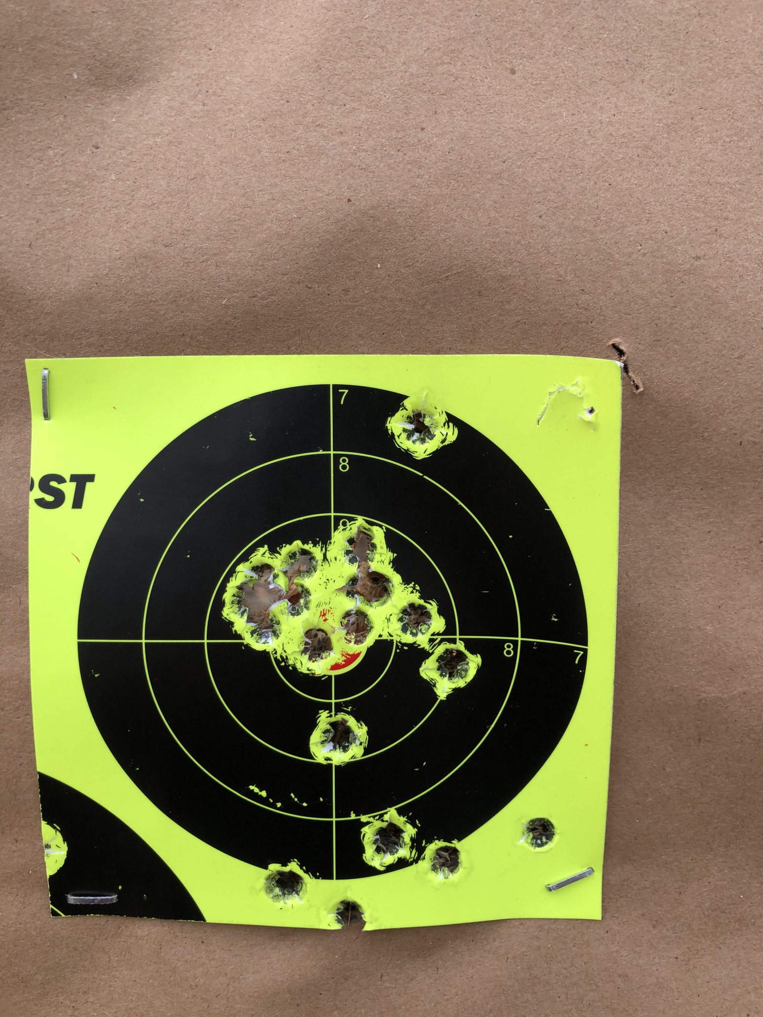

Looks like 13 hit within my 4 inch circle. I’ll take that for what I had to try and hold.
If I stick to these it would have been twenty for twenty.
