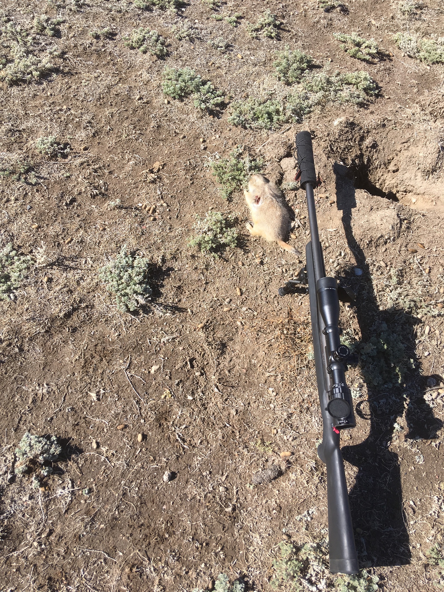

.223 is plenty. I have popped them at 650 with 55fmj-bt at 3000fps or so. I use my rem 700 Tac with 20” bull barrel and a suppressor. And a SWFA fixed 10x scope. Factory trigger, floppy hogue and factory barrel and action. I actually like the stock because it grips on my driver window and does not slide around like a hard/slick stock does. I love it.
When i burn out the barrel, I want a 22” AI heavy barrel. Maybe even a PROOF CF.

View attachment 6970677View attachment 6970679
I like a fairly dense pillow to drape over the window.
