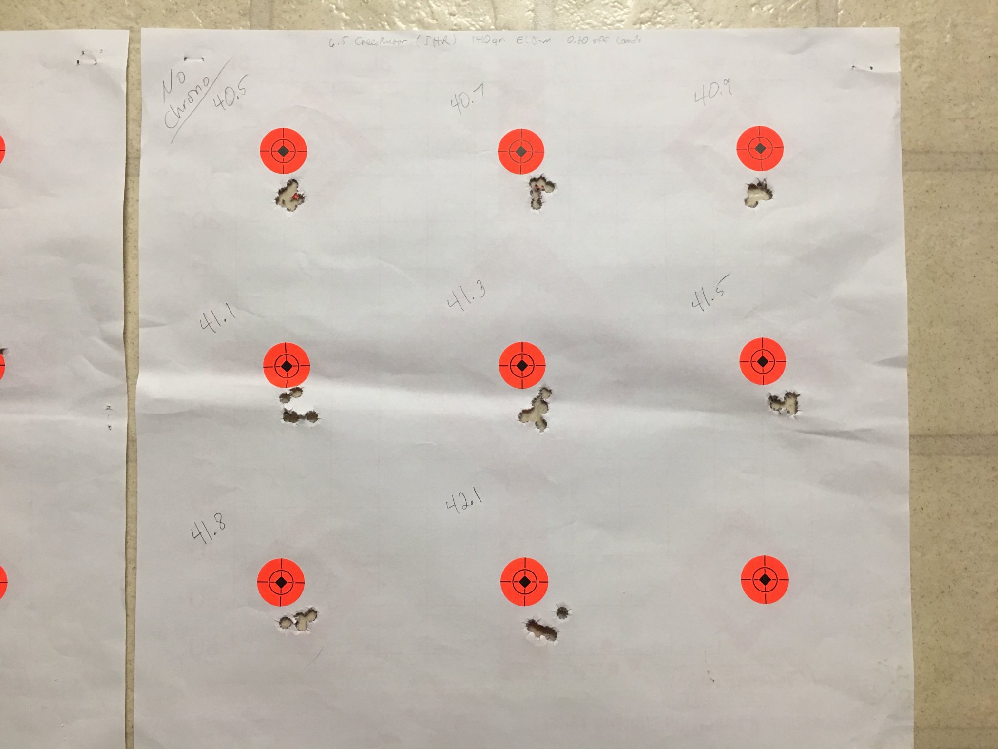

    The second set is the same loads, without the chronograph attached to the barrel.
    On the 42.1, I yanked the trigger. I knew it was going to be off before the bullet hit the paper.
    7084770
    I'm really liking the 40.9 gr., 41.5 gr. and the 42.1 gr. groups. But I'm really liking the 42.1 gr. numbers.

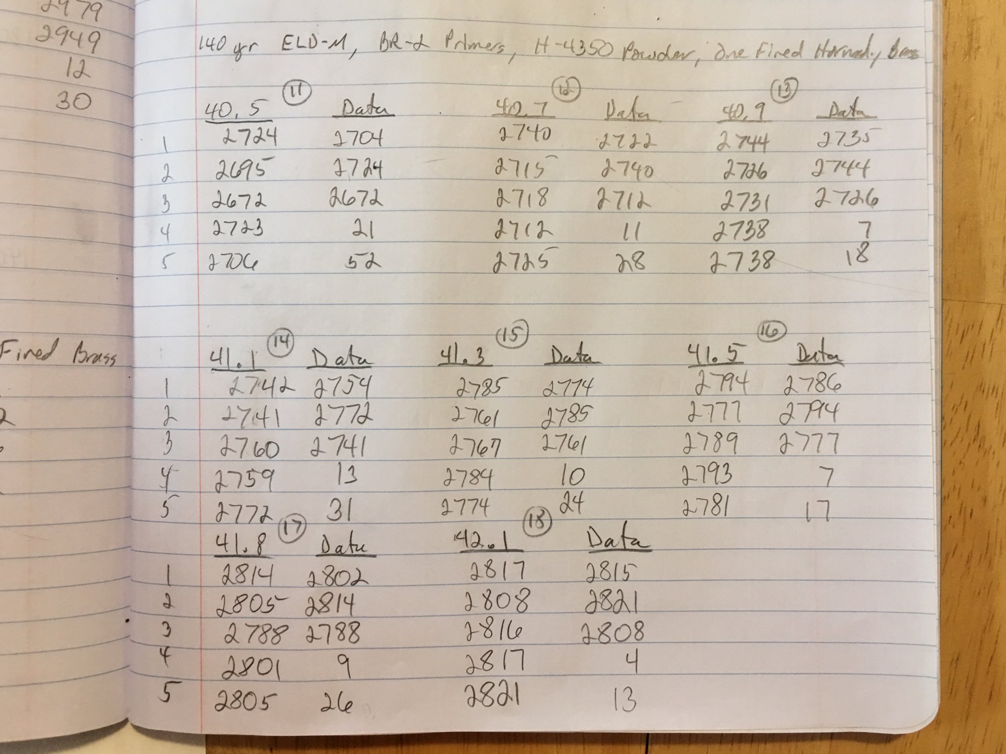

    The numbers: Two colums for each charge weight.
    First column are the velocities.
    Second column are the
    Average Vel.
    Max. Vel.
    Min. Vel.
    SD
    ES
    7084771
    Would you recommend I go with a higher load? I'm above the maximum load on some of these loads, according to Hodgdon's website, and Hornady's loading manual, but I'm below what I see some others online loading too.

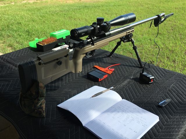

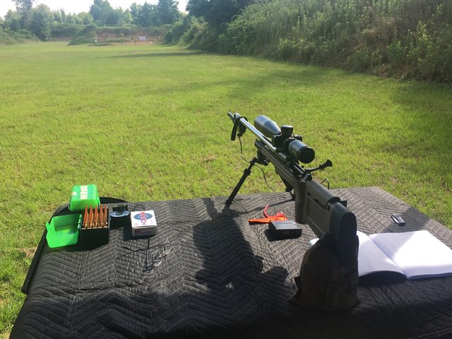

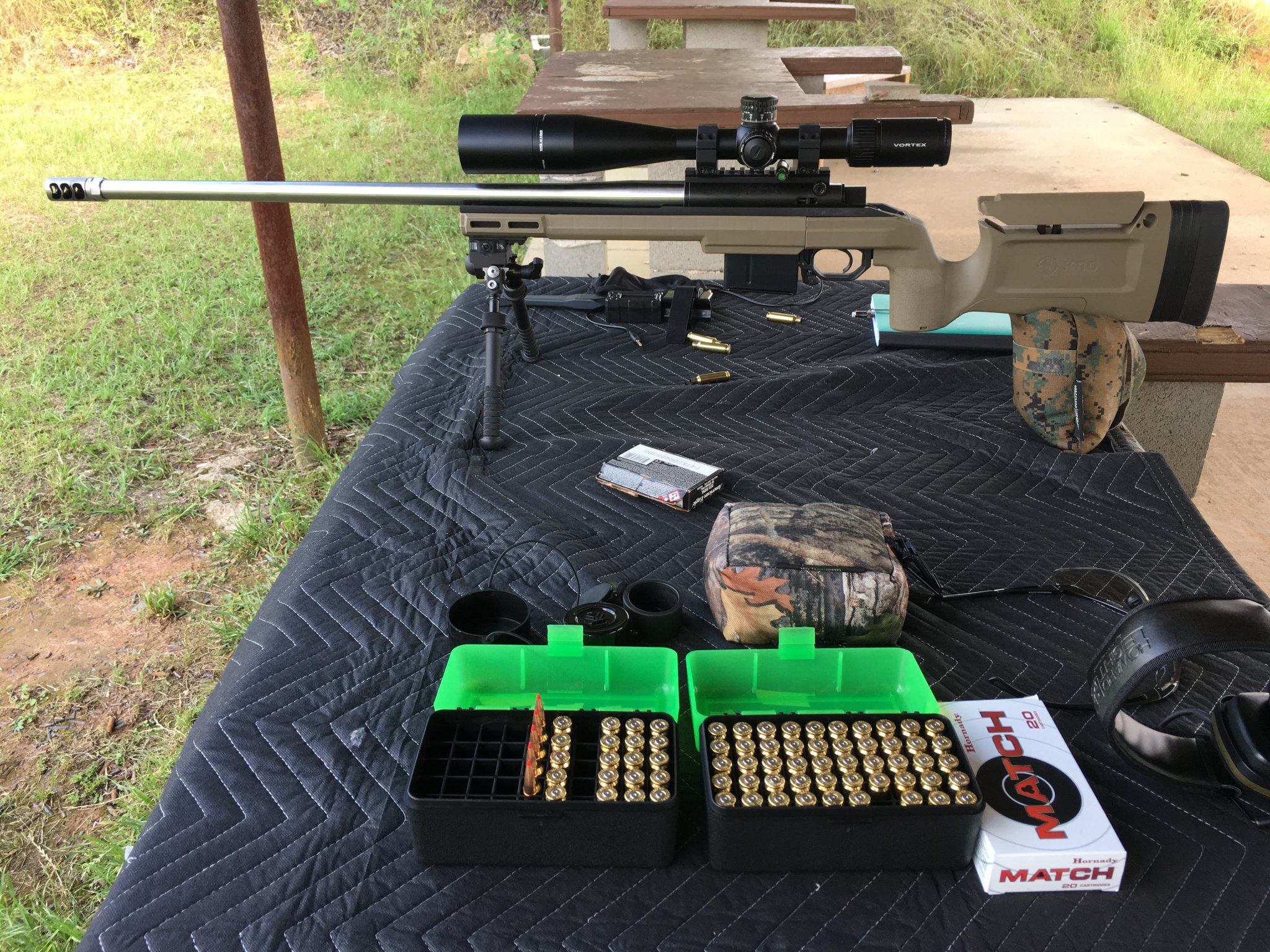

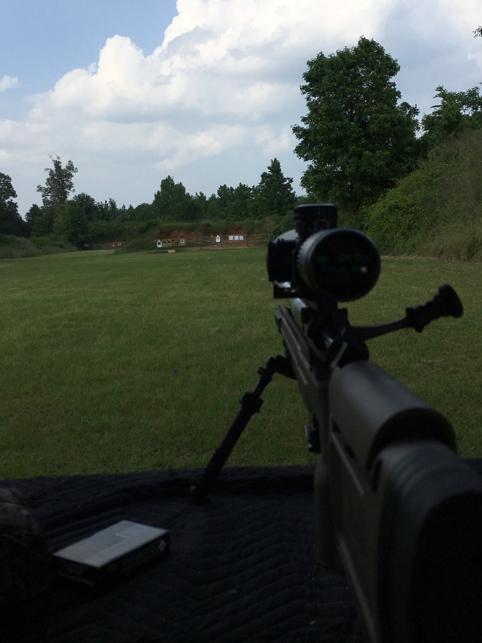

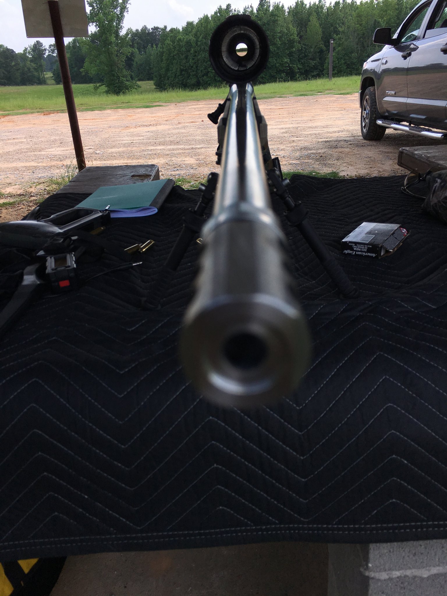

    And of course, the gratuitous range pics, and to say, I'm really liking this John Hancock.
    Any of you guys still waiting on your's, to arrive, hang in there, it's worth the wait.
    7084774
    7084788
    7084789
    7084790

    Sort of. It’s interesting to me how sometimes stuff looks good up close but then at 500 yards it turns into 8” groups.
    Every single group you shot at 100 is at least decent without a whole lot of the ocw shifting impact points to identify. Your rifle seems to shoot it all well. Makes it tough to differentiate for me. Taking it to 500 and letting gravity separate the wheat from the chaff will help me make a decision.
    I bet yours will stay good but it’s a nice boost of confidence to actually prove it to yourself.
    If you wanted to narrow down I would probably look into the 41.4-41.9 in .1 increments.
    Reactions: Srgt. Hulka
    Thanks for the feedback Spife, but I'm not quite sure I'm following you. Are you saying rerun the loads to make sure they are repeatable?
    No need to run the whole test.
    Just pick out some favorites from your test and run those at distance to make sure vertical stays nice.

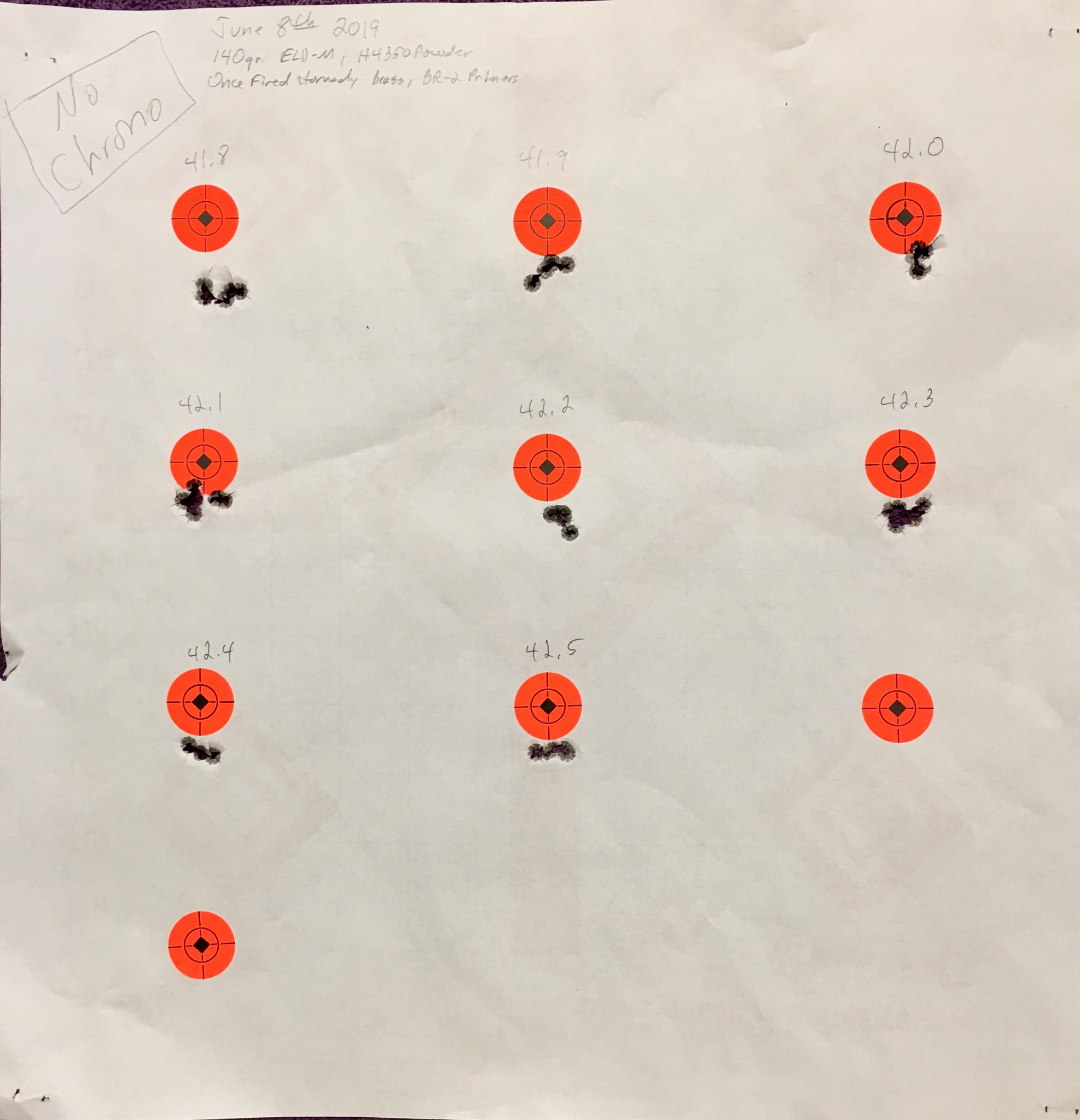

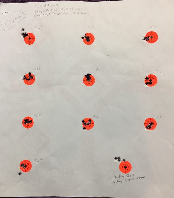

    Fine tuned my loads this week. Loaded up from 41.8 gr. to 42.7, in .1 grain increments.
    Made it out to the range to give them a go.
    Weather was nice today. It started out about 78 degrees and ended up about 85. Wind blowing from the north about 6 mph.
    After today, I have 245 rounds down the barrel. I didn't make it to the 400 and 500 yard steel today. That will definitely be next trip.

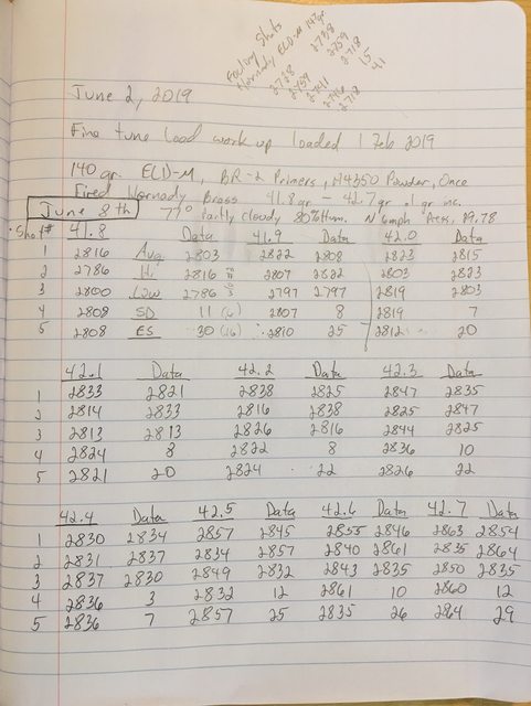

    Here are the results. Like before, each group is a 5-shot group.
    The numbers: Two columns for each charge weight.
    Average Vel.
    Max. Vel.
    Min. Vel.
    SD
    ES
    7101838
    Groups with the Magnetospeed attached:
    7101839
    Groups without the Magnetospeed:
    7101842

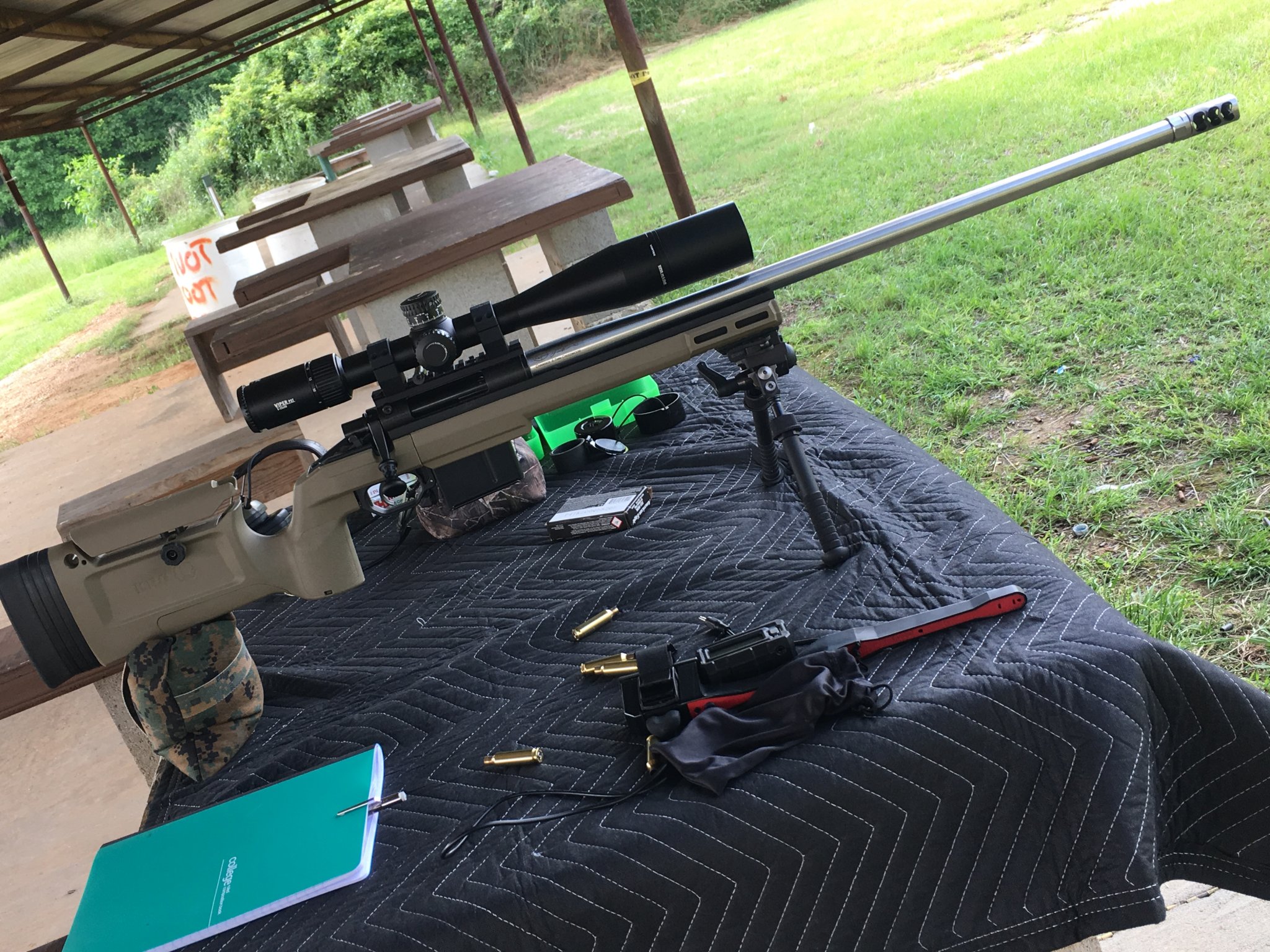

    And as last time, the gratuitous range pics:
    7101843
    7101844
    Like I said in my OP, if you're still waiting on your JHR, hang in there, it's worth the wait. This rifle is just getting better and better.
