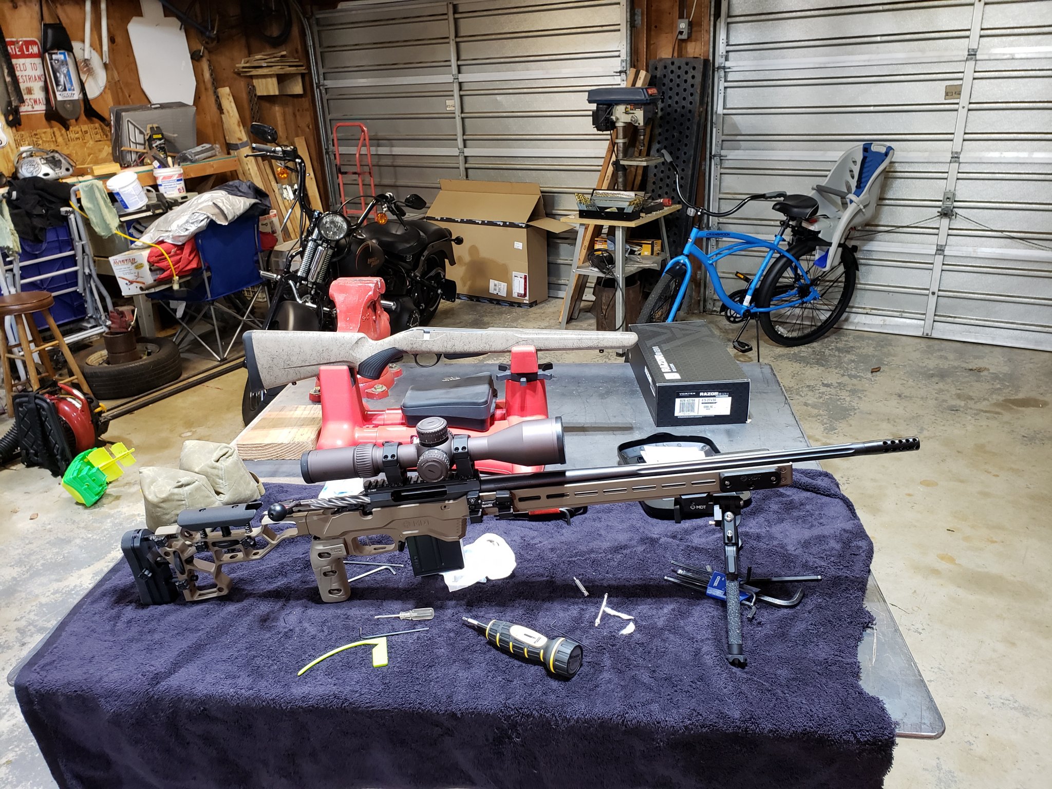

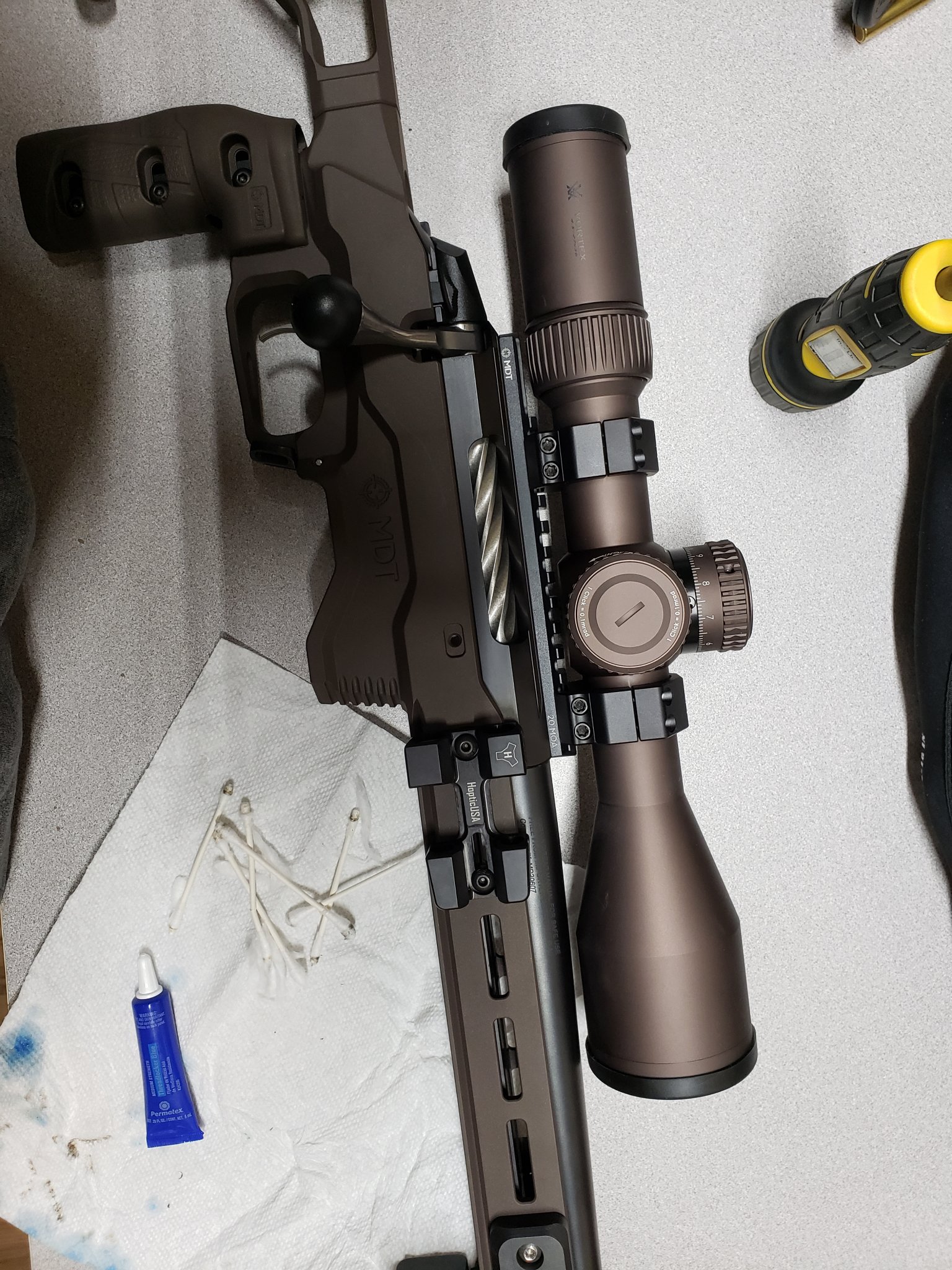

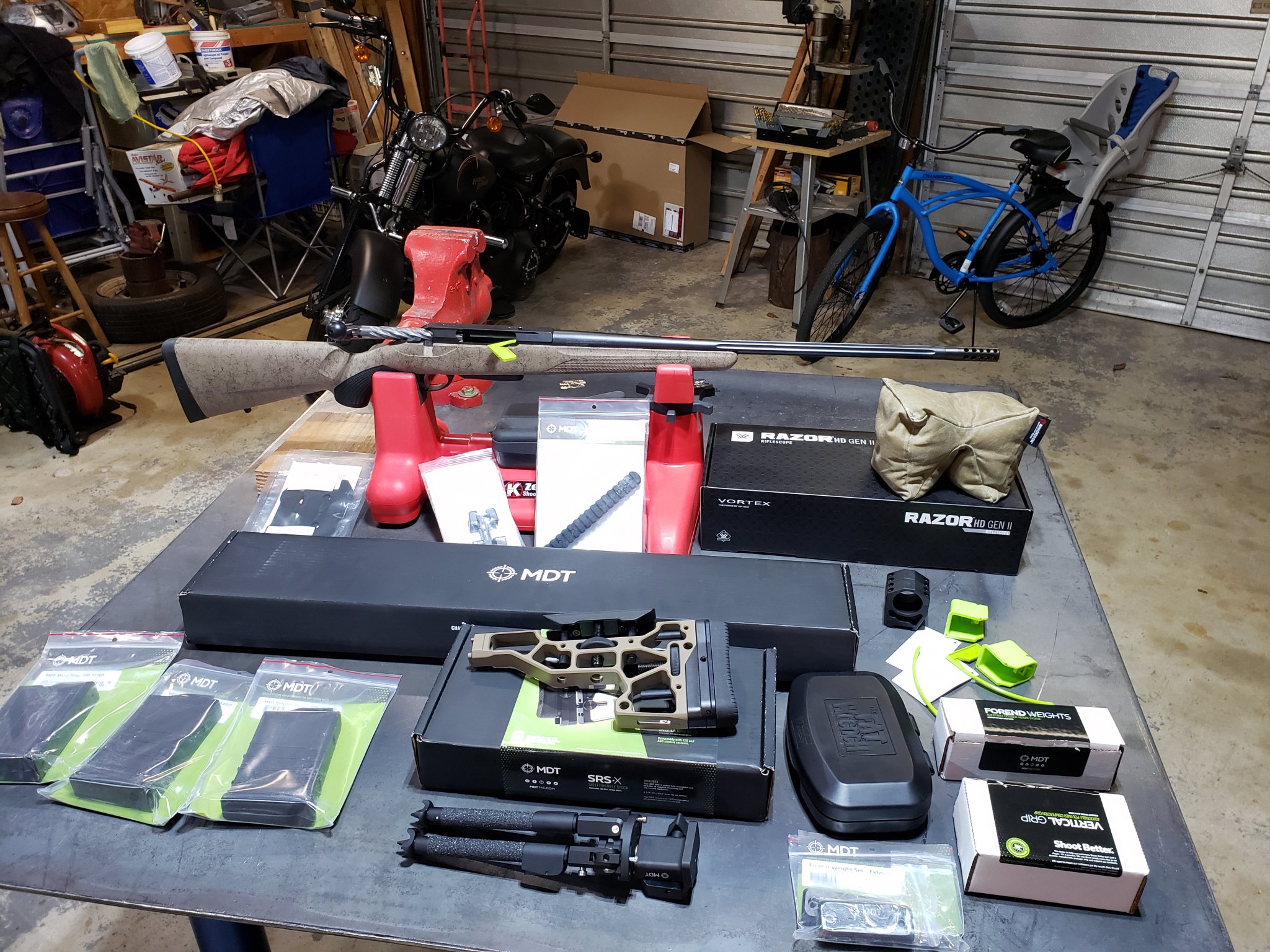

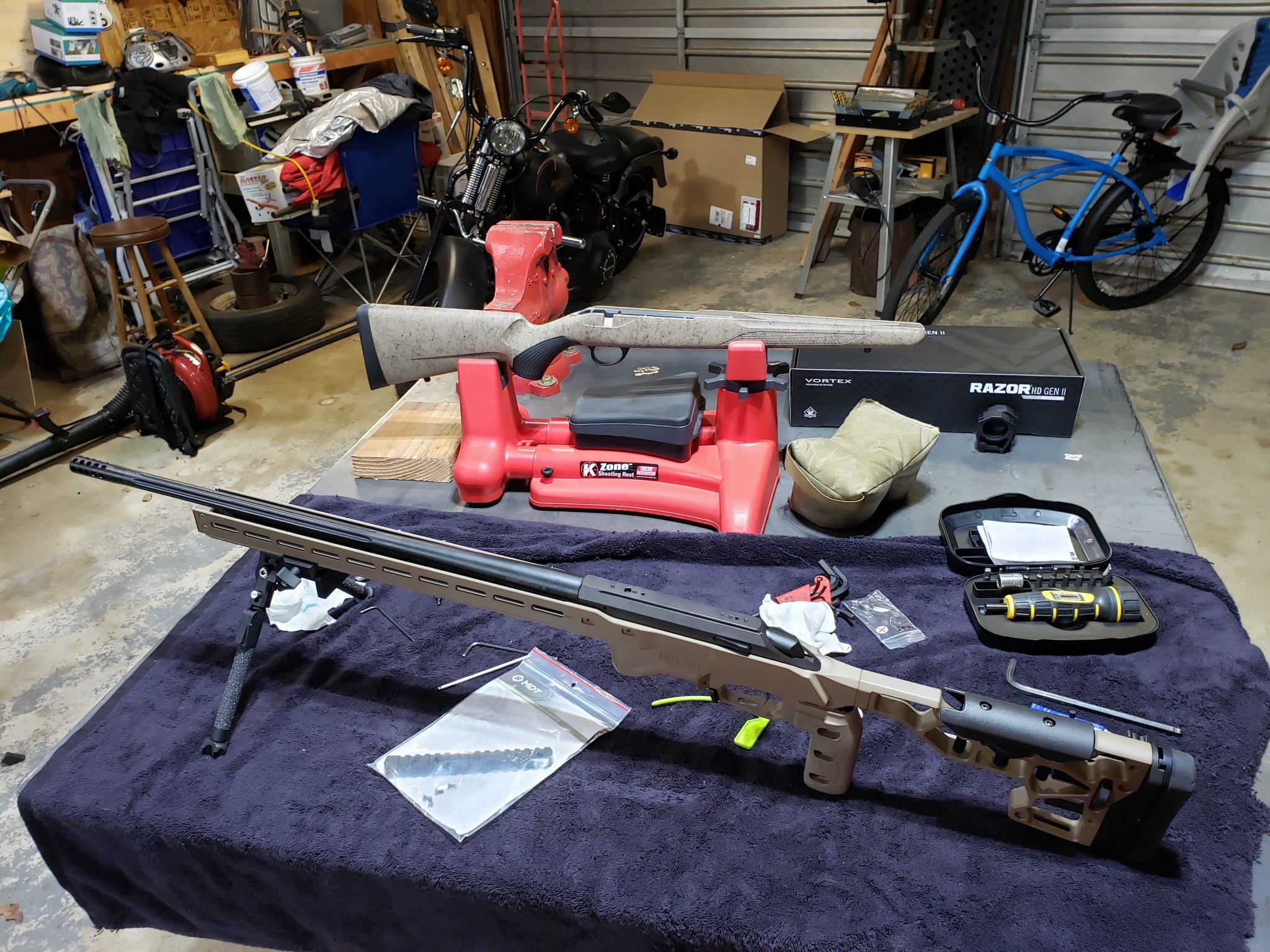

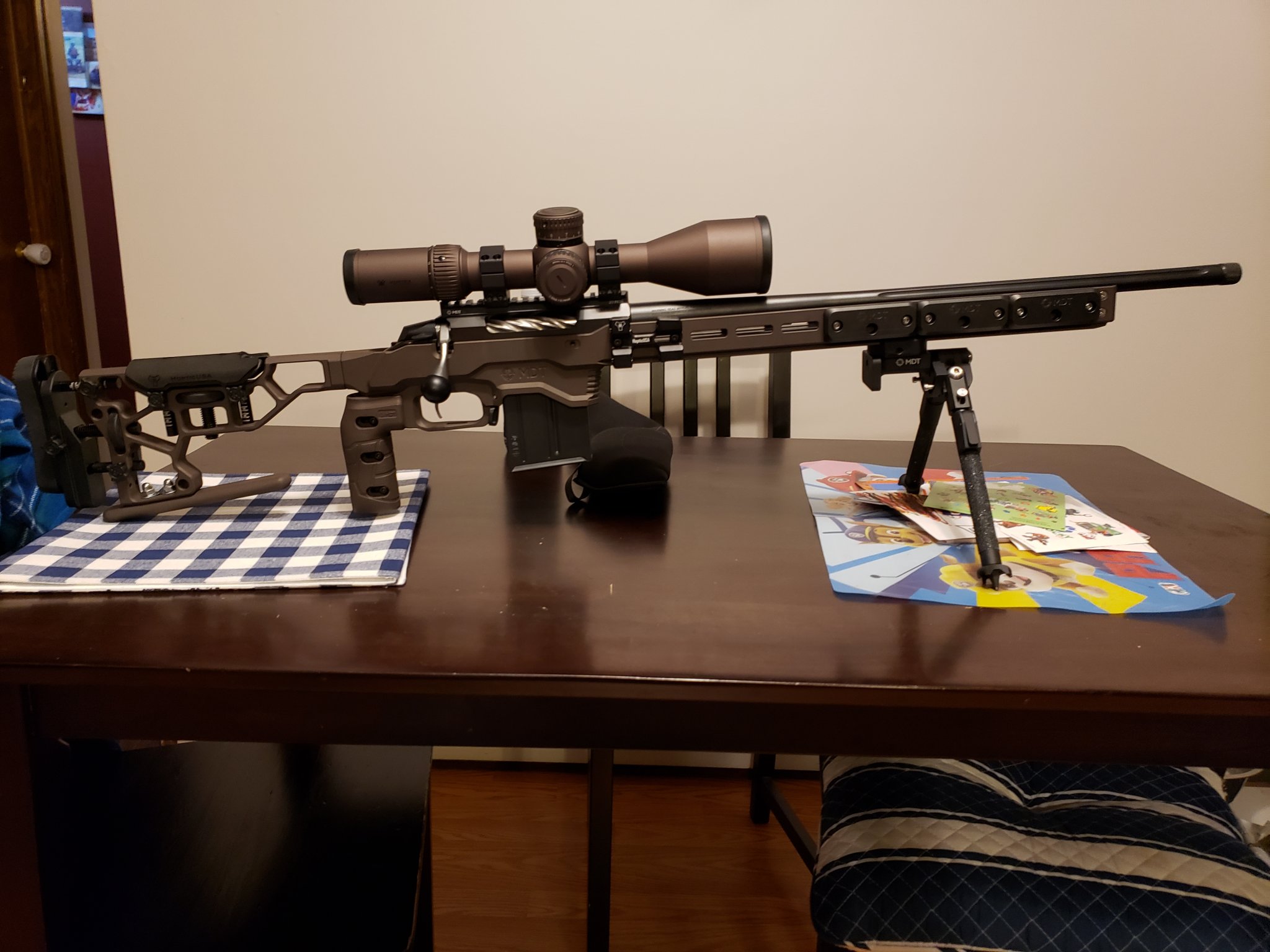

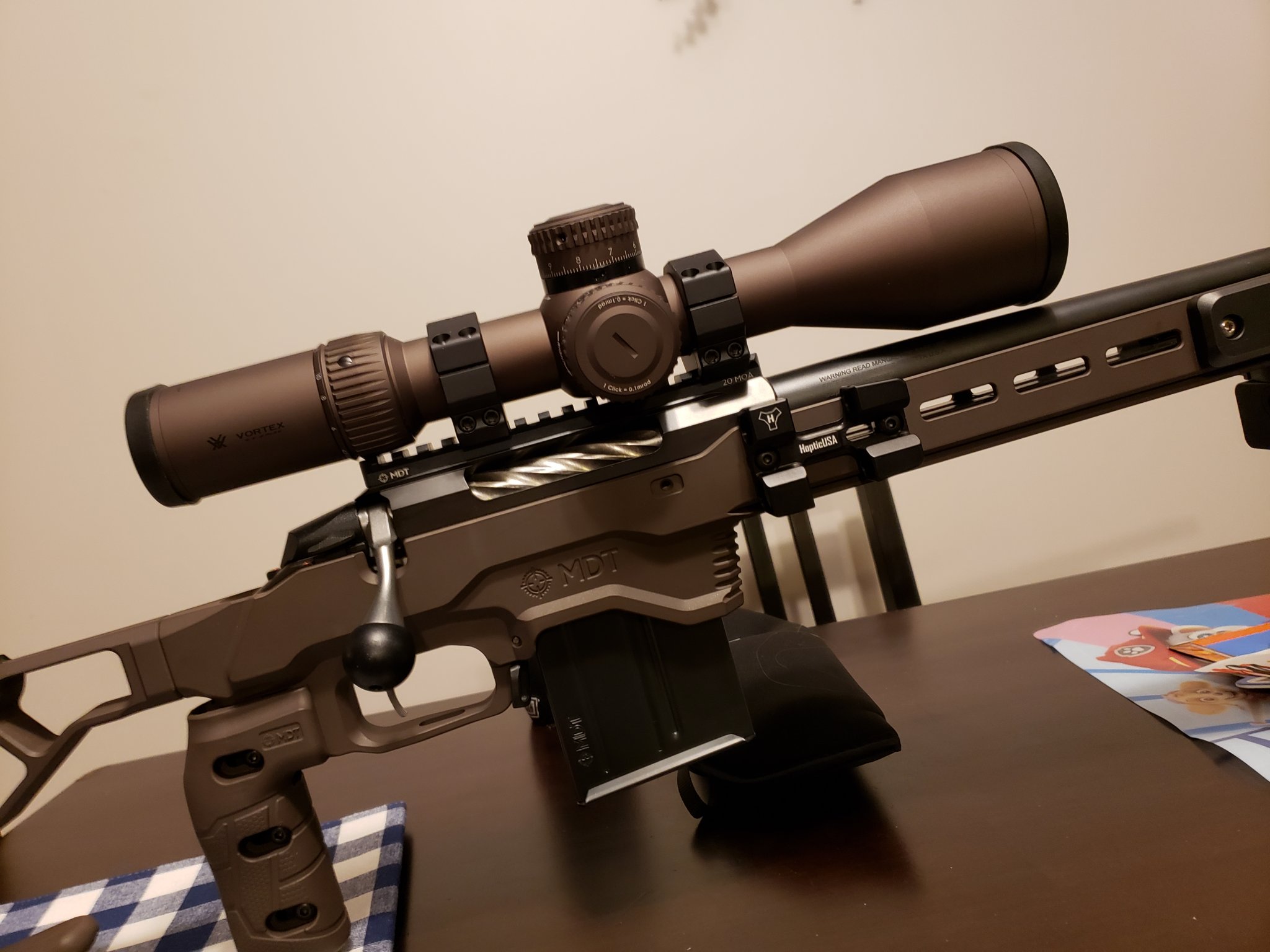

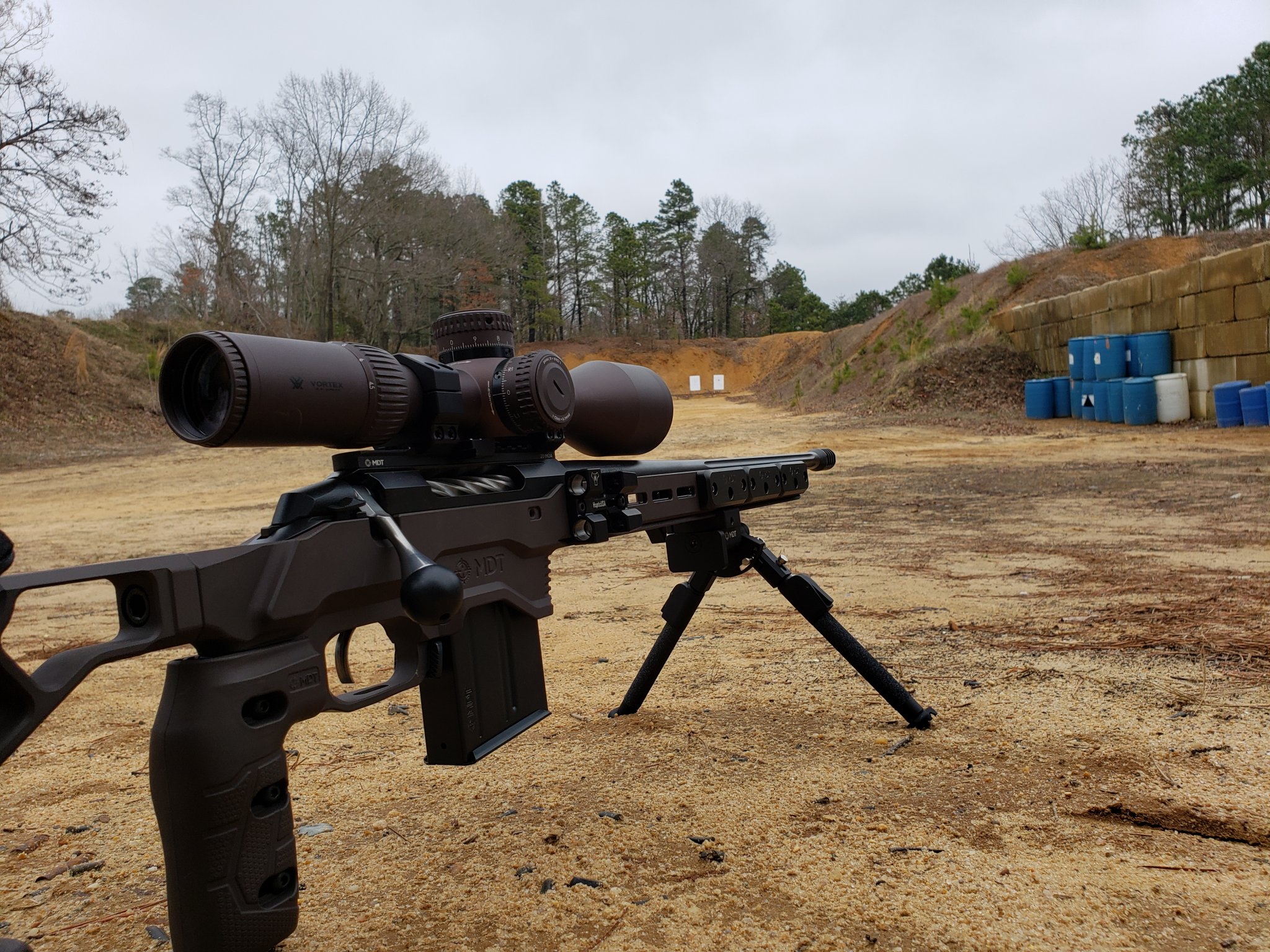

So I spent more than a few bucks on black Friday at MDT to get me started. Then I got a Tikka t3x in the roughtech stock. I guess it's a thicker barrel than the lite and it has a fluted bolt and barrel. Here's the completed rifle
I have a set of the lower rings on the way as well as some more exterior weights. All of the interior weights are in there. I also installed the yo Dave trigger spring and that thing made the trigger amazing!

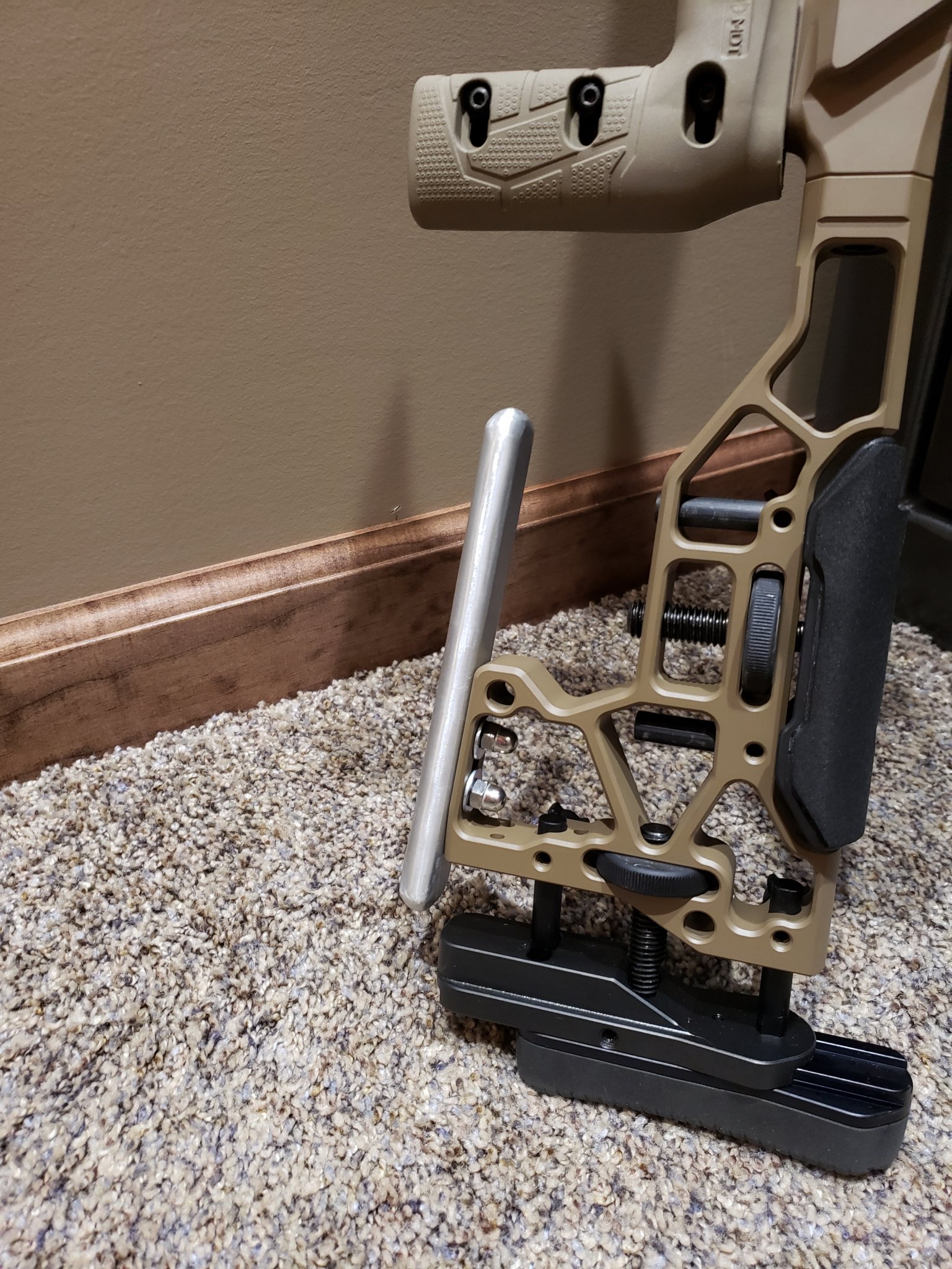

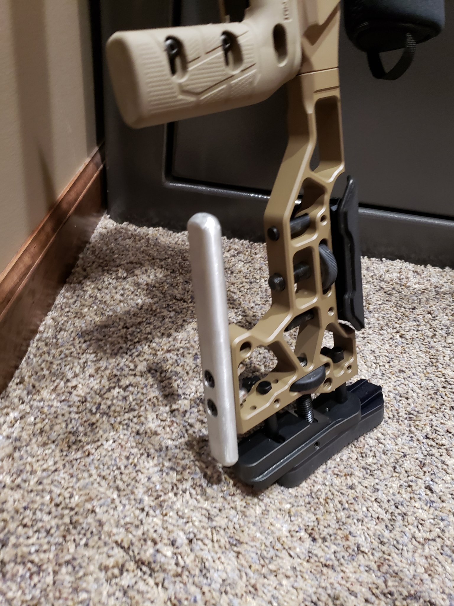

Another thing I did was made my own bag rider out of aluminum. I don't like the mdt bag rider because it's flat and looks to short.
I've always had A2 stocks on all my other rifles and like the angle on the bottom for shifting the bag forward and back for elevation. I'm going to get it powdercoated flat black and will probably get the chassis creacoated to match the scope next week.

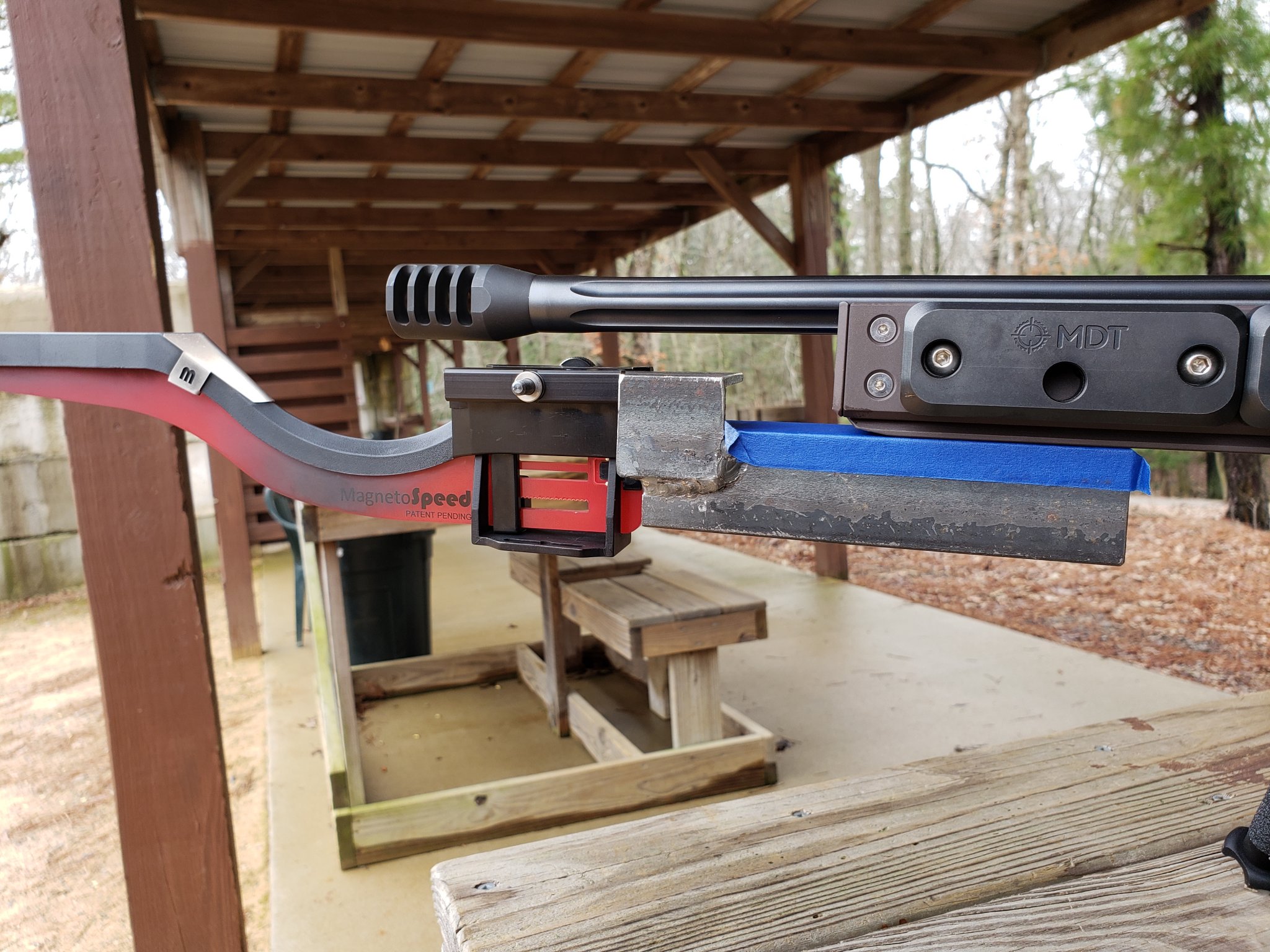

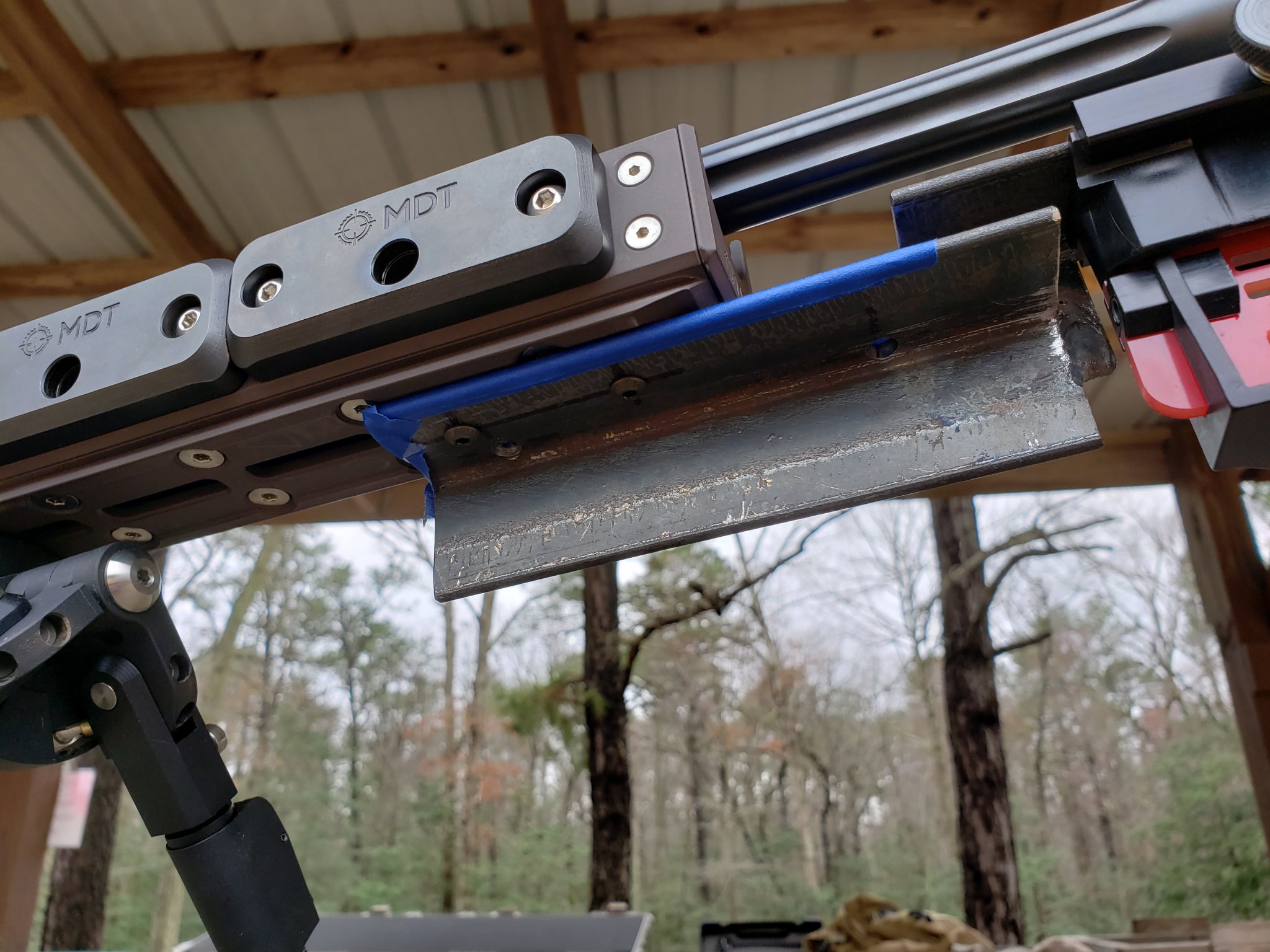

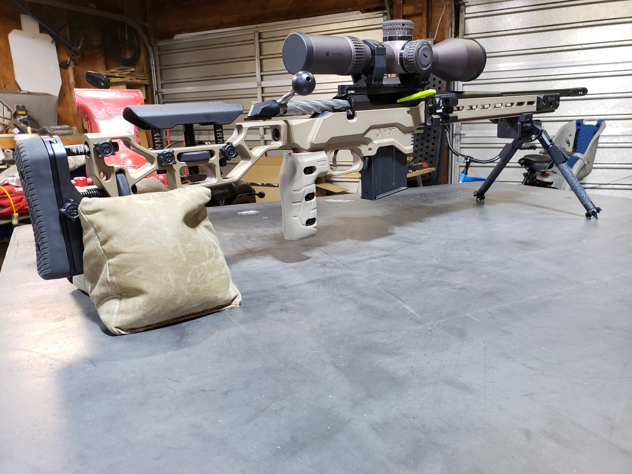

I made a really nice mount for the magnitospeed that bolts to the side of the chassis using mlok hardware. It's nothing special just a pice of angel iron chopped and ground up to resemble a Pic rail on the end so it uses the Pic rail adapter. Sorry I forgot to get a picture but I will next time.

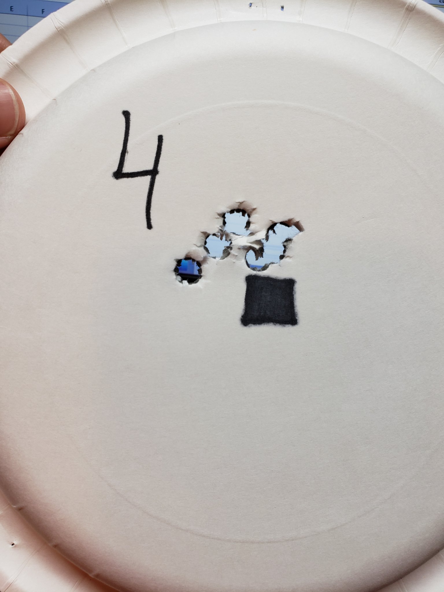

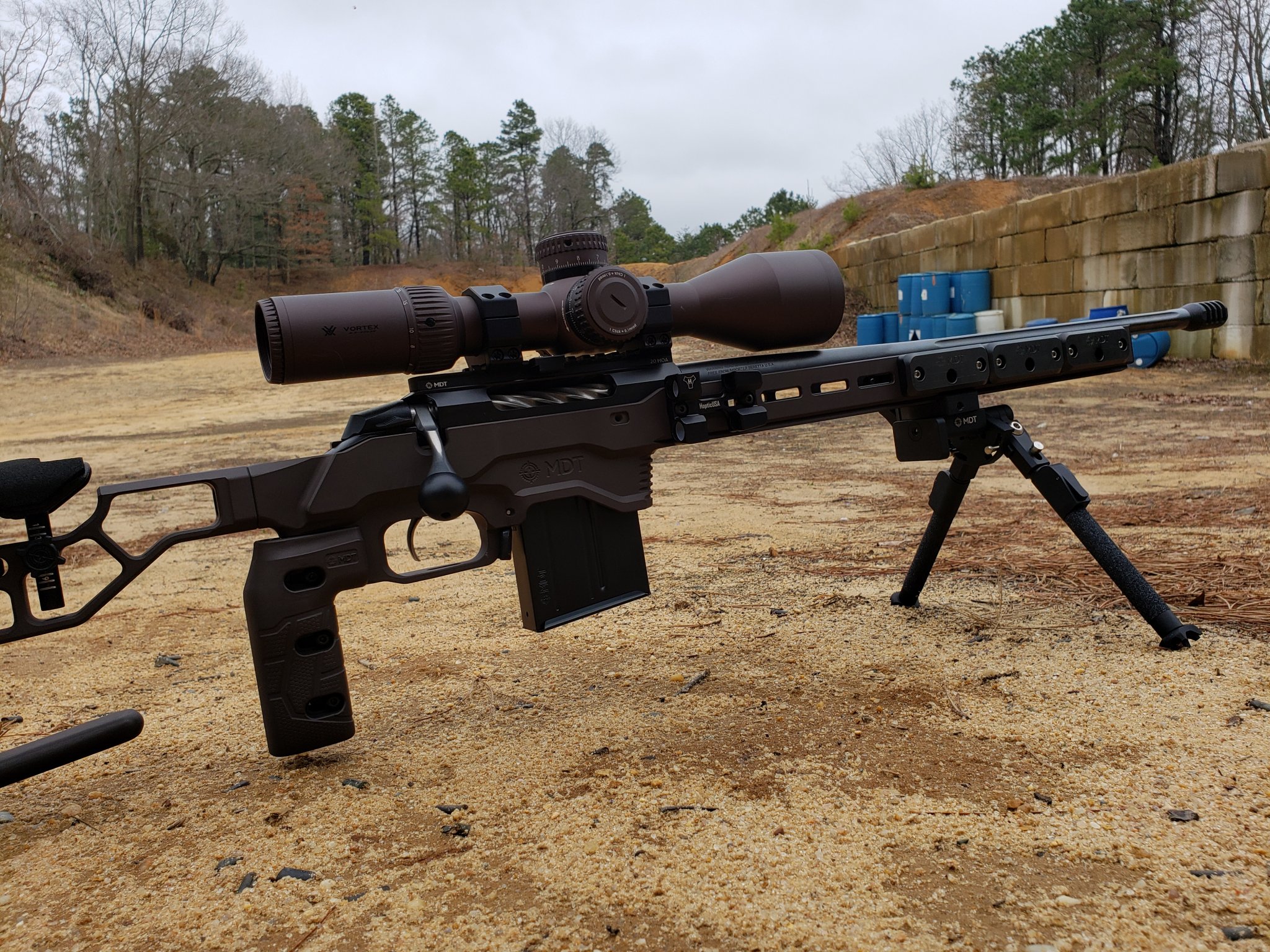

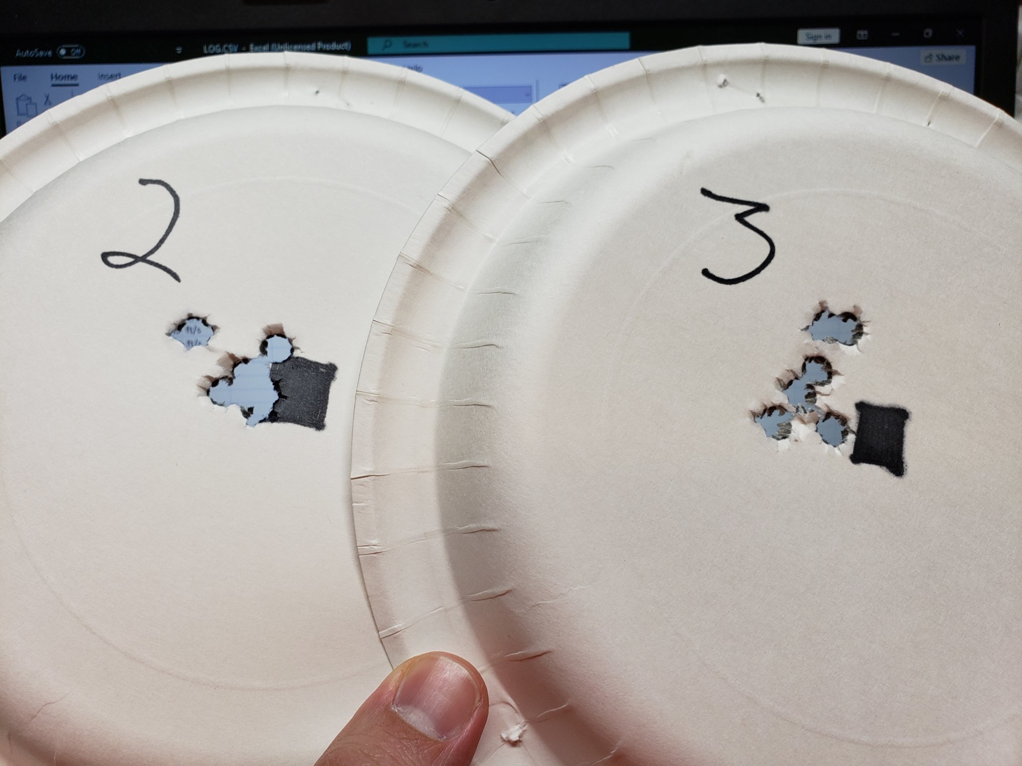

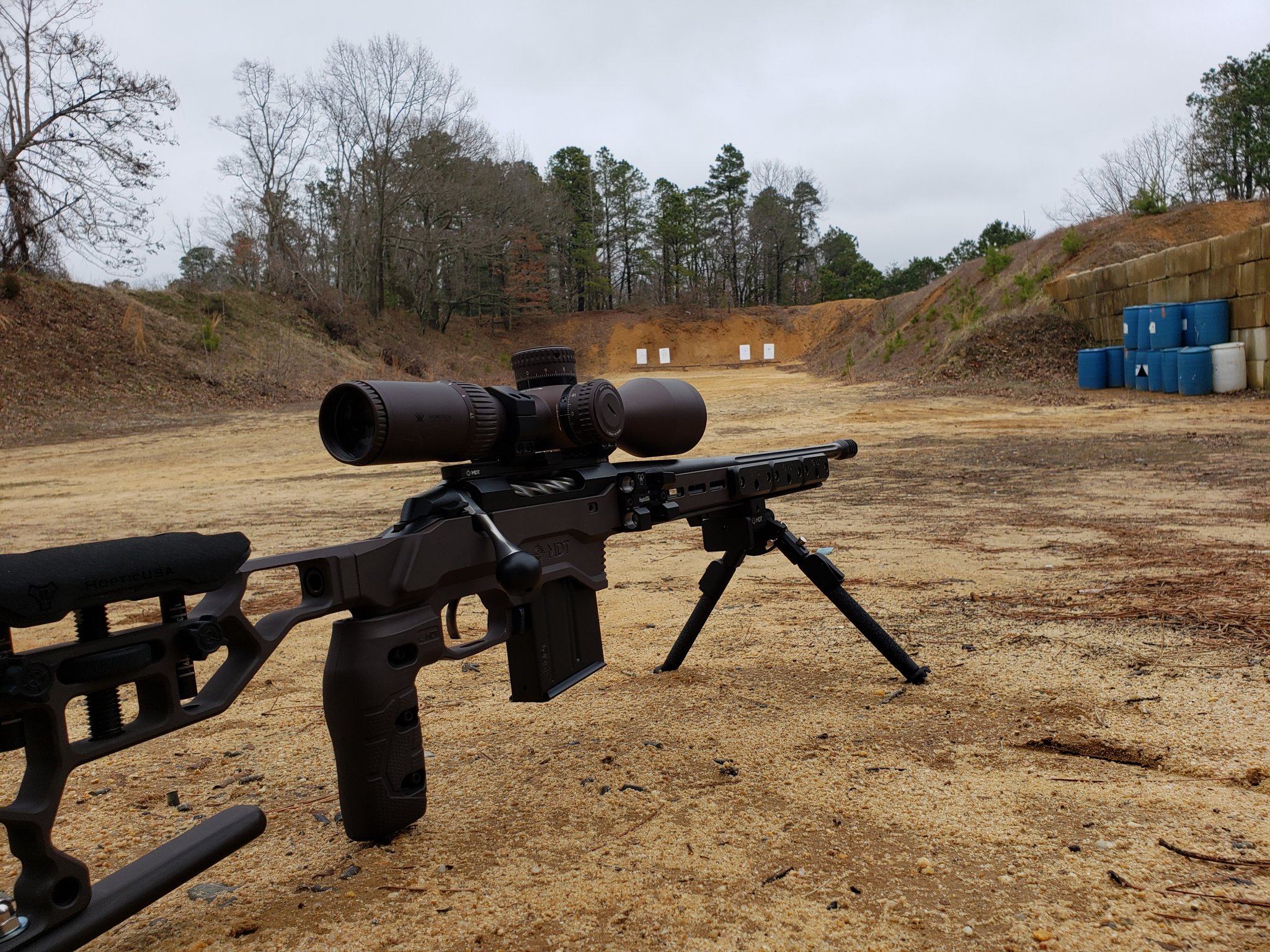

I finally got to the range today and did it all right. I got the scope sighted in, in 4 shots. My first loads were 43 grains of varget behind a nosler custom competition 168 at 2.790. I settled on that length using Eric Cortina's jam method. Some guy was talking my ear off during my next practice target and I can't remember if I shot it 3 or 4 times but the group is probably the best group I've ever shot, at least that I can remember

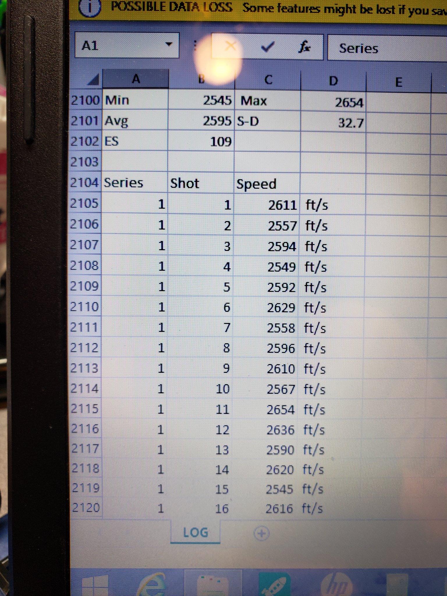

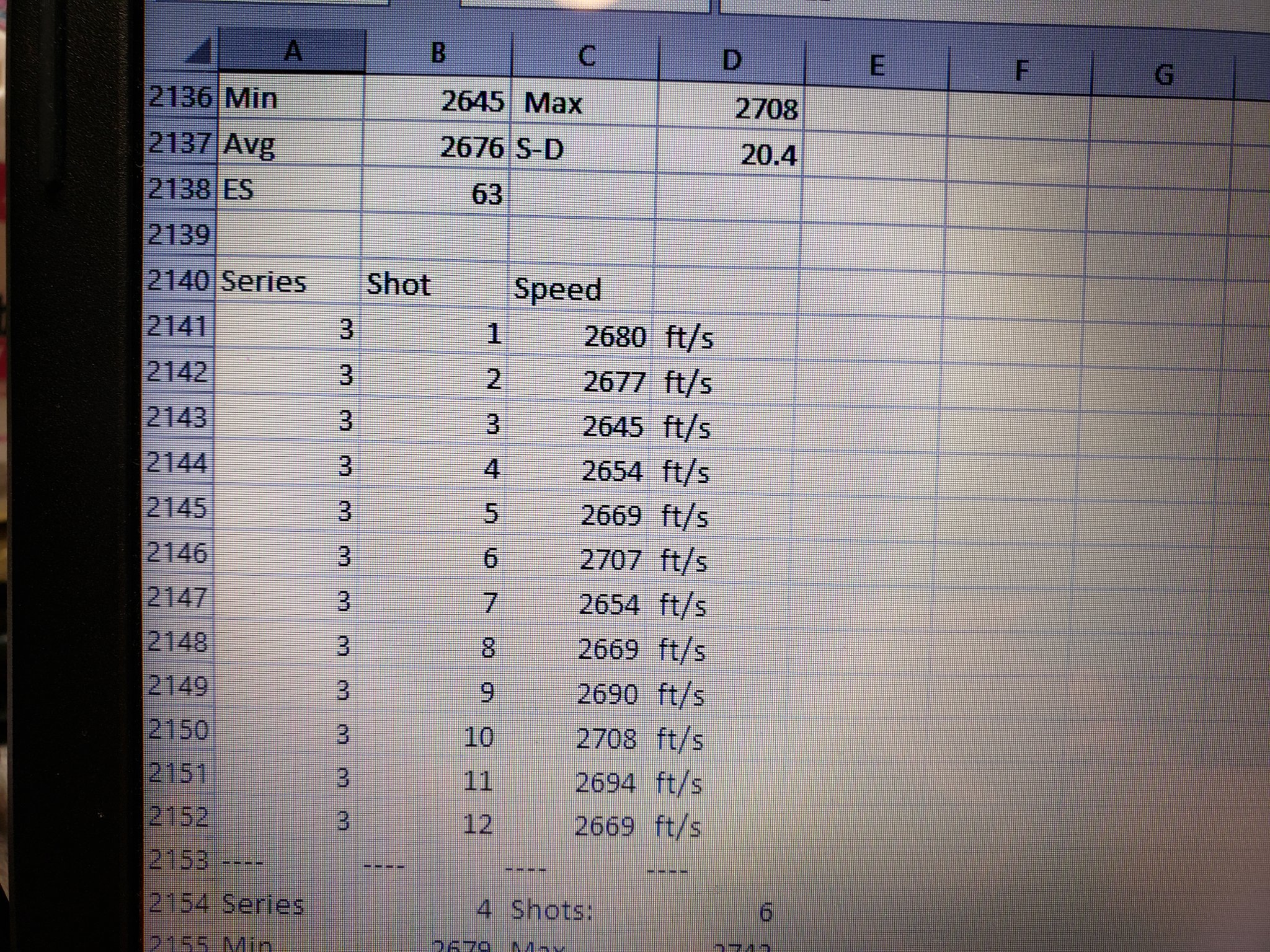

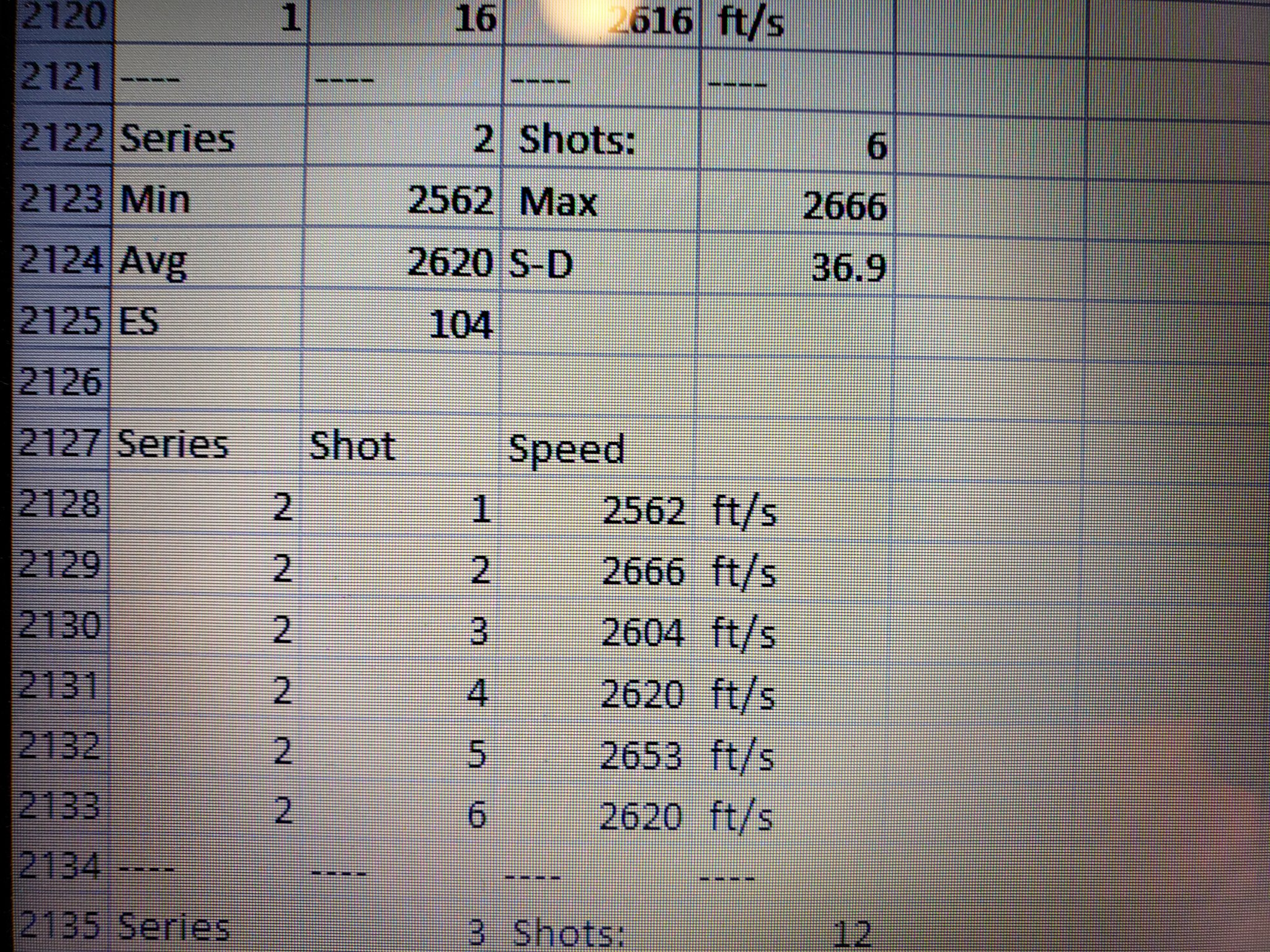

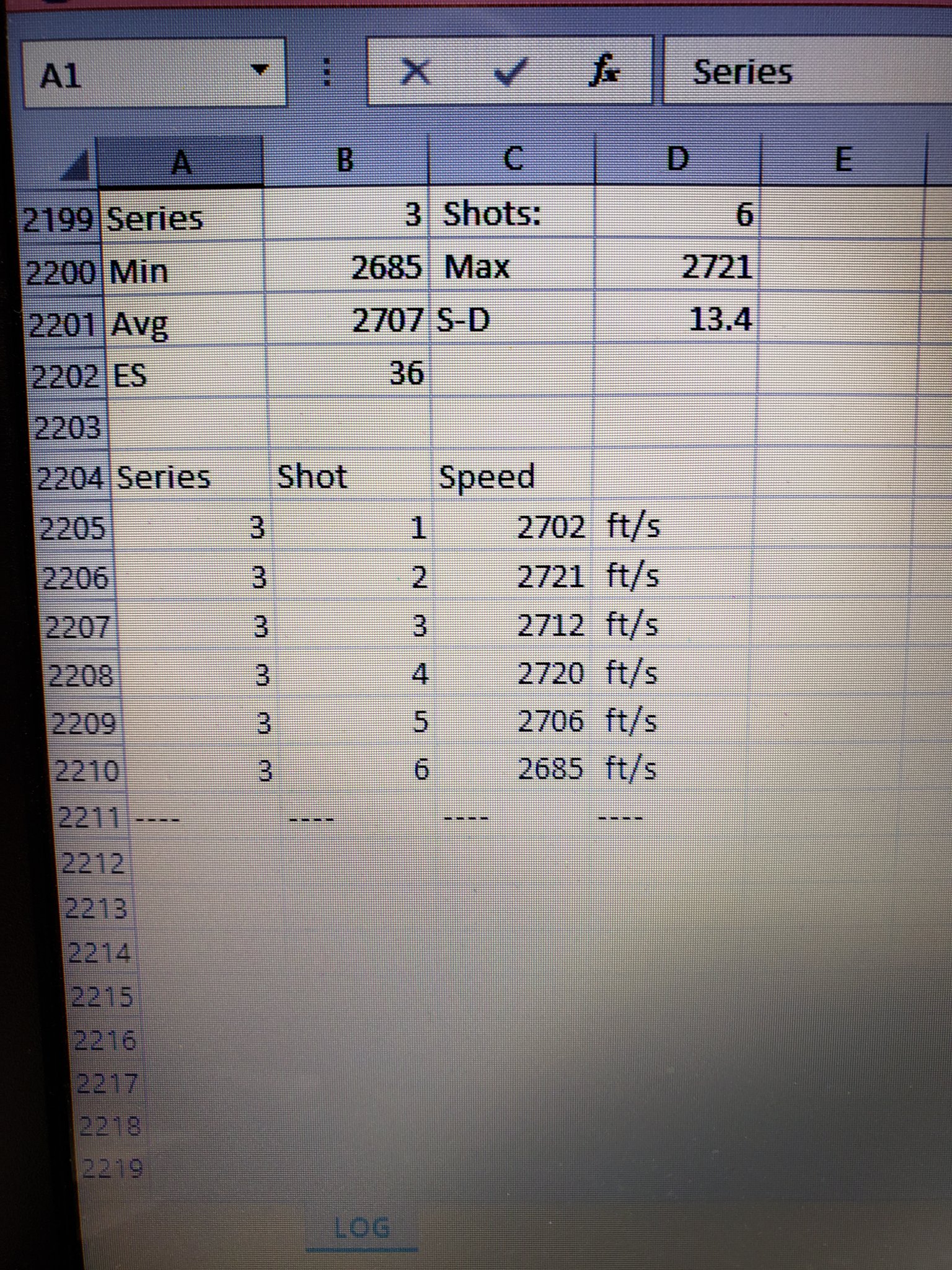

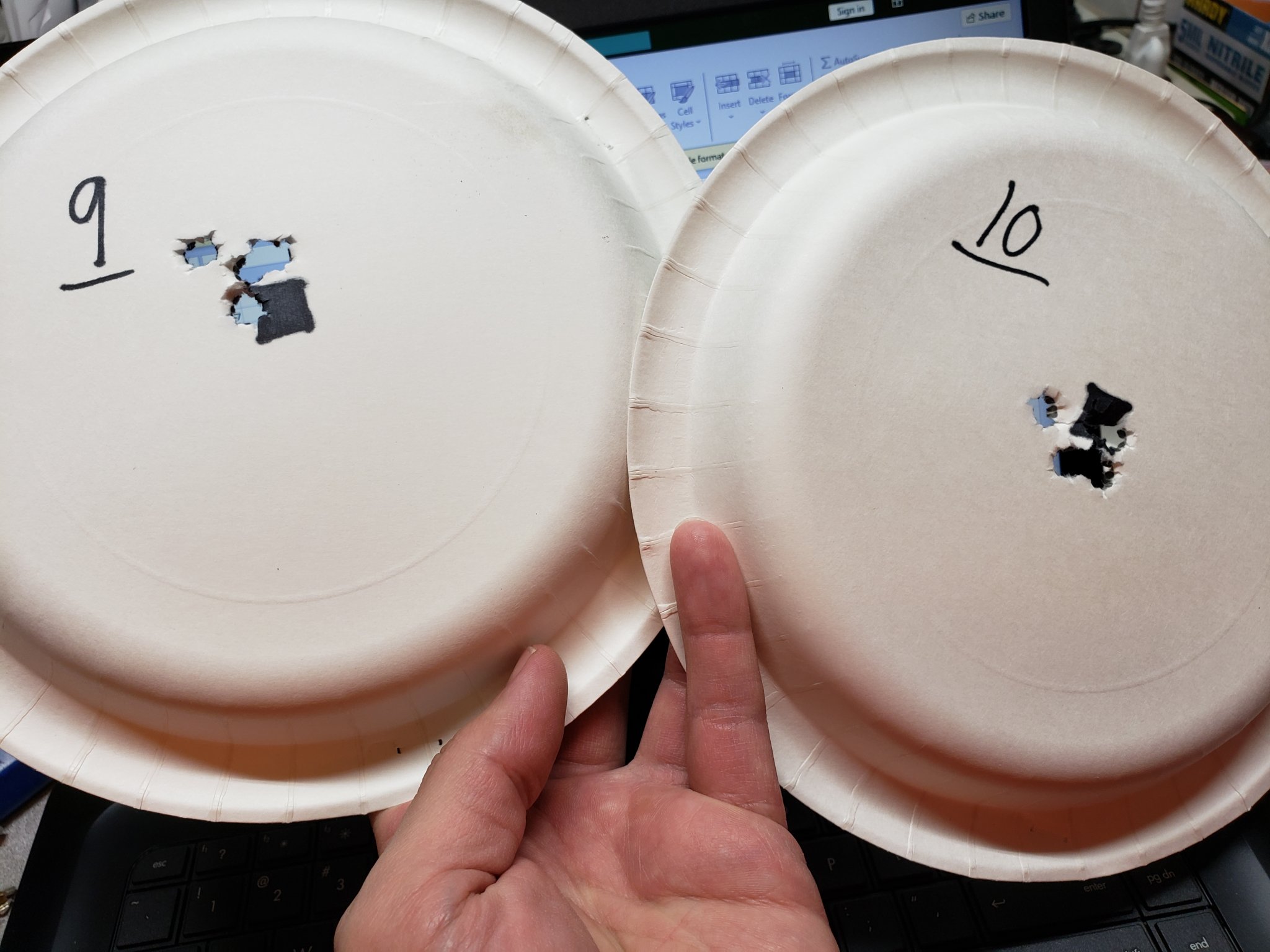

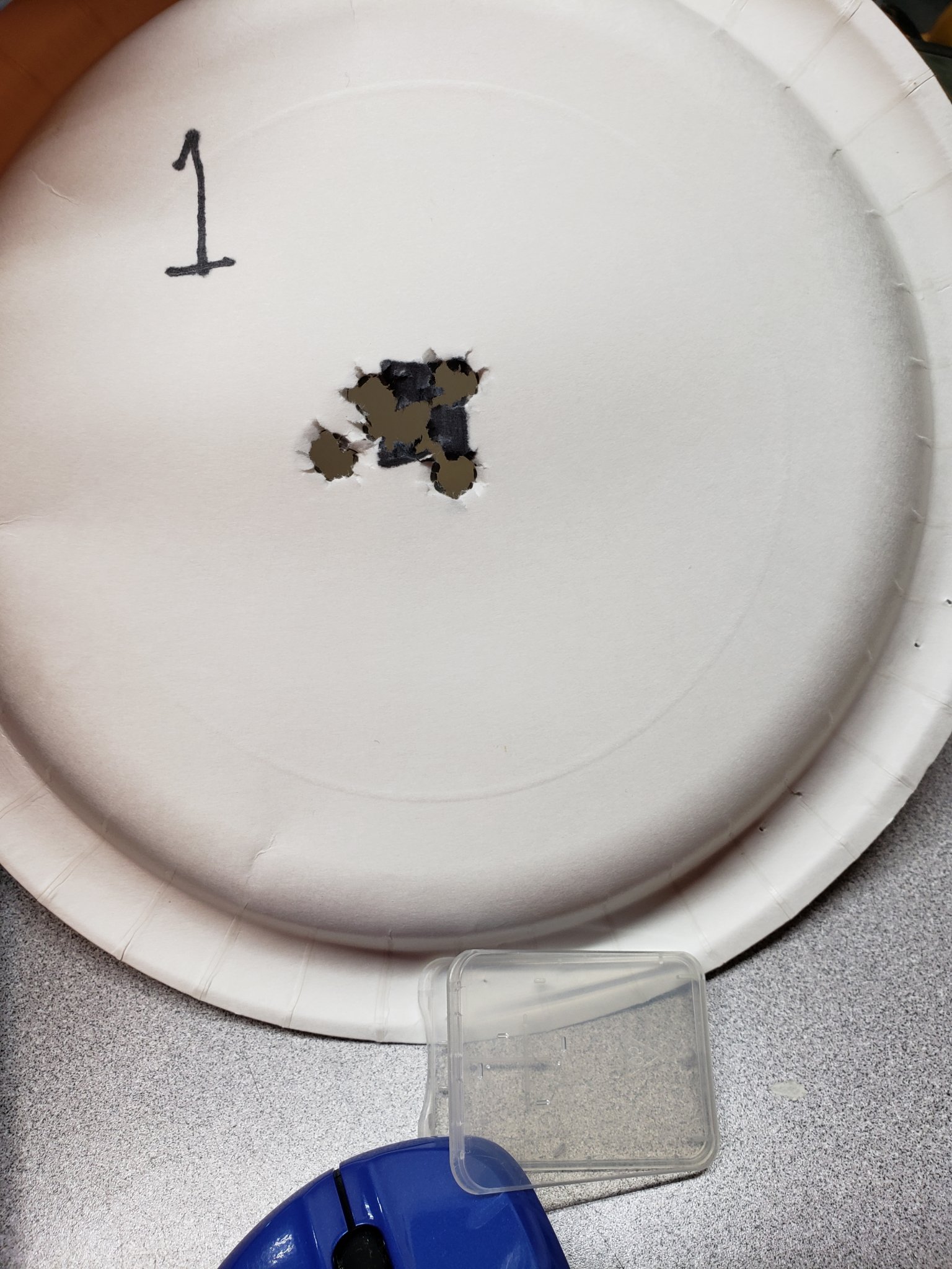

Here's where I'm at so far with load development I shot 16 rounds of the starting load total just to get it sighted in and get a feel for the rifle. I it grouped amazing basically one hole on 3 different targets but the speed was all over the place. Target #12 from above
, 9 and 10
Reactions: camocorvette

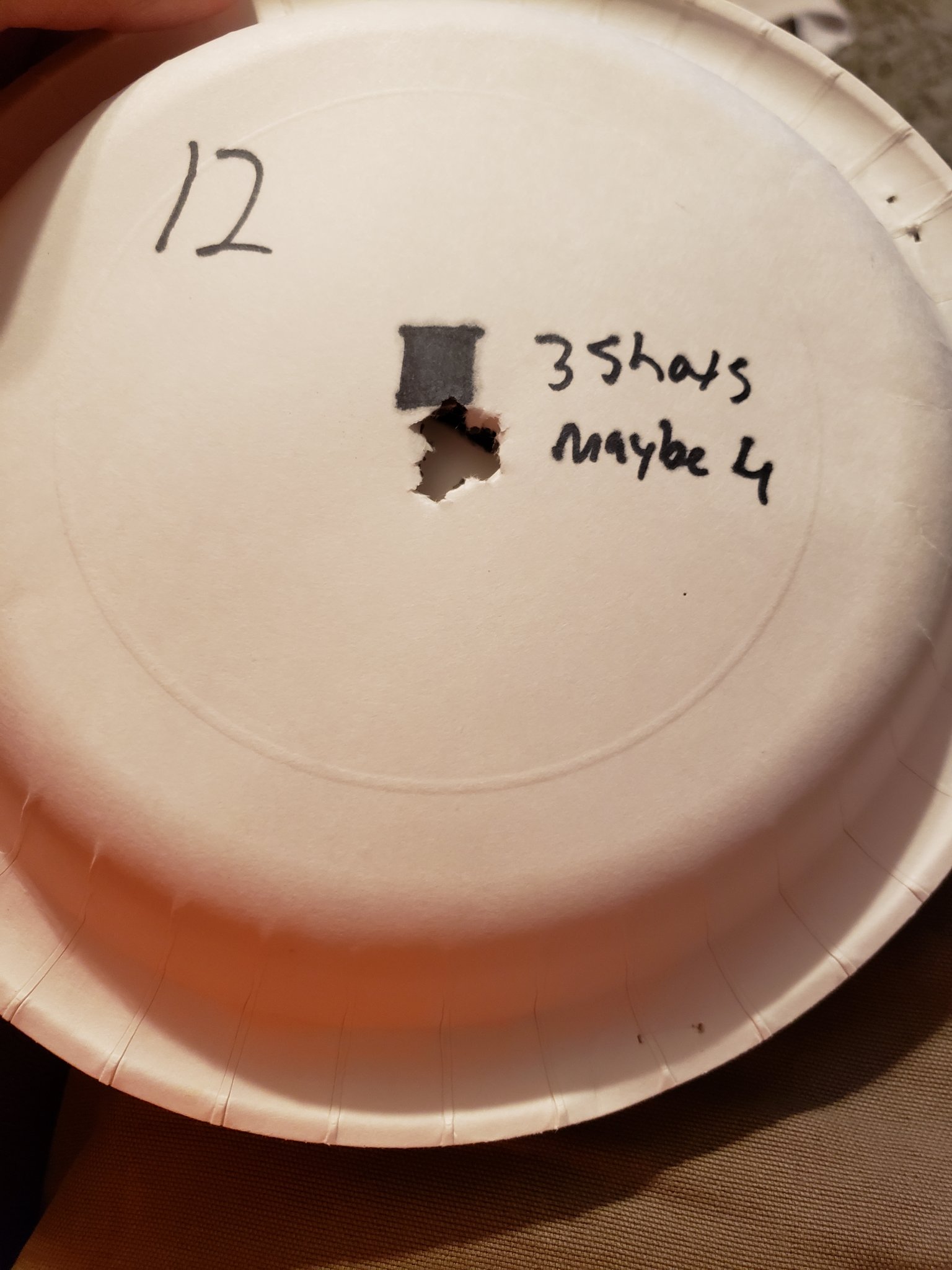

Now I forgot to archive the data so shots 1-6 are at 44gn with target #2.
Shots 7-12 are 44.5gn in to target #3. By this time the barrel was getting pretty hot and throwing a mirage in the scope. I really should have stopped but I'm always short on time
Not bad groups, but your SD and ES are quite high. This will show up greater at longer range. You might want to examine your reloading process and see if you can get those numbers down.
Nice write up. How are you throwing and weighing your charges?

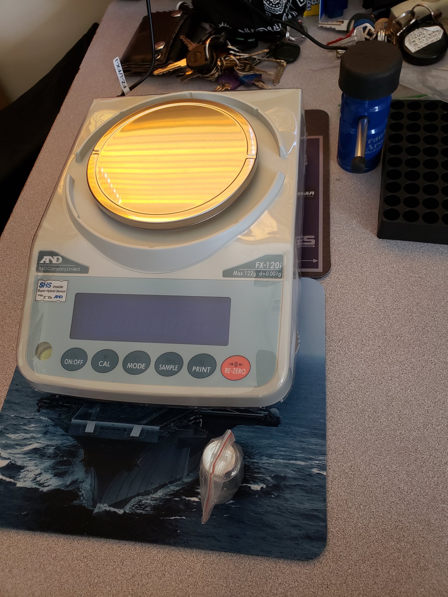

Yeah I can't believe it's that bad. I'm using the gem pro 250 scale and dropping them 1 at a time. It takes me about 30 minutes to roll 50 rounds.
I was looking into beam scales but it's about 50/50 info I've been finding as to it being for me.
I guess I'm going to have to bite the bullet and get the fx120i but I really don't want to spend that kind of money right now because I just bought all this stuff and another CK Arms 2011 and all the Christmas presents for everyone else.

You will not regret the AutoTrickler. The best reloading investment i made. Makes precision charging fast and easy

Got to get the velocity spreads under control before you settle on a load. When shooting be aware of your grip tension, muscle tension in your arm and shoulder and how much you are pulling the gun into your shoulder this will also effect muzzle velocity. Also be aware of how long the rounds are sitting in a hot chamber between shots. Consistent will be your friend as you get further into the sport. I have never used Varget in my 6.5
I use h-4350 or one 4451. If you want more speed rl 17 is pretty sweet but can be temp sensitive.

Doh I totally forgot about keeping the same grip and shoulder pressure constant, thanks for reminding me. I know I wasn't loading the bipod consistently I was scratching the bench all up with the sharp feet on it. I hate it when people damage clup property and I felt terrible that I was. Next time I'm going to bring a pice of carpet and some clamps to protect the bench and get a better AND MORE CONSISTENT pressure and grip on the rifle.
I did remember not to chamber until I was ready to fire though so I guess I did a couple of things right.

I'm talking myself into spending the money for the fx120i. Where is the best place to get it from? I don't want the hopper just the trickler for now.

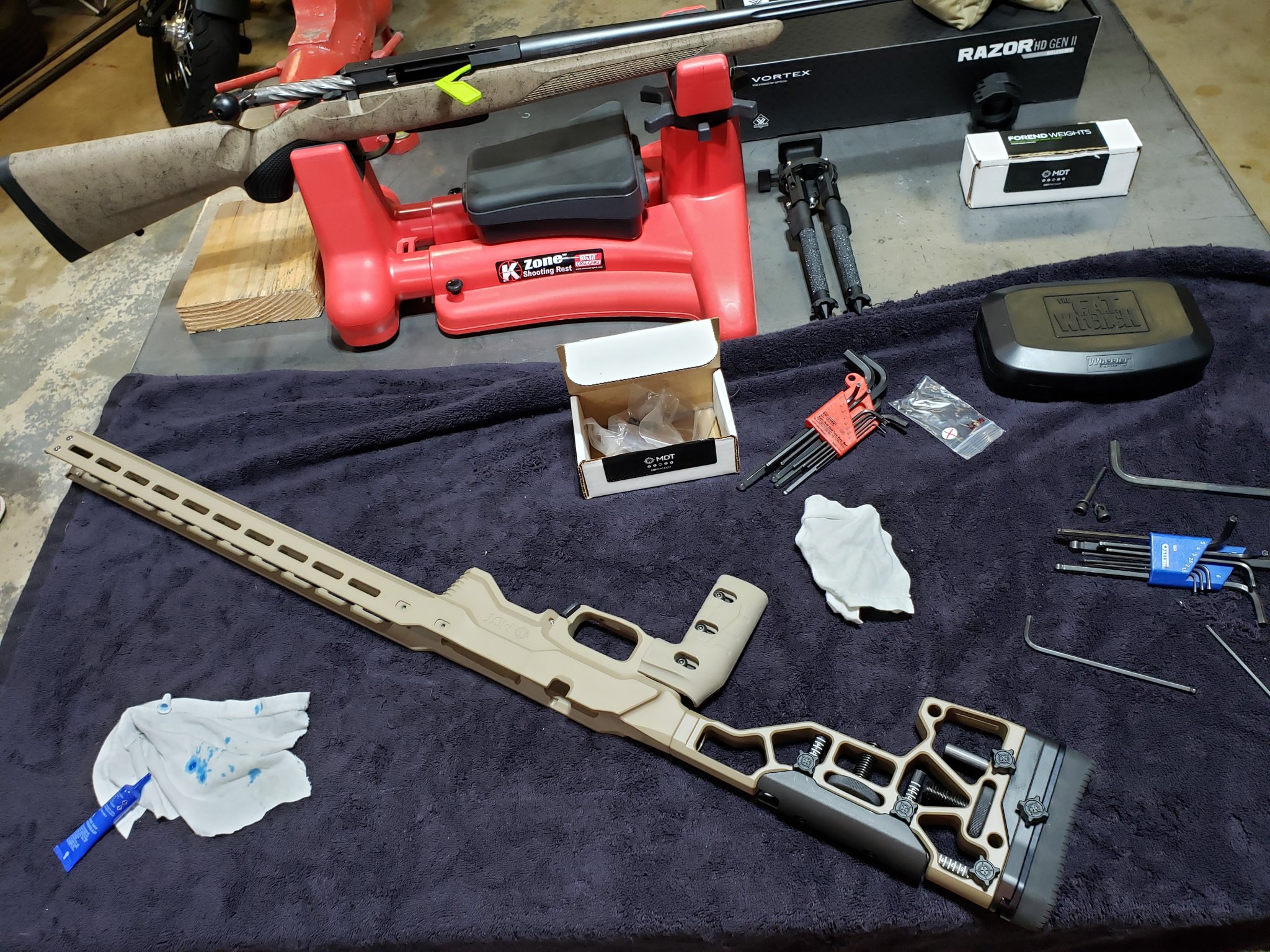

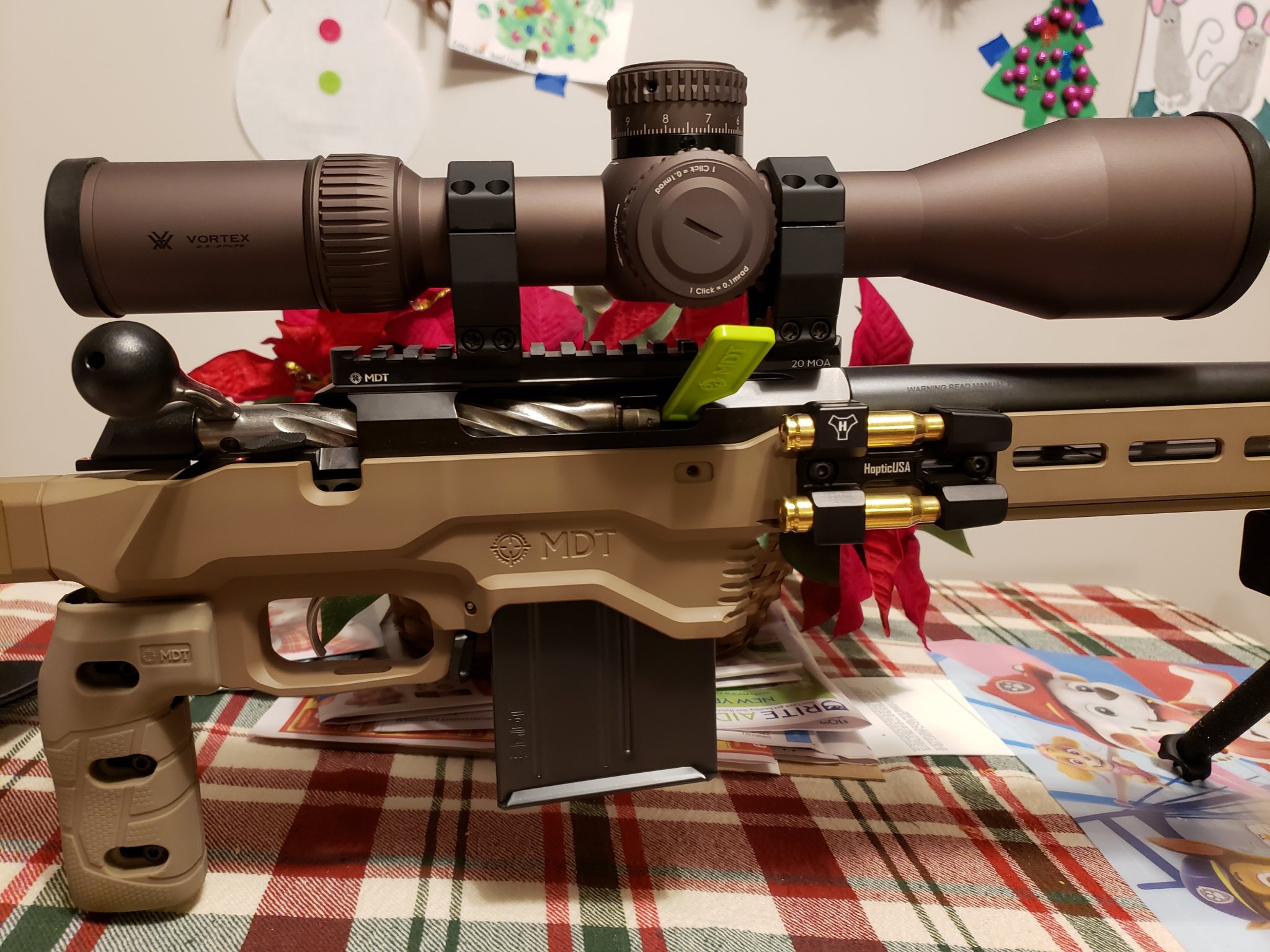

Well the money keeps falling out of my pocket, I'm gona staple it shut pretty soon. I got my scale, the wife signed for it and I hope she didn't look to closely at the box because the super nice Canadians were kind enough to put the recipt on the outside of the box with the price showing! One cool thing is it only took about 5 days to get to NJ from Canada.
Now I'm gona do it right for the first time in my life and read the directions.

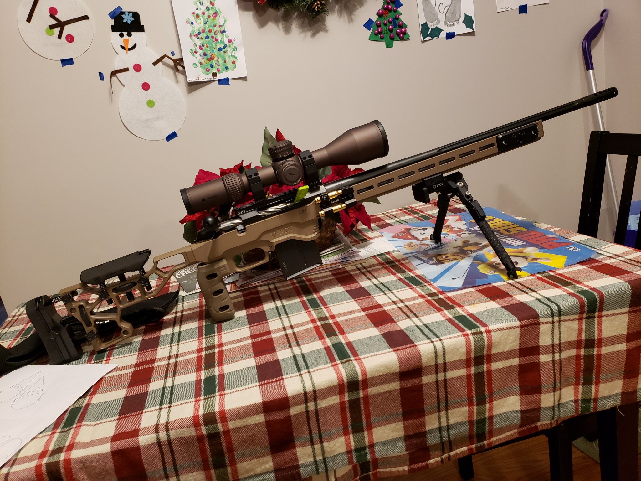

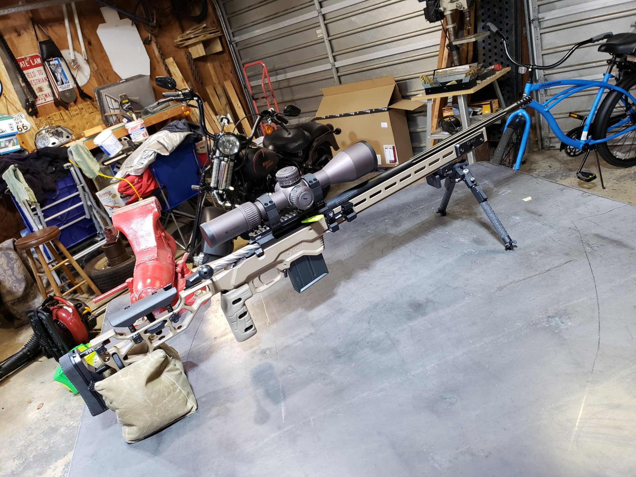

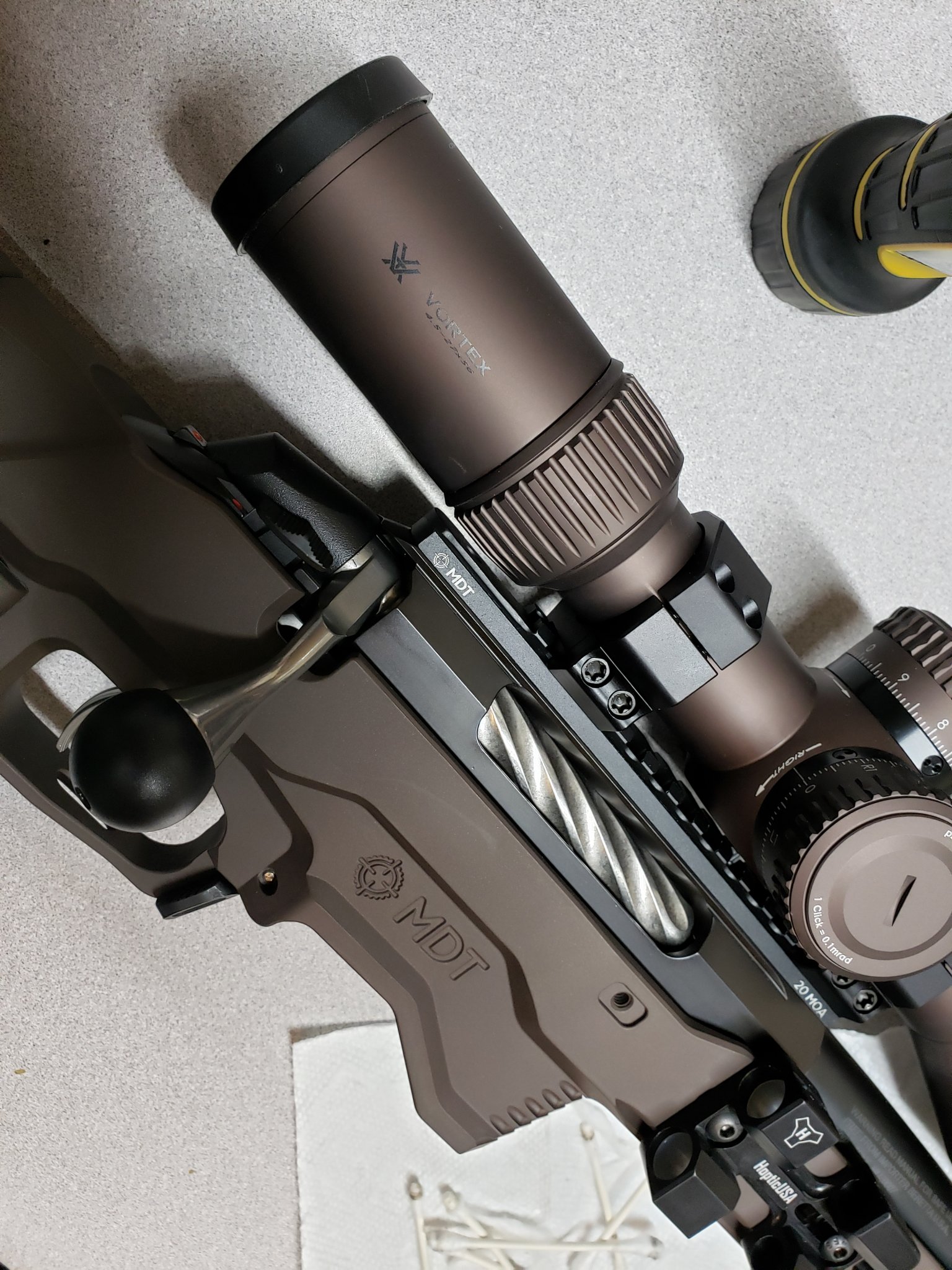

I also gout my chassis cerakoted to match the scope. I think it looks amazing and I can't stop staring at it. I'm gona use these lower scope rings but I have to mill off the last three nubs on the picatinny rail to clear the zoom ring. The caps are just loosely on there.
I'm not planning on running a cat tail so that won't be a problem.

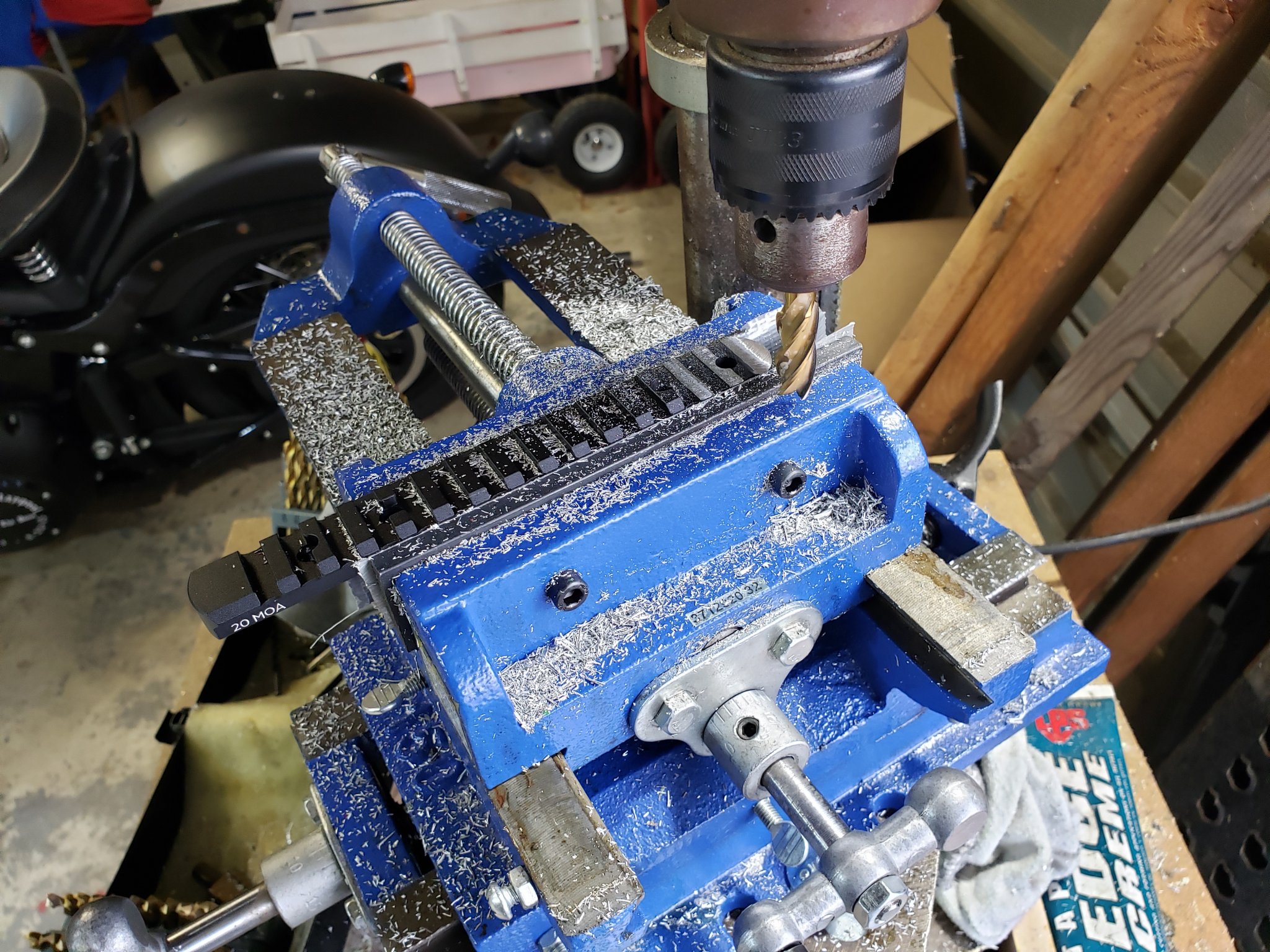

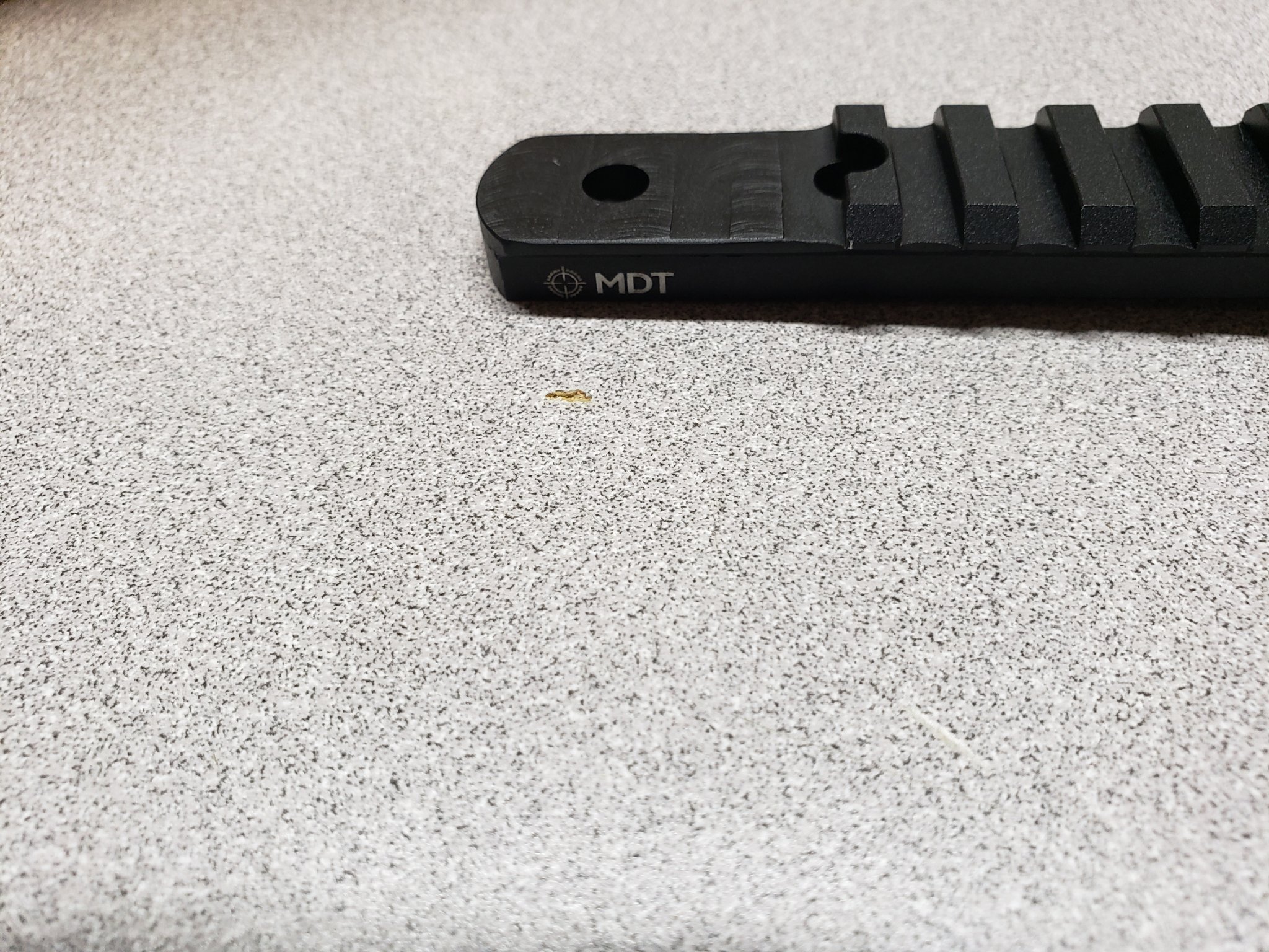

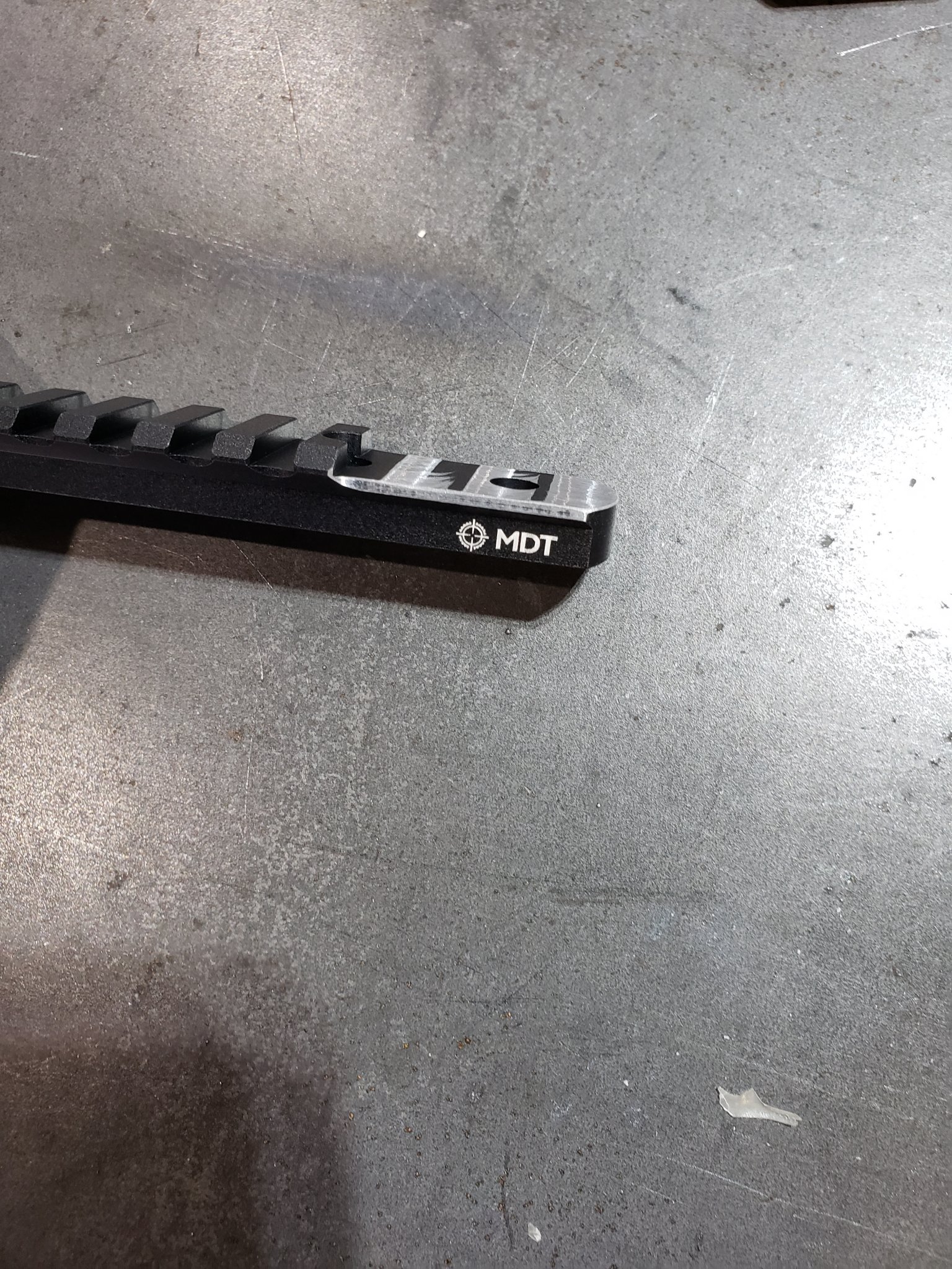

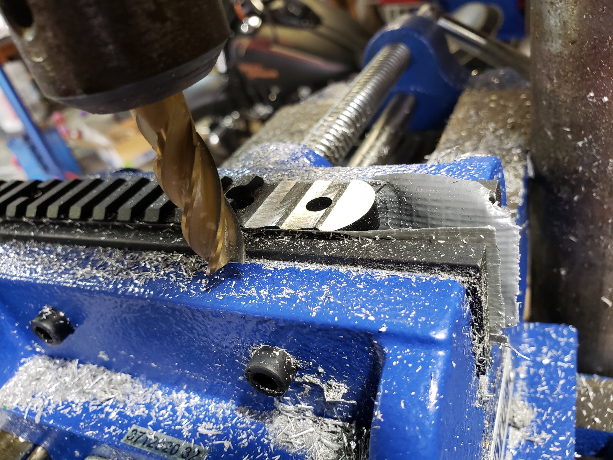

So I went full hillbilly and ventured into a harbor freight and bought a backyard mill set up.
It actually worked great! Way better than my usual method of attacking everything with a Metabo.
I'm really happy with the results
Turns out the paint from my Harley matches pretty closely
Some bad lighting pictures of it finally finished.

@louu nice job on the milling.
Why didn't you just move the scope back to clear the rail? Then add length to the chassis LOP?
I tried it but I have a long neck and I'm 6'. I have this problem on all my rifles to get proper eye relief. I have the buttstock adjustment all the way out. I'm finally at the point where I'm tired of spending money on this stuff because I spent a ton and I didn't want to buy a spacer that's probably over a hundred bucks.

I like that you chose to mill the back of the rail. That is what separates men from boys.
Thanks man, I've been messing around with the Bridgeport at work and it's actually wayyy easier than it seems at first glance. You can make some amazing stuff on one of those. Unfortunately it's a nuclear electric factory so you can't bring gun parts in there to work on. I've been looking into buying one but we're thinking about moving out of this shithole new jersey and I don't want to move a Bridgeport twice. Next house, definitely getting one!

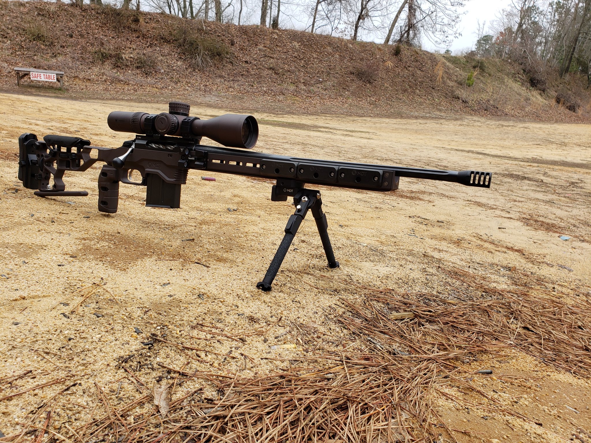

I made some good progress but not without one final kick in the nuts.

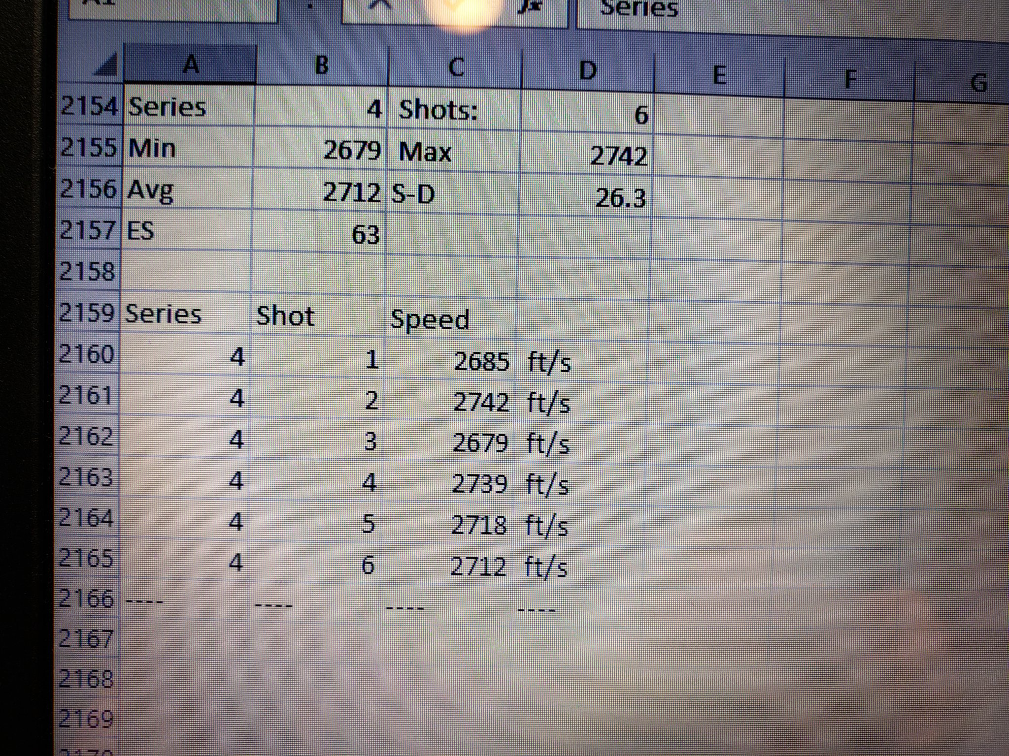

I finally have some proof that it wasn't a waste of money buying the fx120i. I loaded up 6 rounds at 44.5gn and 6 rounds at 45gn. The first 5 shots at 44.5gn were all within 19 FPS but then the 6th shot was wayyy off
I think I'm going to go with that charge because the 45gn load had a higher ES. I think my biggest problem is these bullets are junk. I may switch to the berger 155.5 but it's getting to late to start all over again because the match is in a couple of weeks.
I also got a brake on there finally. I got the EGW spacecomp. What a difference this thing makes. It barely kicks now. The brake did change my zero though so I have to go to the range again and fine tune it, gotta make more ammo first obviously. I may try to shorten up my OAL a little and see if the groups tighten up.
I had to make a new mount for the magnitospeed with the brake. I had it mounted on the side before but I think the brake would have killed it so now it's on the bottom
It's also more convenient because I don't have to remove a weight to put the chrono on

Good write up. Keep the updates coming. Your velocity might stabilize some more as you get 150-200 rounds on the barrel and it’s fully broken in.
Thanks man, I didn't know about that. I'm shooting my first match this Sunday so that should easily be 100 rounds. The next match after that is 3 weeks later so hopefully I'll do more testing between the two if I have time.
I ignored that slow shot in my last chrono session and averaged the 5 shots at 2712 fps for my speed for the kestrel
