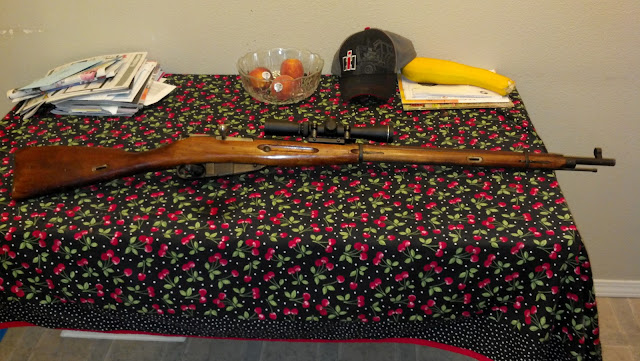

I Broke down and cut my barrle down to 22inches.
With help from a buddy we recrowned the barrle
Better picture

I FINALLY got my mosin back in action, I got the scope back from being repaired and got back to the range, and since me and a freind did all the work ( cut the barrel and recrowned the barrel) I was got it sighted it at 100 and it was shooting 4 inch group with military surplus ammo. and when i took it back out to 300yds i was hitting a 10 inch steel plate every time i pulled the trigger, yes i know i can do better with reloads and i am working on it know but i all of this was done with old russin military ammo so i am REALLY happy with my built. i will post when i get the reloads worked out.

For the Crown i did something differnet. i took a brass screw and placed it in back words in a drill and just kept running the screw head in the top of the barrel till it looked right. You can go on to Youtube and find a instuctional viedo on it. It might make more sence if you see it. But it is shooting really good so i am guessing it work good and It LOOKS Like a gunsmith did it.
