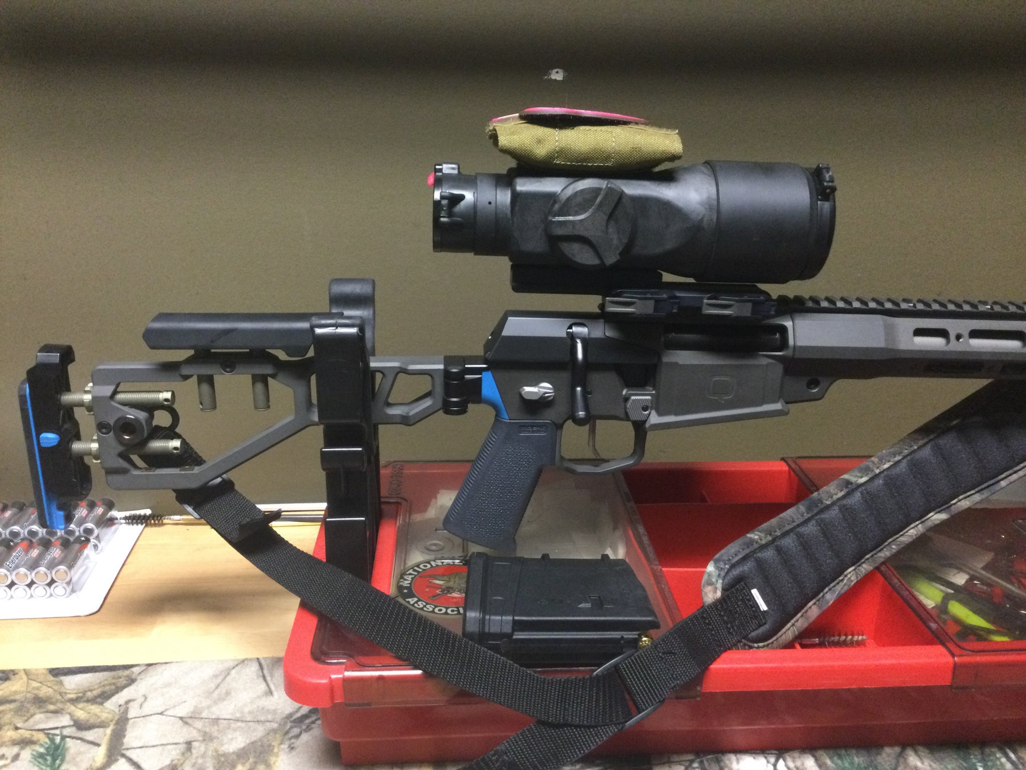

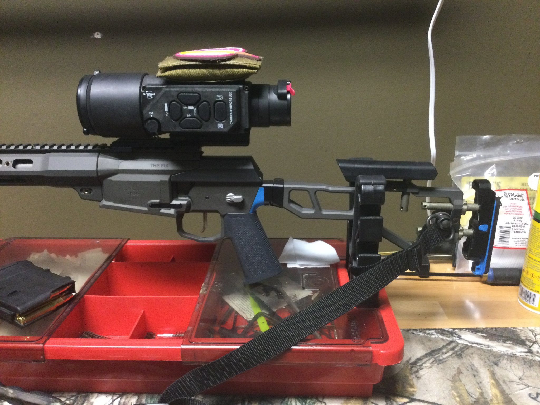

View attachment 7677191View attachment 7677186

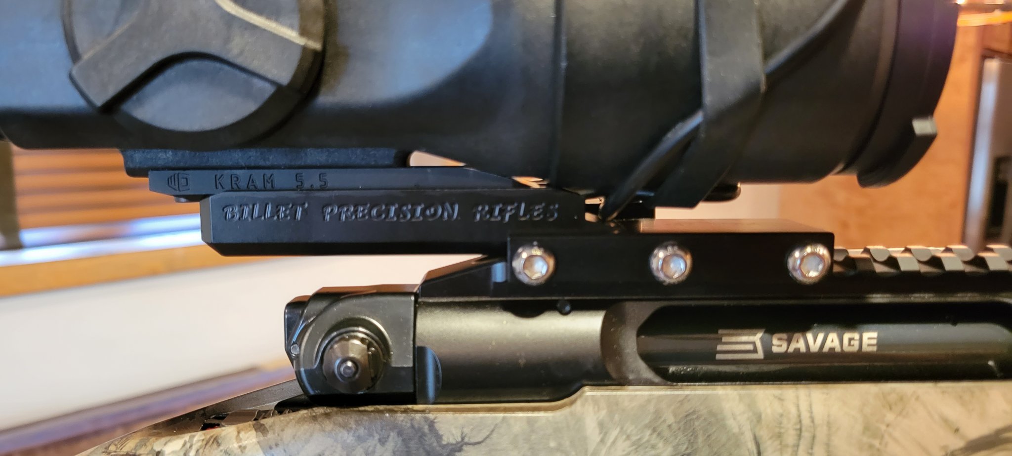

Try the billet precision mount with a kram spacer. I had to file the front of the spacer to get the most out of it with my halo LR. I have the -20 moa version since my action has an integrated 20 moa rail.
