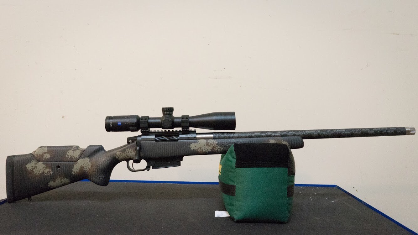

I recently built a 6.5 for hunting, but wanted it to feel like my match gun. So the turrets and Manners stock add a bit of weight.
Honestly it seems people don’t always include everything like scope caps, sling, brake and bipods when talking about the weight of their hunting ring. Most turreted scopes, rings, bases, caps, bipods and slings add about 3-4 lbs to a base rifle.
This one is about 12 lbs with bipod, sling, mag, scope caps, full length arca rail— everything.
I used a Proof because it actually can double as a field gun for a match if the hiking is long. A Bartlien steel barrel can weigh less than my 22” proof but it is not as stable in a match type setting.
I could have saved a couple lbs by going 100% hunting and a SS penciled barrel, but I just don’t shoot as well or feel as comfortable as something in a similar footprint that I use thousands of rounds a year with

This is about exactly what I had in mind. What did it cost to put this together?

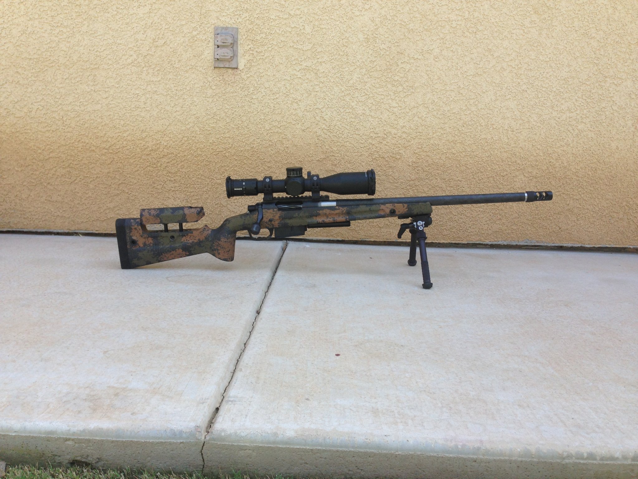

I have a similar build as Diver and the others.
22" 7.5tw 6.5 Creedmoor on a Stiller Tac30 in a Manners PRS2 with a barricade mini- chassis.
12.5lbs as is but might try and lighten it up a little bit more if I hunt this year. I also have an extra 6.5cm barrel (24" rem/varm. Bartlein) to save some life of the proof and it adds an additional 2lb.
Shoot idk everything on all our rifles is pricy. I’ll put a list together tomorrow.

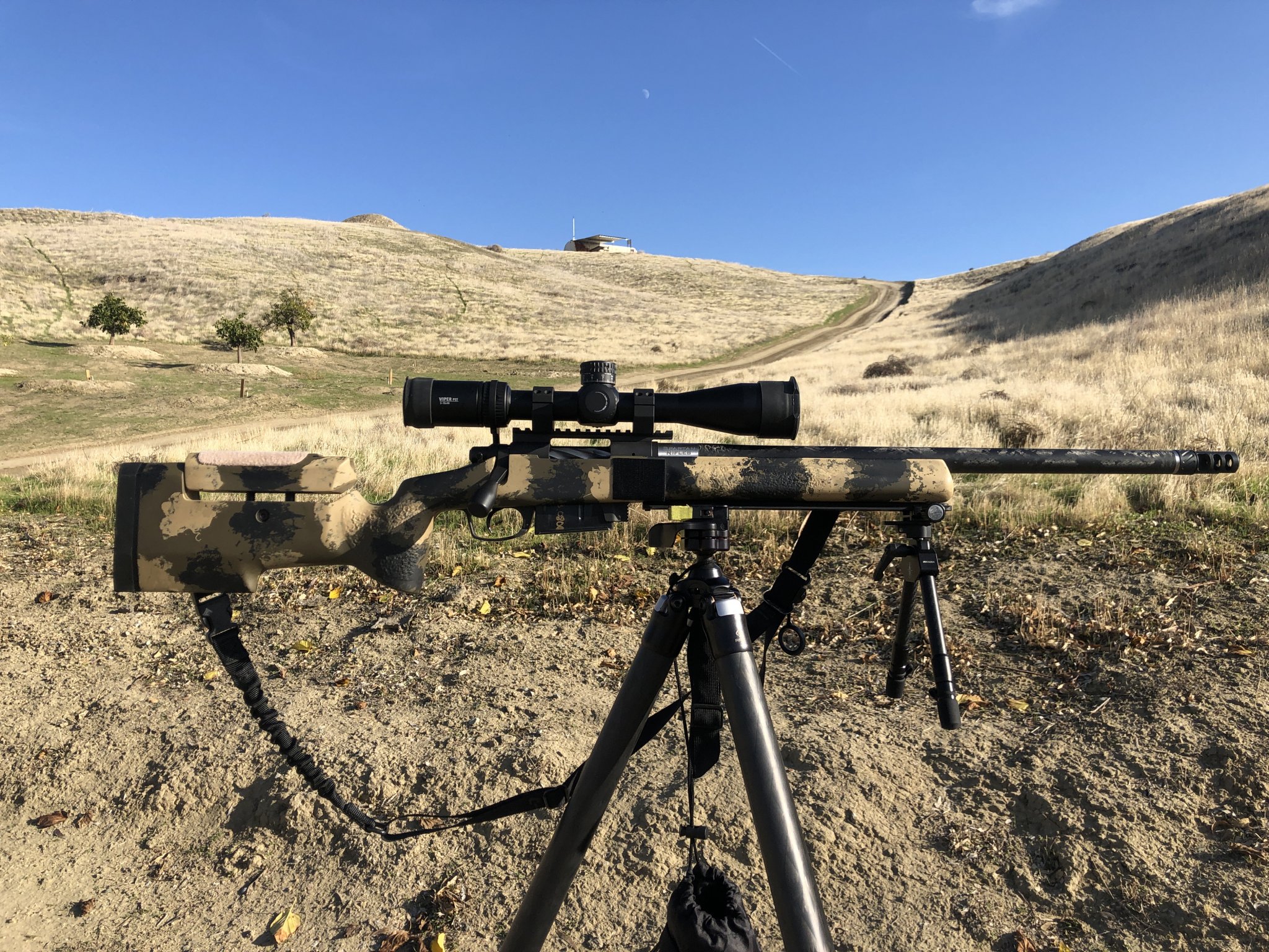

What kind of tripod is that?
Really Right Stuff Anvil 30
