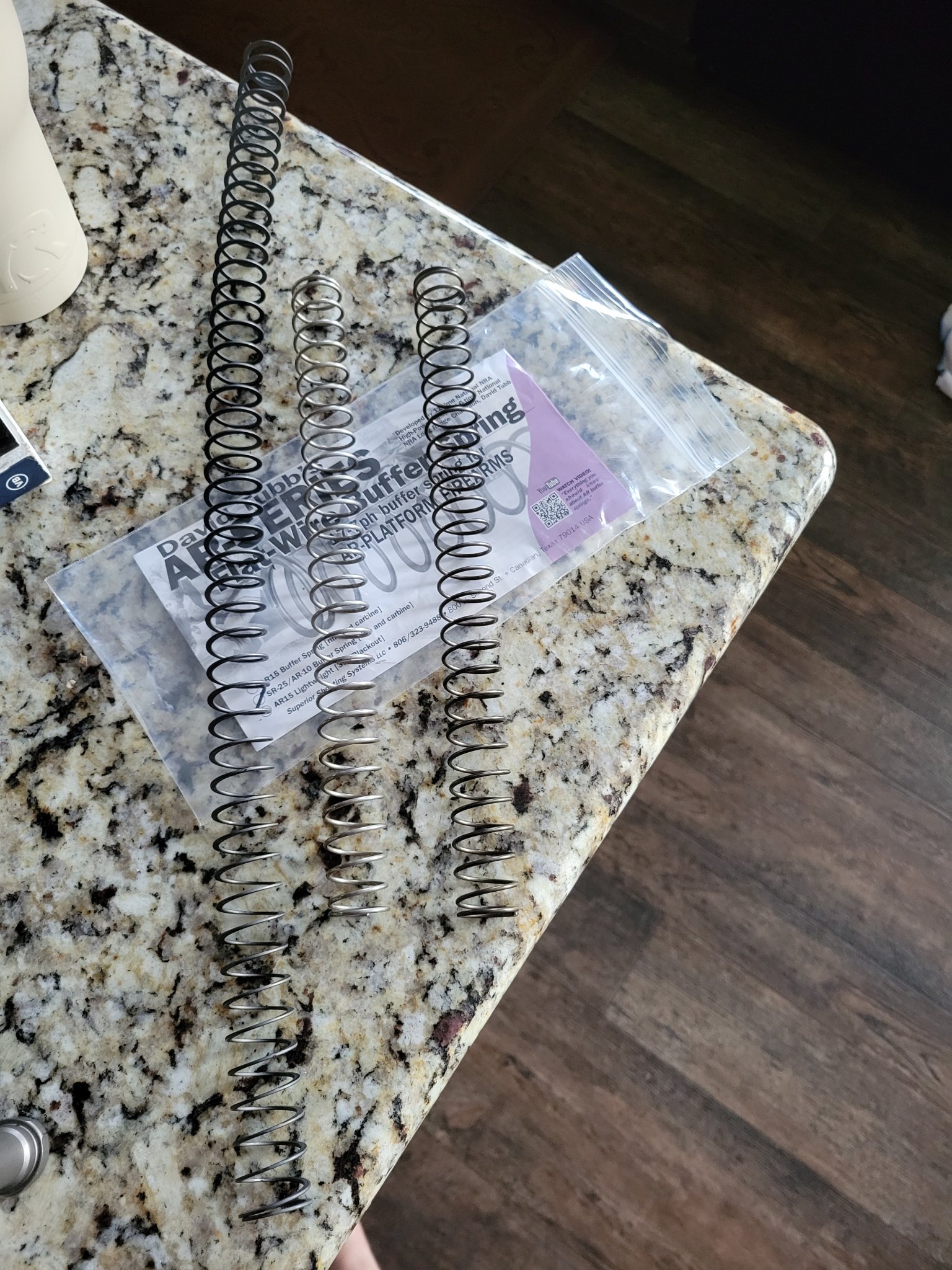

PWS factory spring on the right, heavy spring from slash in the middle, Tubbs on the left. You wouldn't think you could get all that stuffed in a carbine length tube but it all goes in there lol.

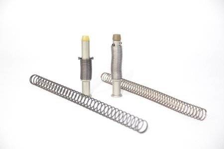

Cut and paste from another threads response...
@Quietguy88
I use the 308 Tubbs Flatwire in all my large Frame AR's .
6.5CM, .308.... various barrel lengths from 14.5", 16", 18", 20", 22".... various gas system lengths ( middie and rifle length ) various gas port sizes.
With DPMS and Armalite carbine pattern stocks , and A2 rifle length stock setups..
And Adj. GB's on every large frame firearm ( SLR's opened 6 clicks from closed of the available 15 )
And heavy buffers in all stock patterns....( again all with the Tubbs .308 flatwire in all patterns )
DPMS Carbine pattern , KAK 2.5" 5.3oz
Armalite Carbine pattern 3.25" 5.4oz
Rifle A2 KAK 9.3oz 308 length rifle buffer
And All function great.... ( Even with the short PSA / DPMS gas tube in all nine uppers, Lol )
FWIW... I tried all sorts of other recoil springs and buffer weights prior to falling for the 308 Tubbs and heavy for stock setup buffer weights.
Every applicable Sprinco... ( the red and orange seriously slammed the BCG in to battery hard, and caused noticable muzzle dip. )
I even use a 308 Tubbs in my 9MM Colt pattern blowback AR, with 7.5ish oz buffer weight.... that application dramatically changed the "vigorious" cycling of the 9MM blowback. I have said this before... the 308 Tubbs in the 9MM blowback changed cycling from Linda Blair in the Exorcist,.... to a consistent smooth functioning Winnie the Pooh.
AR15 version on a rifle length buffer.
These measurements help for us mechanically minded folk...
Handy chart... ultimately, the 308 Tubbs holds the BCG "closed" milli-seconds longer ( easier on the brass rim during extraction since the chamber pressure is slightly lower from the milli-second delay. While retaining a "sane" open poundage... ( allowing moderate cycling, without slamming )
A2 (old) - 7.6lb closed, 14.5lb open
A2 (new) - 9.1lb closed, 16.7lb open
Tubb Flatwire - 10.5lb closed, 16.3lb open
Tubb .308 Flatwire - 13lb closed, 16.7lb open
SpringCo White ? (standard) - 8.3lb closed, 16.3lb open
SpringCo Red (extra) - 10.5lb closed, 18.4lb open
SpringCo Orange (increased) - 13.9lb closed, 24.8lb open
A few videos , from David Tubbs... he explains better than I can.
David Tubbs weight measurement video..
Believe David Tubbs or not... but for me the Tubbs Flatwires impressed me enough to use them in all my AR's
The only drawback I have heard, and for some people, is, the Flatwires don't smoothly insert or come out like a round wire spring. The difference is negligible to me... but some people have complained about it... so just sayin'
I hope some of this helps.

Who or what company is an expert AR Gunsmith that I can send my AR10 to make it run like a sewing machine?
It doesn't want to feed smoothly
Scratches up the brass upon feeding
Doesn't want to lock up bolt in the chamber without it being oiled to heck.
*have magpul and lancer mags
Have a ton of money tied up in AR10 6.5CM Build.
Mega Matched Receiver Set
BSF CF 16.5"
JP Silent Spring
Trigger Tech Diamond
JP LMOS BCG
Ti misc parts
Superlative Arms adjustable gas block
Wilson Combat handguard

Cycling and Feeding Perfectly now.
And yes even suppressed
With yall advice I made these 2 changes.
TUBBS Spring
Kynshot Hydraulic AR10 Buffer
Liked this setup so much I ordered Tubbs Spring and Kynshot High Pressure AR15 Hydraulic buffer for my 6.8 SPC pistol.
Thanks again to my Brothers on the Hide for all your advice.
TUBBS Spring

Any of the more knowledgeable guys here know who besides Tubb makes a carrier weight system ?
Slash's Heavy Buffers. and for the 308 carbine short 2.5" 5.3oz buffer, there's KAK, and even Primary Arms Expo and Midway AR-Stoner getting in on the act. probably a few others also.
ETA: didn't know you guys were talking about a whiz-bang high-tech proprietary system. Please excuse my ignorance.
Reactions: sinister
I've got the heavy buffers. Done a lot with slash buffers in full auto m16 variants. I love slash buffers.
And the heavy Kak and XH work with the 308 "difficult" ammo lots except the Hornady ELDM 168. In an earlier post here, I posted Hornady created an AR version of the ammo, that I had yet to try.
I thought the CWS was discontinued some time ago. Unless it was brought back.
I have contemplated a 6.5oz heavy buffer and tubb spring.. but, the kynshot is still working.
Glad you ironed everything out. Enjoy shooting.
I haven't seen any other "drop in" CWS versions over all these years. I even asked David Tubbs if he could make a limited run again, and he said not likely.
