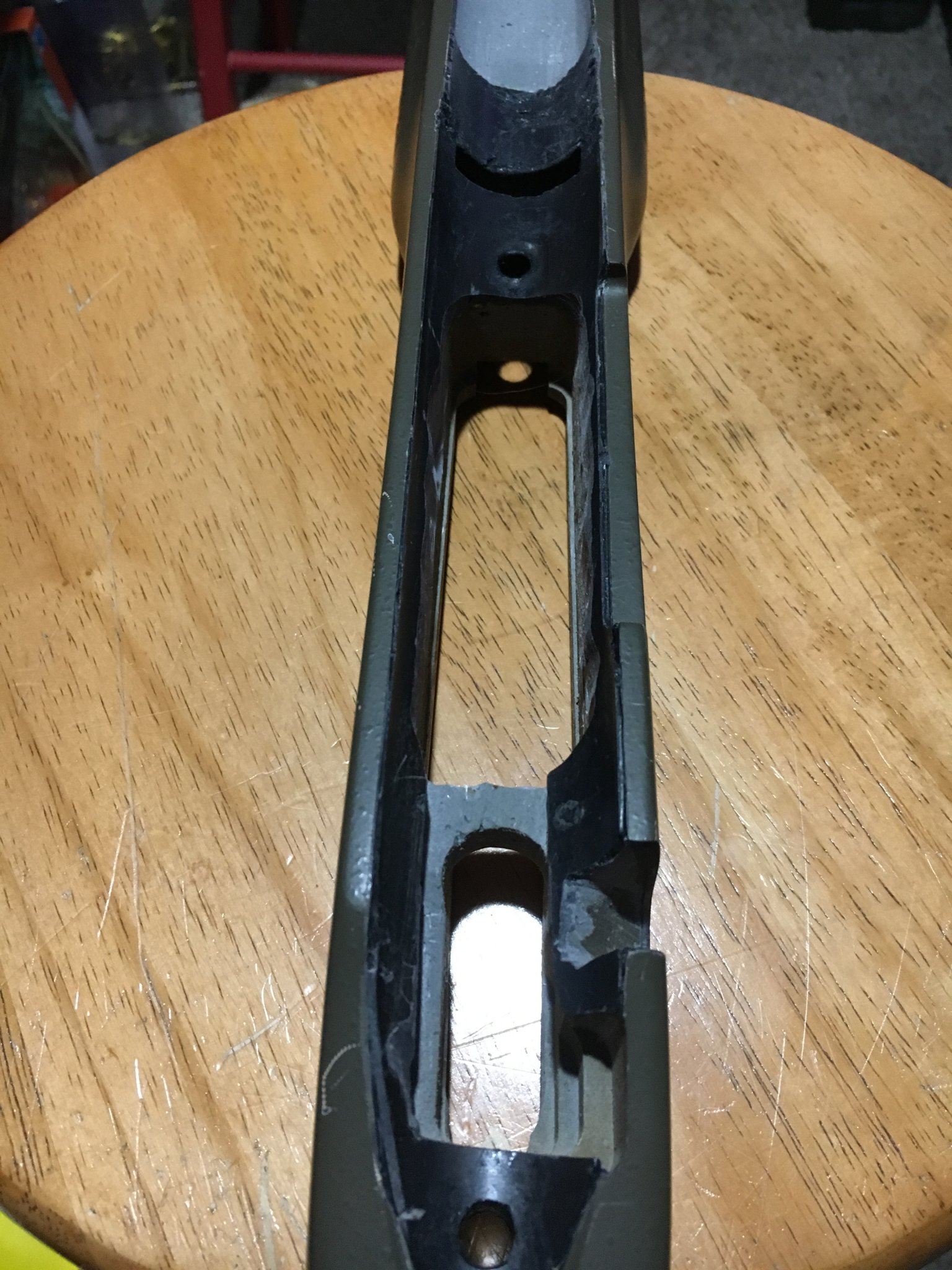

Not bad for my first time, it’s definitely not the prettiest but it did work for the most part. It did stick to the barrel for some reason I know I covered it pretty well but it still stuck so I had to sand that off. I’ll throw up some pics in a little bit

I have a 26inch barrel and I covered at least 25 inch’s of that haha. I tapped the entire stock just because I knew it was going to be messy with it being my first time. I think I screwed up when I but the compound in the stock, I didn’t put enough in there so I pulled the action back out and packed a bunch more in and then set the action back in. When I bought the stock (used) it already had a bedding job done to it. it looked like jb weld and it had air bubbles everywhere, so after grinding all that out there was a large area that had to be filled by the compound. Not trying to make excuses but I don’t think it came out to bad all things considered. Yea my nice stainless barrel is a little jacked up nothing a little cerakote can’t fix, and that’s already going to be taking care of by a member on here (BigRso) he’s done really good work for me in the past. I really appreciate everyone weighing in on the matter, I can’t wait to try in again with some different techniques.

Looks better than I thought it would judging by your hurry to get it done.
