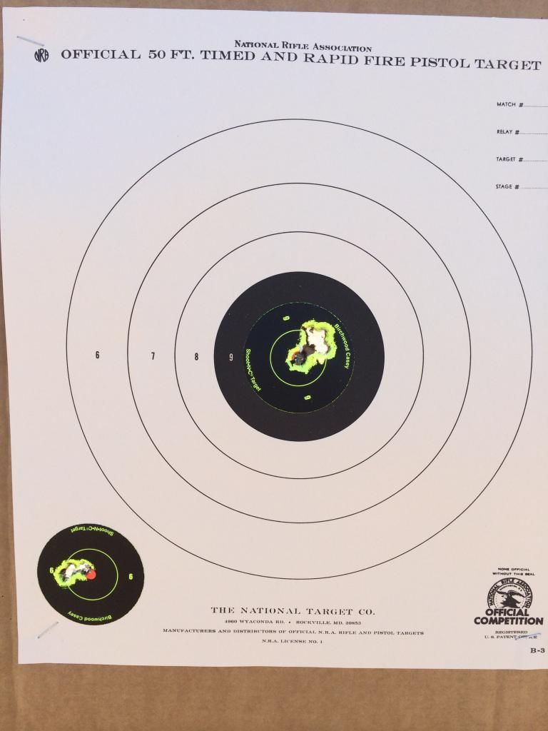

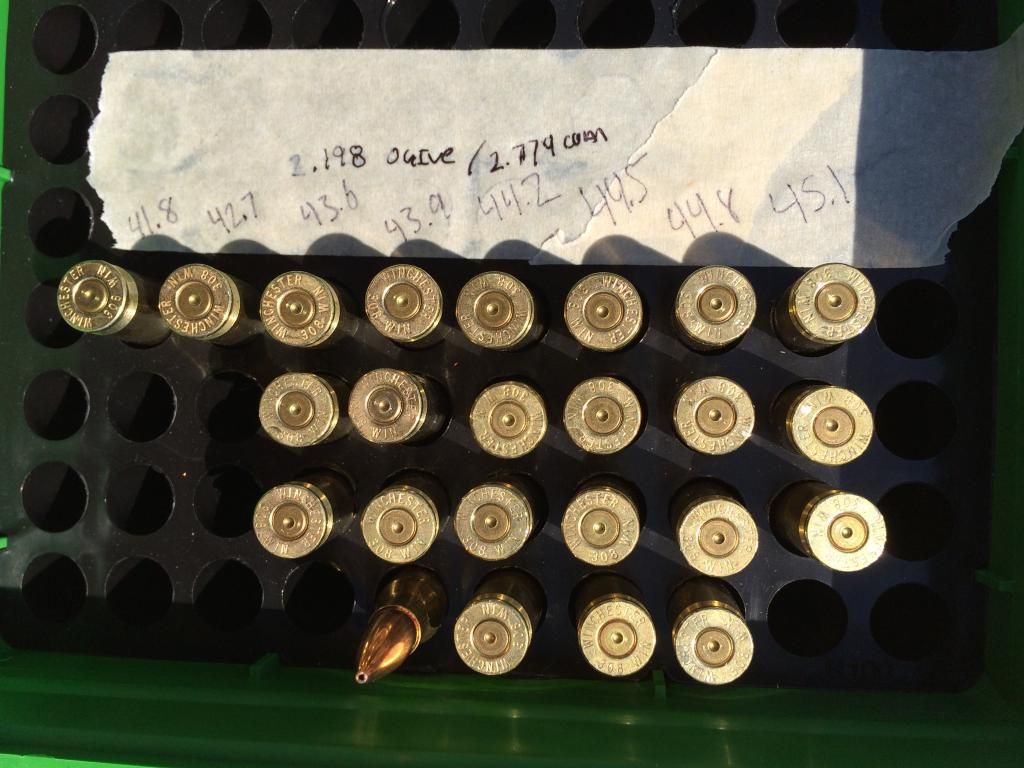

So went and shot a OCW today with the COAL of 2.774. No pressure signs with the near max and max load.
Here are some pictures:
Here is how it shot 168smk FGMM (10 shots in the big target) and 175smk Southwest ammo (3-shots on the botton) without any pressure signs. These were 2.795 COAL and there were no problem with extracting a live rounds.
Overall, I think this Bisley Chamber is going to be great from the groups I've seen. I'm going to try to find a load and stretch it out to further distances to see how it performs.
