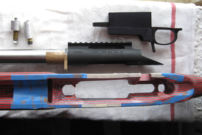

I just bedded a Provarmint. Hog out the action screw holes, mask it off, and glue it back in with the barrel taped-up to center in the channel.
I live about 8 hours' drive from DFW.
I did install aluminum pillars, they're in the pic I posted; top left. I set the pillar height so that the magazines work and the receiver and DBM are all square and the whole business floats in the stock inlet a little but centers on the barrel channel. Glue it into the stock and wait. Trim off a bit when it's still "leather-hard" then pop it free when it's good and hard and clean out the rest of the goo where it doesn't belong.
Takes about an afternoon.
Of course if it doesn't fit like it should then maybe a call to Boyds is in order before you go hacking on the stock.
Leave a bit of the material alone from the tang screw rearward. Relieve the rest of the action area so your action sits in bedding compound. I do not use aluminum pilars anymore it has a different expansion ration than steel and can cause action screw torque issues. I use the threaded rod you find in lighting fixtures for my pilar material. I also use the guide screws in my action while bedding. This way I am not causing stress to the action with a point load at the action screw. To do that I use electrical tape to hold the action in the stock while the epoxy cures. I am using west systems epoxy with cab o sil. This relies on the filler for compression strength and reduces shrinkage. Marine tex has the least amount of shrinkage in a matrix only compound. If I didn't use epoxies as much as i do I would use marine tex and call it a day.
