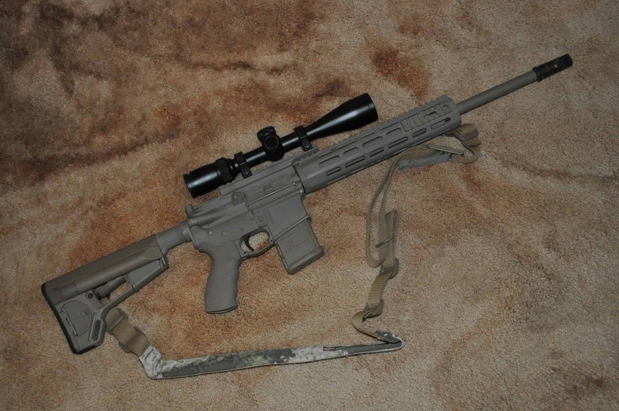

OK, so my little SPR is a low-ball budget rig, but it shoots great out to 600yds with either Nosler or Sierra 77BTHP handloads. I went with a WOA mid-length gas system SPR 1-7tw bbl, which is probably a button rifled Wilson blank contoured, chambered, & finished by WOA. Nothing exotic about the RRA TRO handguard, either. I found a Weaver 20 MOA sloped rail/riser, and mounted a Weaver 3-15x42 SuperSlam in TPS TSR rings. Don't know where the two short picatinney rails at the front of the handguard came from - they were a gift from Gunner75 - but they work fine for anchoring the Vickers Combat Application sling on the left side, and will work fine with a light or whatever else I might need from time to time on the right side.
Point is, the little 1" Weaver gets me out to 600 with no problem, optical quality is fine for this app, it tracks good, is fairly lightweight, and isn't a bit oversized for this rifle. Don't know whether they're still in production, but found this one on sale at Midway for around $350.
