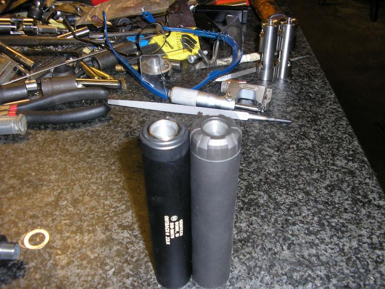

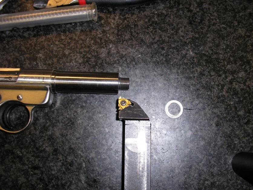

I looked at my Outback II and my Sparrow and both have about 2 threads worth of counterbore(.075 or so deep). Picture taking is one of many things i'm not good at
but here are the two next to each other. The other picture is of the detail on my Ruger MkII. The thread stops about .085 from the shoulder and with .010 worth of shims
the suppressors both will lock up against the shoulder. I threw in the threading tool just because it happened to be laying on the table. I like using shims between the
suppressor and barrel so all the on and off doesn't start digging into the shoulder. The radius on that insert will work down to a 48 pitch thread and the way i calculate
my depth is to take 1 divided by the threads per inch(pitch) X the Cosine of 30 deg, X .75, X 2, and subtract that from the maximum major diameter. With that number
I can either enter it into the program as the final X coordinate in my threading cycle, or i can touch off my threading tool on the manual lathe and zero the dial(or dro)
then turn in the calculated amount and reset my zero. I have found that this is usually very close to where it will finish so start with it backed off about .005 and run it. Then i check the pitch diameter with the pitch micrometer, make the adjustment, and re-cut.
