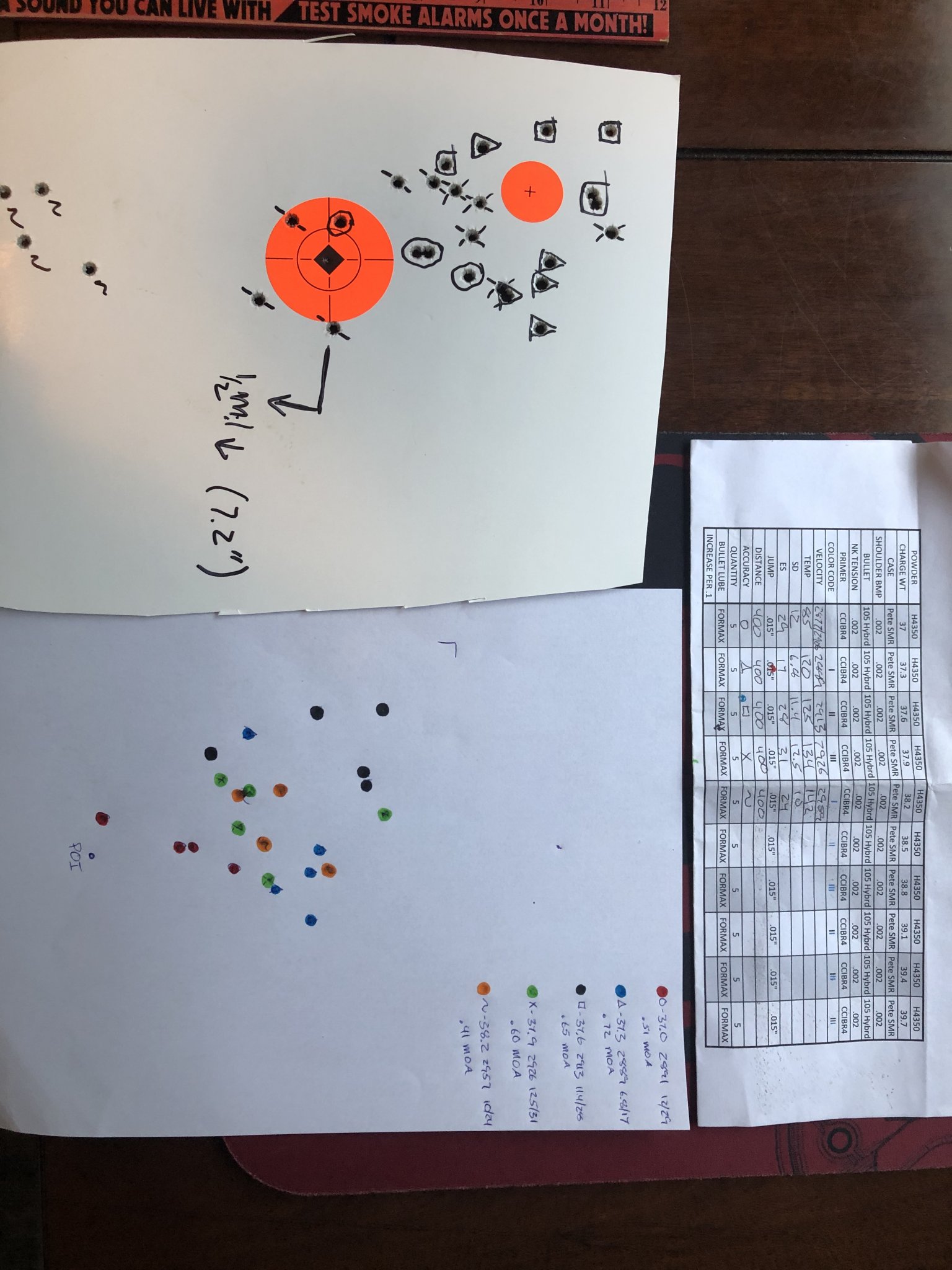

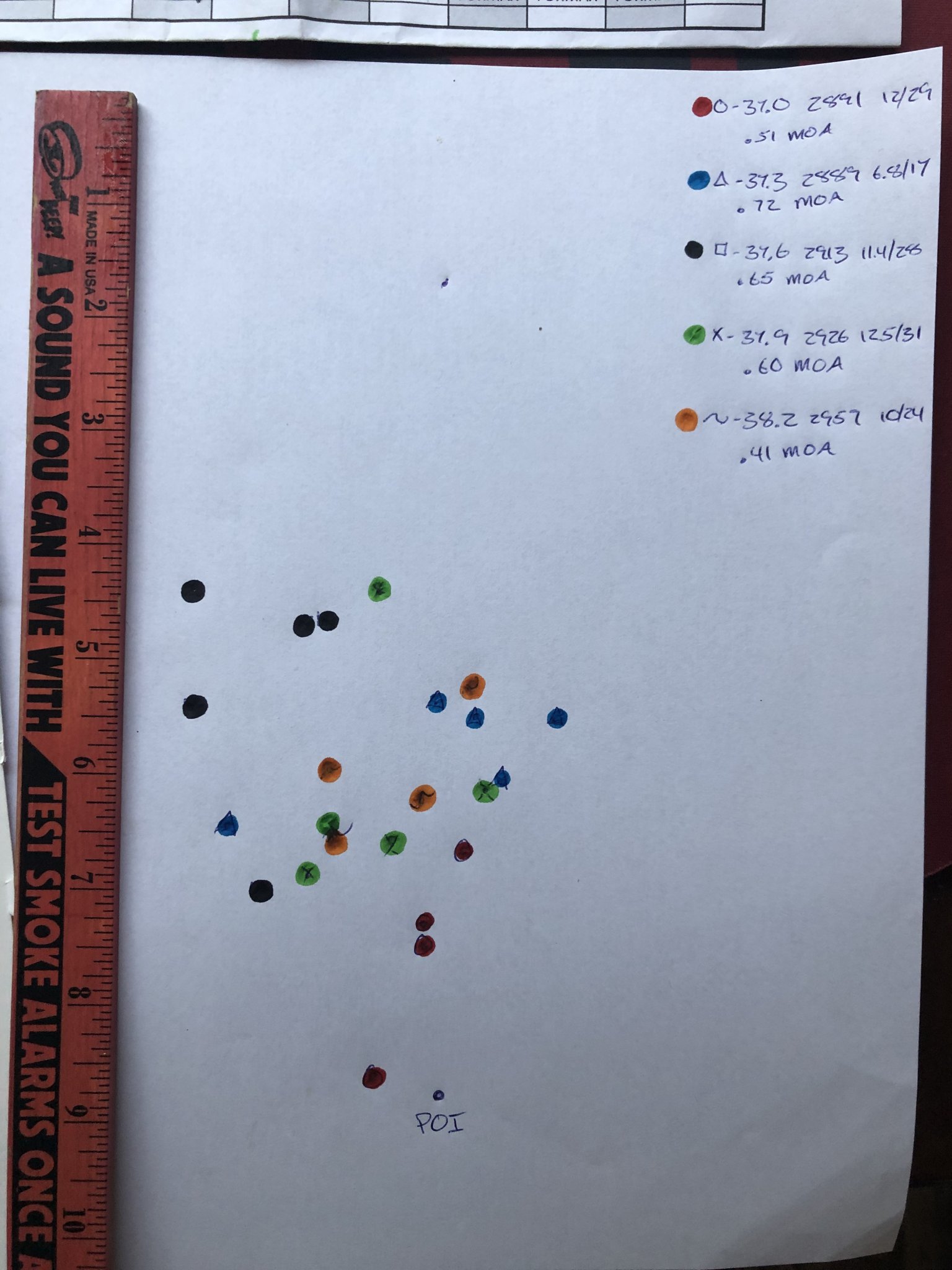

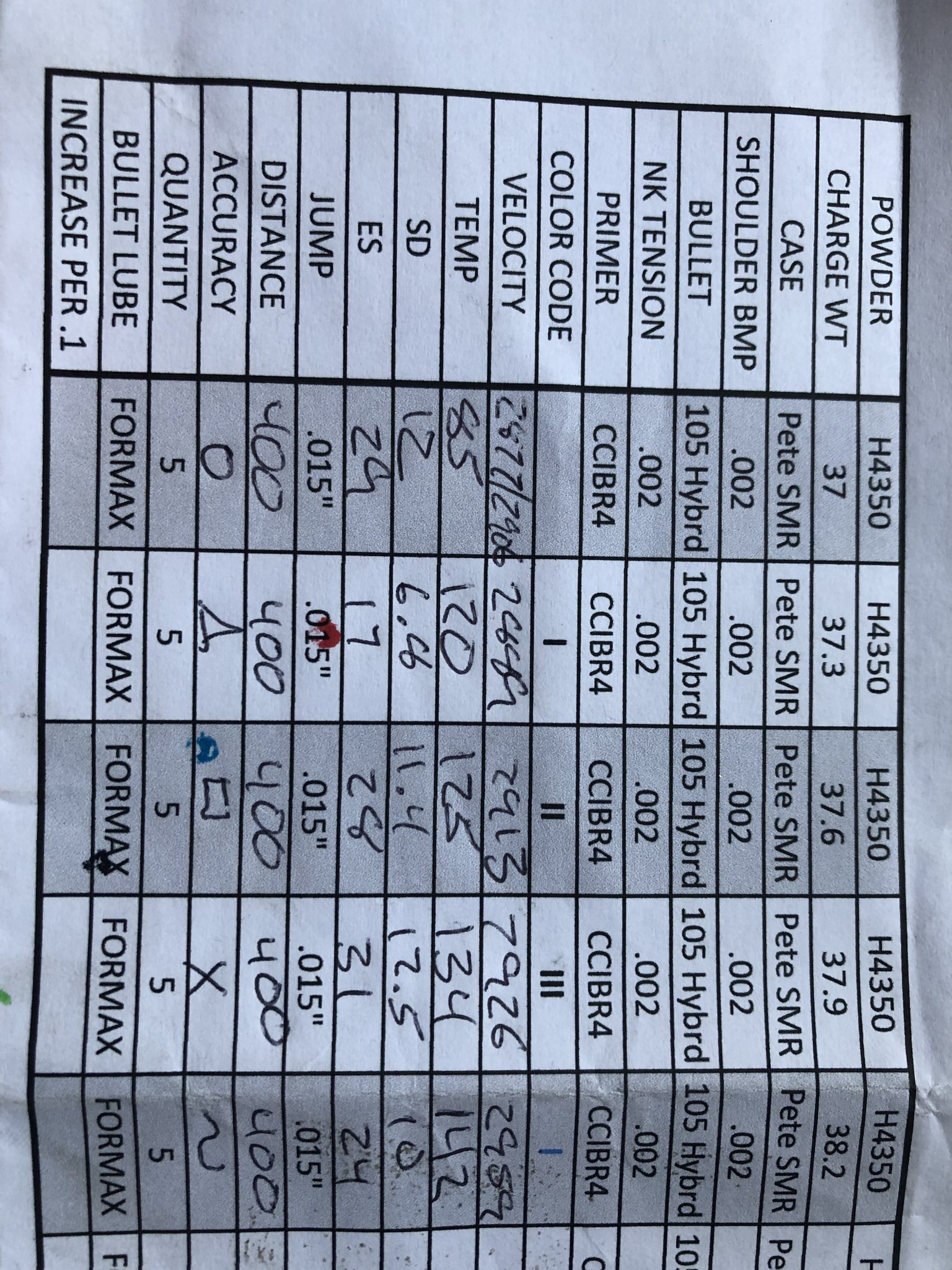

Down-loaded 6mm CM with H4350 & 105 Hybrids. Loads shot faster than anticipated, I’ll pull bullets on what I didn’t shoot and do a few more loads in the 36 - 37.5 region, .2gr increments. Would like to find something in the 2850-2900FPS range.
This was at 400 (longest public range within 2 hours) and I still struggle to get loads to spread out enough to establish anything more than accuracy with a Magnetospeed strapped on the barrel.
Mirage was going pretty decent.
85°-89°

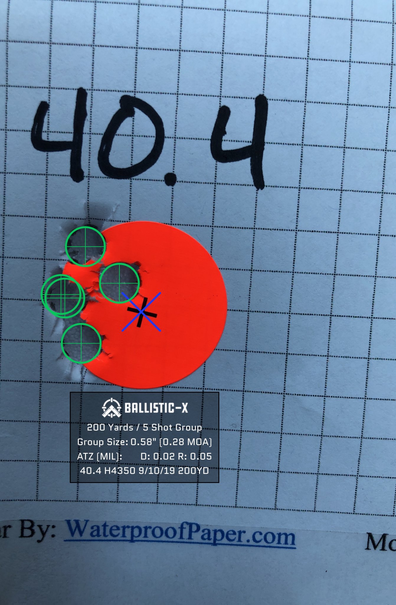

After 2 days of load development, nothing seems to shoot as well or consistent as my old loading of 40.4 @ 3100 FPS
I’ll start saving for a back-up barrel I guess.
