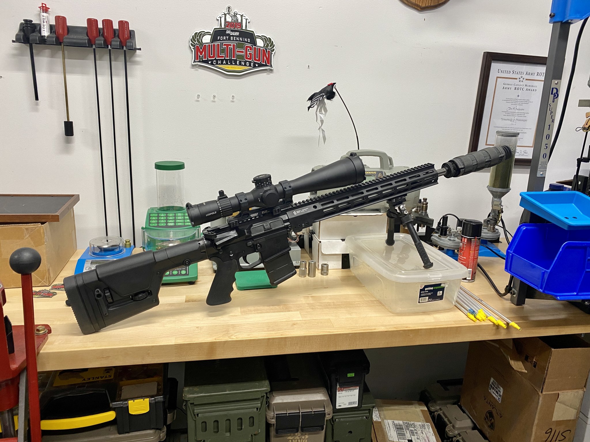

Here is my new 223 Gas gun I built for coyote hunting and some competitive shooting as well. I really like how it’s turned out!
Specs:
Receiver Set: Grey Ghost Precision MKII
Handguard: Geissele MK18
Barrel: Ballistic Advantage SPR Fluted 18”
Trigger: Geissele High Speed NM
Stock: Magpul PRS Gen 3
Buffer Spring: JP Silent Captured
Optics: Leupold MK5 5-25
Optic Mount: Geissele MK5 Mount Suppressor: Silencerco Omega 300
I am looking to do some load development with 55 grain VMAX bullets if anyone has any good recipes. I have TAC and Varget available with CCI 450 primers.

Awesome feedback. Yea I normally load 77 SMKs with TAC and also shoot Atlanta Arms 77s which shoot phenomenal. I was looking at some lighter Varmit loads for hunting. I have some 8208 and also H322 so I can try both. I think I only have 1 pound of each at this point.
I will check the 53 VMAX out for sure!
