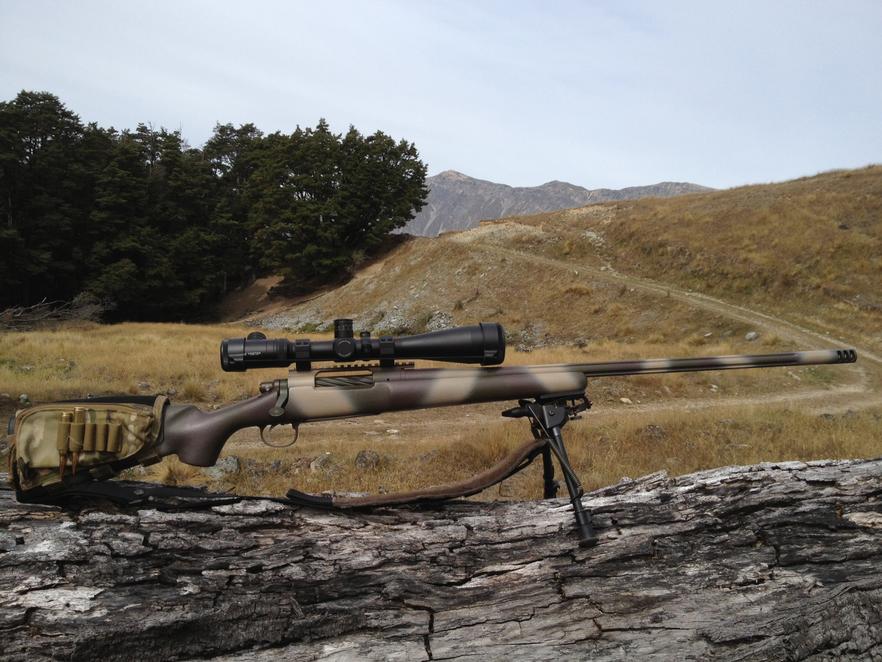

Garvey, nice looking rifle! I have my 7 RM, 27" Broughton barrel which was built by RBros shooting 180 VLD's at 3056 fps with 71 grains of Retumbo, Fed 215 m primers, and Win Brass. My elevation is 4900'. This rifle was also just built for hunting. In fact, I shot a Tahr at 500 yards with it this year in NZ. I have bigger caliber rifles, but this is becoming my favorite, perfect blend of weight and power out to 1k yds.
