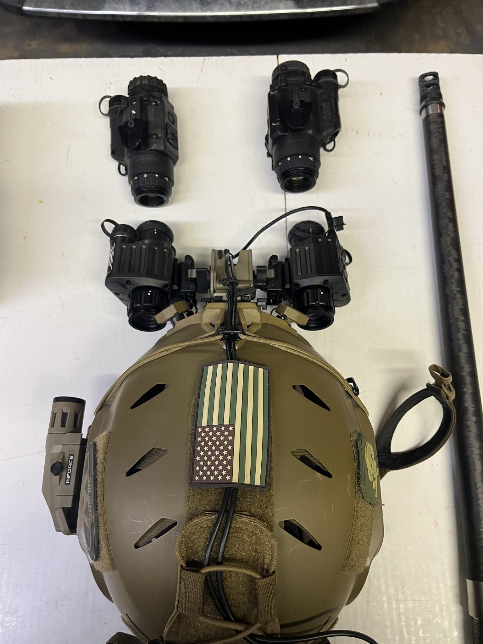

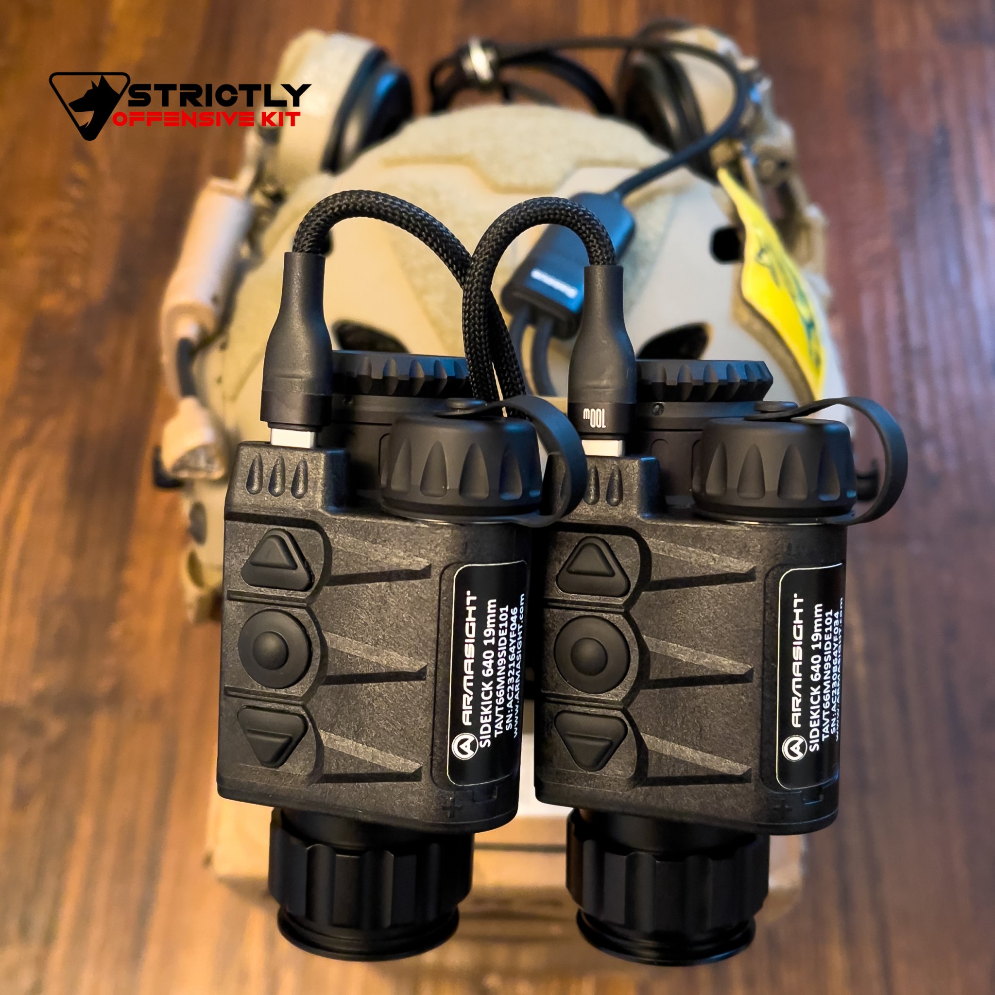

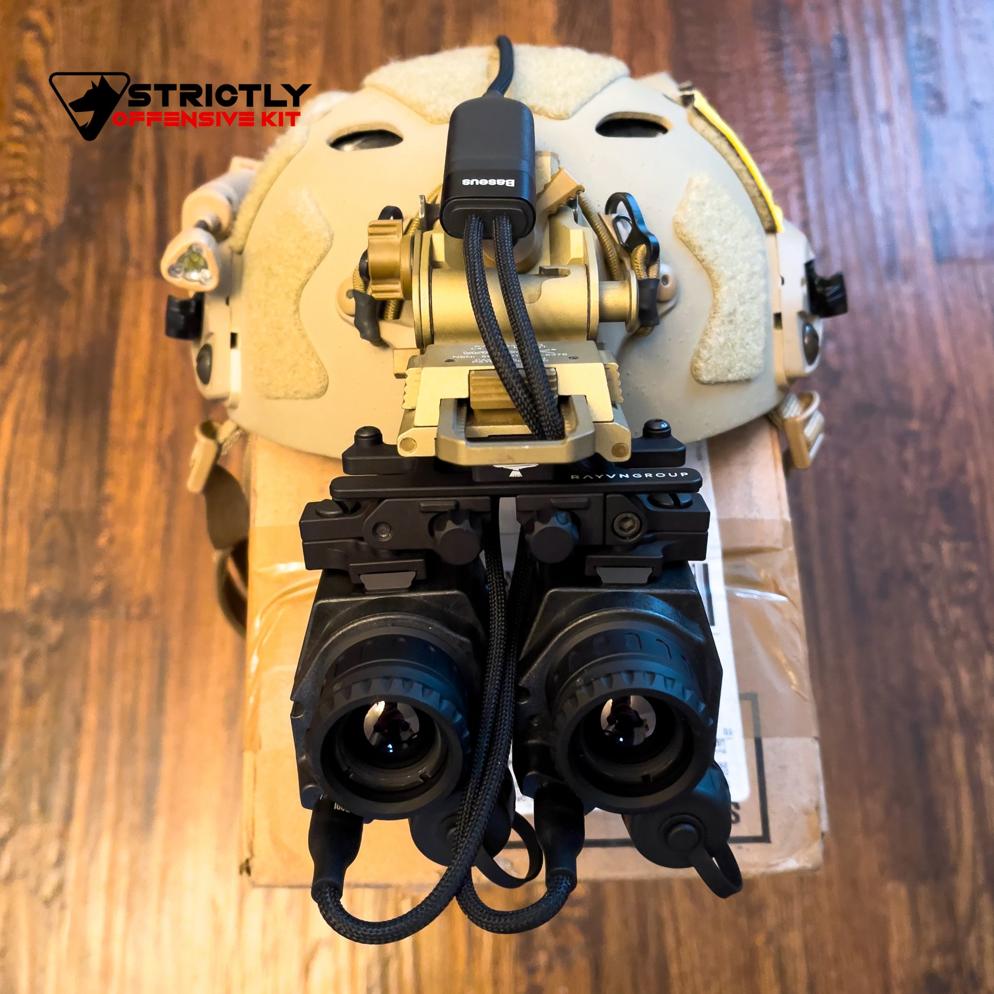

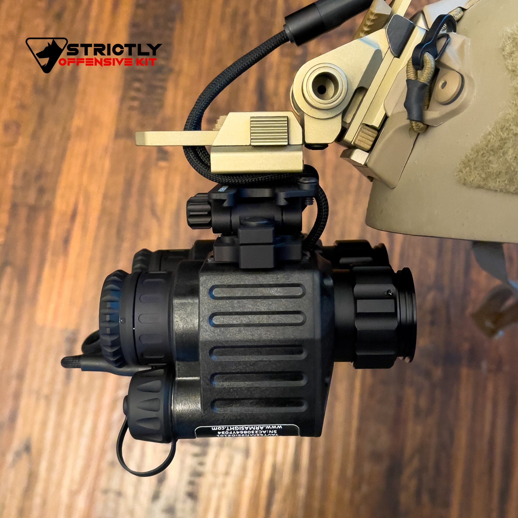

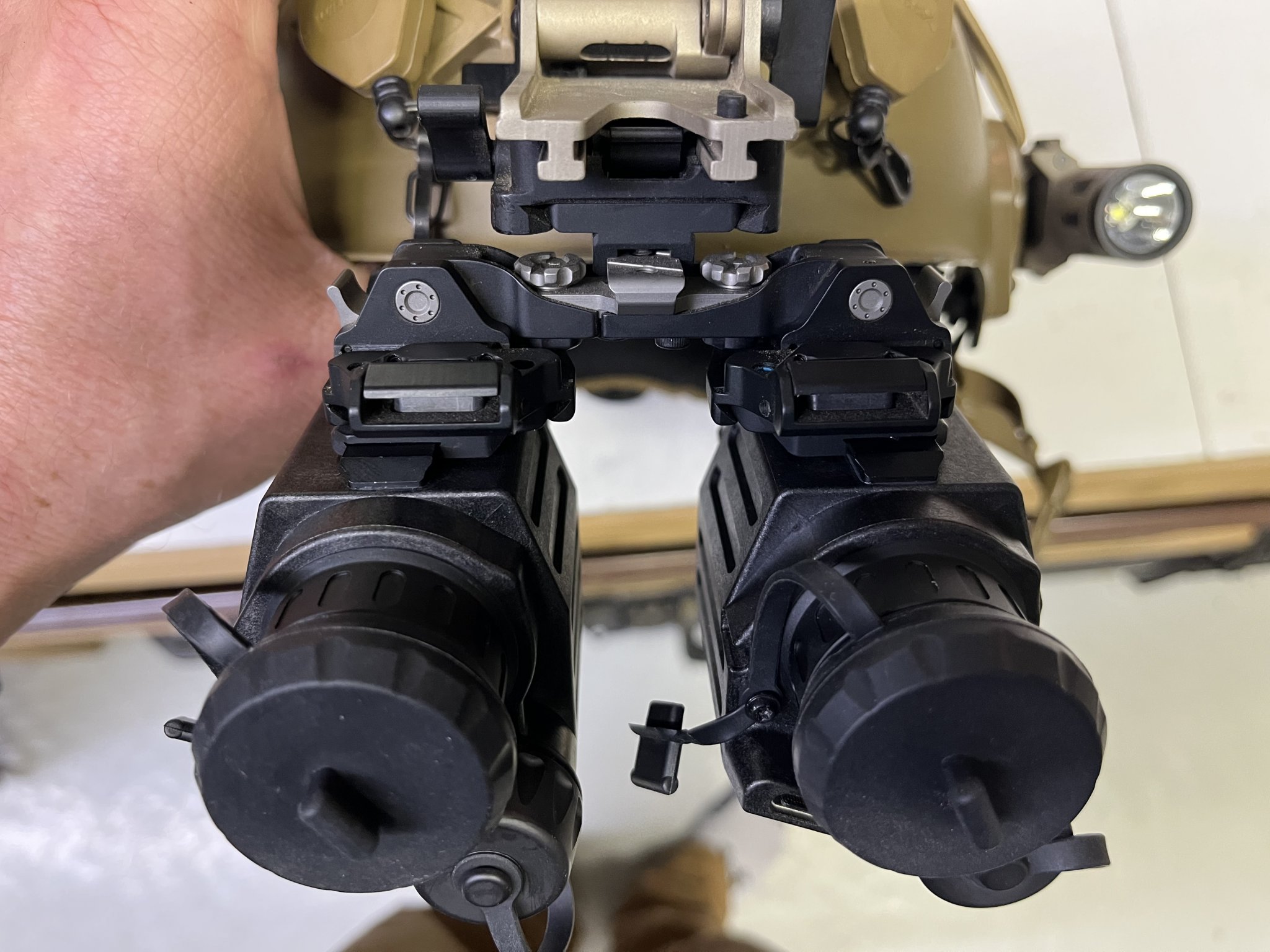

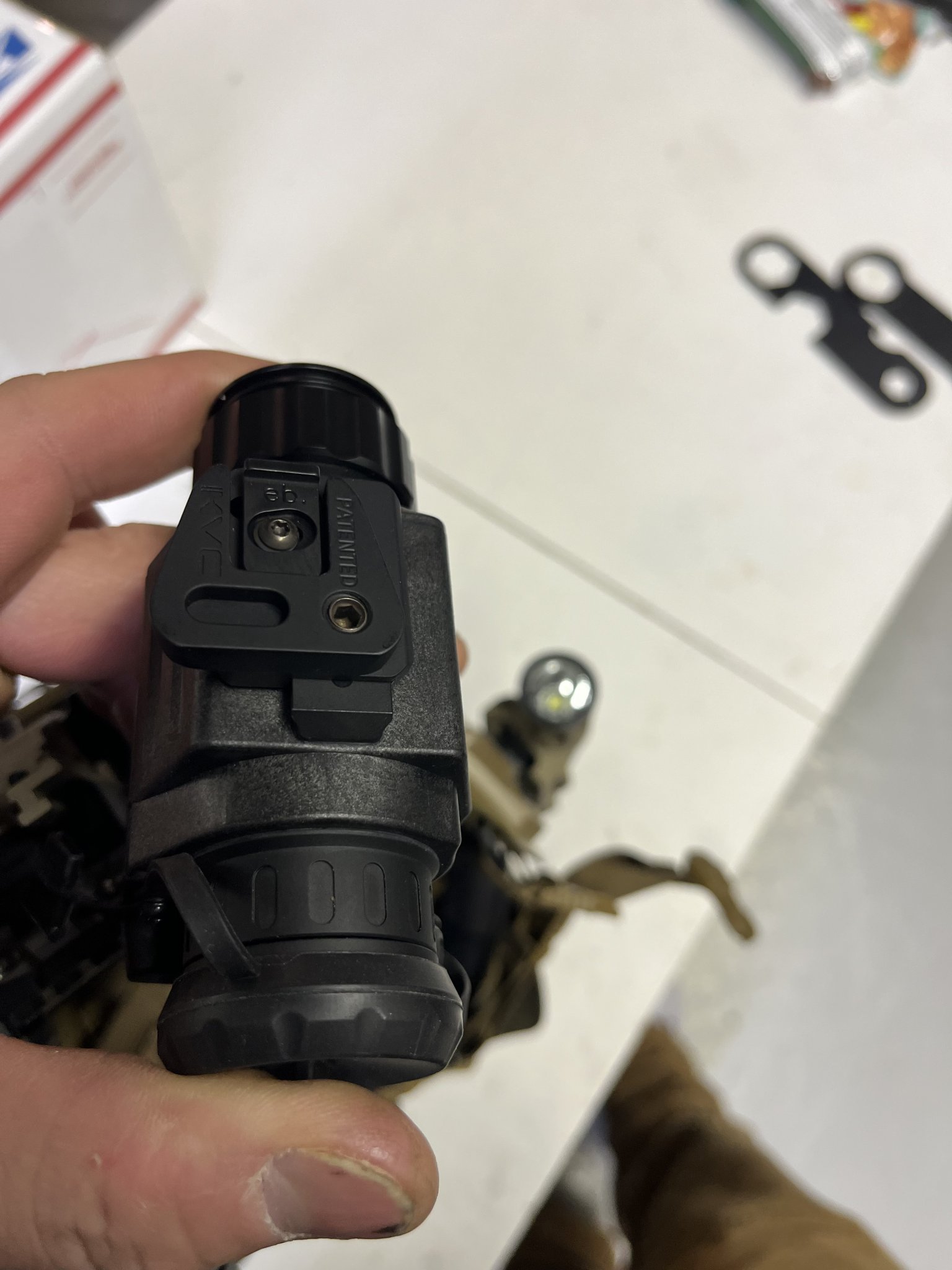

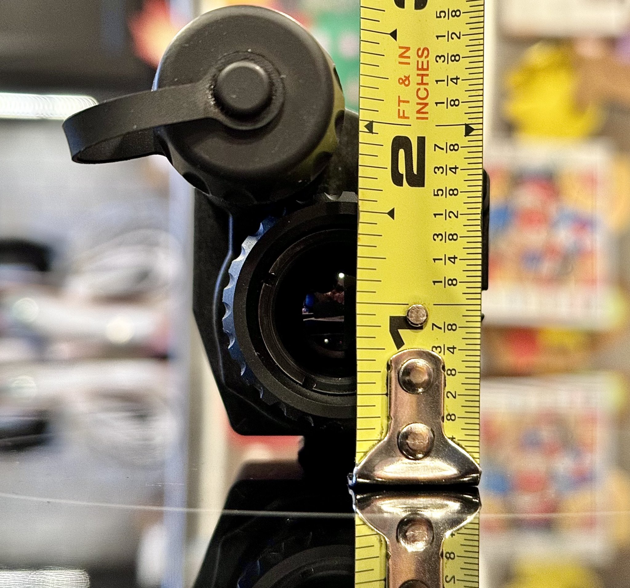

Size comparison to the nox18’s

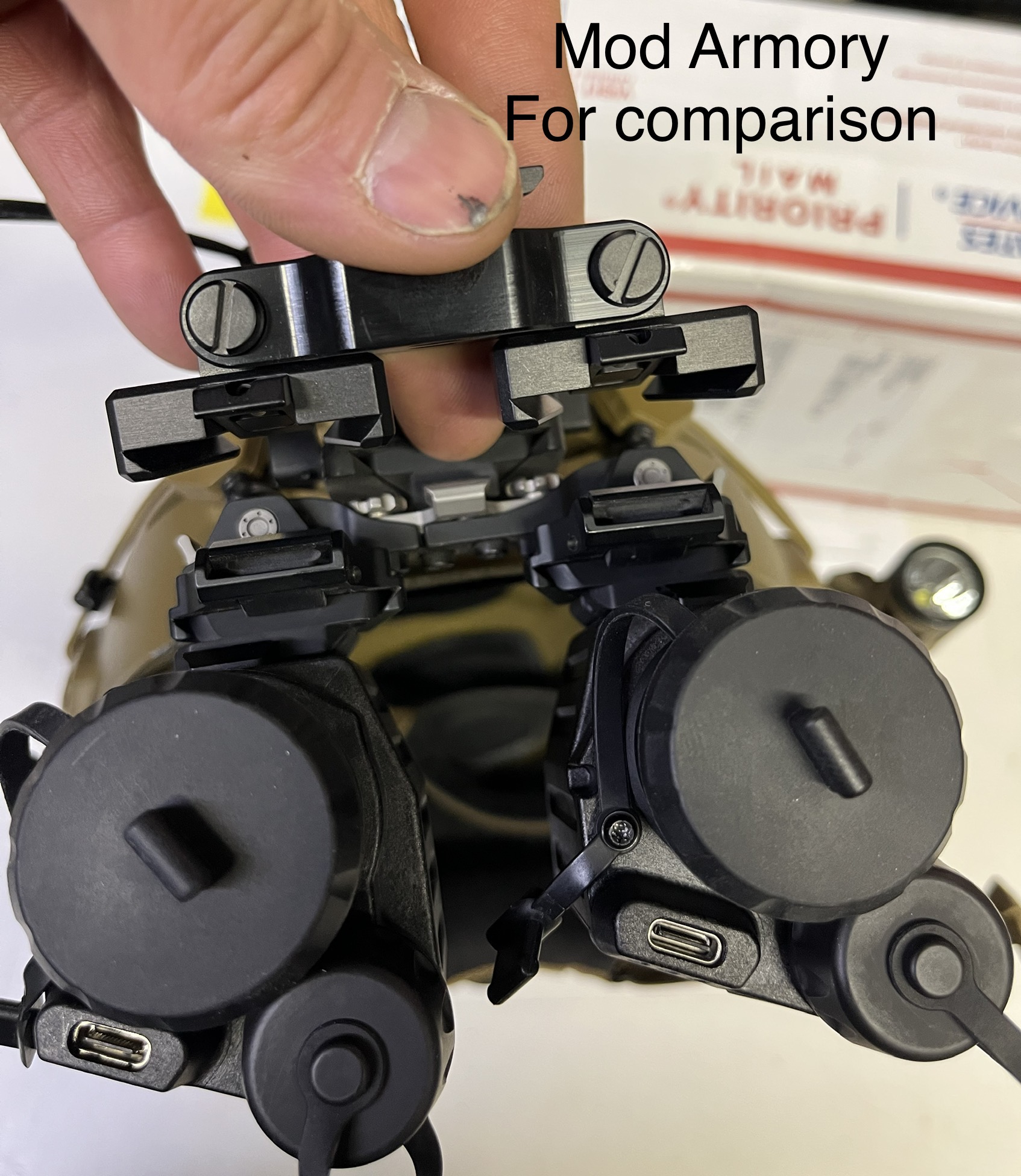

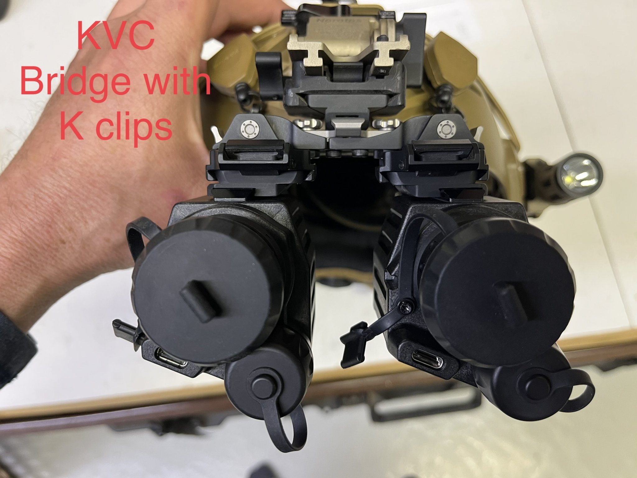

I’m using a KVC bridge and K clips. In one picture I held a mod armory up for comparison.

Note that in all my efforts to mount a breach as a clipon, the mounting solutions that worked for clipon purpose, were not the same as the mounting solutions that worked for head mounting, so going back and forth quickly may be problematic, even if both can be done for the sidekick.
The breach has 3 different mum mounts on 3 sides, so you could leave 2 different mounts on the breach and workish, but having the extra mount on there for the clipon can induce other ergo problems when mounted on the head.
Life is full of tradeoffs.

Sidekick arrived today. Thanks to Wig, Preston, and all the guys at SOK. Wig has been helping me navigate as I dip into the NV/thermal and has been a great help.
I fiddled with it a bit this afternoon, mostly inside, and got it mounted up. I'm running an IC bridge with the MUM dovetail. Sidekick on left, -14 on the right. I had to do some fiddling with the settings to get both devices to align right (understandable), and still may do some more fine tuning. For me, it's just slightly too narrow. An adjustable width bridge might be needed later on to get both to sit just right. As is, I need to slightly cant the Sidekick to get the full screen in view. With this setup, it's useable but maybe not perfectly so. That said, I could adjust the screen margins to get the images to align pretty well for a good fusion effect!
Unfortunately, I have a work trip and have to move my oldest to Waco for grad school in the coming weeks, so I won't have much chance to geek out with the setup for a while, or really delve into all the intricacies. And I'm sure the guys with vastly more knowledge and experience will be putting out more in-depth reviews here shortly. I'll chime in again when I have more time with it if I can add anything worthwhile. And if anyone has any suggestions for tweeking the lateral adjustment on the IC bridge I'd be appreciative.
I was able to get the two Sidekicks mounted up on my, new to me, Panobridge using the Panobridge MUM / Thermal mounts. Much better than the KVC bridge for my face. I had to adjust each screen outboard to a setting of -34 on the left and +34 right. The combined image is excellent! It was just like looking through a pair of binos with respect to the merged image.

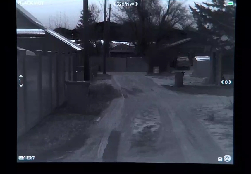

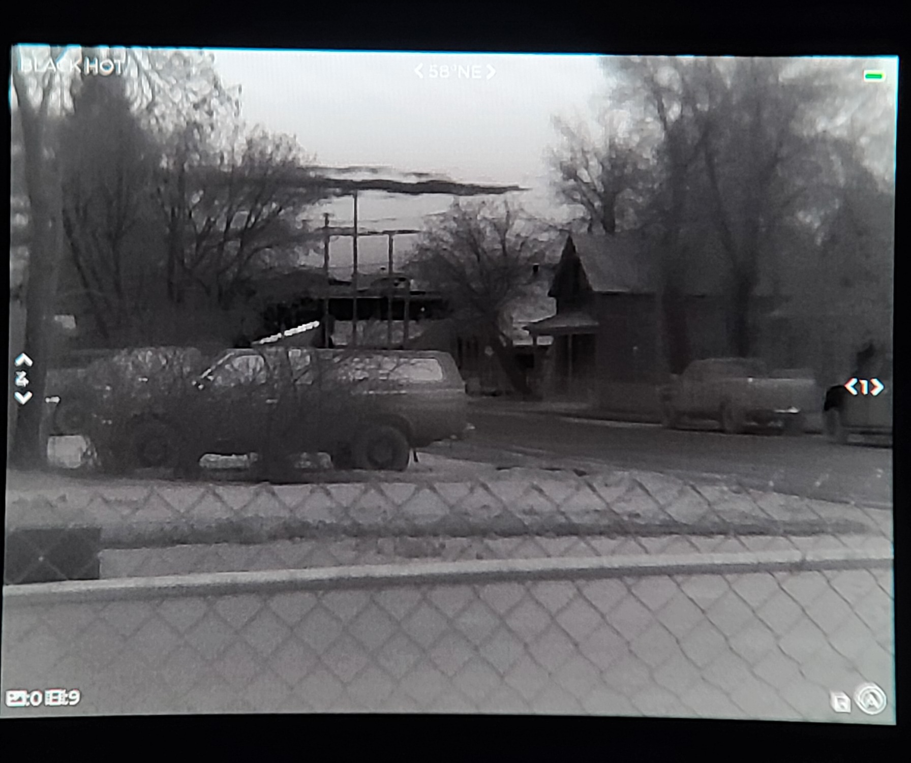

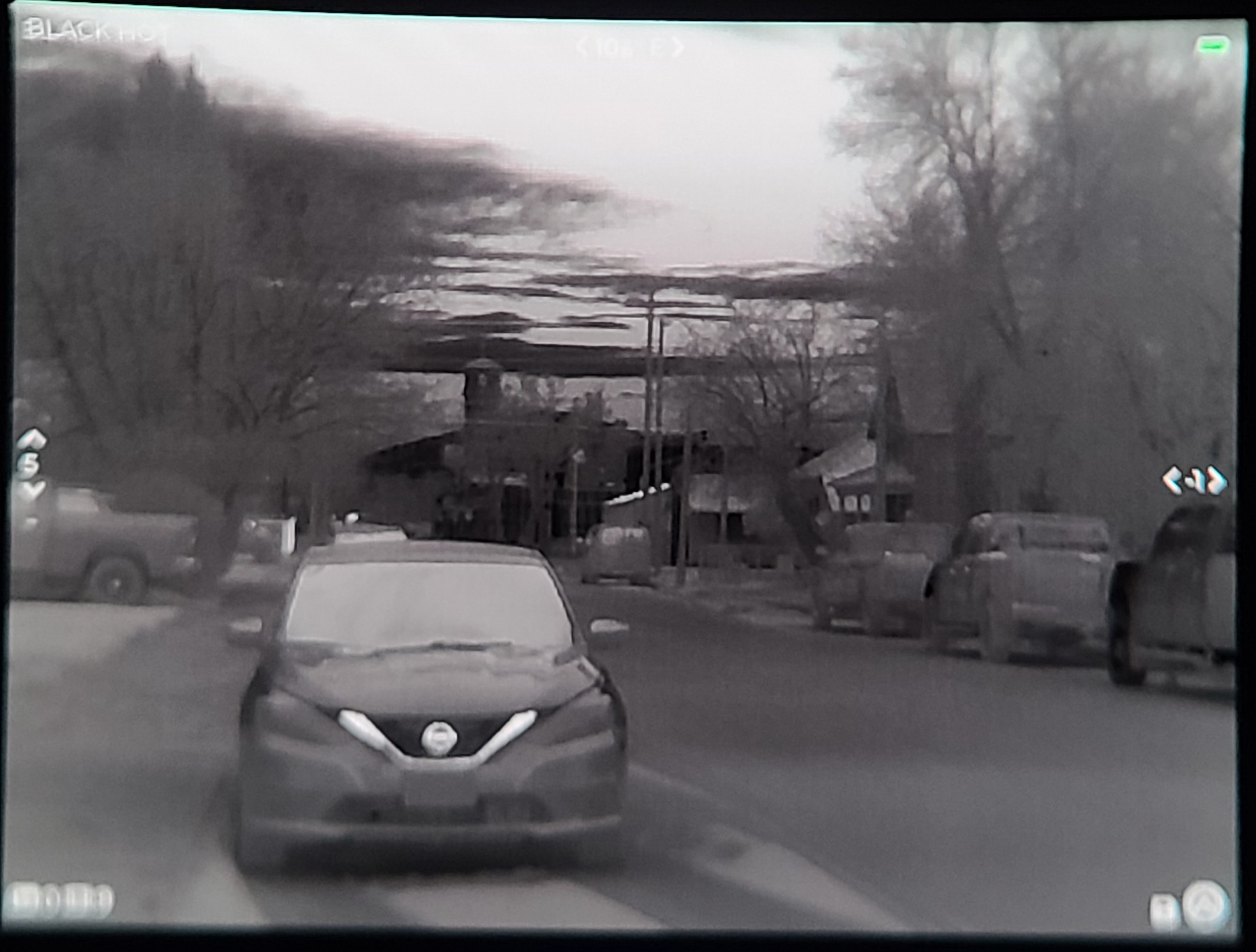

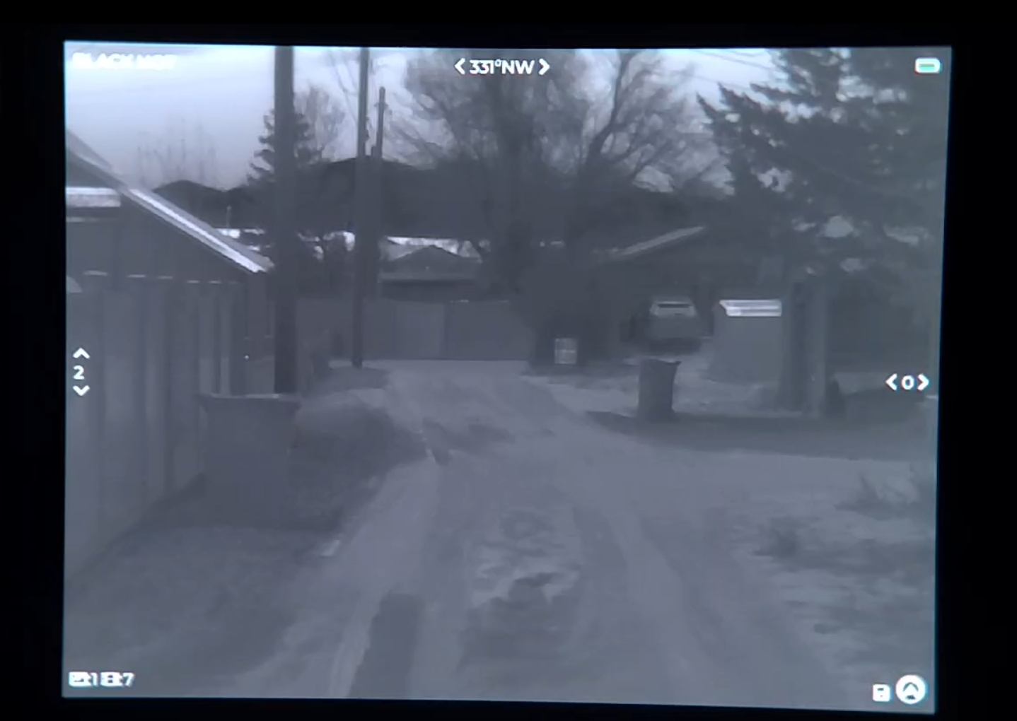

Here's a little sneaky peaky.
Factory settings (lighter image) vs my Settings (more detailed, contrasted settings):
