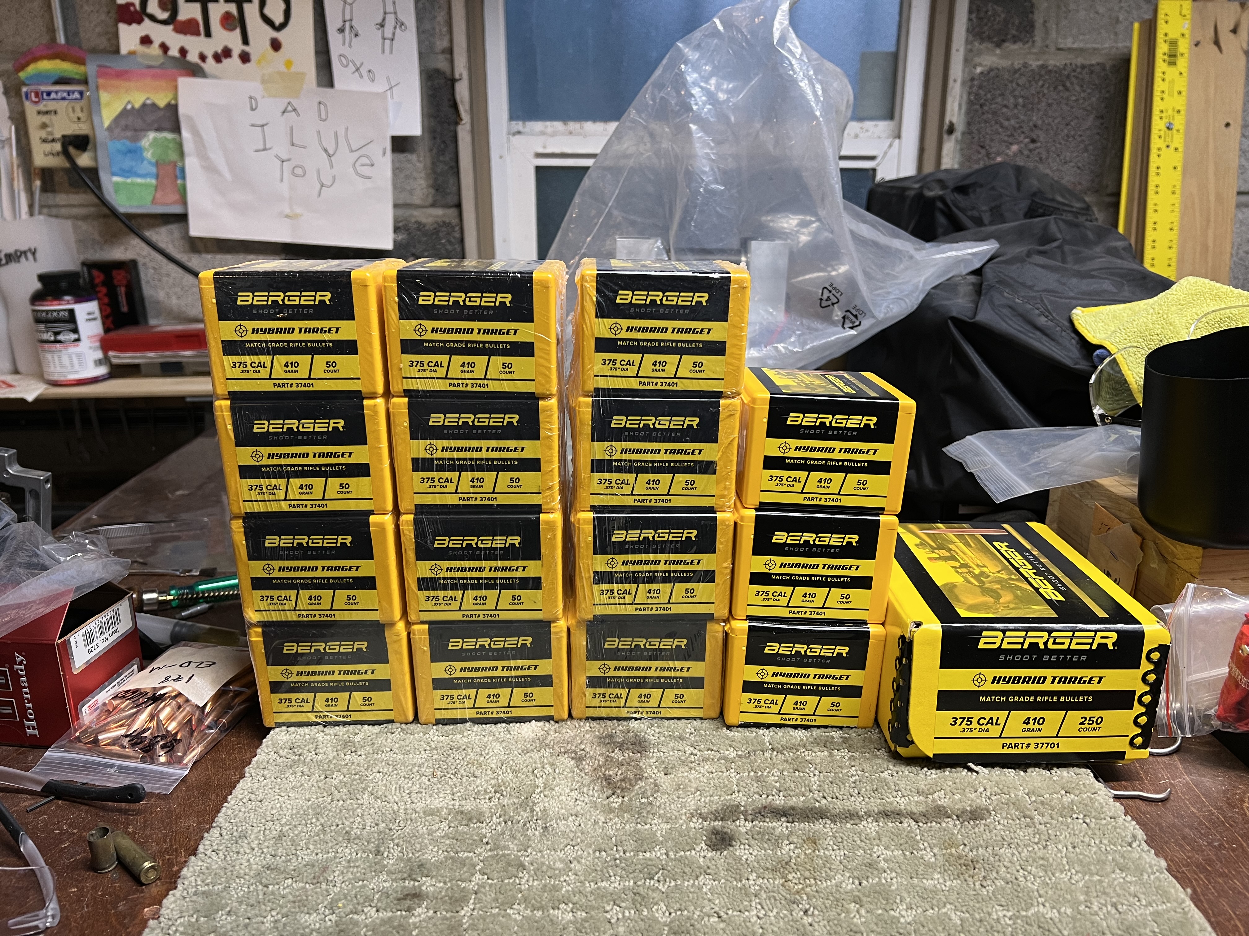

I had the 250 box. The day I tested them in the desert last week, I was so overjoyed that I got on my phone and scooped up 750 more. I've been through 375 component shortages since 2012 and I know better now :)

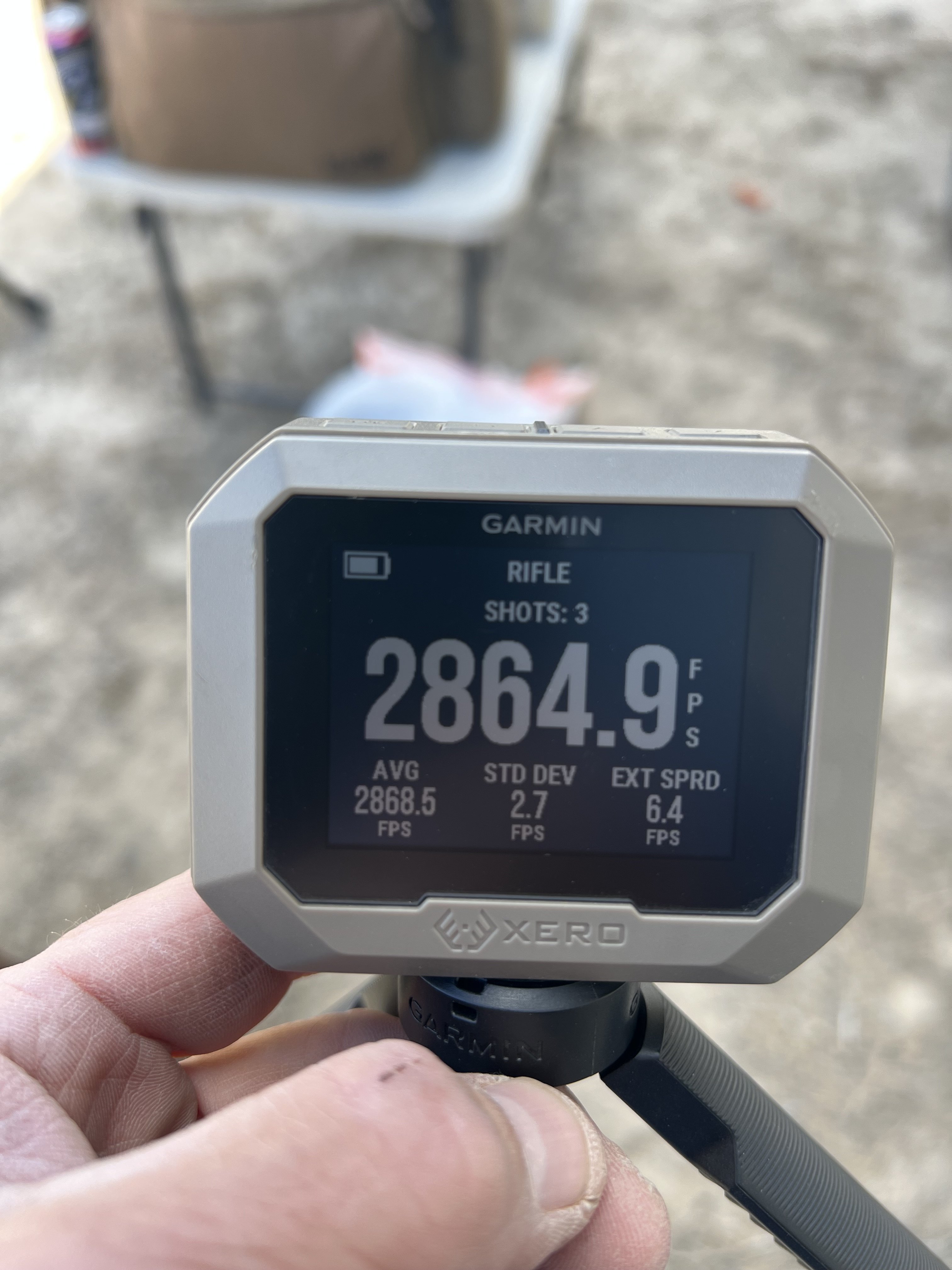

Holy shit, brothers
First three shots 133 grains of H50 BMG, 0.025 inches off the lands, shot from bipod at 122 yards. 35” Lilja 10-twist.
I need to buy several thousand of these and sell my ATIPs

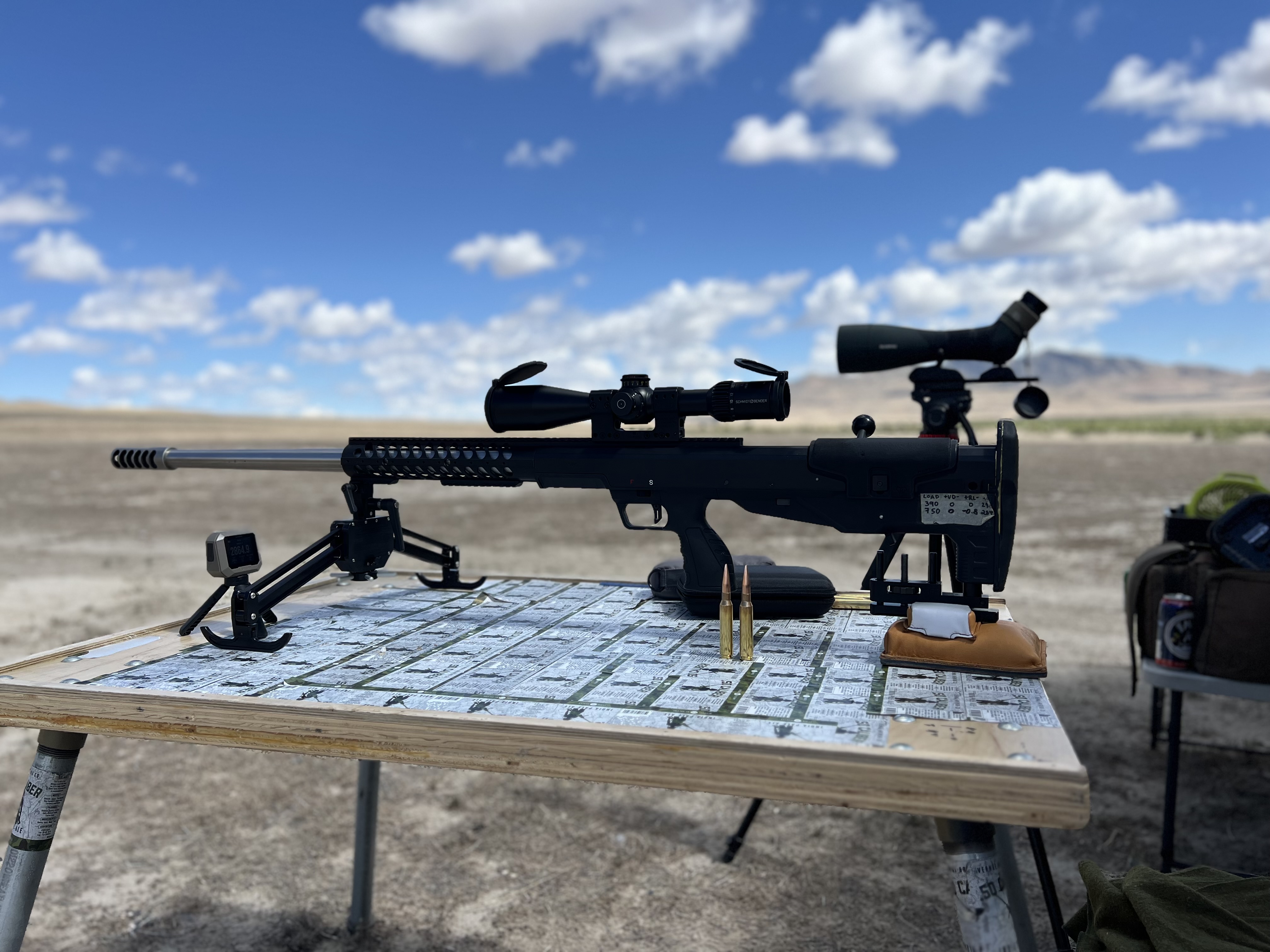

At the range. Since I couldn’t find any load info for 410s with N570 in the 37XC, I extrapolated off my 390 ATip loads. I had been running 120 gr of N570, so decided to run the ladder from 114.5 to 119.5, with foulers at 116 and 117. Very low cell signal, so I can’t share pics, but holy crap these things perform.
Slightly heavy bolt lift at 117.5, definitive heavy lift at 118.5. Stopped there. My shoulder hurts.
Since there’s no load data for this combo, I’m going to start a new thread for the loads when I get home.
With random seating depth (.020”) I’m getting groups and SDs that I could almost run with.
Will post data later.
