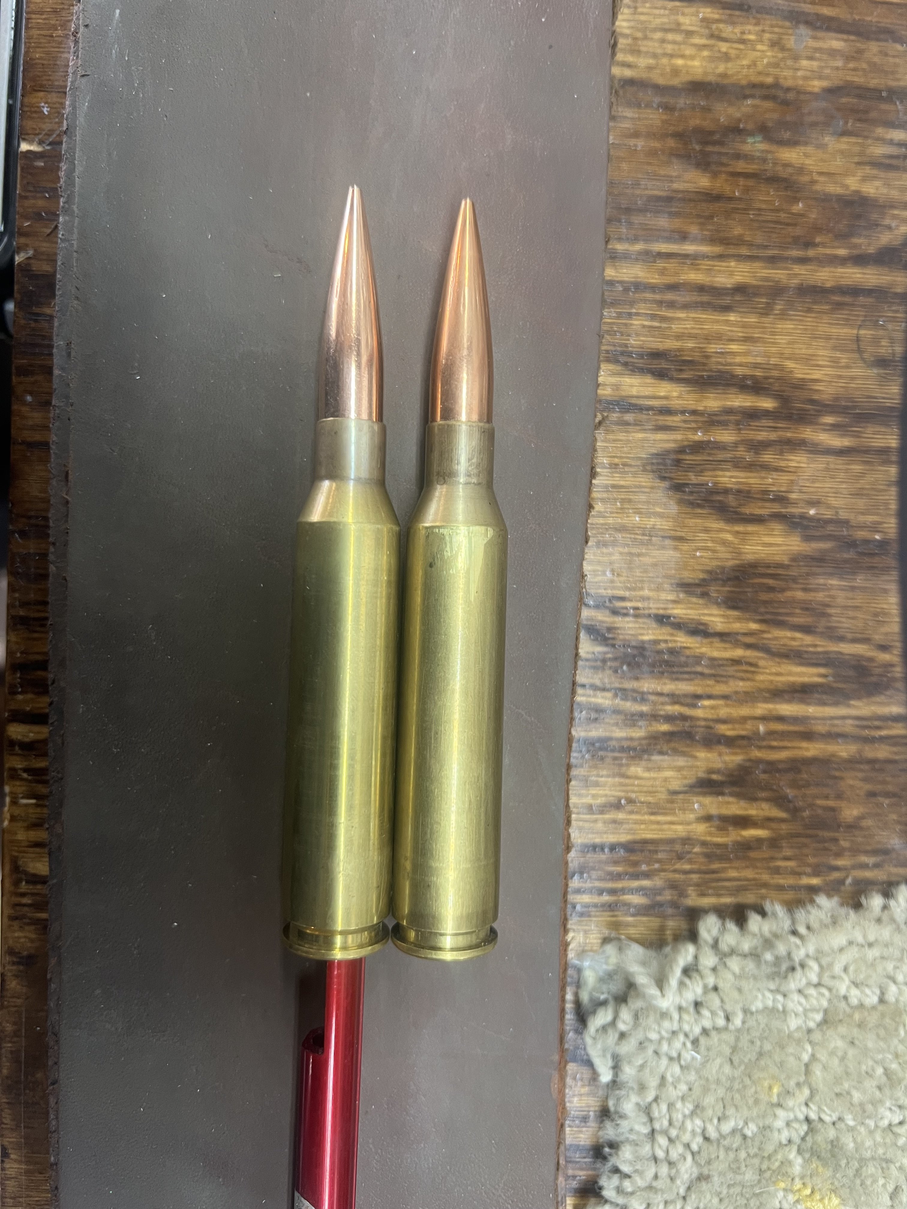

I was putting the outliers at the end of the box as I won’t take home 4-5 unfired cases. I just send them and know if performance tailed off, why. I was keeping the best in the first five(bottom left) because I always verify zero and chrono the speed into calculator.

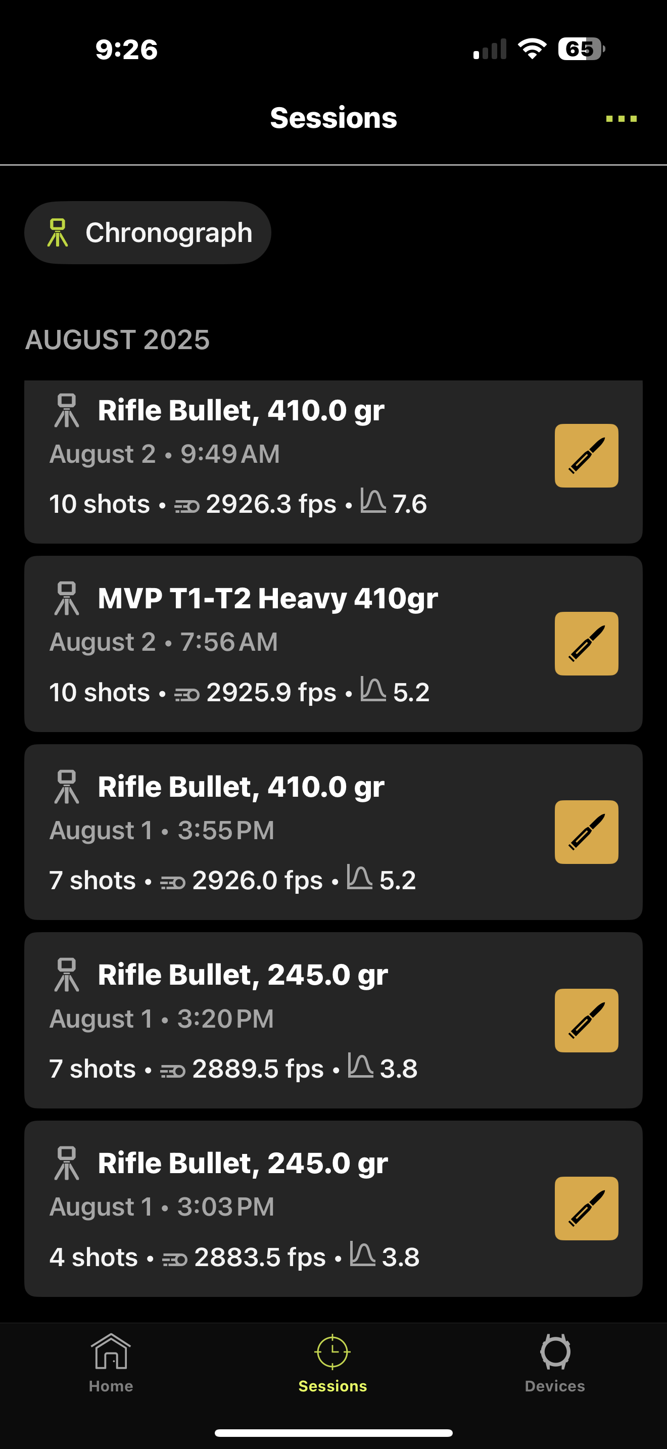

I just returned from range and tested the first 5 of 50 I loaded that were the lightest ones.
Average: 2995.8
Low: 2991.4
High: 3004.4
ES: 13.0
SD: 5.3
Group size: under a minute and all touching. I am going to load the other hundo and call them good to go.
