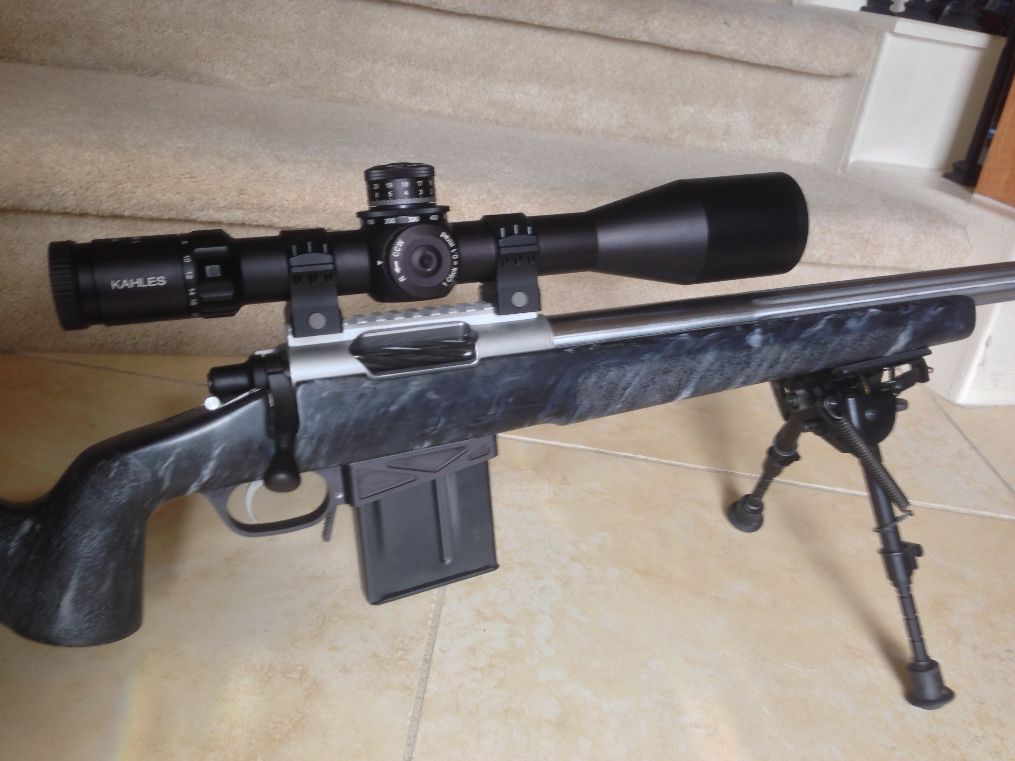

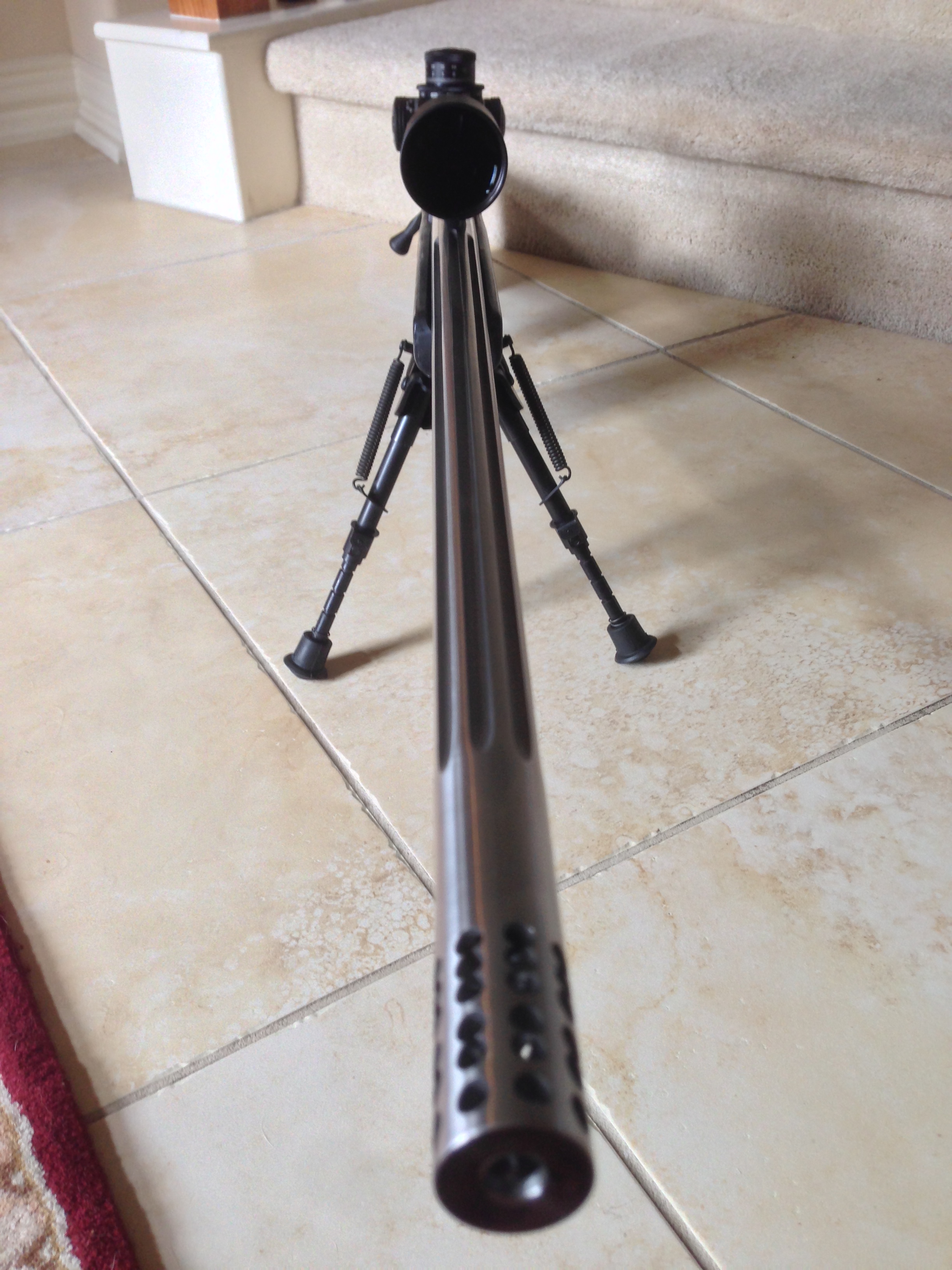

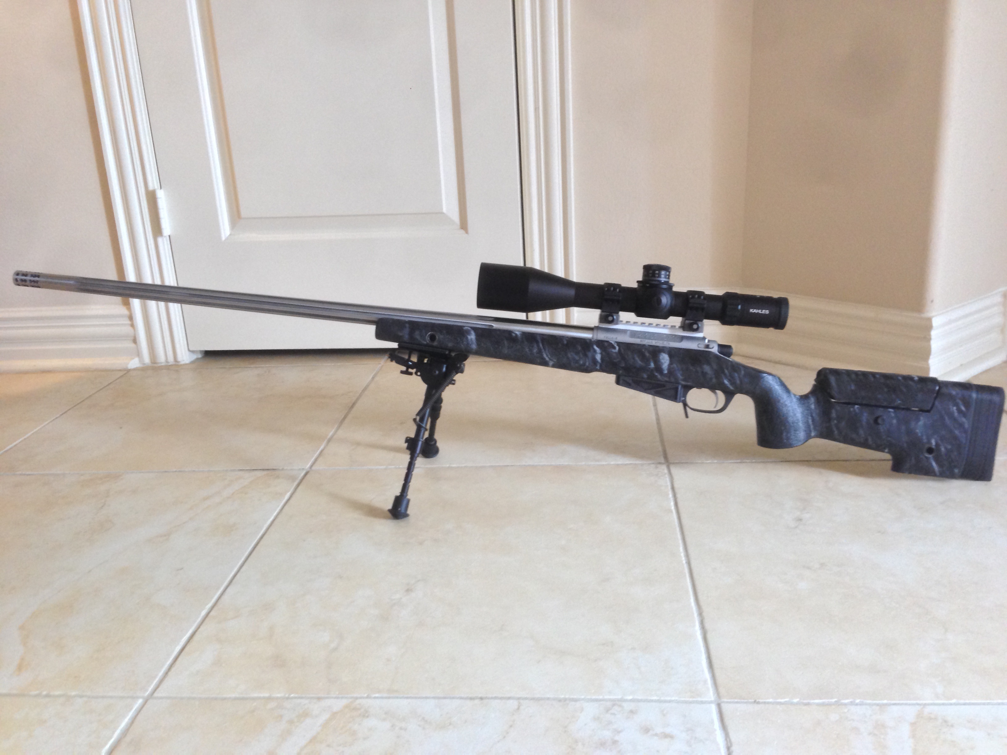

The specs:
Benchmark 30" 5r 8 twist 7mm tube light varmint 5/8"x24 threads
Chambered in 7 SAUM.
Stiller Predator s/a 20 MOA rail
Stiller DBM
Alpha Type 4 10 round 300WSM Mags
Jewell trigger
McMillan A-3/5 , 2 flush cups
Kahle 6x24 56 MSR
Nightforce 6screw rings
Waiting on the stamp for my thunderbeast
Built by Omar Alonzo in the Houston area - builds a lot of 6.5 SAUM hammers.
I cannot wait to get some time to shoot it. I will break it in with 180 VLDs over a healthy dose of Retumbo and if I can ever find some H1000 will compare that to the Retumbo. Yes that is an 8 twist cited above as I have heard about some 195 VLDs in the future and I would rather have a little more than not enough.
This whole project started from me thinking about rebarreling a Rem 7-08 sporter that needs a need tube to be fun. But one thing leads to another and you need a new stock, why bother truing an action, that trigger needs work, etc.............

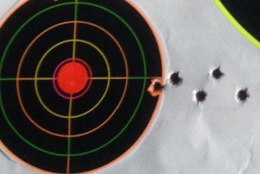

Well I made it out to the range last weekend. Unfortunately the wind was blowing a steady 15-20 with gusts 25-30. No problem I was mainly planning to do the barrel break in and get a lot of cleaning exercise in. The first 15 shots were some lightly loaded 150 NBTs over some H4831SC just to get things rolling and I needed to do something with the last 15 as I do not use them for anything anymore. The barrel stopped laying copper down very quickly and I was able to shoot a little ladder of 180 VLDs over some Retumbo as I was still waiting to find the ever elusive H1000.
The gun shoots great and it is always nice to be able to fire the first shot at 300Y just by pulling the bolt and looking through the barrel to get on the target ( a lot more precise at 100). I was not planning on doing much more than brake in so I did not run the 215M primers that I plan to run normally as I decided to burn up the last few WLRM that I had. Given the wind that was whipping of my left shoulder and quite variable from 6-8 I was quite pleased. The group in the pic was again from 300Y but ran a max vertical spread edge to edge of just over 0.7". This was a 180 VLD over 63.5 of Retumbo, Norma brass.

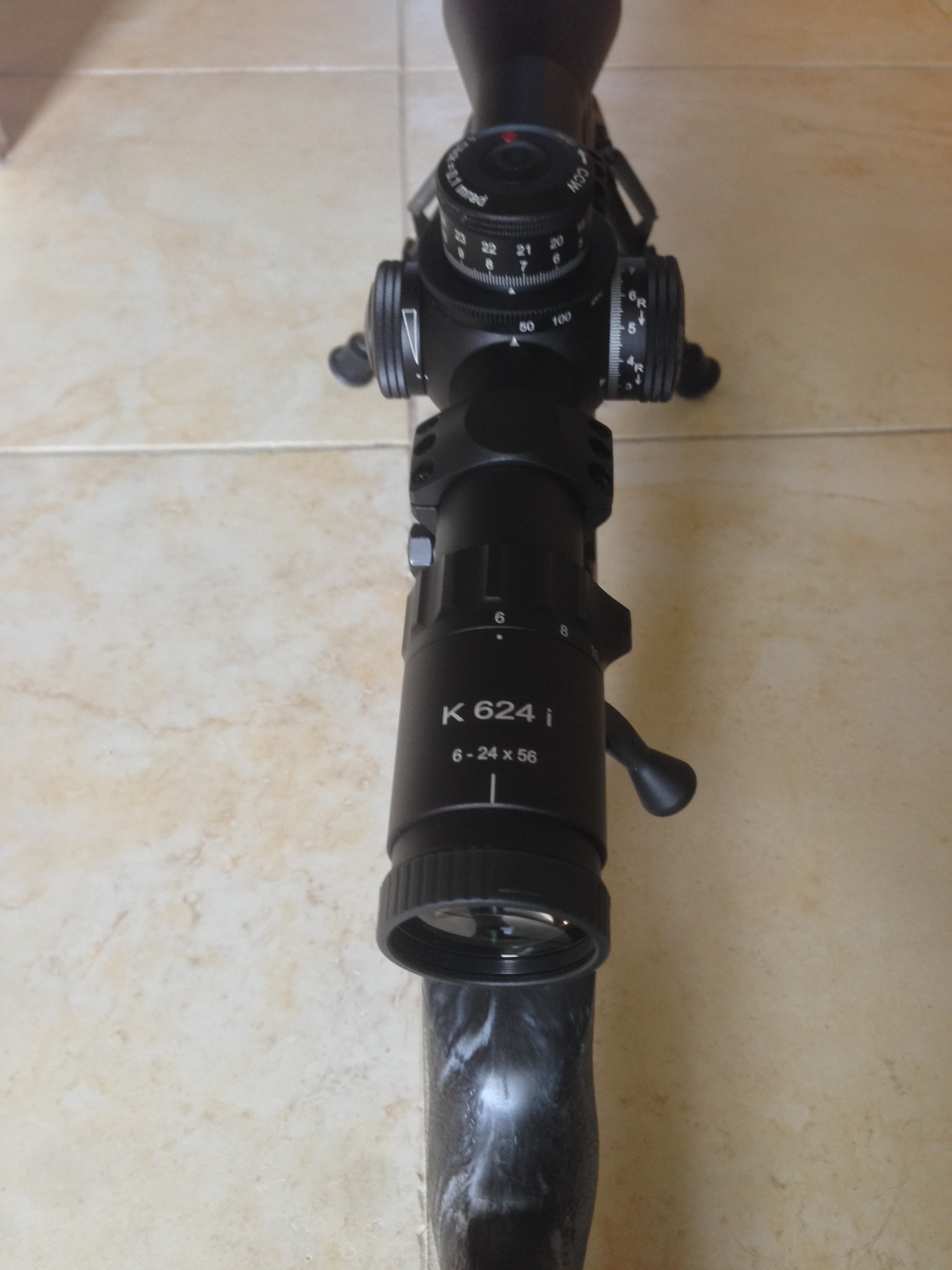

I love the Kahles 6x24 with the MSR. The floating dot is awesome for precise shooting.
