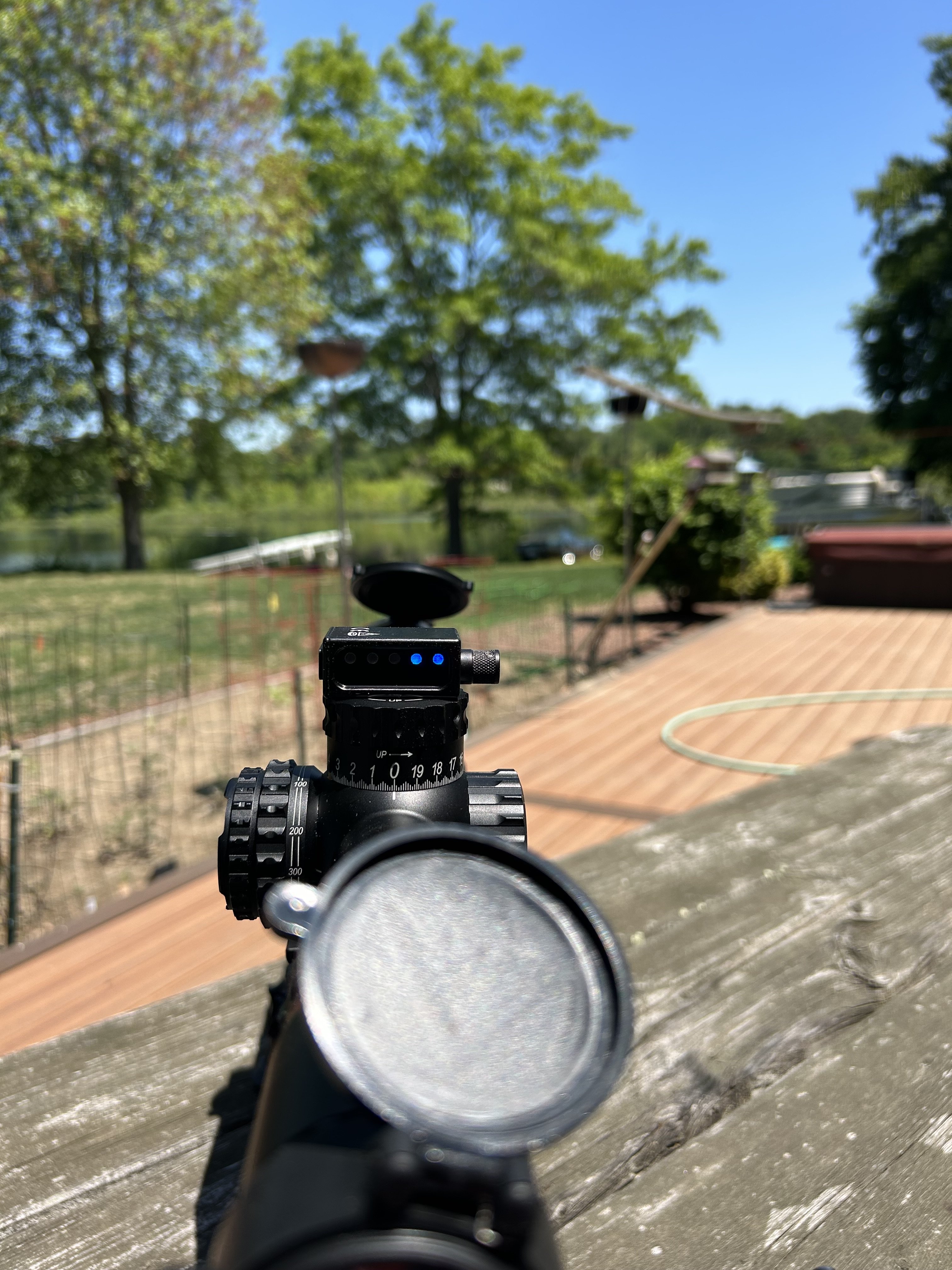

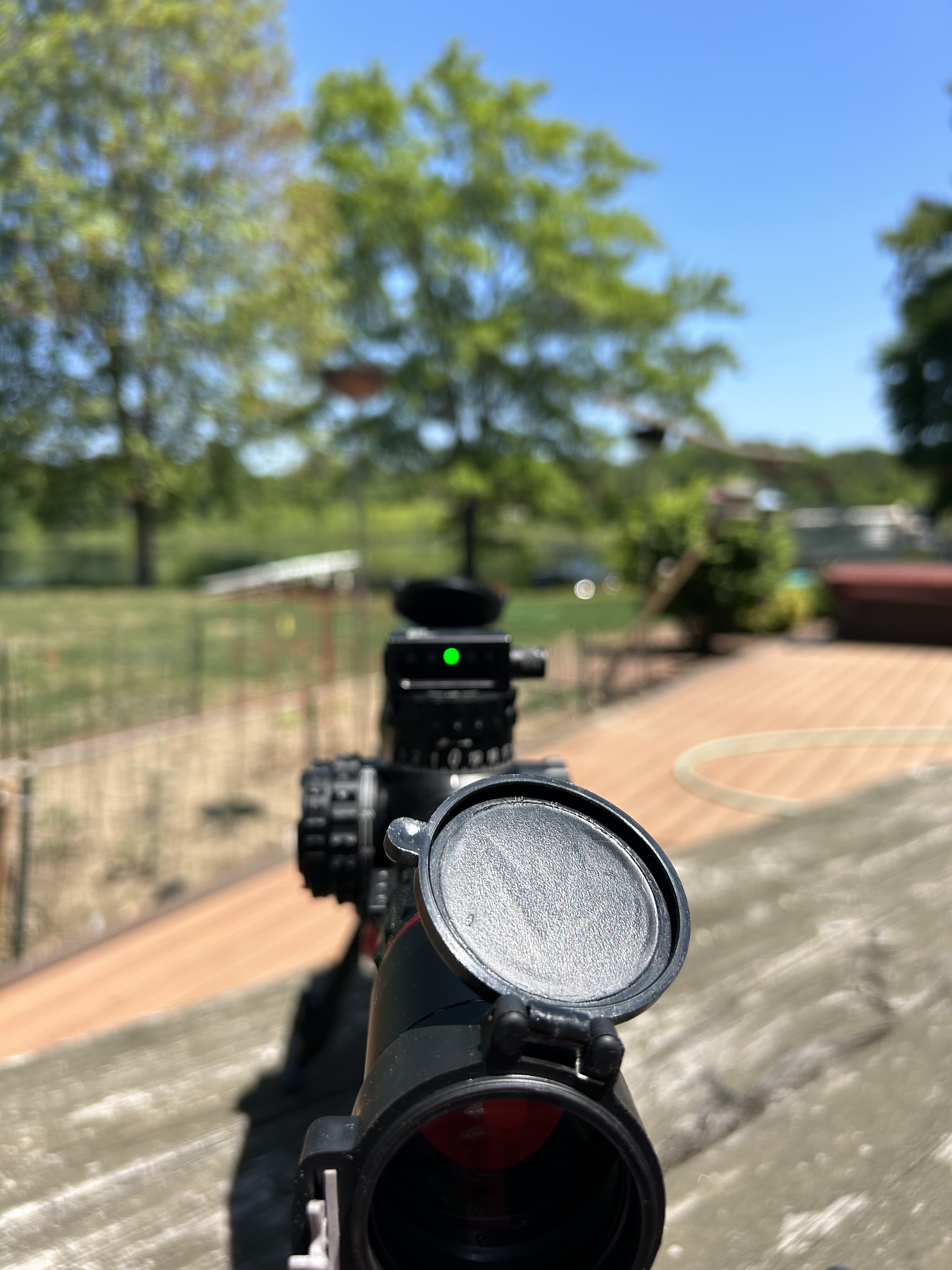

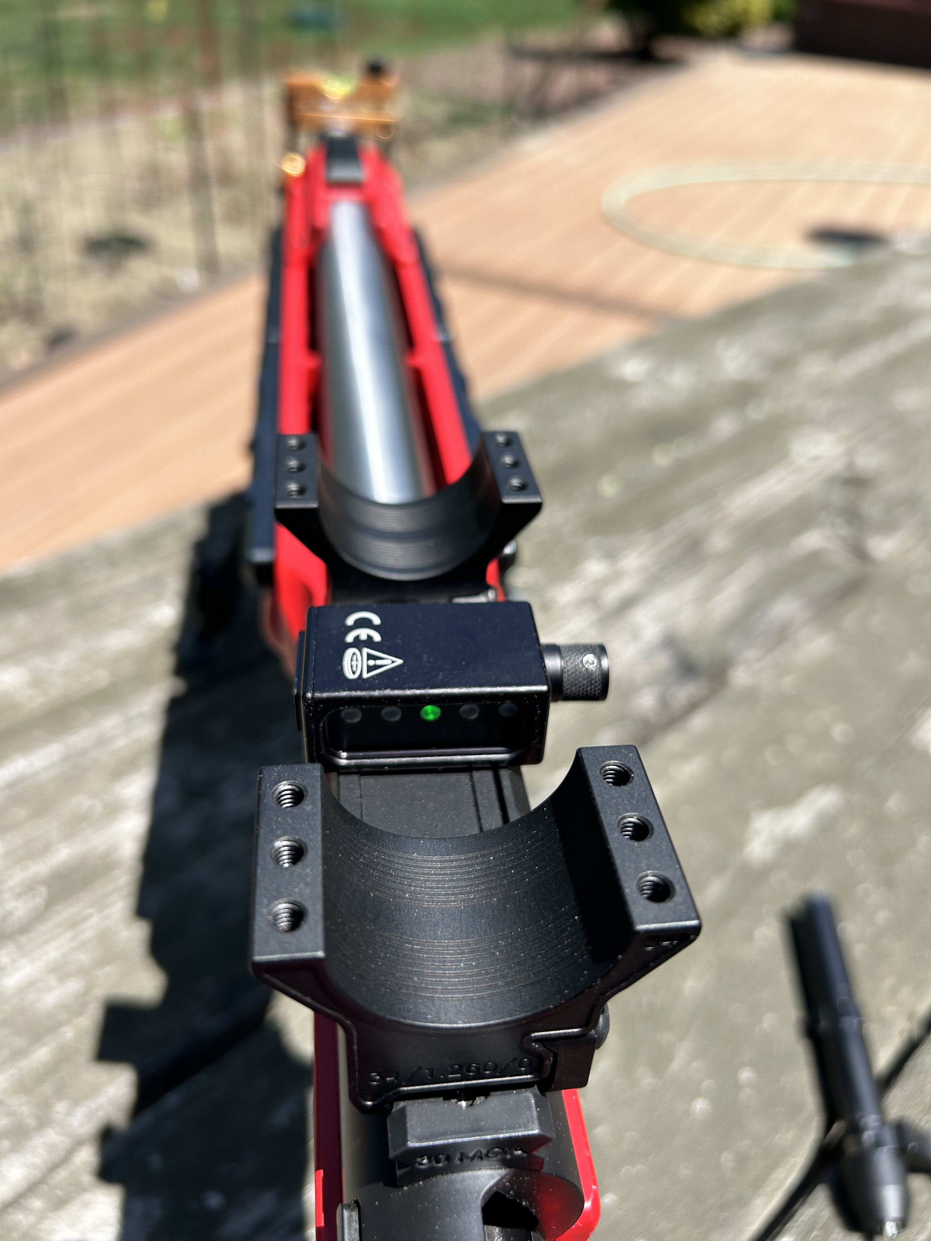

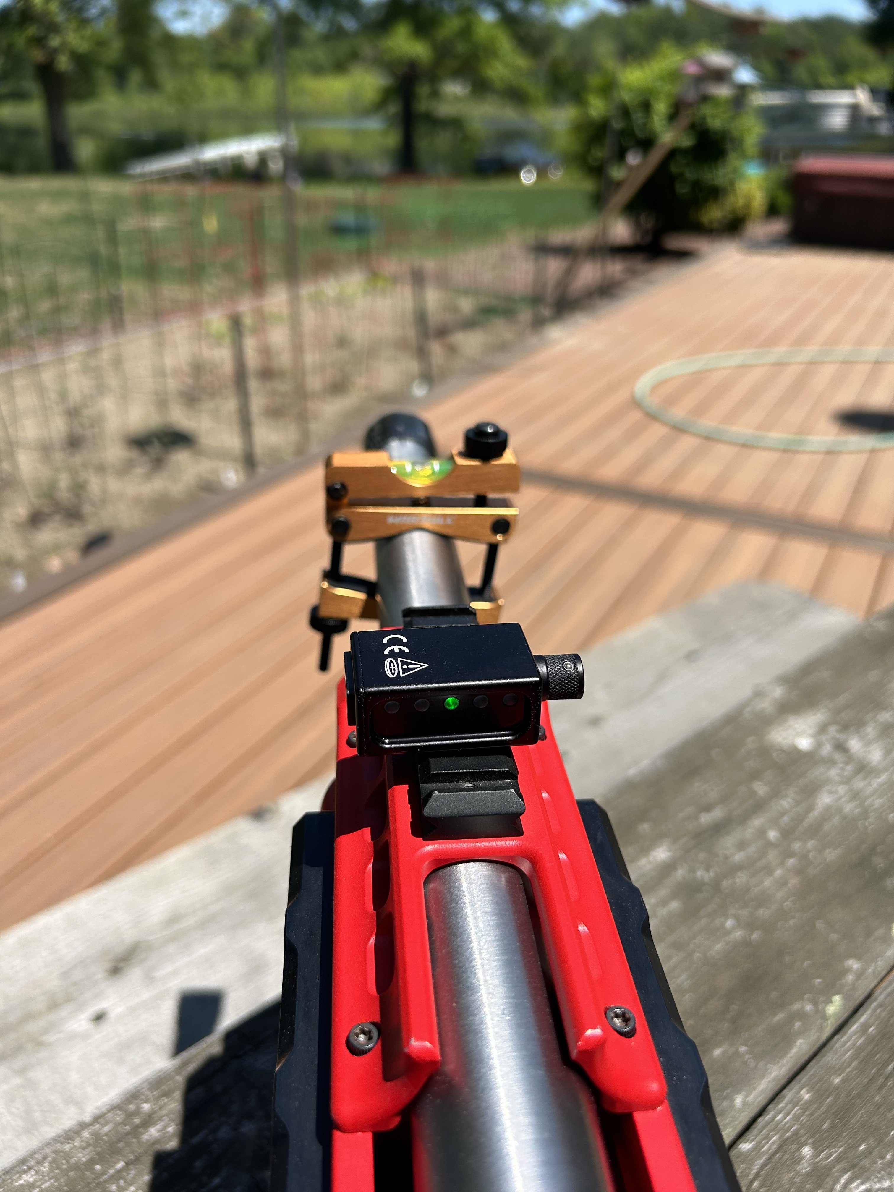

Help with level.
I’m outside trying to bore site this scope. My gun is level ,front top pic rail is level. Rear of stock is level. When I put my send it on top of the turret and level it, the inside bubble and retical are way off vertically . if I zero the bubble will that straighten out the retical also? I’m thinking no.

It just centers up the digital bubble. Don't worry about the turret being level. Level or plumb your reticle and the scope should track with your reticle.
