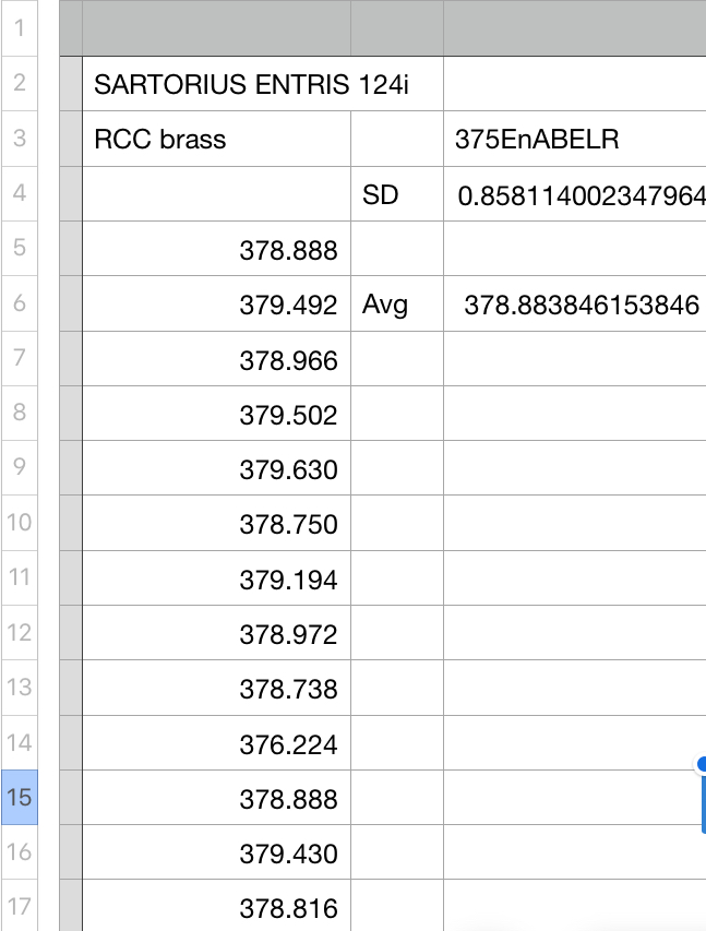

RCC Brass for the EnABELR
Reactions: RyanO7 and Bradu
