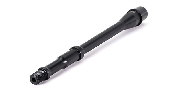

I'm not too happy about this. This is a new 10.5" faxon pencil barrel I purchased. After building the rifle and doing the first cleaning, the inside of the barrel looked all cruddy, like it has had a lot of rounds through it. I though maybe that was from the factory test firing the barrel?? Do barrel manufactures even do that and send you a barrel with gun powder still in it?
Here is link to exact barrel I bought. I bought the barrel from a different online retailer.
I then started to clean it and it doesn't come clean, the crud just sits there and the inside doesn't look shiny. I also noticed that when running patches through they get stuck at one point and kind of rip the cloth patch after getting stuck maybe at that point?
I've never seen anything like this and all my barrels are very shiny and reflective, even after firing many rounds through them.
I also just bought a 11.5" faxon pencil that was new and that was shiny inside. I checked my 16" faxon pencil that I actually fired at the range many times and after running a single CLP patch through it was shinny and looked new.
Since I purchased this a few months back am I pretty much stuck with this? What would you guys do, I am kind of bummed about the whole thing. I have no idea what all that crud is and it can't be cleaned.
YES, lesson learned, I will check all barrels the day I receive them in the mail.
What should I do in this situation? What is all that stuff in the barrel?
Thanks for help here.

    Not sure if you are stuck with it, you would have to contact Faxon to know that answer and I would recommend you start there. I've had good luck with Faxon barrels though I've never needed their customer service. Let us know what they say.

    Noticed it says QPQ. Perhaps the salts weren't properly neutralized or it went into the tank with an unclean bore. As to torn patches, my guess is burring around the gas port. I'd contact Faxon before trying to "fix" it.
    All it takes is one bullet down the barrel to fix burs at the gas port.

    For those interested here are pics of the crud inside the barrel that would not clean out. These pictures are after I ran a lot of patches down them, and also solvent. Then I took a picture of a brand new 11.5" faxon pencil barrel and you can see its shiny smooth.
    What do you think all that crud is? Hopefully you can see why I was a bit concerned.

    Just an update. Faxon did send me another 10.5" barrel.
    However, it has the same issue again, not as bad but the same issue.
    I'm having such bad luck here.
    What would you guys do if you got two bad barrels in a row like this? How common is this?
    Here are the pictures of my 2nd barrel, it's not as bad as the first but its still a deal breaker and really bothers me. I don't want to have a barrel that looks dirty all the time.
    YES I tried cleaning this barrel and that crud and pitting will not come off.
