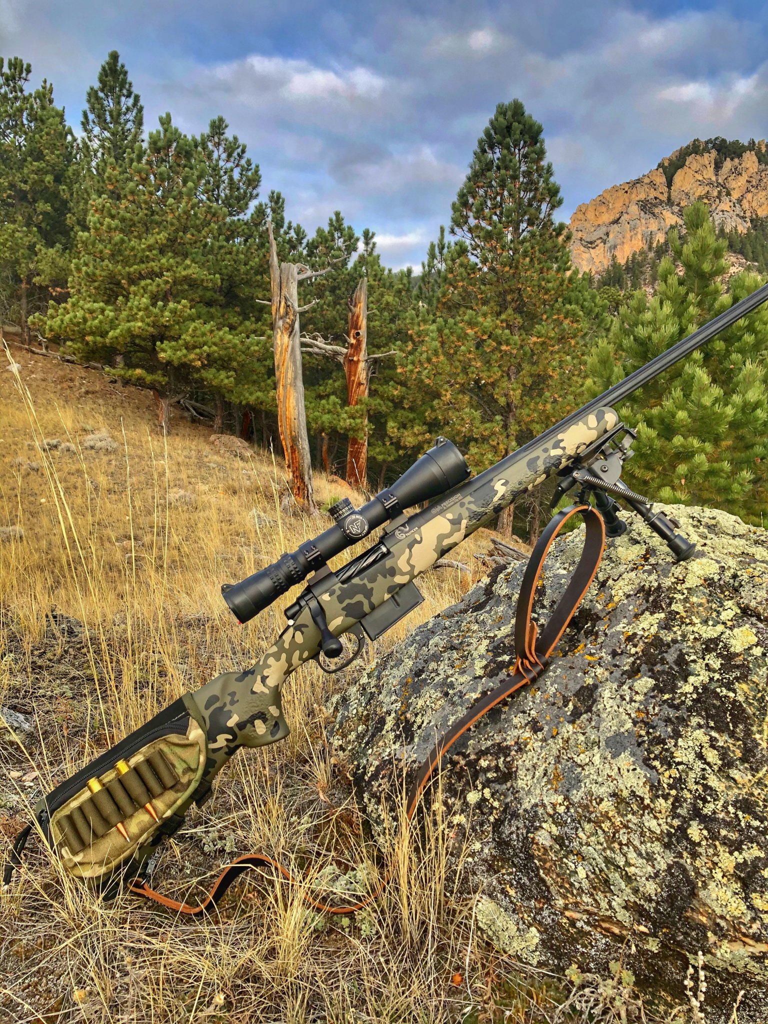

New GAP Extreme Hunter in 6.5 SAUM

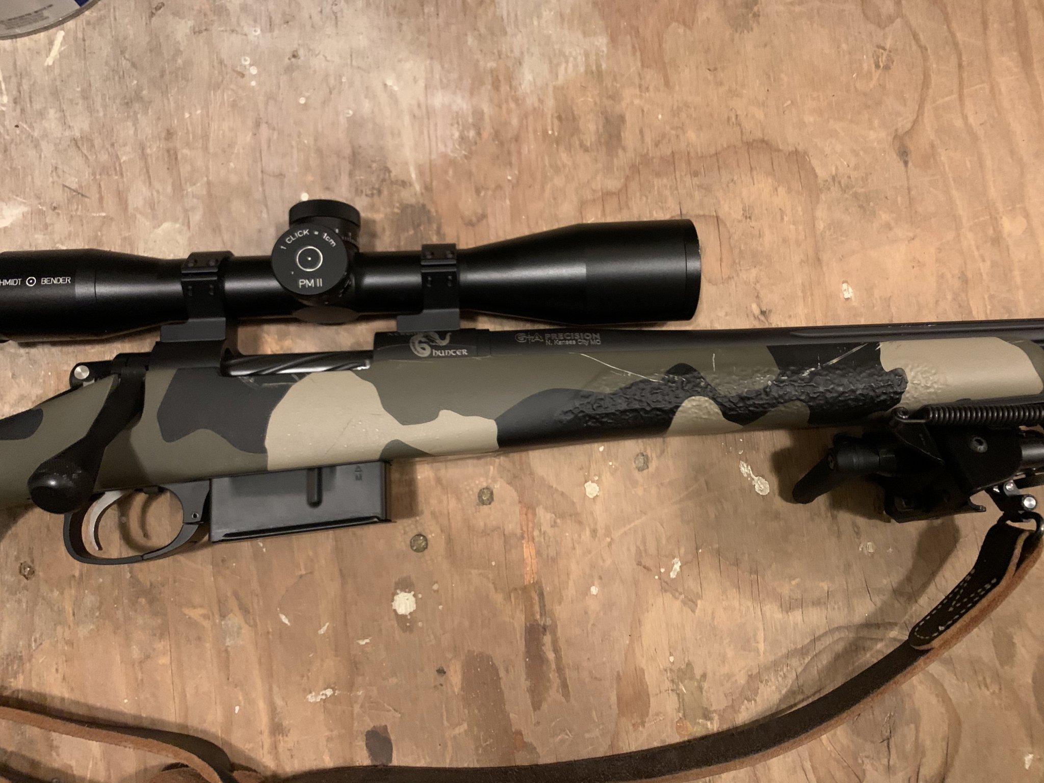

To be honest, I built the rifle planning on shooting the amax. I haven't killed anything with the rifle yet, but I might drag it along as a backup to my 7 saum on a New Brunswick moose hunt this fall. I have amax, scenars and 127 lrx on the shelf, so I might just see what shoots best and call it good.

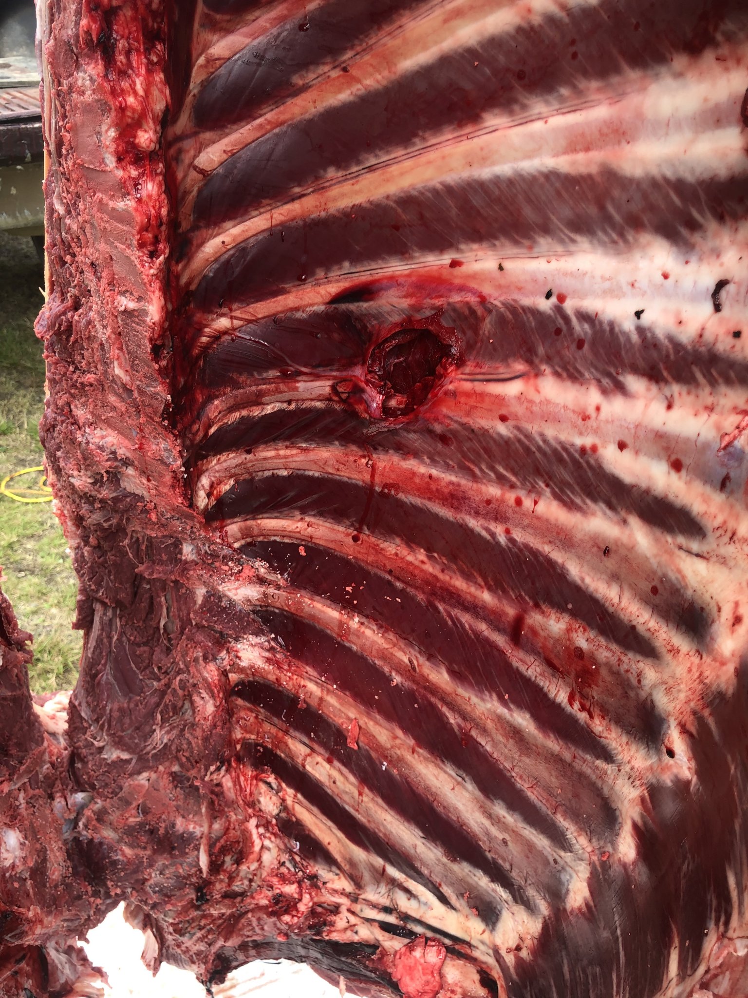

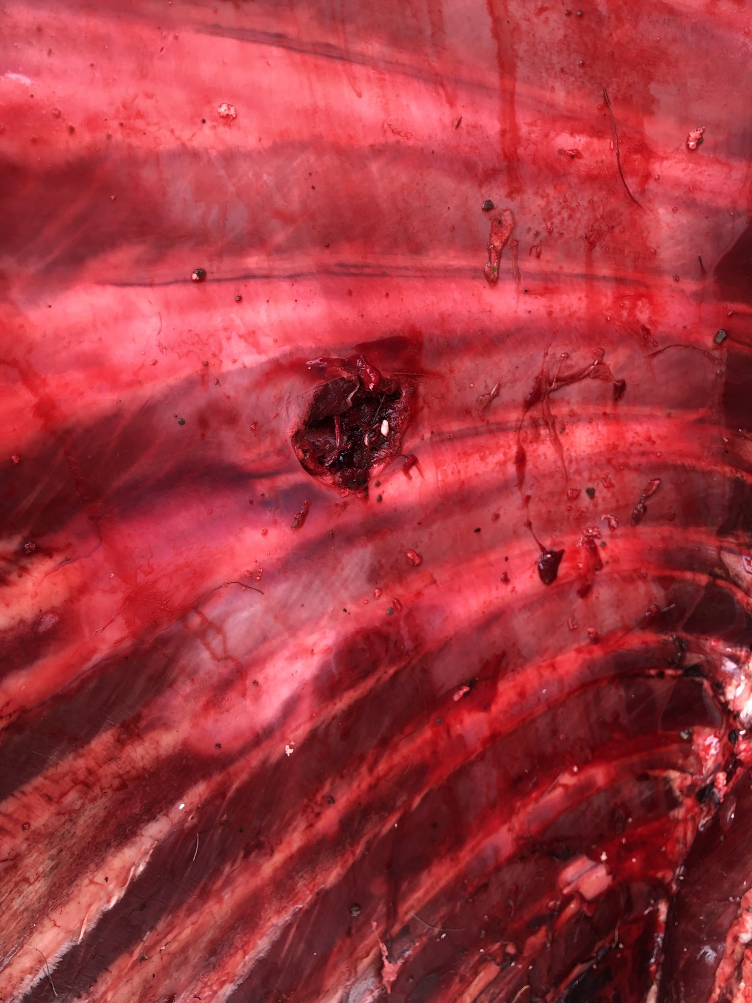

The lead up to the season was a real gong show, so I ended up running the 7saum 120tsx load that I’ve been shooting for years. Found this eater bull on the last day of the 5 day hunt. He had his head down feeding, so all I knew was it was an adult moose. Shot was broadside at 70m. Quarter sized entrance and exit, center of the lungs. He was down before I came out of recoil. Couldn’t ask for better eating.

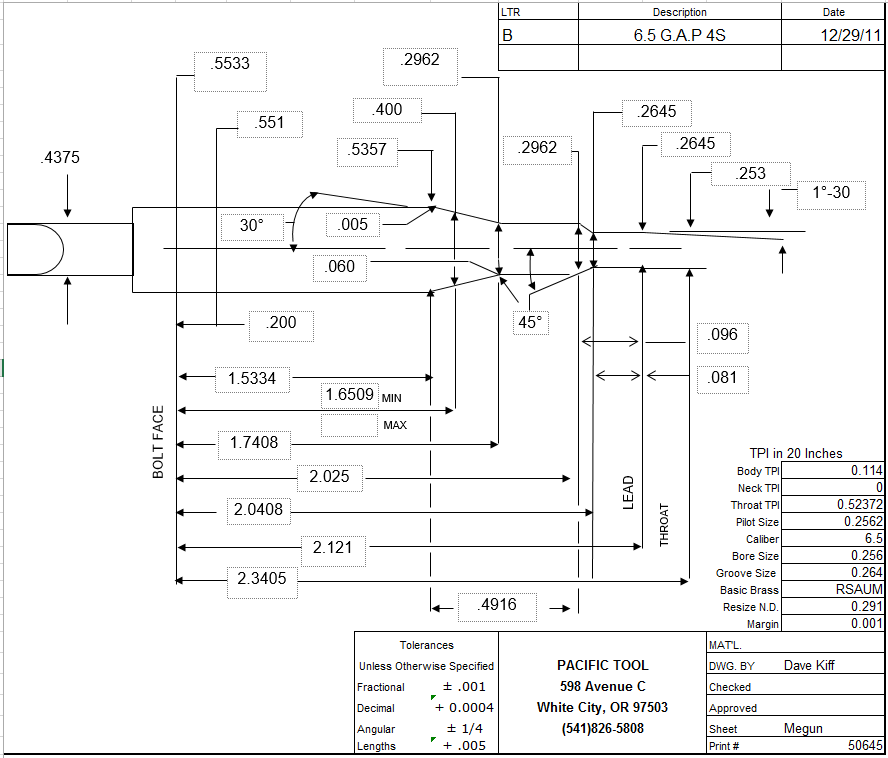

I wanted to ask for some advice. I am looking at ordering a PTG reamer in the .296nk/.081fb for my 6.5 saum build. I have Redding Type S dies and will be loading new ADG 6.5 SAUM brass. As for the neck tension I intend on using a .293 bushing. Will the .004 clearance be sufficient? Also how often should I expect to neck turn with this brass? I appreciate any assistance you can provide me.
^ 0.293 bushing seems a little big doesn't it? It's been a little while but I thought I used .290-292 bushings going off memory.
I have that same reamer, and have found that turning necks is definitly required. I would aim for a .290 loaded diameter, so likely .287 bushing.
Turning necks required with ADG brass? I had used the .2962 neck reamer too and didn't find any clearance issues with the first run of ADG 6.5 brass released.
My ADG 6.5 case necks measure 0.015, so a loaded round is 0.294.
My point is that a loaded neck diameter of .294 in a .296 neck is really not enough room to get a clean relase of the bullet. You would be better off ordering a reamer with a more generous neck if you don't want to turn necks.
