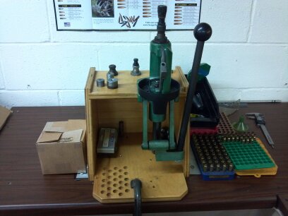

Just another option, but I use this box made by a friend who builds cabinets. It raises the press to a good working height and is very sturdy.
He sells them for about $45 plus shipping. I put the holes for the dies and loading tray in. I use the die holders constantly but seldom use the loading tray. If I had it to do over,
I'd just have the die holes.
