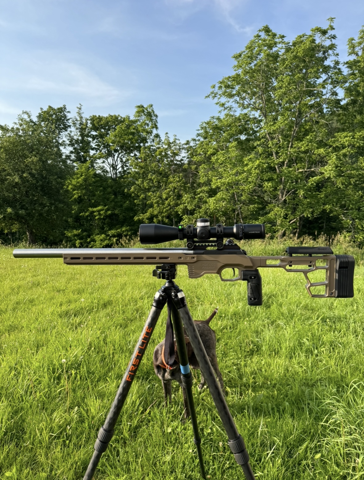

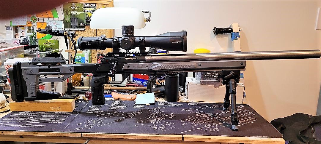

New CZ 457 24" 1.180 Match Barrel from L3i

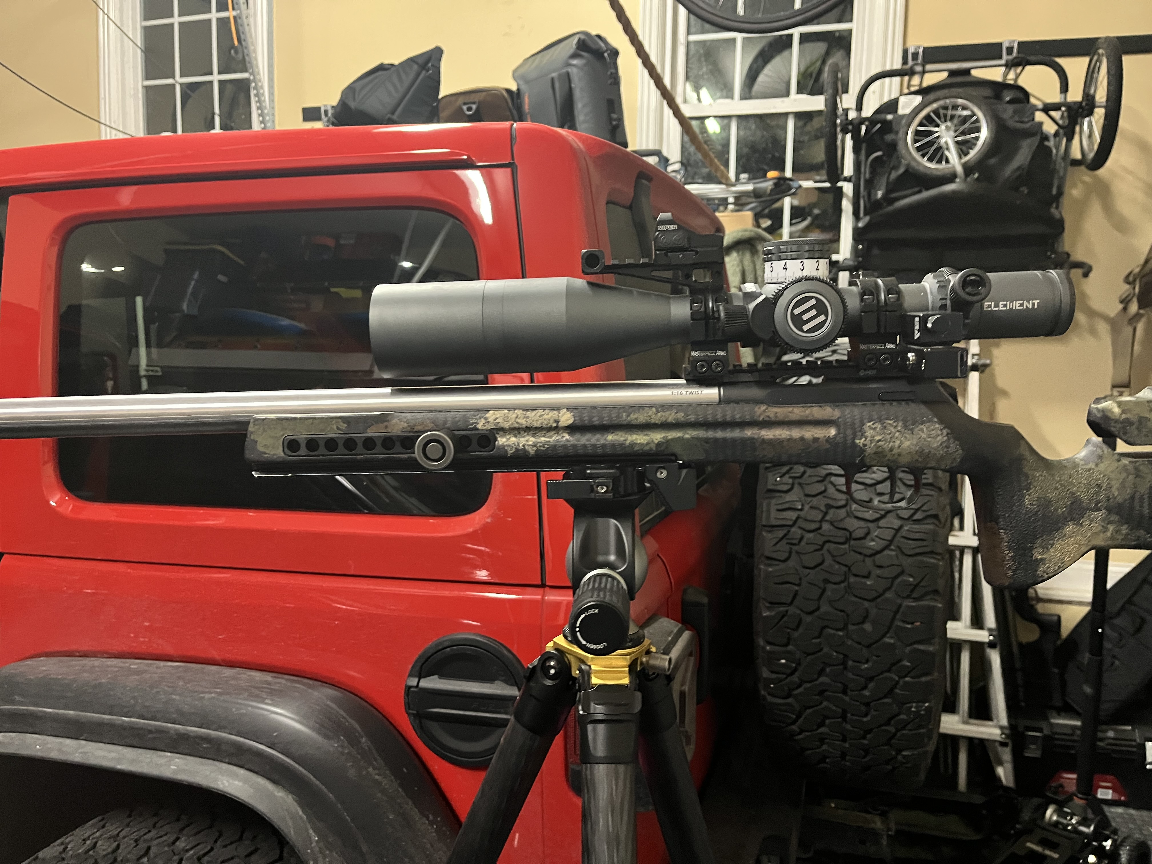

Even balances well in an MDT Oryx, which is pretty much the equivalent of a Gen2 ACC...difference being polymer panels and half the price.

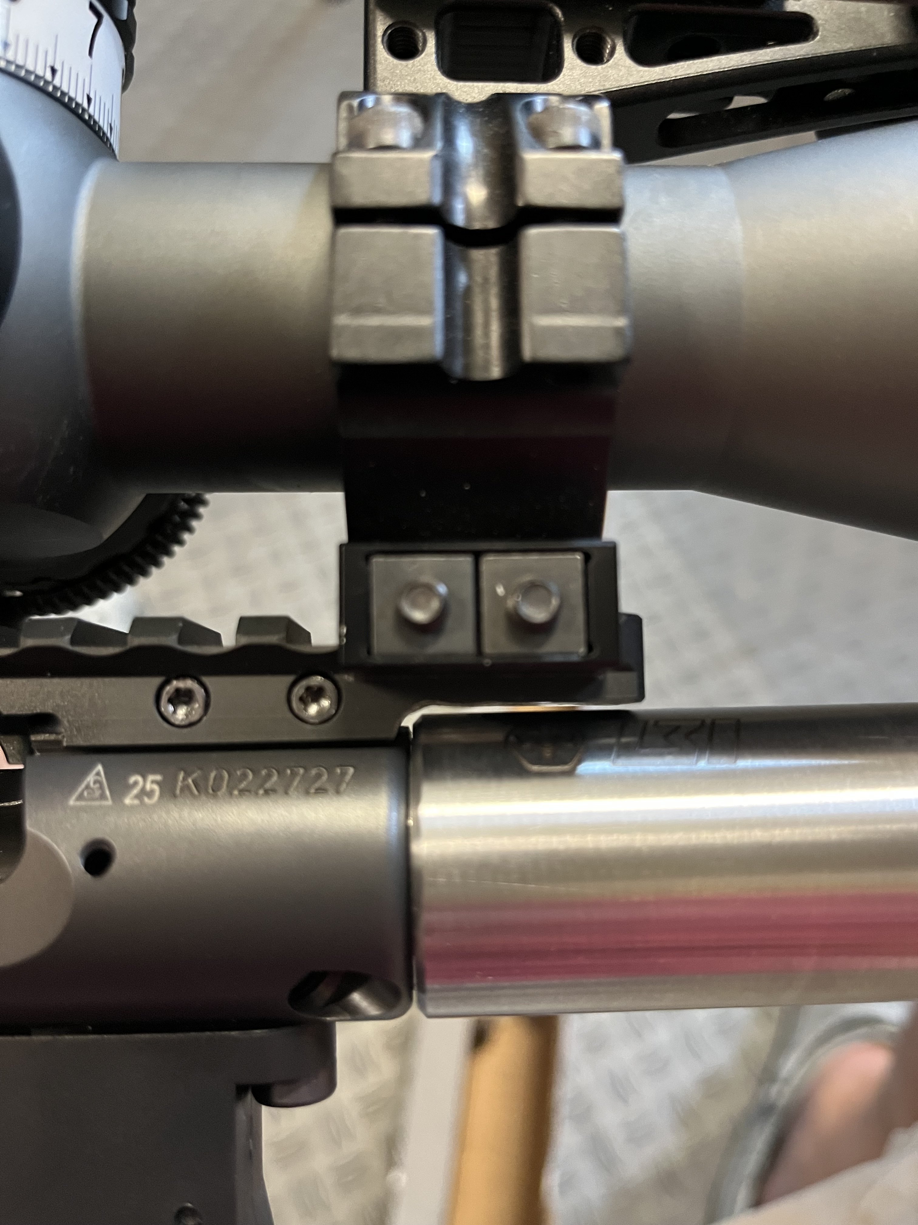

Does the barrel contact under the picatinny rail right where it meets the receiver? Hard to tell from photo.
Thanks for the measurements and initial review!
My l3i 457 barrel ran into my 419 rail. I moved the rail back just a bit so that the barrel would seat against the action. I emailed L3i and Marcus said they had to move the rail on their test rifle. He said it still functions fine.

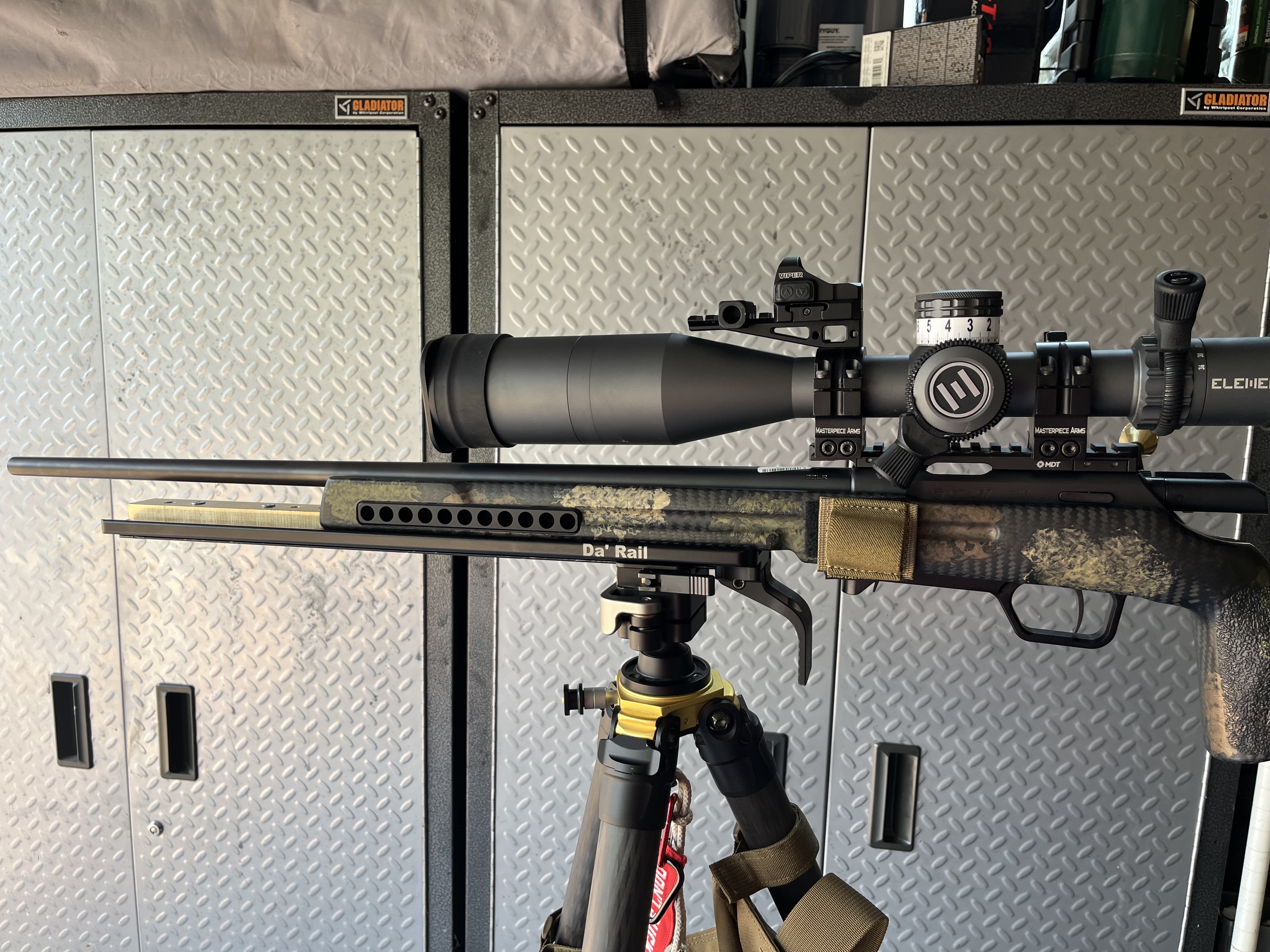

This guy has been skipping leg day, but is going to get a solid injection of L3I later today. This is a brand new action and scope rail. You can see that the rail has been clearanced already awaiting the barrel.

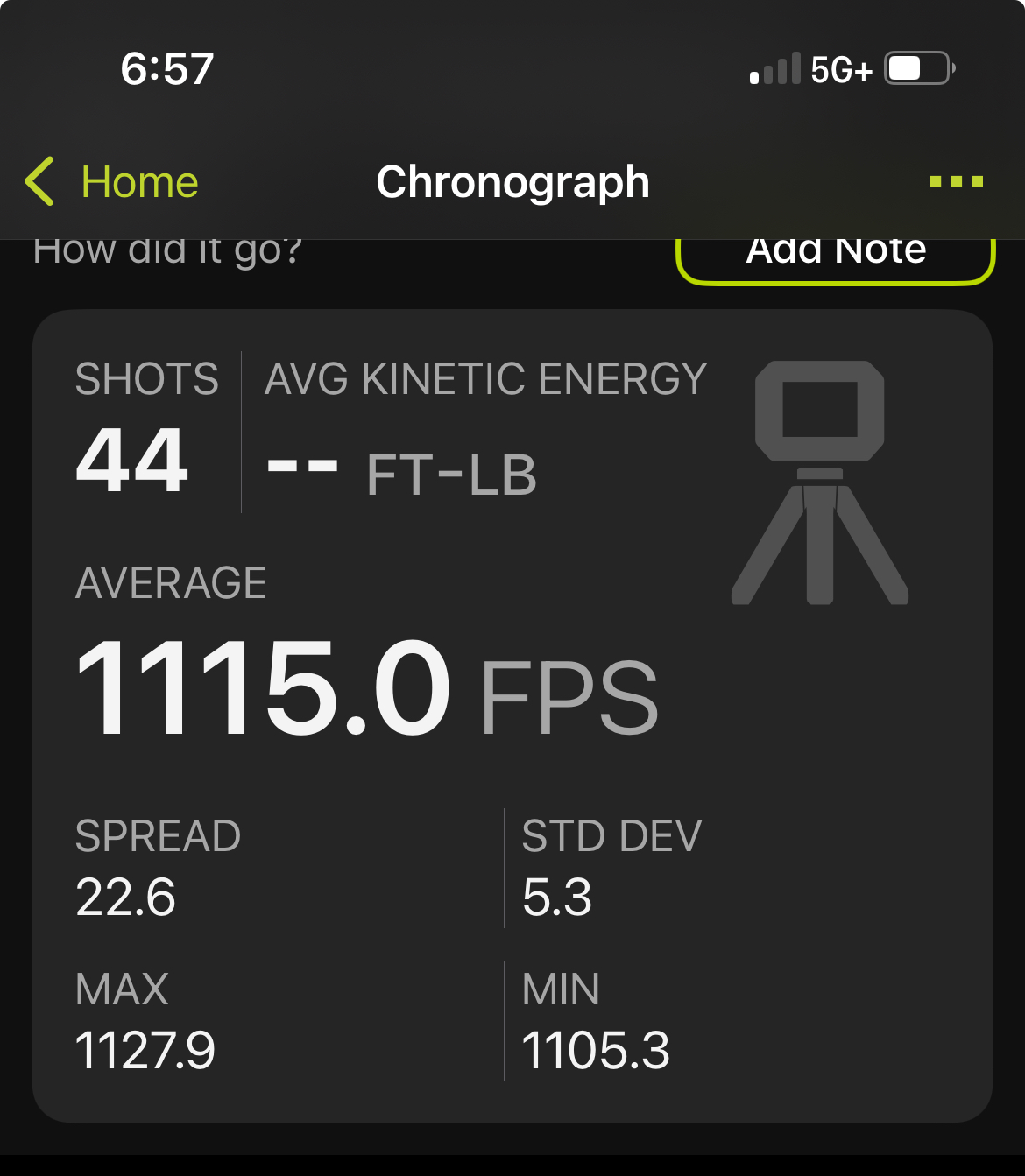

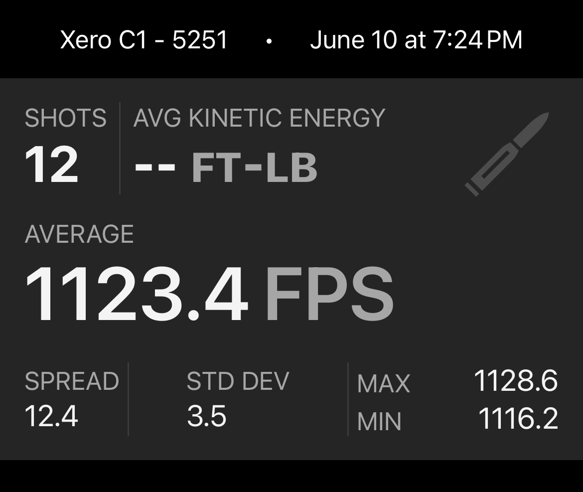

I save and track my chrono data for my rimfires. My first L3I barrel holds the top few spots for best ES and SD shooting eley ammo. I received a case of SK long range match ammo in yesterday, and have high hopes for the new barrel. It was getting dark, so I only ran one mag through this rifle (a Hart barreled Rimx with the MODX conversion). The down range results were what you would expect with these figures - incredible.
Brown Santa arrived about an hour ago. I was targeting 0.044 headspace, and it looked like the 0.004 shim would work best. The contour at the breech end appears to be the same as the pre order version. That’s just to my eye.

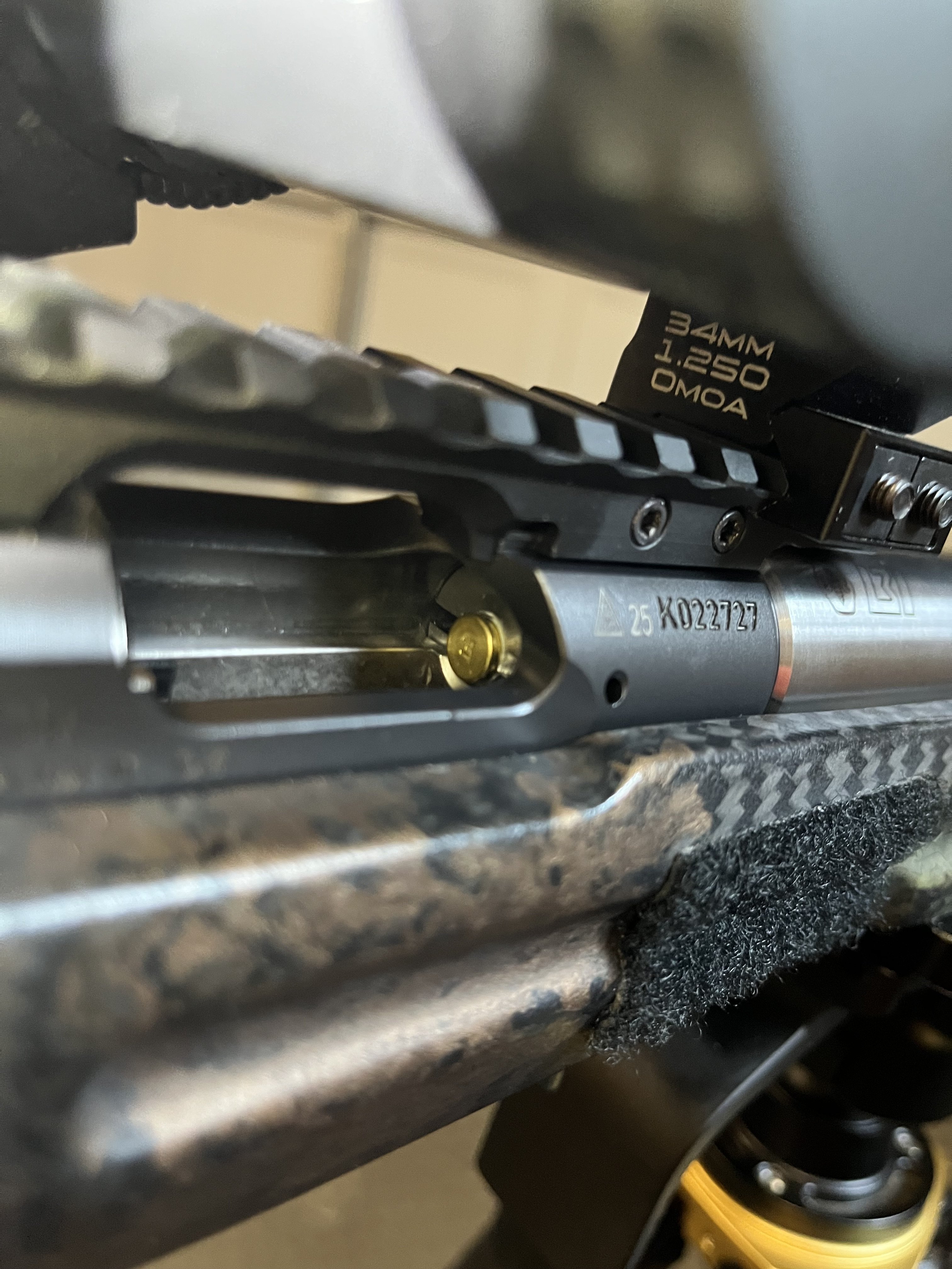

Stickout on both Lapua and eley is almost nothing, compared to the pre order version. That’s obviously makes bolt close much easier. Extraction is impressive.

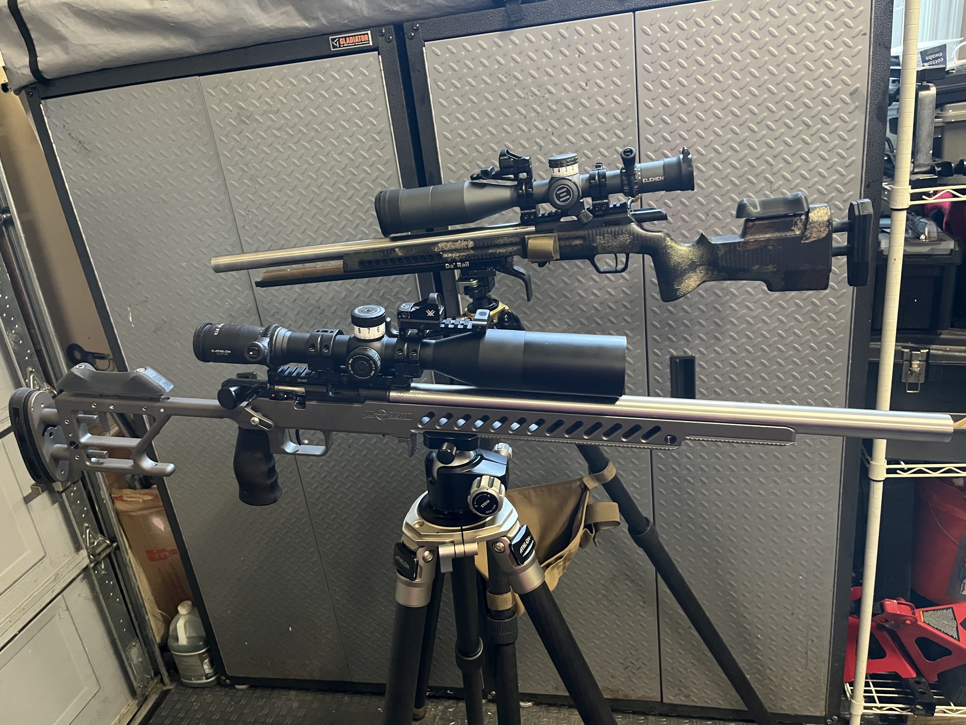

Here are my 3 CZs. I love my Rimx and Kidd rifles, but the CZ is damn hard to beat.

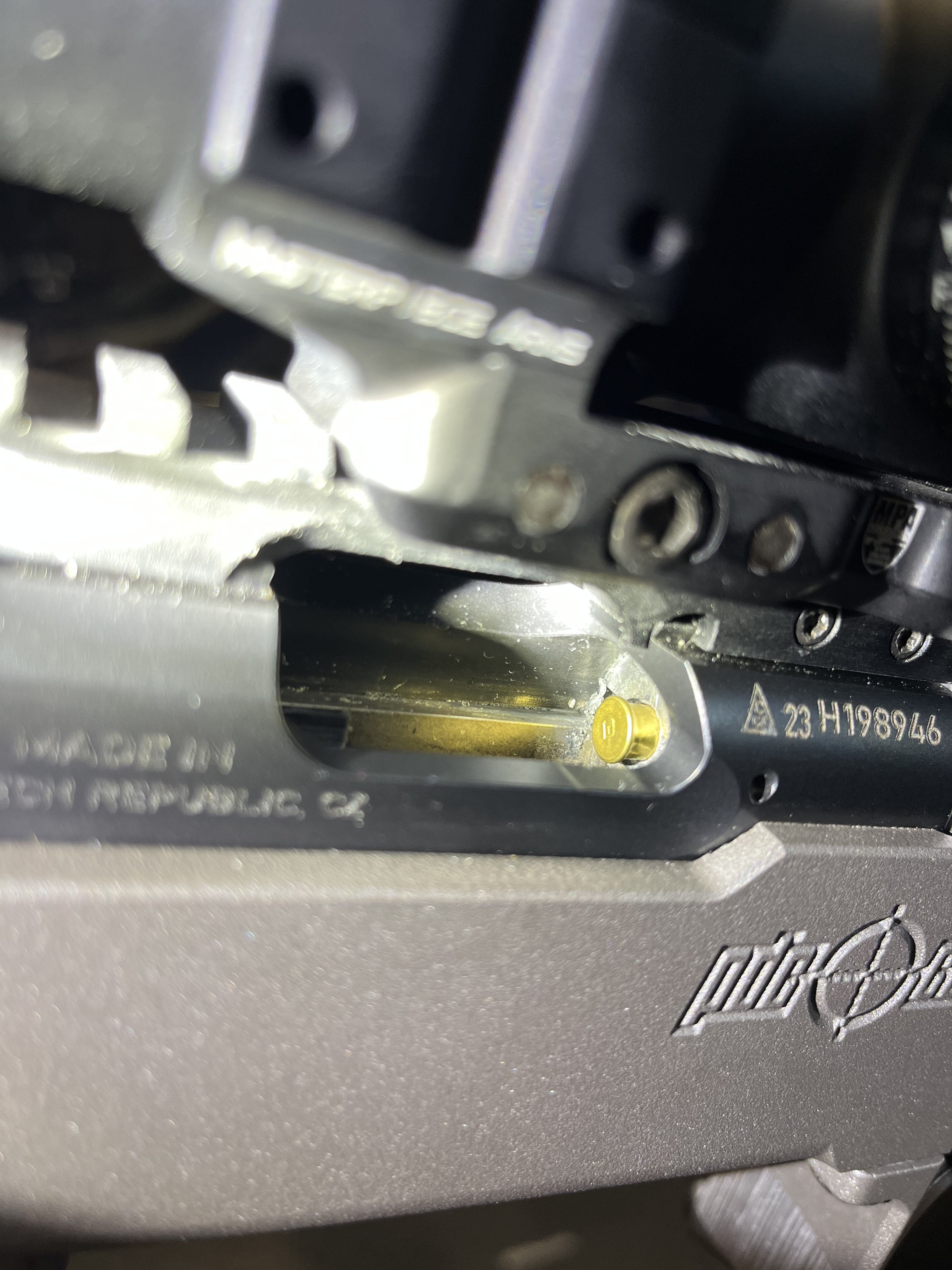

Stick out - wasp chamber:
Stick out - original chamber:

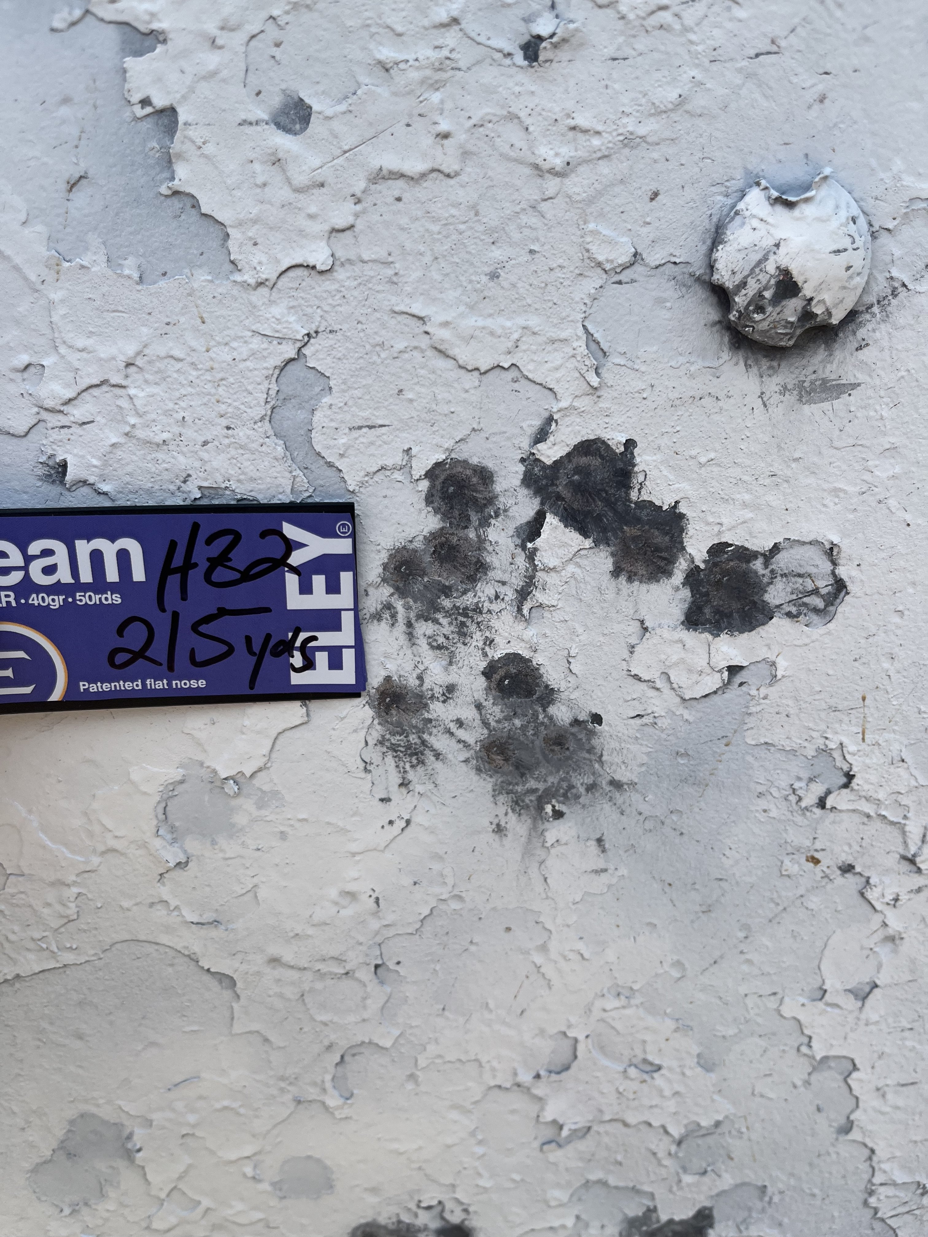

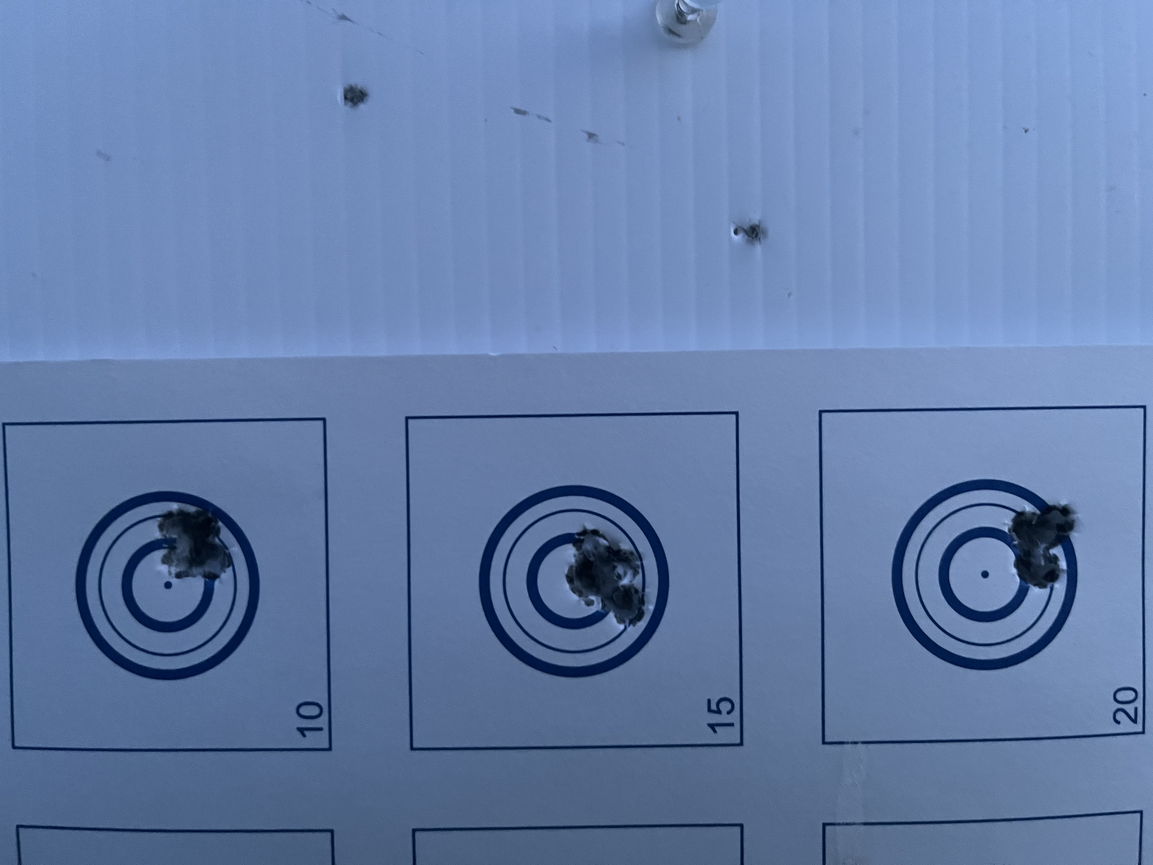

Three five shot groups. These are rounds 11-26 out of the Wasp chambered barrel. This is SK long range match. I used CCI SV to get the reticle zeroed, so these were not even fouled in. No shots were excluded. 50 yards, bipod and rear bag.
Will shoot a lot more this weekend, but I had to get out and get some rounds through this rifle. It loads very easily, as I noted when the barrel was first installed.
Again, brand new CZ with a brand new barrel, assembled in my garage with a pair of fix it sticks. I have plans to run eley tenex, match, team, and some Lapua center X on Sunday. Because why not?!
I shot 6 different ammo lots today through my new Wasp chambered barrel. There were lots of 0.3” 5 shot groups. Lots of them. A few smaller than that, which was great given the wind (I was not holding any based on changes/gusts).

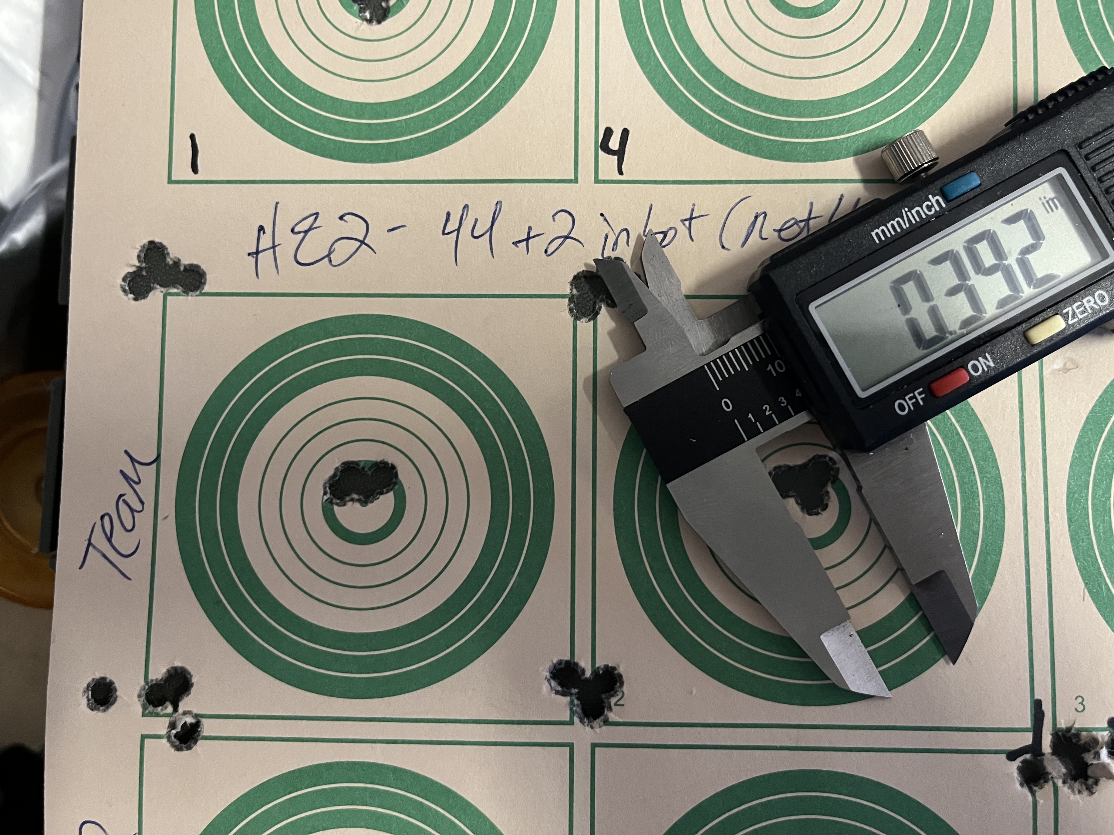

I did add a bolt shim that is 0.002 to make my effective headspace 0.042. I decided to do it that way versus pulling the barrel off. Taking the bolt apart is super quick.
This was the winner for the day. There were a couple of other lots of eley that would be shot again if this one wasn’t so incredible.

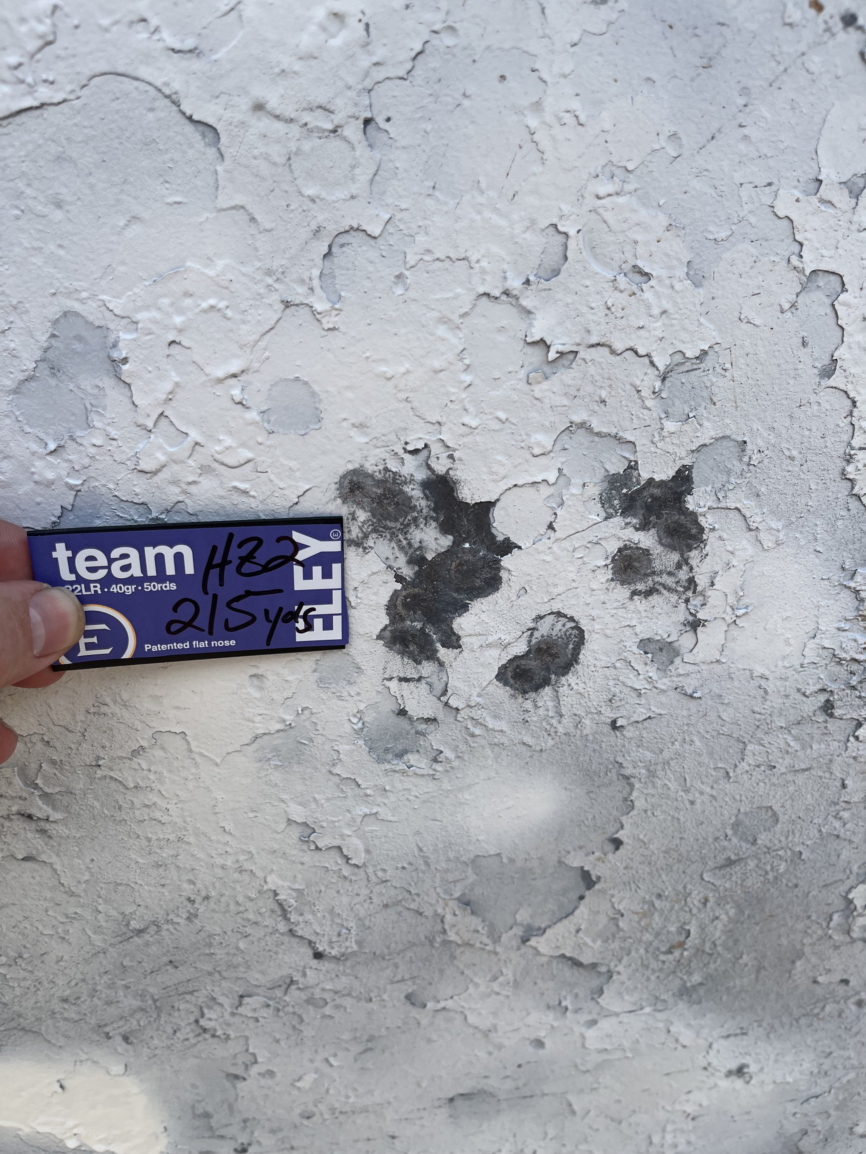

The groups at the bottom are 10 shot groups at 215 yards. You can see the wind flags in one of the pictures below.
