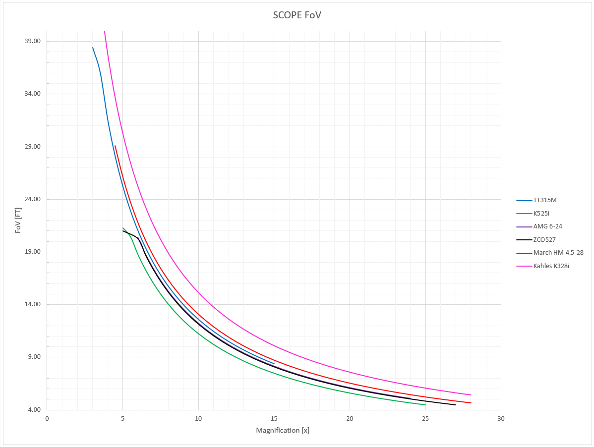

I'm guesstimating on my math here and admit I don't know how these calculations work but I'd think a 5-25x would have FOV numbers around 40.3-10.4'. I could be completely wrong though.
If you keep the same 28.7 degree apparent field of view at as the k328, a 5-25 version would have a field of view of 10.05 yards @ 100 yards @ 5x and 2.00 yards @ 100 yards @ 25x.
Kiba is a math wiz who taught me about arctan's, so I would trust his numbers :sneaky:

The 328i has a listed 5.9' FOV on 28x, wouldn't it be bigger than 2 yards (6') on 25x since it's already 2 yards at 28x? Super noob when it comes to this stuff and apologies if I'm derailing the thread.
Specs show an FOV of 42.9'-5.4' @ 100y on the Kahles website.
The AFOV of the k328 isn't constant over the mag range. According to the Kahles specs the AFOV calculates out to be 28.48 degrees at 3.5x and 28.87 degrees at 28x. For simplicity I used a 28.7 degrees average apparent field of view to calculate the FOV of a hypothetical 5-25x version, so there is a little wiggle in those numbers I posted.
Eating lunch while at work, so this is quick & dirty comparison. Graph is rough calc'd, not from empirical observations.
As has been pointed out in this thread & others, there is something wonky going on with the stated FoV specs from ZCO.
