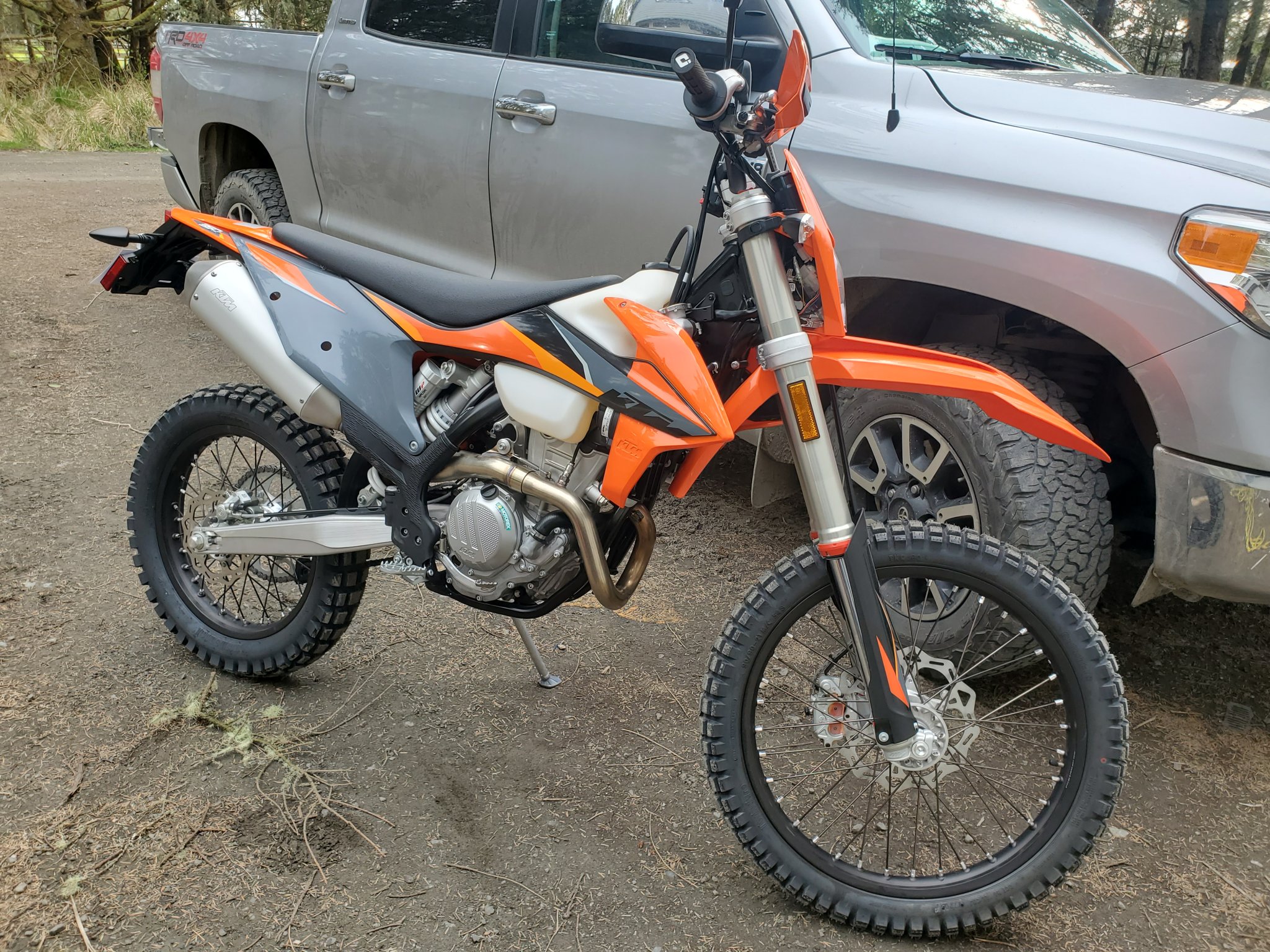

I just got a new KTM exc 350. I got home and the dealer is closed now.
So my problem is this thing start just fine, responds to the throttle while I'm in neutral. However as soon as I try to go it sputters and wants to die. In first gear I can get upto about 9 or 10mph where it dies. It starts right back up, but it will not accelerate at all.

Hope the bike is a simple fix. Sounds like it’s starving for fuel to me. I’m going with the fuel filter. Maybe the tank didn’t get cleaned out well at the factory.
Not familiar with fuel injected bikes but did work on auto stuff for years. Sound like a fuel delivery problem, either volume or pressure.
Could be a line fom the petcock be crimped either from mis routing or stuck betwene someyhing. Could be a restricted fuel filter. Could be a pump with insuicient flow. Could be wiring issue to the pump I.E. bad connection to the pump. I would think any pump issue would throw a code.

Well. It ended up being lots of shit left in the tank from manufacturing. Clogged the small inline filter inside of the quick connect. The dealer drained the fuel into a jar and it was immediately evident. Went thru 3 or 4 filters at the dealer, but seems to be ok now. Just did a quick 10mile loop and it runs fine now.
As a rule of thumb, I change those in line filters every 3 or 4 oil changes and keep a couple in my pack when I ride, to avoid this. I’ve still had to change one on the trail before.
Seems dumb but it’s way better than clogging the injector. Glad your bike is good to go.
