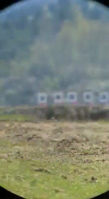

I have attached a mirage recorded with the phone through the Swarovski STR scope at targets of 1107m, 15C, 44% Rh, 4m/s wind.
It would be very interesting to see a comparison with MARCH HM10-60*56 under the same condition.
At 50X, my FOV is one full target and 2/3 of the target on either side. Your video looks to be at about 20X and in no way would compare to the 10-60X56 HM at 50X. You need to compare at the same magnification, in the same conditions, at the same time.
