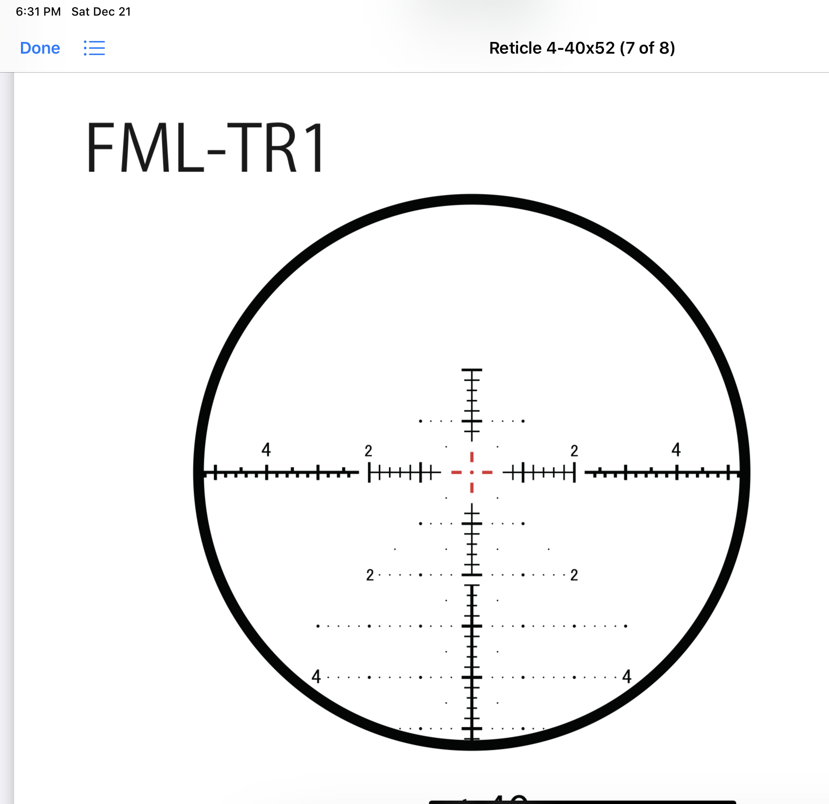

I do look forward to actually looking through the FML-TR1.
At first glance it’s the center dot combined with the cross that seems odd/different.
(and overall crosshair thickness that may just be the pdf)
I have been experimenting with that arrangement and it seems to work well for high erector ratio scopes. On high power, it is not very obtrusive and everything is based on 0.2mrad. On low power, it looks like a small illuminated cross. The dot alone gets too small on low power for my taste and I do not like to bring all of the vertical and horizontal hashes too close to the center because that obscures things.
ILya
Reactions: ddavis
I think the FML-TR1 is the best March reticle I’ve seen to date. I assume @koshkin had a hand in its design. I prefer his version of this reticle in the Meopta that he did, with the numbers on the tree alternating sides as they go down, and the shorter top cross.
My 2 cents is that the first line should extend to 2 mrad instead of just 1. Varmint shooting and prairie wind push my bullets past 1 mrad. Remember one of the most popular PRS reticles, the 2c in the Razor gen Ii, went to 2 mrad left/right on that first, lower line.
I can’t figure out why most scope manufacturers didn’t copy that feature. Exceptions: The Nightforce Mil-XT goes to 3 mrad, and the S&B grid or GR2ID (whatever) goes to 3 or more mrad, if memory serves.

I would add the large tapering outside lines (like the current FML-1) to all FFP designs, it makes the reticles actually usable at low powers, and disappears at the higher powers....no downside at all, IMO.
On that note, I might make said lines taper out further and wider. They look thin enough to be frustrating when looking at a deer in a thicket on a sunny day.
Otherwise I really like this reticle and may have a hard decision to make between this and a ZCO...

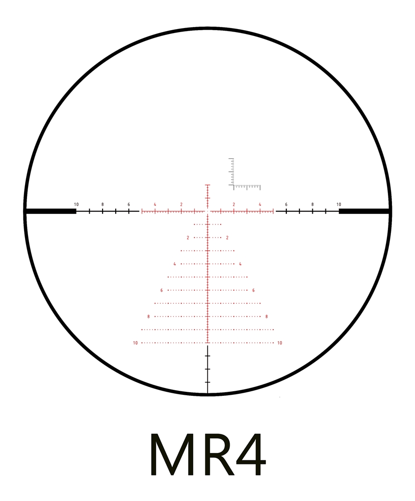

Sheesh, another reticle miss for March.
I really like March, but MSR, SKMR, MPCT2 and Minox MSR4 are so close to being just right, why does March always try to beat a new path??
How so? The reticle is an uncluttered .2 mil hash similar to MR4 with dots in the tree?
I own both March and ZRO. I can tell you first hand that the ZRO line is far superior. Not knocking March as they are fine but as others have stated, there are a few things that could be improved.
To me, it’s a personal prefernce I guess.
Keep in mind that is at 42x, backed off to 25x and they might be very close. The MR4 goes all the way to within .2 mil of the dot while the FML-TR1 has the .2 mil width cross. But yes, the MR4 and Gen 3XR are my favorite right now. I’ll be curious to see how this looks in real world, I didn’t think I’d like the EBR-7 in the AMG but found it to be very usable in the field.

Better than anything March has had so far but they’re all just too complicated and distracting. Not streamlined.
.2 mil hashes vertical and horizontal with no breaks or gaps just run them straight to the centre with a floating dot. So in other words MPCT1 and then play with thickness and length of the hashes, alternating lengths etc.
The reason for the gap is to differentiate between line thicknesses. For the +/- 2 mrad from center, the lines are a lot thinner than the ones outside of that.
Making everything equally thin does note work well on low power, while thick lines around the center would look kinda massive on high power.

Once I figured out the center crosshair sub-tensions, the FML-TR1 is growing on me. I really like March's ability to parallax down to 10 yards.
I'll be ordering one and look forward to seeing it in person.

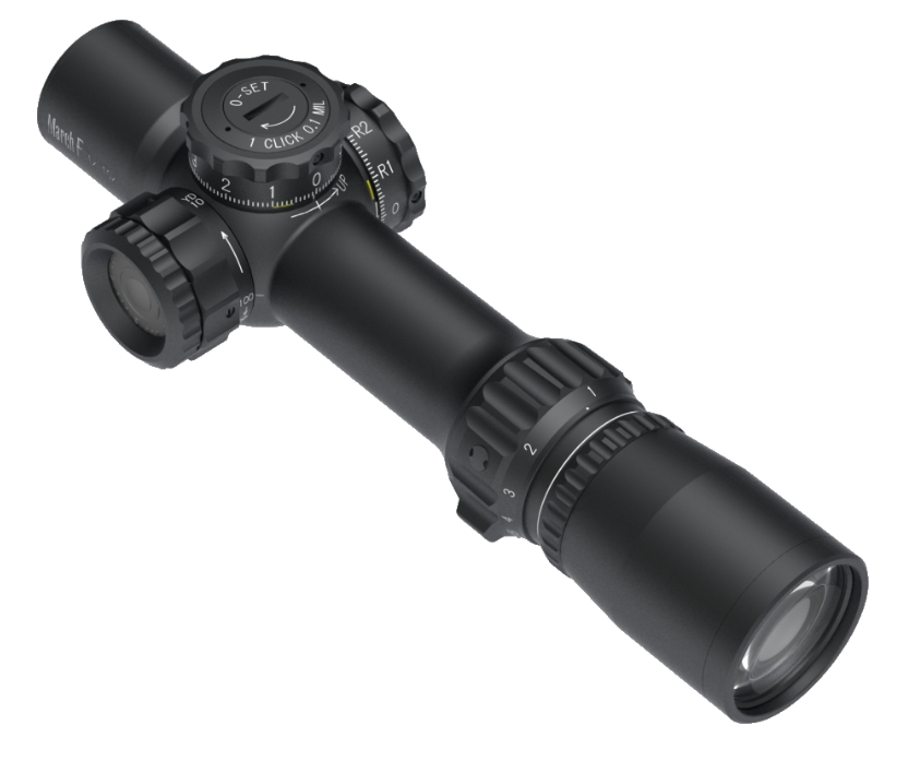

So March just posted on their website they have a new 1-10x24mm Shorty FFP scope. With the news this week from Vortex about their new Razor Gen III 1-10x24, this sure makes things interesting on the LPVO front. It is a 30mm tube and is short, light and has a side parallax which is pretty cool. While I'm not too excited about the existing reticles; however, they do mention they have more that are being designed, if they can get a good mil reticle with Christmas tree that works from 1x to 10x that would be impressive indeed.
top reticle
All the information you need with being busy,obtrusive and confusing.
bottom reticle
Lots of pizazz to attract someone who doesn’t know what they truly want in a reticle yet.
the MR4 and ZCO tree I think are close to perfection for what I want.
I think you meant to say "without being busy..." above, but I hear what you are saying. I agree that the MR4 is one of the best out, I had the ZCO MPCT2 in some of my reviews and while I like the overall design and thickness I do not like the solid horizontal lines in the Christmas tree, I found them to be distracting when I was hunting for targets, the SKMR3 has a similar design and while thinner than the MPCT2 it too can be distracting. I'd love to see a MPCT3 that has dots in the Christmas tree instead of solid lines. A blend of the MR4 and MPCT2 would be ideal IMO. The FML-TR1 reticle provides enough information without being too busy once you figure out the center crosshair is .2 mil away from the center dot and .2 mil across, some might find that confusing at first and some will like that only the cross and dot are illuminated, but I actually prefer the whole reticle to be illuminated for low light holds.
If the MR4 and MPCT2 mated and had a baby it could awesome.
Really stupid question, but where do rings go on that tube?
Reactions: ddavis
Appears the 1-10 is concept only and production is 1-8??
I was wondering the same thing. I did a google search of the March 1-8x24 shorty since they share the same design. I came across this video. Looks like a company in the UK makes a mount that has a larger (40 mm) ring to clamp over the bell.
Reactions: Glassaholic
I just read the same thing. Apparently they won’t even have a prototype at shot this year. Only “more details”
That is correct, their website says concept, they are going to have the concept 4.5-28x52 so hopefully they'll also have the concept 1-10x24 FFP at SHOT.
There are a couple of 1-10x24 prototypes in existence. Hopefully, they will have one.
1-8X24 Shorty is in production. I have one.
ILya
Ilya, any chance, that you‘re aware of, of the adjustable parallax being an option on the 1-8 moving forward? Or perhaps that, plus the greater magnification range, will differentiate the 1-10.
I should think that adding a side focus to the existing 1-8X24 is more than just adding "an option". That's a new scope.
That's pretty slick with the mount that clamps onto the front objective
Not an “option” as in a retrofit for the existing 1-8s, but now that they‘ve offered it in the Shorty package I doubt it‘s much of a leap for them to offer it in the 1-8.
Theoretically, they could, but given that the 1-10x24 is effectively the same size has side focus, I am not sure what would be the reason to go through re-design of the 1-8x.
ILya
It is generally not a good idea to clamp a ring right over the objective.
Many objective lenses have been cracked that way.
ILya
i wondered if the objective housing would be a weak spot but figured they had tested that. Curious if the Vortex Gen III 1-10 would have a similar issue if you mounted too far forward. I bet a couple of ARC M10 X-High 30mm rings would fit behind the turret or a single mount like the Lancer SMRS and offer more flexibility or mounting position, any other single mount options out there?
