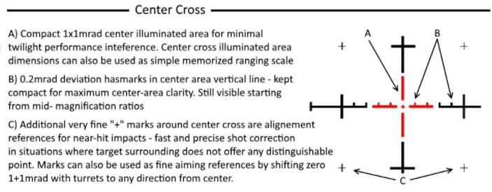

3-27 has small exception. Due to technical etching limitations in 3-27, we were forced to remove
0.2mrad "half-hasmarks", ones that are 1mrad left and right from center. Otherwise it is identical compared to
all S&B and Steiner MSR2 reticles.

Really a nice-looking reticle. I would be interested to know what drove the decision for the minor hashmarks on the elevation line to be .15 mils instead of .2. So holding on the end of the line would be .075 mils of wind instead of .1 mils. Just kind of an odd number - unless I'm just reading the diagram wrong. Honestly, I really like the overall design and I think it would look fantastic on target.

Minor 0.5mrad hasmark dimensions are balanced purely based on clear overall look and feel: Dimensions were made so that 1mrad deviation hashes are clearly dominant and 0.5mrad smaller hashmarks should not clutter clear and light feel - but are still just big enough to pop out as soon as eye focuses on them.
So principle is very simple but surpringly hard to balance in practice. May sound over-complicated explanation as it is essentially just a straight line with several short lines intersecting it. But we did try many longer and thinner / shorter and thicker alternatives, even different shapes instead of lines. Result, as it is in final reticle and original MSR already, just felt right.
Same principle was used again for MSR2 when balancing 0.2mrad half-hashmarks next to center. Idea with those too was to keep them as small as possible to keep center-area look clean, but still big enough to see them well as soon as they are actually needed.

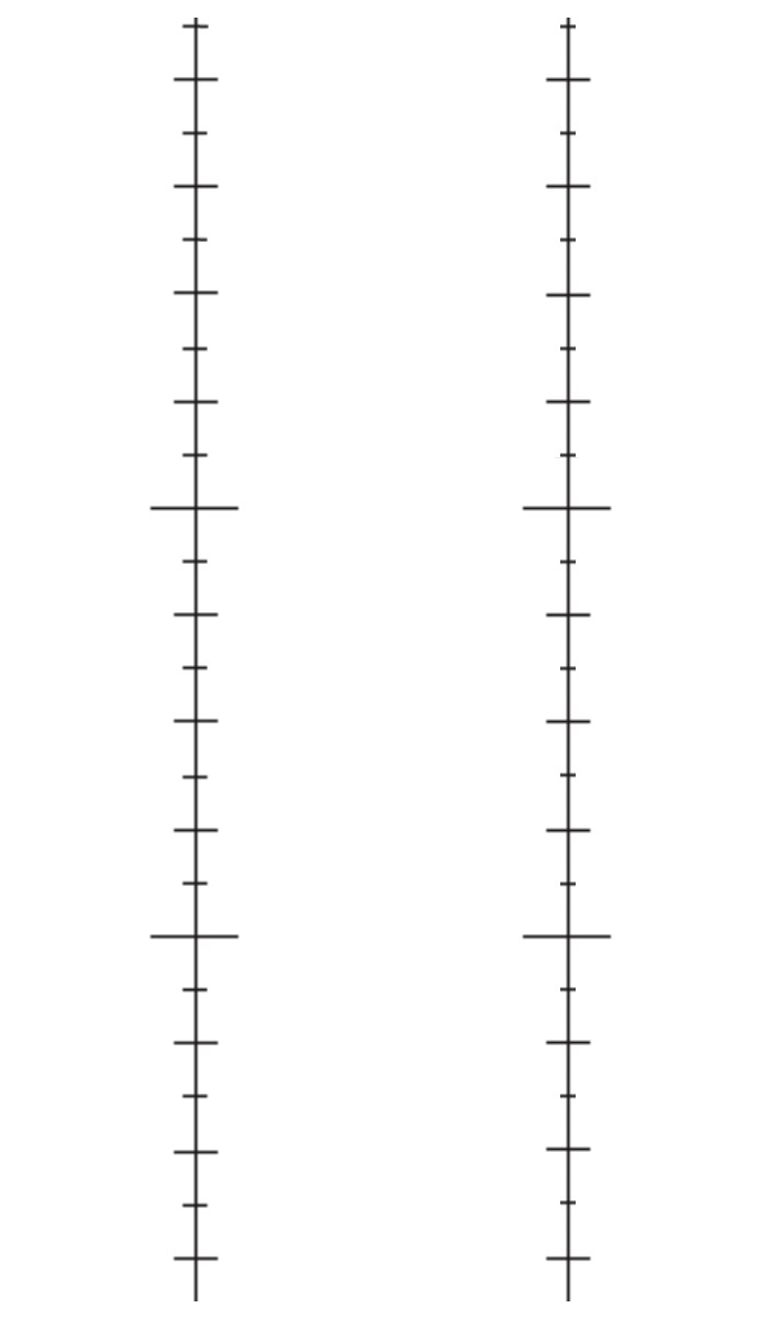

I must have communicated my question poorly. I wasn't debating whether to have minor hashmarks at .2 versus .5. I think having .2 mil hashmarks up to 1 mil of wind and then .5 after that is great. My SWFA mil quad has .5 the whole way and it works just fine, but having .2 hashmarks before I get to a mil would be a bonus.
What I was trying to ask is why the length of the minor hashmark itself was .15 instead of .2. Like I said, I could just be reading the subtensions incorrectly, but that's what it looks like to me.
Apologies for being unclear!
0.15mrad long 0.5mrad minor hashmark line dimensions were determined by their look/feel balance relatively to hairline and 1mrad hashes.
As said, it just felt right after trying several other dimensions too, even shapes.
Target was clear and dominant 1mrad stepped basic deviation look, but 0.5mrad minors are still clearly there when looked at it.
Edit:
See image- narrow 0.5mrad minor hash as it is on MSR/MSR2 vs slightly wider 0.2mrad minor hash for reference.
Feel difference on seeing 1mrad stepped principle better is clear.
Difference is even bigger in real life when looking trough scope. When background has various geometric shapes making whole view much busier.

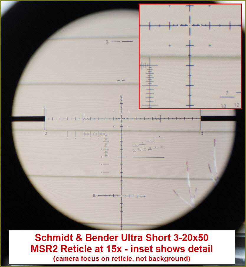

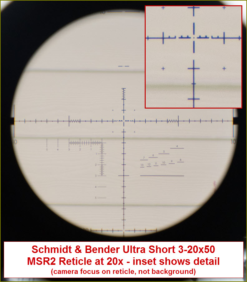

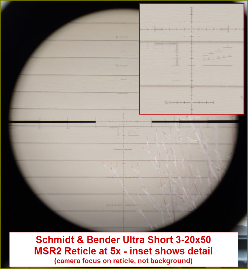

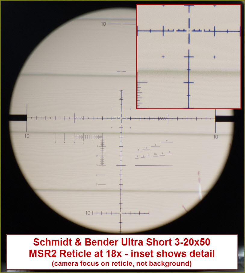

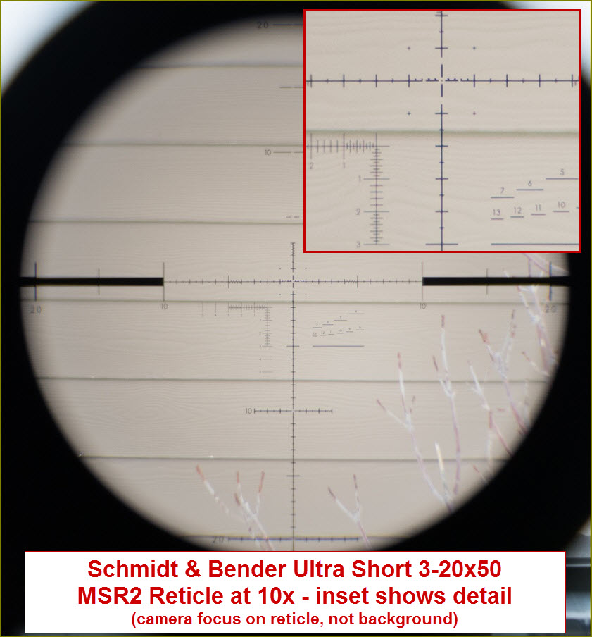

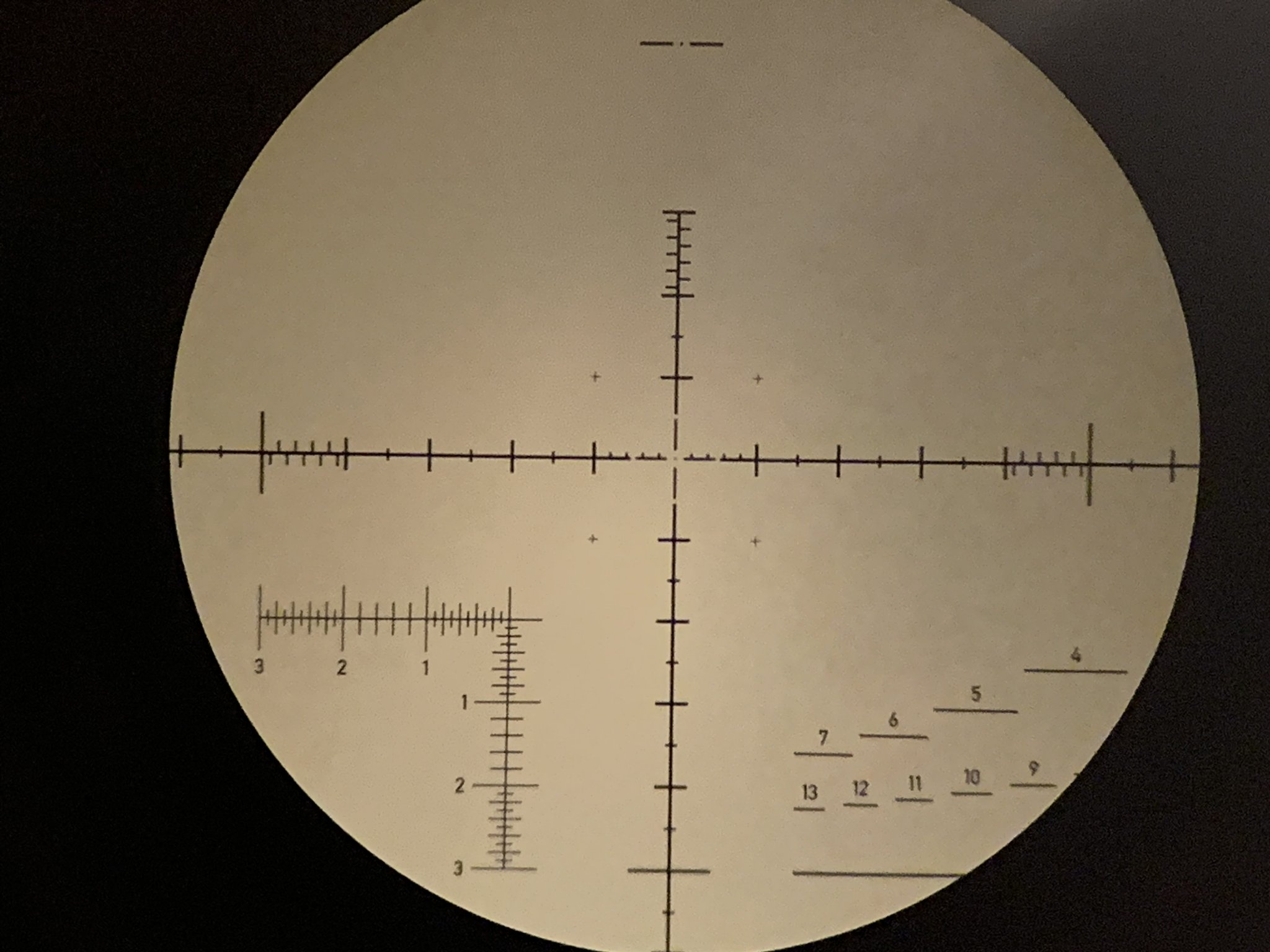

Did some through the scope pics, please do not judge the image quality of the scope based on these images - the image through the scope was stellar for both scopes and any distortion you might notice is due to the position of my camera/lens bot being perfectly aligned with the scopes glass as well as the distortion inherent in camera lenses through other optical lens elements. I tried my best to focus on the reticle and get a clear image of how it looks at each magnification.
At 3x it is barely usable and very thin, but in the right conditions looks like a duplex.
7042875
At 5x it is a bit better and more usable but still fairly thin.
7042876
At 10x things really start to improve and you can even clearly see the .2 mil hash ticks but center dot is still somewhat lost, acts more like a crosshair with open center.
7042877
15x is completely usable and clear to see everything the reticle has to offer including the center dot.
7042878
18x is perfectly usable
7042879
7042880

Great pics WJM308! It's good to see the reticle at various magnifications. Huge help for me.
