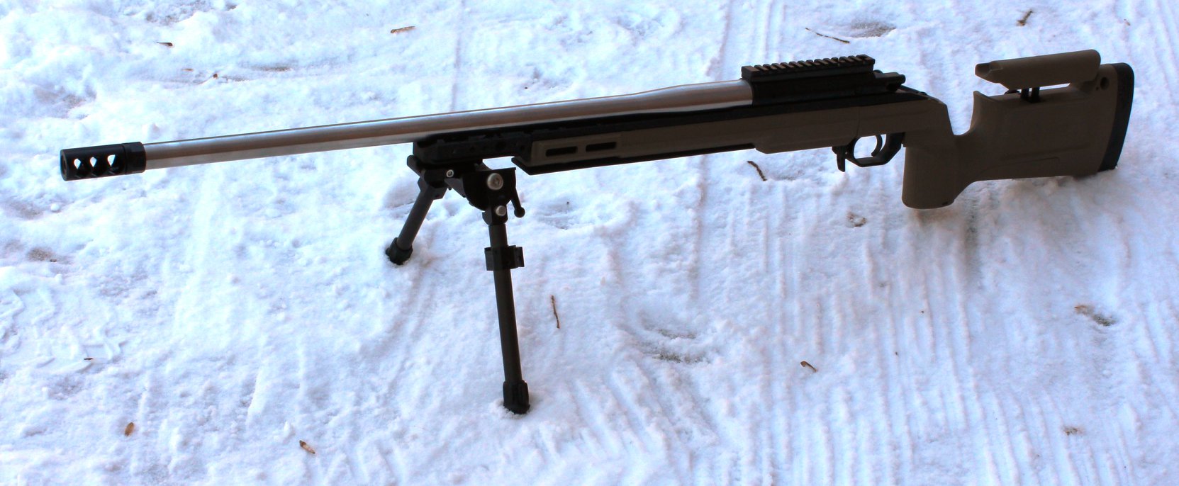

Here is a less than high quality pic of the new offering from the PVA page...

What barrel profile is that.
It’s ugly lol. I have no idea why but the step down from the chamber doesn’t look right.

    That pic probably doesn’t do it much justice. I’ll bet that once it’s decked out with a good scope, bipod, and all the other goodies, it’ll be one sexy bitch that’s sure to be a shooter! Are those KRG chassis compatible with their bipod spigot mounts?
    He had a pic on his FB the other day I think with all the accessories from KRG including thew spigot mount. Found it.
    It's probably like a parent looking at a kid and thinking "my child isn't ugly..." but I have to admit, that picture is not flattering. It's also snapped from a cell phone in 17F snow just outside my shop door while I'm shivering so I could show a mockup photo of the rifle for folks that are not familiar with what it would look like.
    That is a medium palma contour, normally the contour is buried down inside a stock or a taller wall of a chassis but that's the way it goes on a Bravo. Keep in mind that there is also no scope, rings, etc tacked on that rifle in the photo. If you pull that stuff off anything else it is going to look similar.
    Thanks, it's not a great pic, it's just a mock up and it has been darn cold here...
    The KRG Bravo takes their spigot mounts for ARCA and PIC rail attachments. It also comes with MLok slots molded into the chassis skins and it has the option of getting an ARCA mount plate for ARCA accessories. The ARCA mount plate, I am told, kicks it from Production Class.
