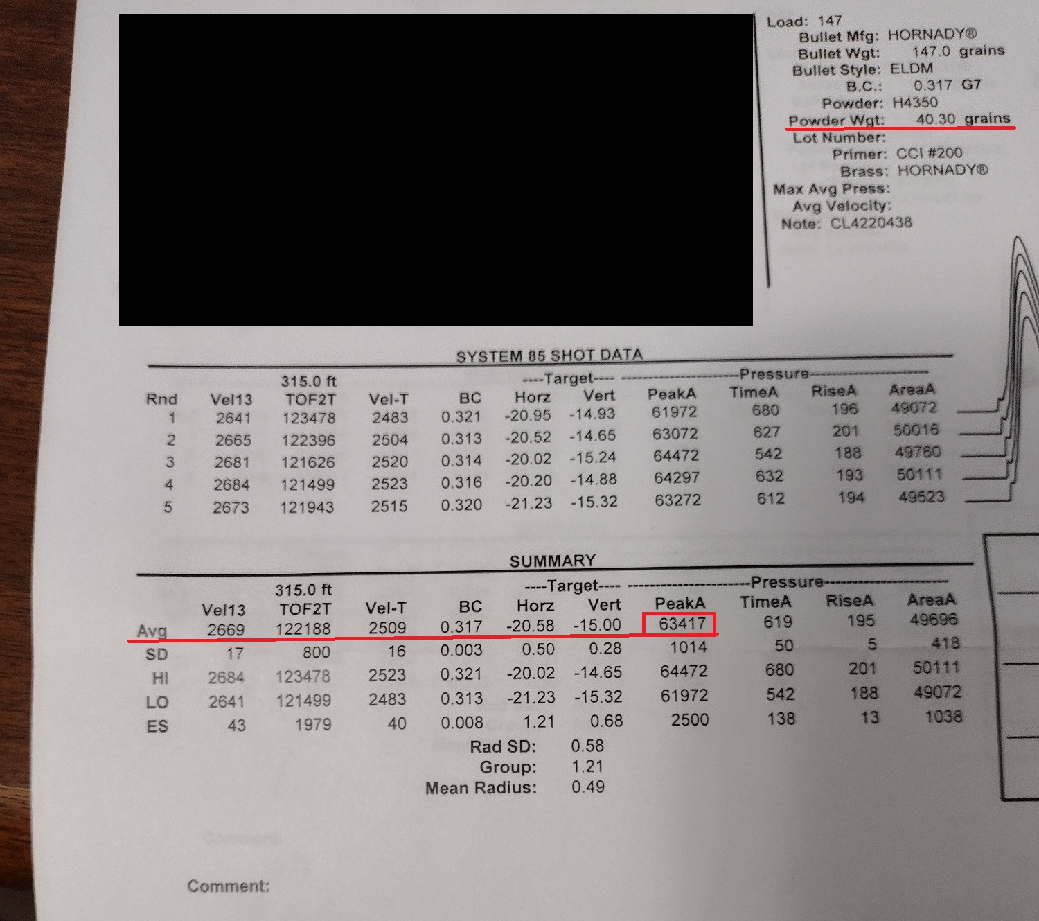

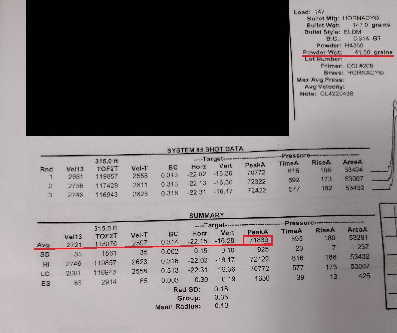

This is what happened in the barrel I tested with, with the components I used. I'm not suggesting and can't guarantee you'll get the same results with your stuff in your rifle.
Latest Hornady manual publishes 40.3gr as the max charge for H4350 in the 6.5 Creedmoor with 147-153gr match bullets... So let's see how "Lawyer loaded" it is... "PeakA" is the peak pressure of the shot. SAAMI MAP is 62,000psi for the 6.5 Creedmoor. 55-65ksi is typical across the board for modern brass cased rifle stuff. These are all at 2.800" COAL.
Oh... Turns out it's not pooched for the "litigious environment"... In fact, almost every time I've tested various book max loads in several different cartridges, they've been right at, if not slightly over SAAMI MAP.

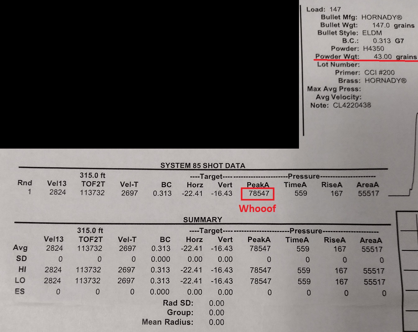

And for shits and gigs I found another post in there with someone else (actually a couple people IIRC) loading up to 43.0gr of H4350 with a Hornady 147 and I only shot 1 because at this point I was a little afraid of damaging a transducer. Obviously the guy posting this also has "no pressure signs or hard bolt lift"... :rolleyes:
