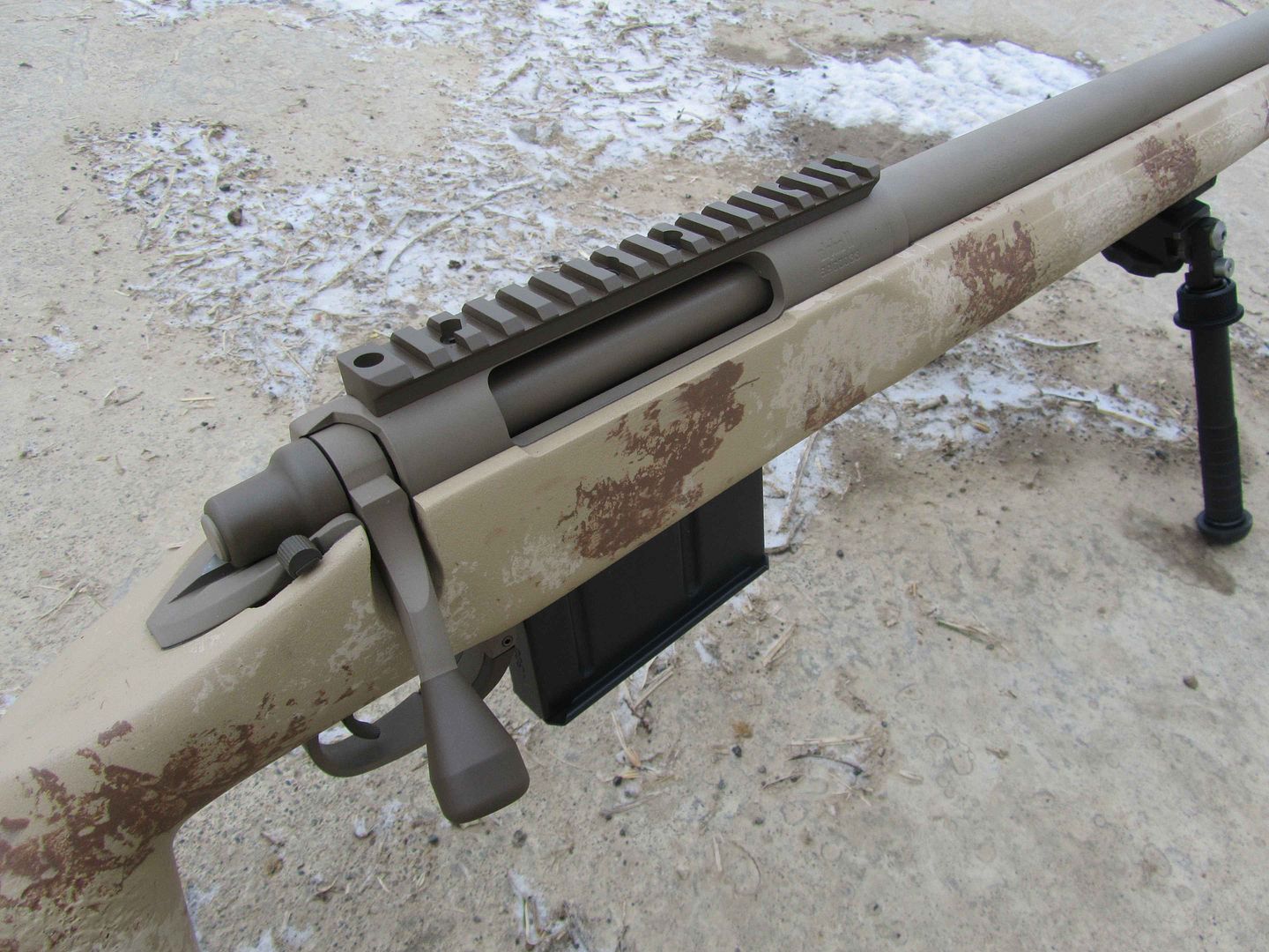

Gpowers gave me a heart attack on the phone yesterday. He called me with a dead serious tone stating that he just got back from the rang and "<span style="font-weight: bold">let me ask you this Mark, is this the best you can do?</span>" I said "<span style="font-weight: bold">What???</span>" GPowers says again, "<span style="font-weight: bold">This rifle, is this the best you can do??</span>" With my heart beating out of my chest because I was not sure if he was pissed off or what, he goes " <span style="font-weight: bold">because this rifle just shot a 3/8 MOA group with the first load I tested</span>" I hate being pranked!!!!
Anyway, here are some pictures I took before hand. I'm really happy with the color's we went with. All metal was Coyote Tan with Patriot Brown accents to match up with the stock. I really liked working with Manners Molded In Camo stocks. The Gel-Coat they use has a great texture to it and it just looks great and feels good. Its not a smooth finish like the McMillan, its slightly textured throughout. Here are the build specs.
-Short Action Custom's Alpha 11 Long Action, 20 MOA base, Lower Bolt Clearance Modification, Double pined recoil lug, Match firing control assembly, Timney 510U trigger tuned to 2 lbs.
-Bartlein M40 30 cal barrel, 1-10" twist, 5R rifling, finished at 24" with out brake.
-Manners T2A stock, molded in camo, Atlas BT-17 Rail, Atlas bipod, our Epoxy pillar bedding with some American Precision Arms "RTG" bottom metal.
Everything turned out great and I'm very pleased with the way the rifle turned out.

Mark, thanks for the better pics of my rifle. Sorry about the near heart attack, just like to give a hard time. Should have waited until you know me a little better before I started harassing you. Mark is a great guy to work with and he builds an even better rifle.
Re: New SAC build
That is absolutely gorgeous, and a shooter too! You are only 30 minutes west of me... I've got to get over to see you... Great Work!!

Sorry did not read close enough got the colors.
nice. i love the color of the acton and barrel. the two tone is a nice touch
what colors are they?
thank you
joe
Re: New SAC build
thank you gpowers. i really love the look of your gun. i am thinking about doing mine desert digi camo on the stock and tan or brown on the action and barrel.
