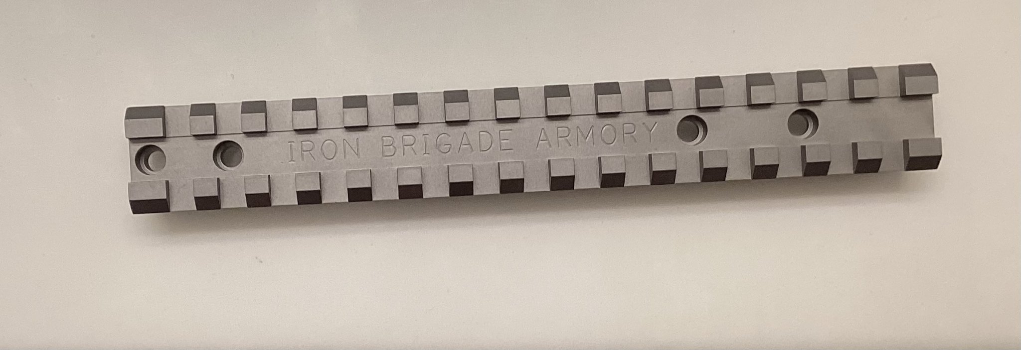

I am hung up on the scope mount and recoil ring (my lead fell apart). Does anyone have a lead on those parts for my XM3 clone build? If yes please PM me, thank you. For whoever comes through I will have a reward on a hard part to obtain for your own XM3 build.
Did you try pacific tool and guage? Shows steel and titanium. I ordered a titanium one they said in stock. Hopefully I don’t get screwed by them. I will update you when I get it.
Or IBA. There’s is steel not titanium
As far a recoil lug I’m using a Stainless Badger Ordnance on mine. I could not find anything in titanium

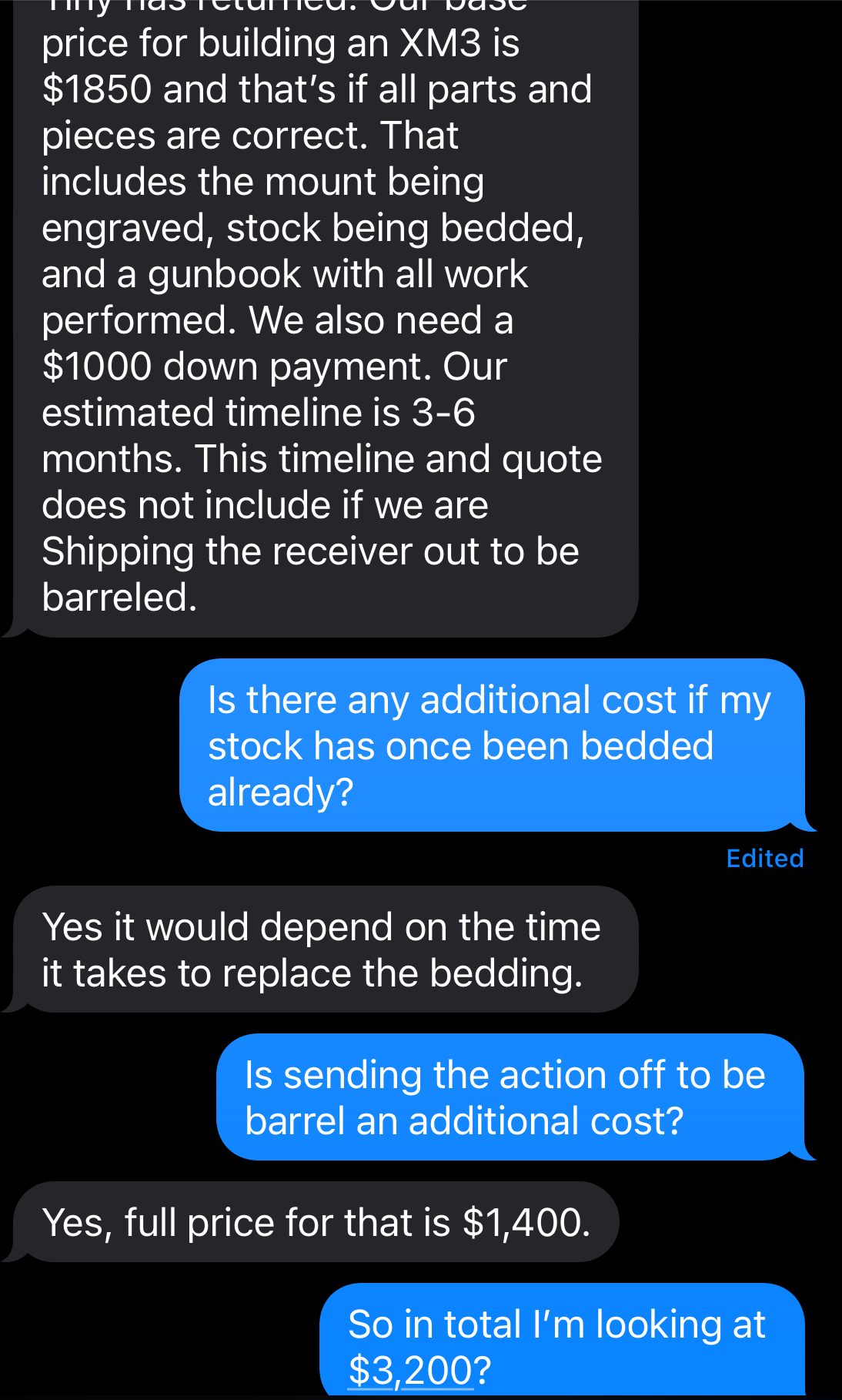

Depending on your reputation as a gun smith $1,000 for a build $1,500 if there is a good bit of fitting involved, $2k if you have a reputation, but $3k-$3.5k is as much as all the parts combined. That is just my opinion. It's too much. With BG Defense (Type A Rifles), the price I was given was $6,900 which is $3k for smith fees from a company that has no standing like Tac Ops who has the reputation to deserve $3k or more smith fees. That is my point. Or IBA who has the provenance and reputation to charge $3,250 and be justified. And as consumers we take our money where we feel like we will get value. I will keep my money from Type A Rifles because I feel they are taking advantage of the XM3 name and making claims that are not true. That is why I started this thread. And a complete rifle build or part will go for a price that someone is willing and able to pay for it. Not what the seller thinks it is worth.
I was quoted way less than that as long as I had all my parts.
Correct, however there is an additional charge of $1,400 if you have a barrel blank and need it installed.
Oh shit they never said that when I emailed them.
Yep, I talked to Sabien Chandler yesterday and just received this same information. However, if you already have a Hart barrel blank, it should be less than the $1,400 that Hart is charging for their part of the build. You still nees to send all of your parts to IBA because they'll do some work to the receiver before sending it out to Hart. They're only using Hart for these XM3 builds and a few other rifles that use Hart barrels, they're doing other rifles in-house with their gunsmiths. I think this is just easier for IBA to do it this way, and they've had a relationship with Hart for a long time. Hart was building the barreled actions for IBA when IBA first started up in the late 80's or whenever. After a few years, IBA moved to doing everything in-house, including building the original USMC XM3's. It's interesting to see that theyve moved back to using Hart for builds, but Hart is also a very reputable company with known history for high-quality work.
As for the price on builds that have all of the parts supplied by the customer (minus the Hart barrel blank), it's $1,850 for IBA to do their work and $1,400 for Hart to do their work. If there's a discount for the Hart work by supplying your own Hart barrel blank, then it might be around $1k for their work, but Sabien is reaching out to Hart this week to verify the price for us. That means it will be $2,850 to $3,250 for an XM3 built by IBA/Hart.
Don't let this price be a turnoff, there is nothing insane about this build cost! If you gather all the correct parts, such as an original Remington S prefix serial number receiver and reproduction titanium parts, the price of the parts kit is probably going to be around $3,500. You can obviously spend even less than this, if you want. In total, $3,500 plus $3,250 is $6,750 (and you can spend even less on the parts of you want, which will lower the cost). The original price for just an IBA XM3 rifle was $8,541 in 2006 dollars, which are worth over $13,000 in 2024 dollars with inflation taken into consideration!!! So, even spending under $7k today is MUCH cheaper than buying one of the original IBA XM3's back in 2006! I purchased an original IBA XM3 prototype from them back in 2012 and it cost me about $9,500 with the NightForce NXS scope. I sold that rifle to a friend for a little over $10,000 a few years ago. Before these new IBA XM3's were being built, you'd have to pay over $10,000 for an IBA XM3 civilian build, or currently over $20,000 for an original USMC IBA XM3 at CMP auction. Those were your only options for a real IBA XM3 build, but now you can get one done for a fraction of those prices! Taking all of this into consideration, the $6,750 price is completely reasonable! And right now they're charging more than that for a 100% IBA/Hart complete XM3 without any customer supplied parts, so it's far cheaper to source your own parts.

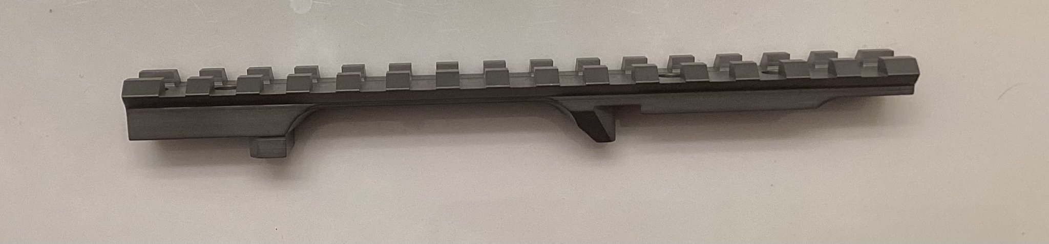

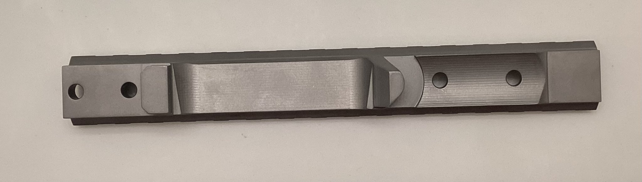

I ended up purchasing a titanium scope mount from PTG hopefully it is very close to the correct one and I actually get it.
Any ideas where to get a correct recoil lug?

I talked to PTG today and they are doing a run of the TI recoil legs. They will be over $100 and the TI scope base is $350 Ref #F66940C3 to order.
They did not happen to give an ETA on the recoil lugs did they? I know PTG can be notoriously long on their lead time. I get it everyone is busy and do not just drop everything for one part.

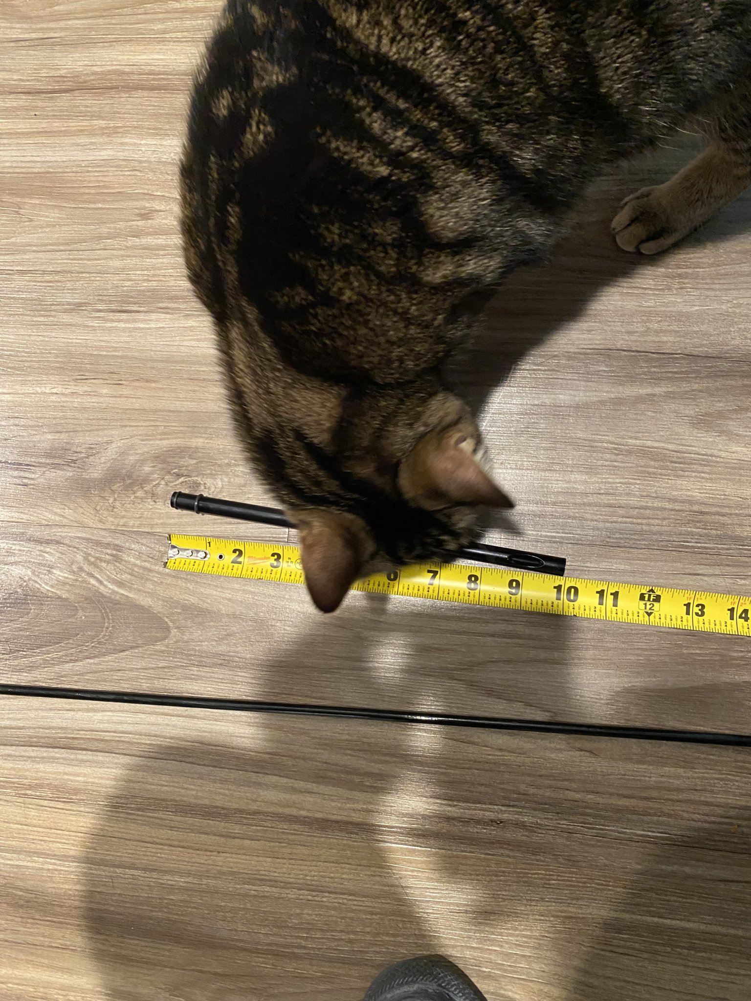

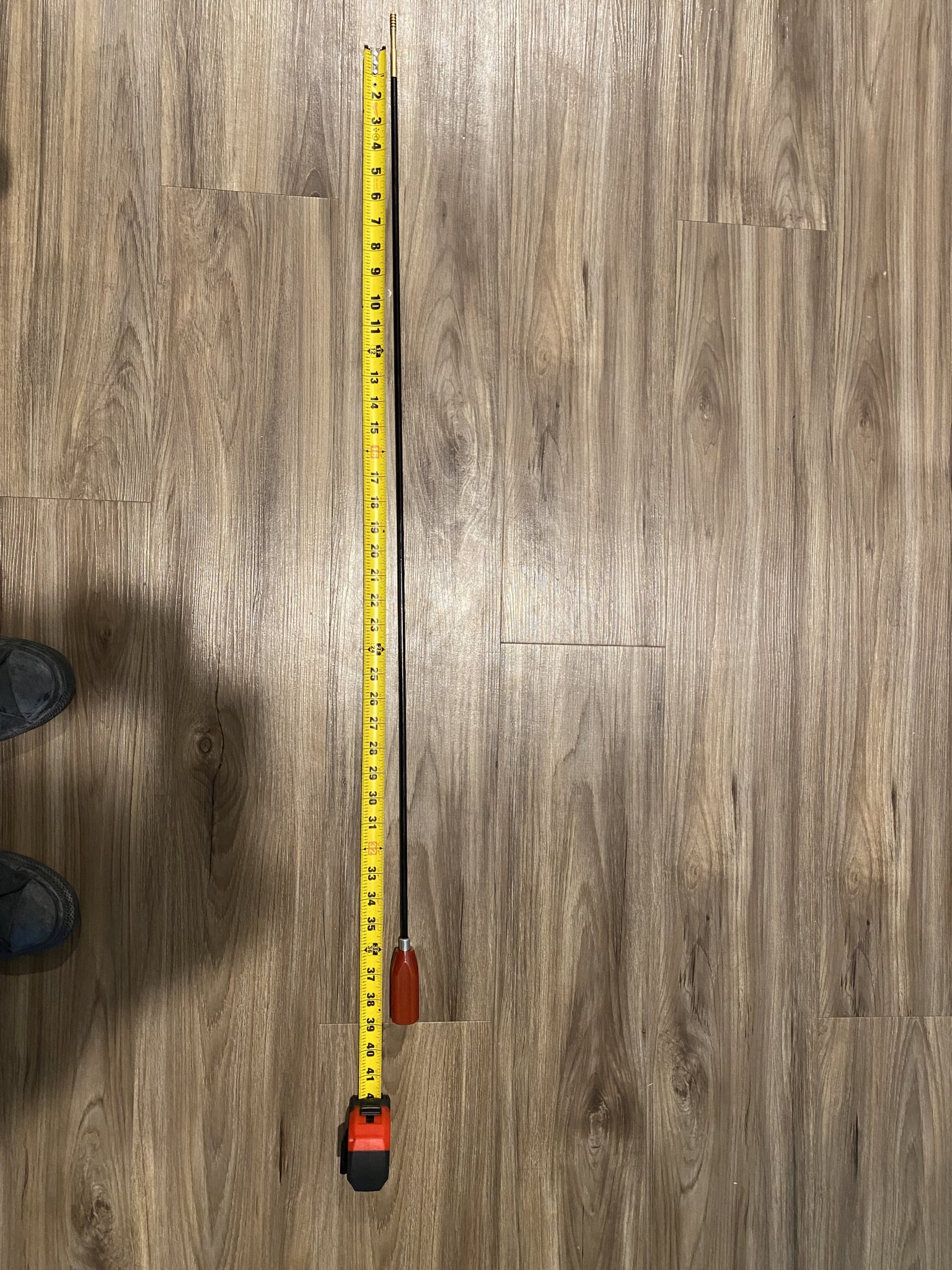

Two questions
1. How long is the Dewey cleaning rod? I only see 36” and 40” on their site
2. How long is the Dewey bore guide. 10” or 13”? I see it fits in the craftsman case that is 12” long so I am assuming it’s the 10”.

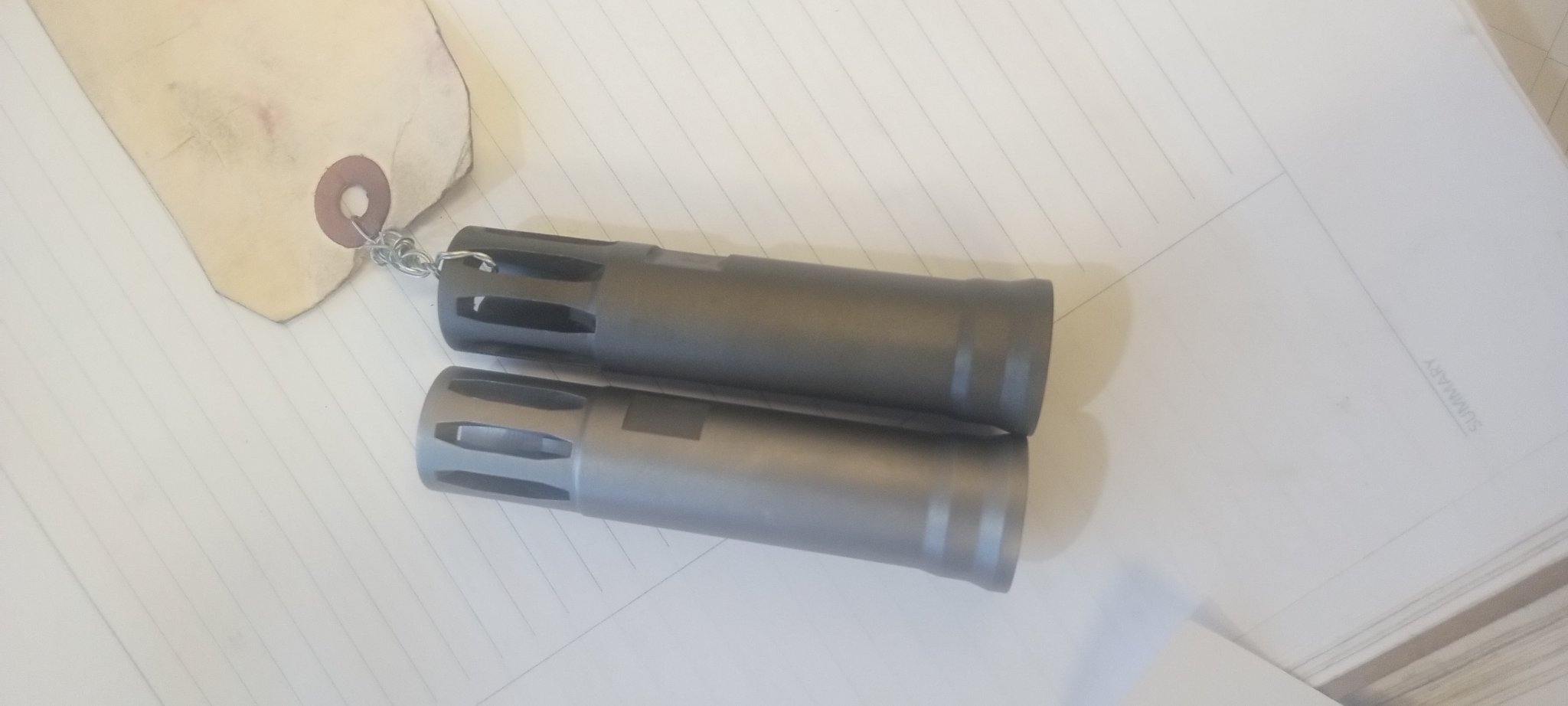

But who is making the flash hiders? That is a the hardest part of the whole thing.

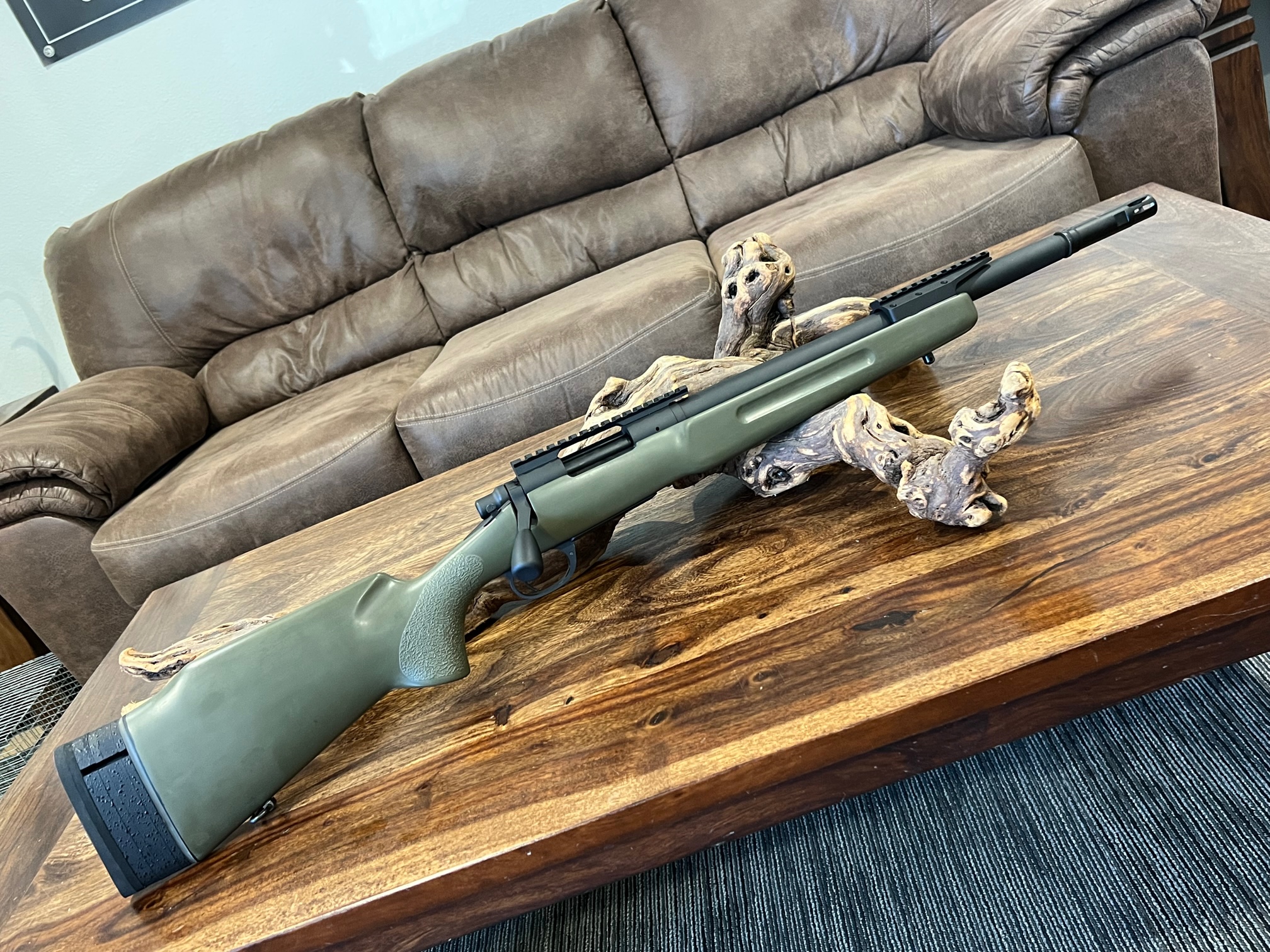

XM-3 is a total vibe. This is as close as I could get but I love it.View attachment 8450080
Very nice build! Sometimes all we can hope for is to get as close to military clone correct as possible. Some parts are so ridiculously rare and expensive, they are next to impossible to acquire. That version of the EFR is actually correct for the police and other civilian XM3 builds, just not the specific USMC version. Your XM3 clone looks great, I hope you enjoy shooting it!

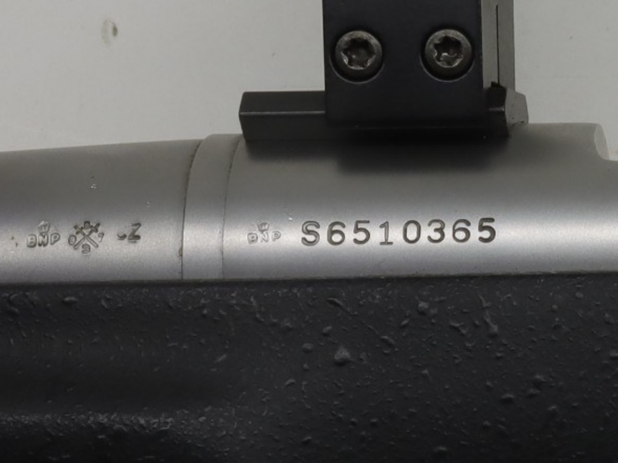

This would make a good donor. It’s close to the SN range posted by USMCSGT0331, and has a Marine Infantry MOS built in.
I guess those would be Canadian proof marks.
I won’t give out the listing right now, just in case a SH member has already seen it and is trying to make the purchase. I have no interest. Just came across it looking for M40 six digit donors.

Ptg has titanium xm3 recoil lugs. Also have repro flash hider suppressor adapters too.

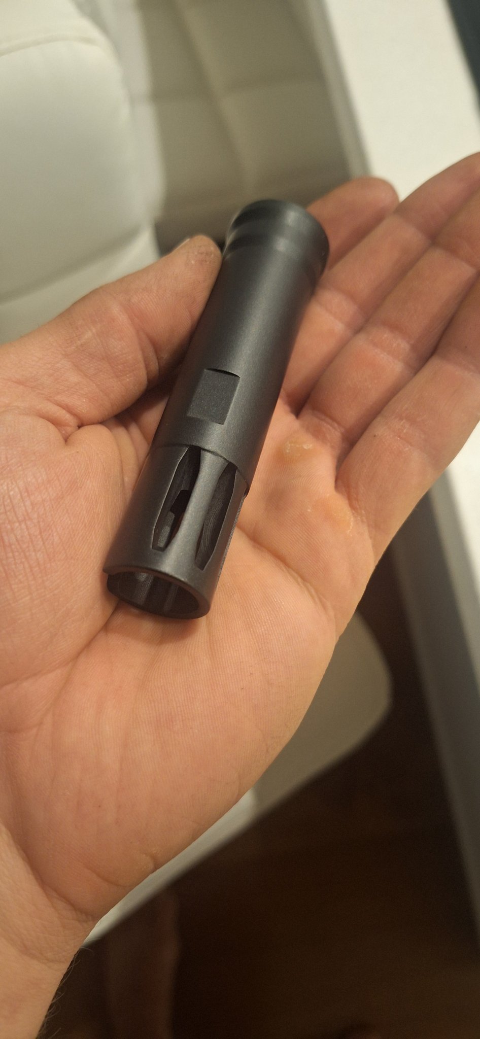

Got the PTG repro flash hider in hand today. Looks great. Color isn't correct but that's fine. No issues ordering from them. I have their repro v2 EFR on order now too.
