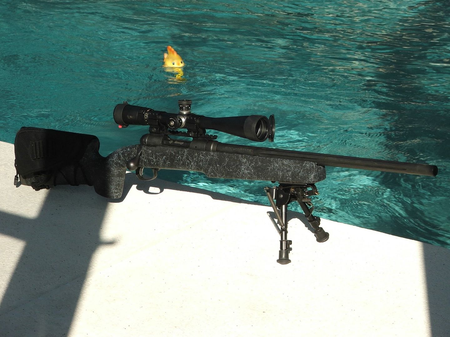

I just put my 10FCP into a B&C Varmnt Tactical. In addition to the slight fitting sometimes required to get the rear of the trigger guard to seat, and a quick 1/16" drill bit to allow the wood (rear trigger guard)screw to enter easily, you may have to clear a little material away from the area were the new bolt release slides back and forth. It may bind a little when you torque down your screws, that is why a little juducial chisel work, above the trigger guard inletting, (but out of sight when it's mounted) is required.
Since your's is the newer center feed model, if it has a detachable magazine, you'll need to order the magazine retaining clip, at minimum, direct from Savage. You can also buy a new mag box, follower and spring as well. They aren't Midway so don't look for it getting to you in two days! Also, if you have the detachable mag, the front action screw may be too short for the new stock. You'll need to order a replacement action screw, they'll sell you a set.
Keep in mind that the detachable mag can be used but you have to remove the bottom plate from it and use the Savage retaining clip to keep the rear of the mag box seated in the new stock and out of the way of the bolt's travel. I made a clip for mine that is working well enough but have parts on order from Savage anyway. The total parts cost for the mag, spring, follower, retaining clip and screws is like $30.00 clams. They'll be open tomorrow.
As long as you have the screw spacing measurement correct, the stock is a drop in fit with only minor tweakage.
A good person to talk to is a member here who works for them,
Gunner75.
Good Luck!

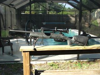

Here's how mine turned out!
