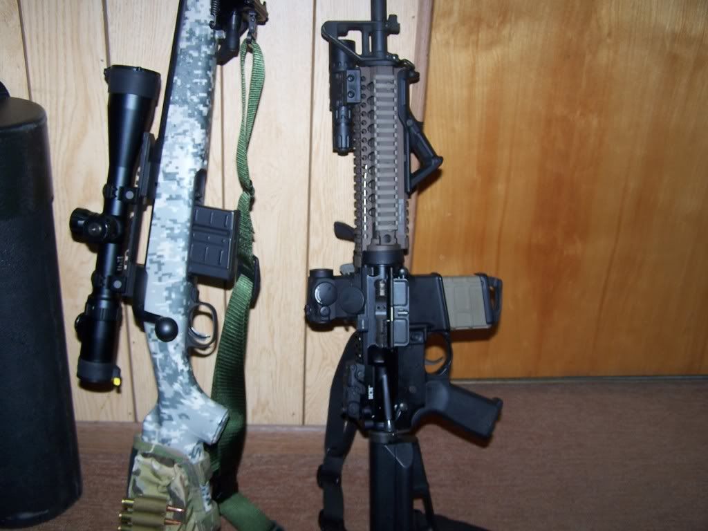

The one in front is the .223 with a bushnell 10x mil-mil scope. The second one is the .308 cut down to 14.5 inch with a fixed brake to make it 16 scope is a new IOR 2.5-10 FFP mil-mil. the one in the rear is the new 300wm scope is a bushnell 3-12 FFP mil-mil stock was done by daughter, she did pretty good.
