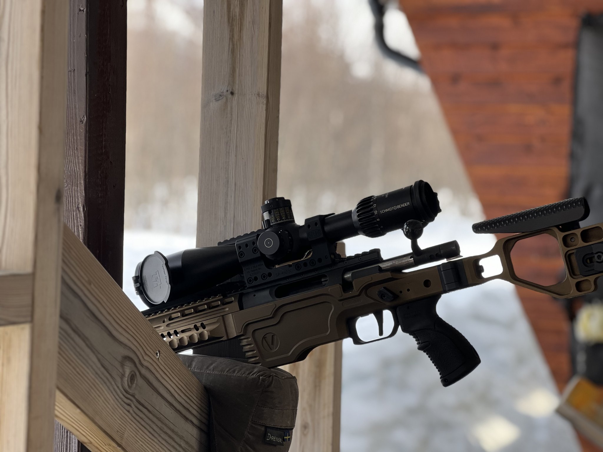

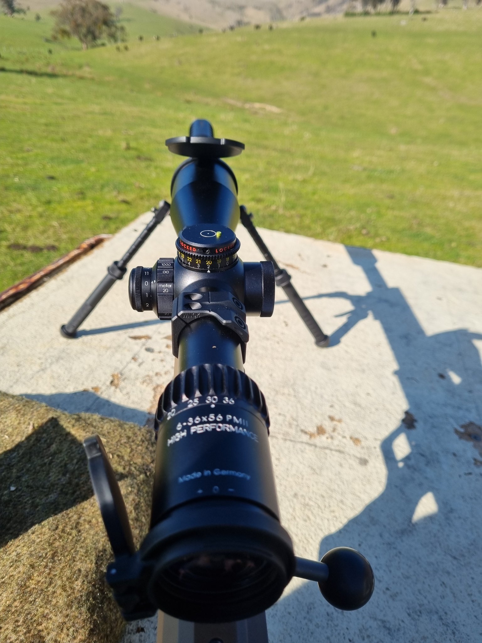

Finally the snow melted enough for us to use the range.
So far very satisfied, and living up to my expectations!

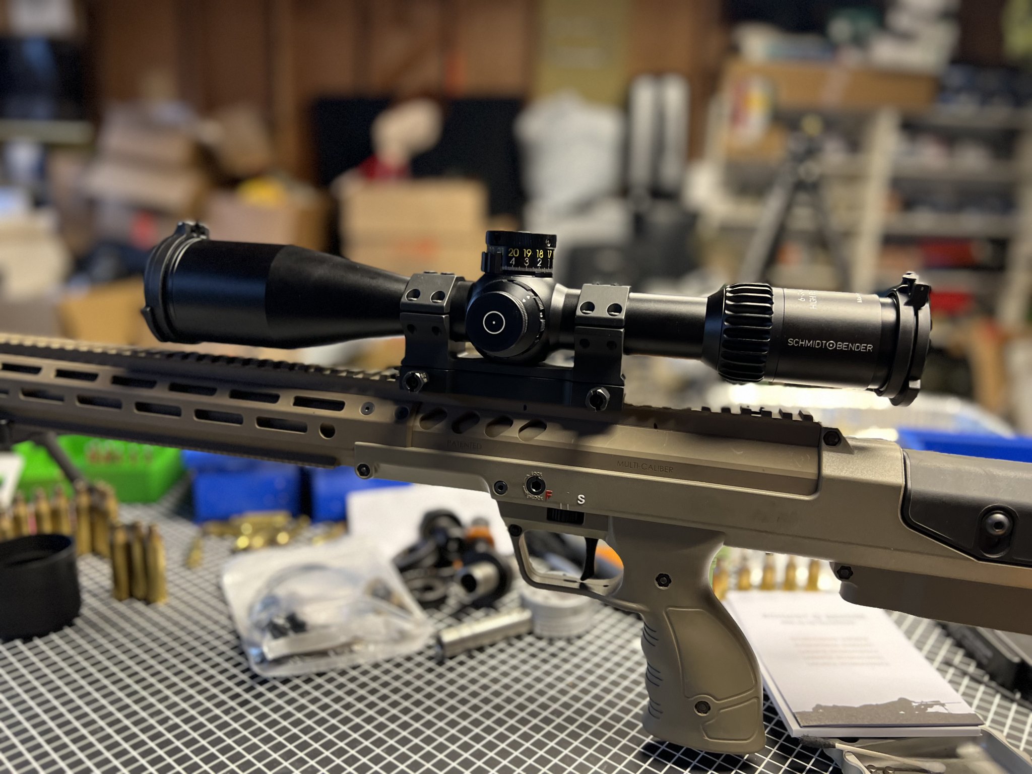

Since I always wanted a Schmidt&Bender I decided to jump on the hype train and today my 6-36 arrived, with the DTII+Turrets and the Grid reticle.
I just got to play with it so here are my thoughts on first glance:
- Fit & Finish is excellent
- The magnification and diopter rings have just the right amount tension to them

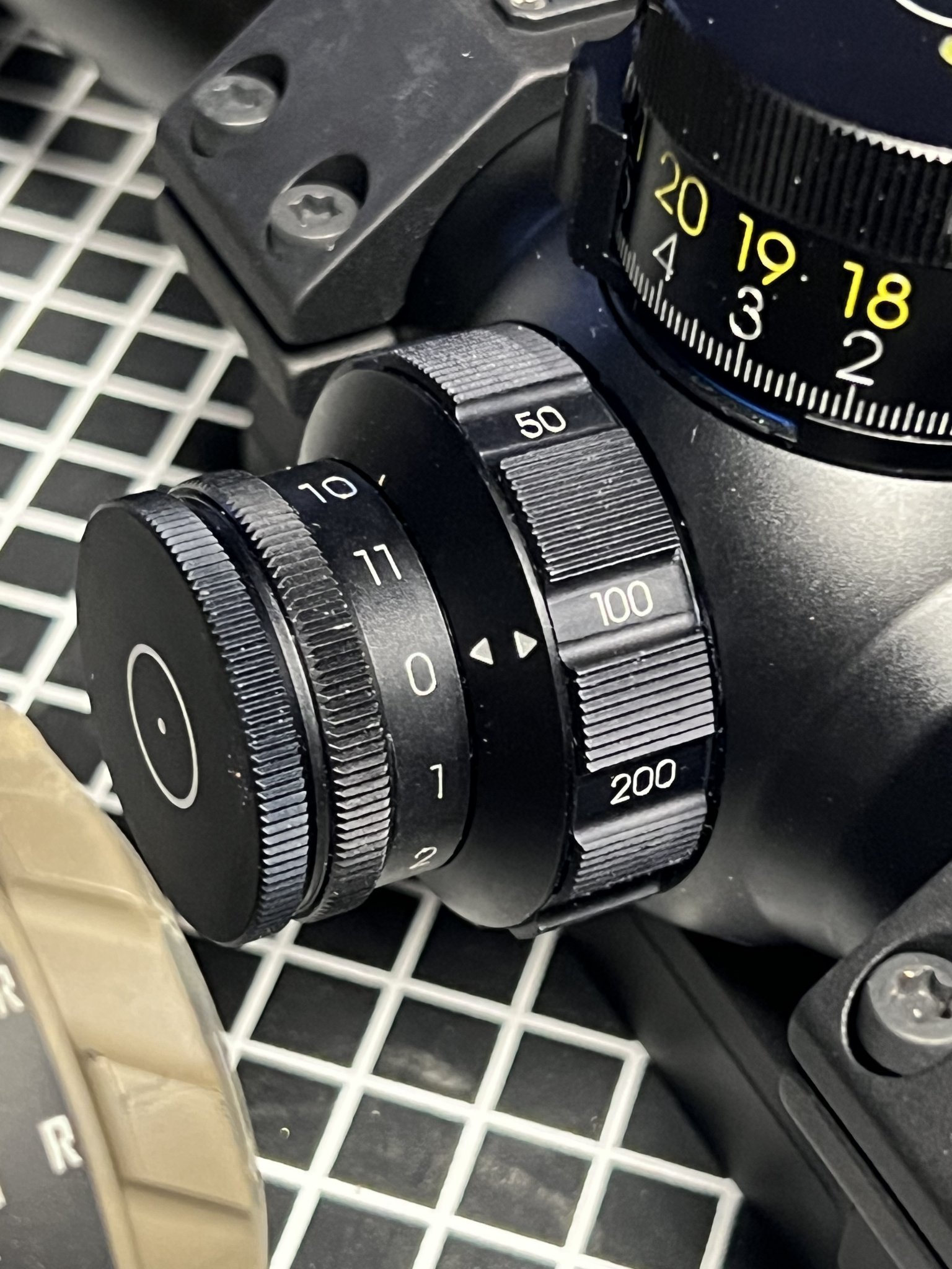

- The parallax adjustment is a tad tighter than I would have wished, escpecially with the smaller turret due to the combined illumination. But it is fine to work with.
- The clicks on the elevation turret are nice and tactile and feel pretty much like my ZP5 but more audible.
- The clicks on the windage turret are also like my ZP5 (sadly) and they feel a little less tacticle and are less audible compared to the elevation. The Zero Click also makes it harder to adjust just one click from the zero position. But the windage turret will be locked most of the time after zeroing anyway.
- The locking mechanism for the elevation turret works fine and thankfully the MTC can be deactivated, since I am not a fan of that. The only annoyance is that when you switch to regular clicks (without MTC) the locking lever sits right above the parallax wheel which means you can bump into it when you you have to make bigger parallax adjustments.
-Optical quality is superb as far as I could test it, as expected the eyebox gets tight toward the 36x magnification and you will see some chromatic aberration when you are not perfectible centered in the eyebox. This probably wont be a problem once it is mounted and with a well adjusted head postion. But the detail you can pick up with it is amazing from the short time I got to play with it.
The Grid Reticle makes it noticable that the picture is "pillow" shaped, so you will see the reticle bend, starting at the lower third of the picture. I'll have to see how and if that is a problem/annoying when using it.
All in all I am happy with it so far, and can't wait to test it one the range.

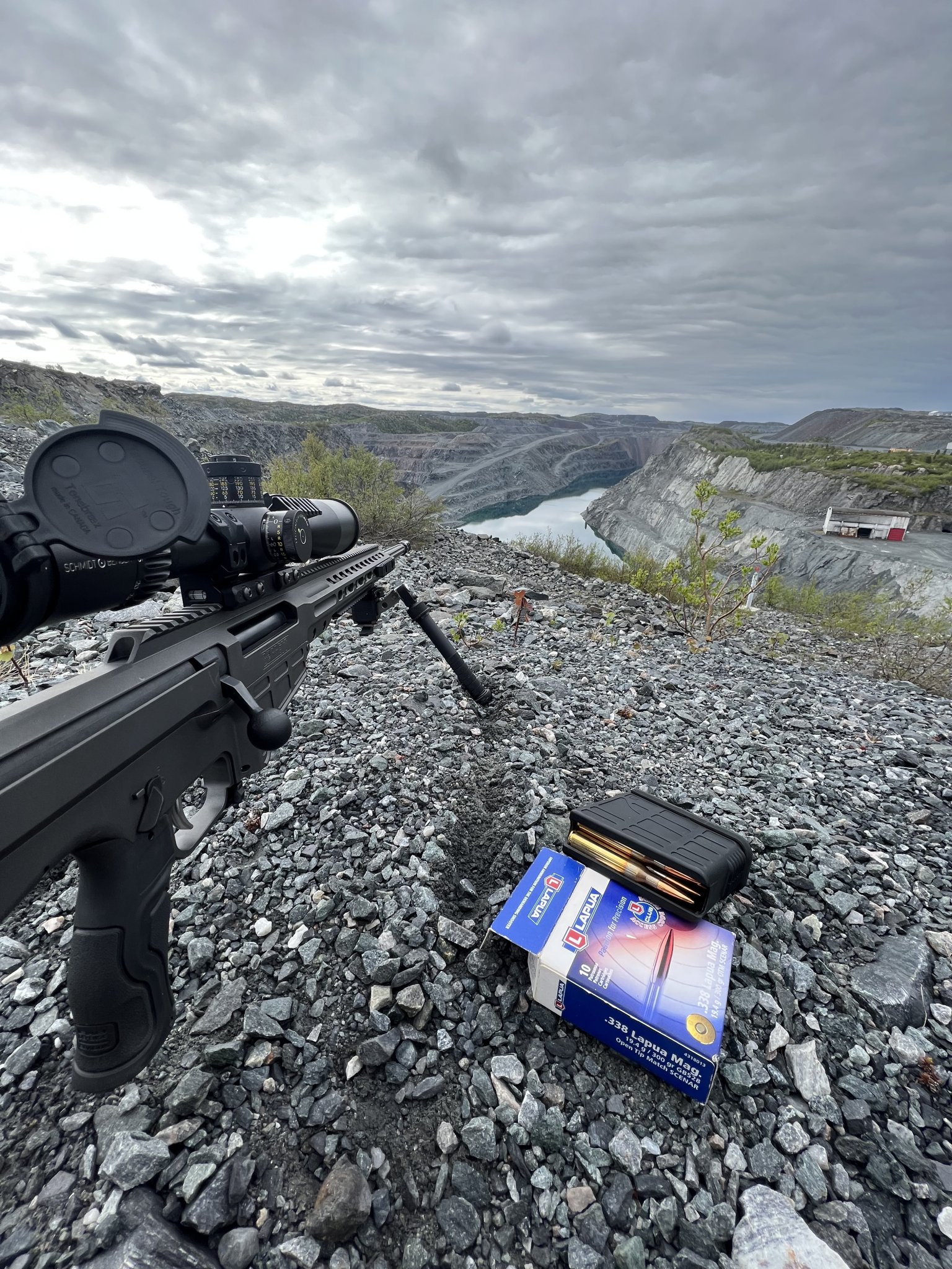

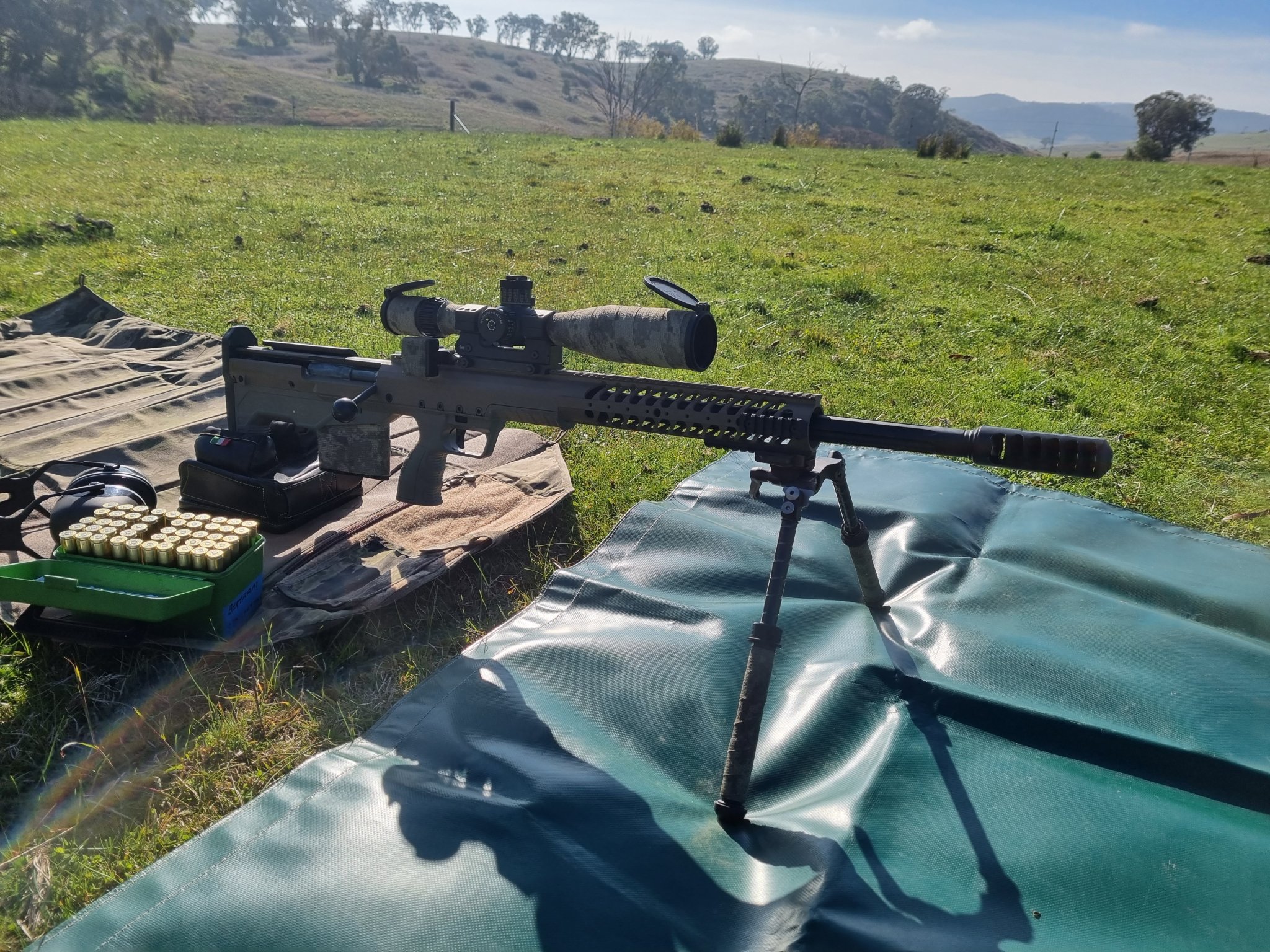

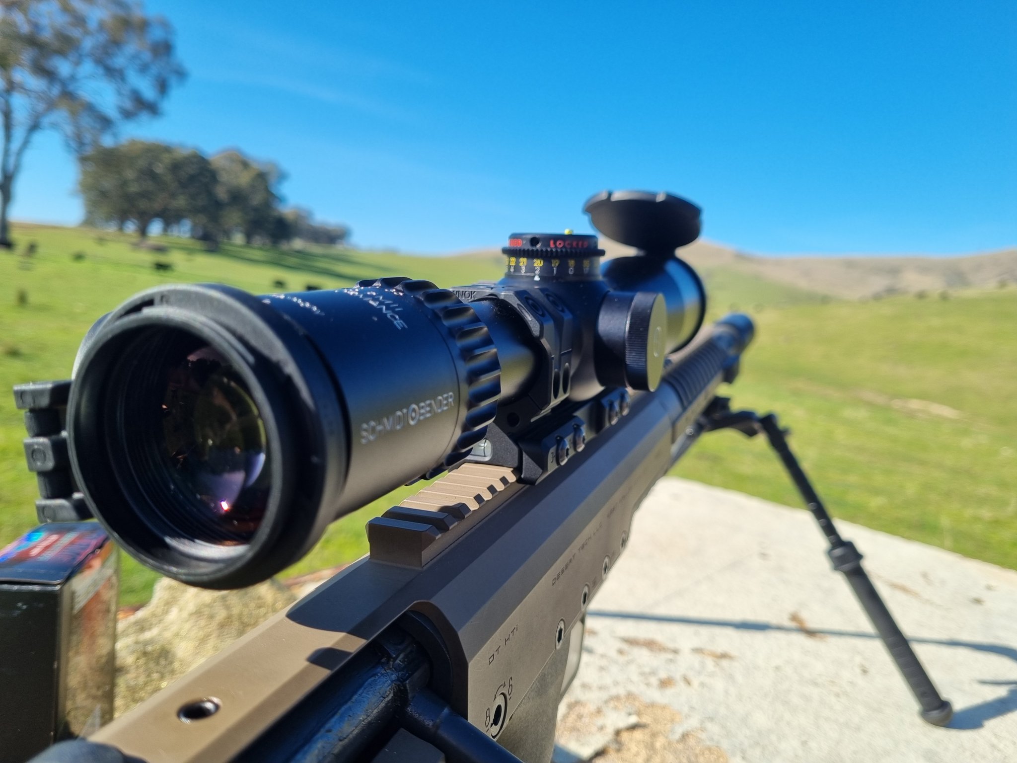

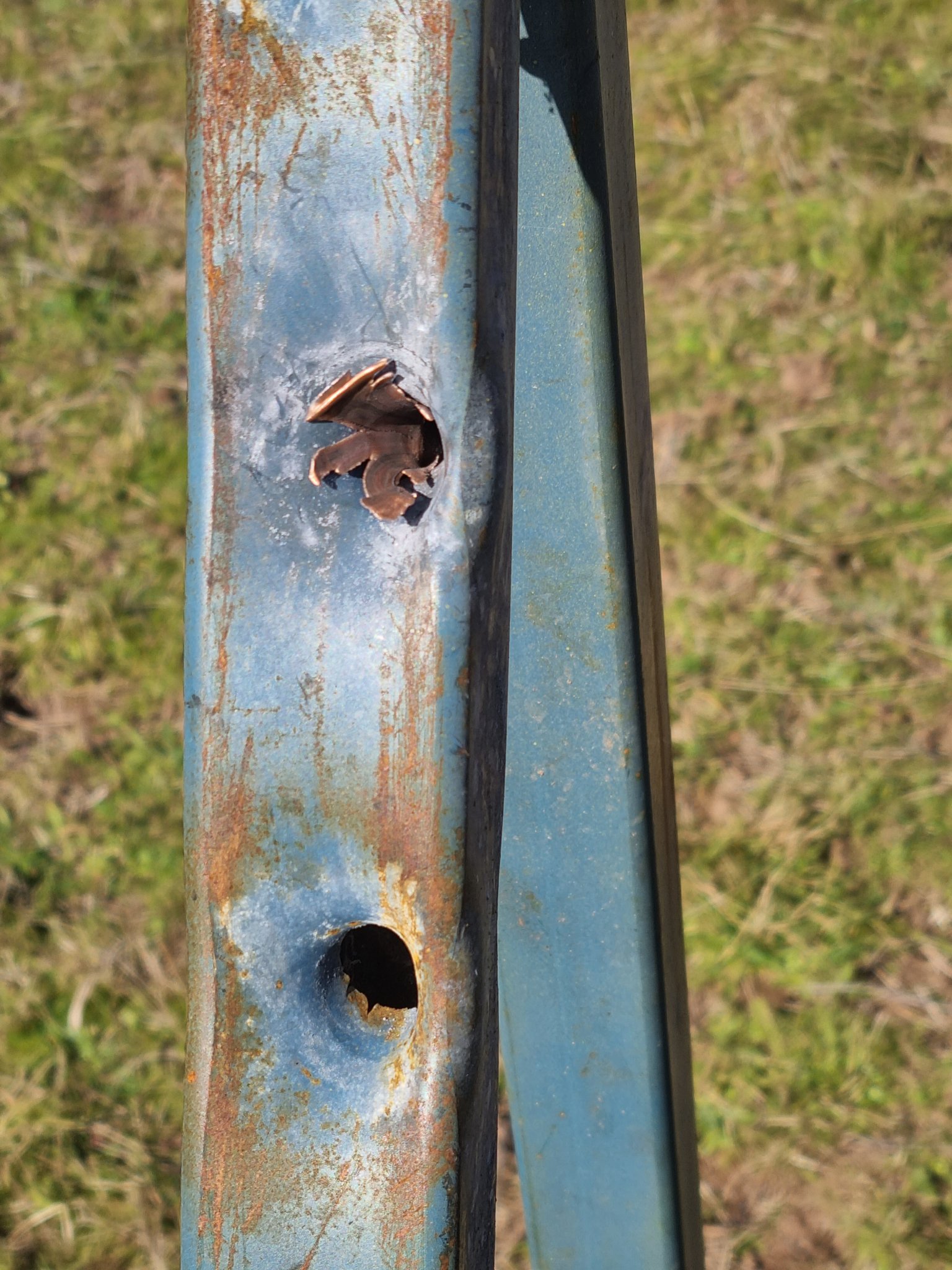

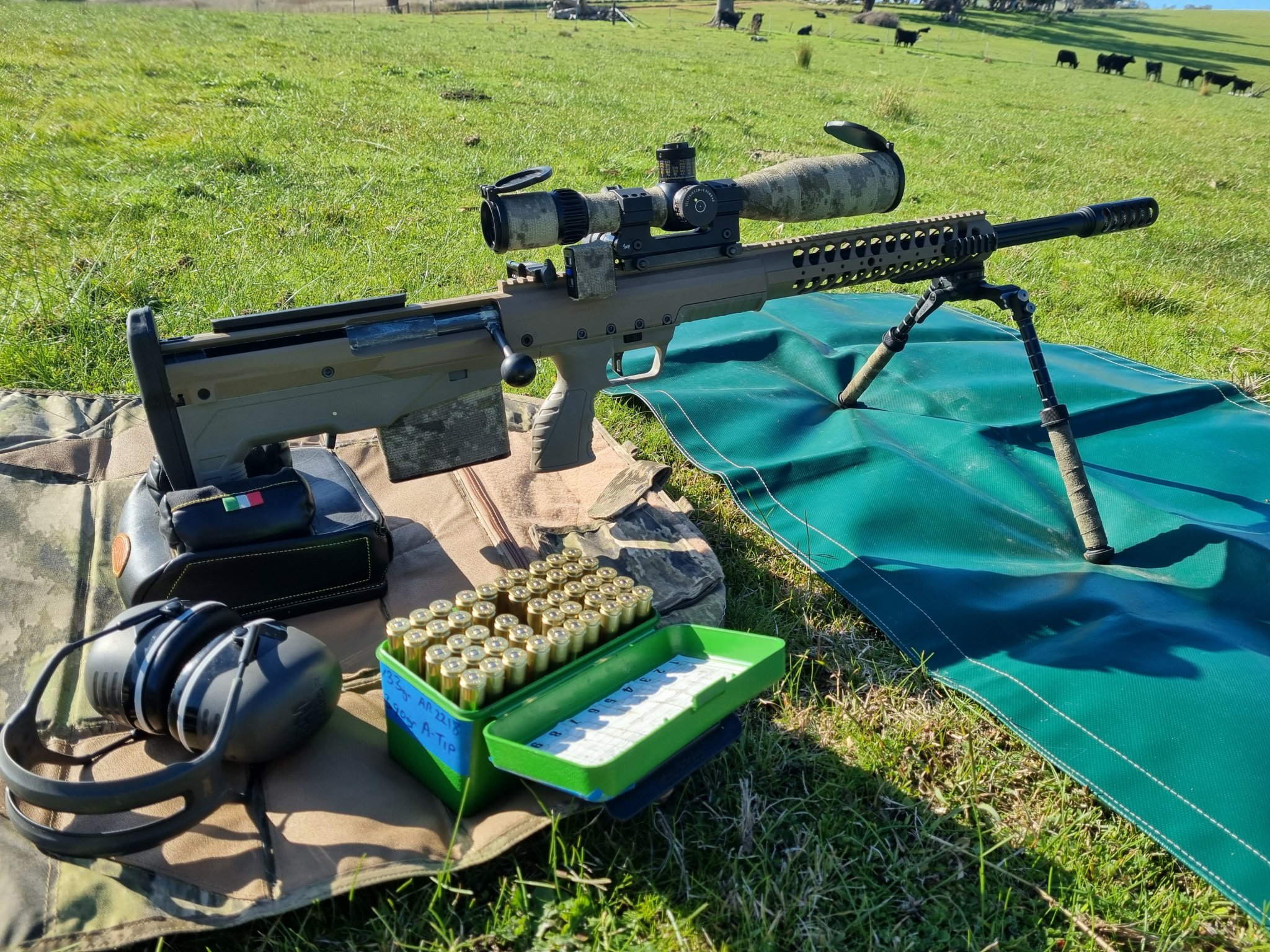

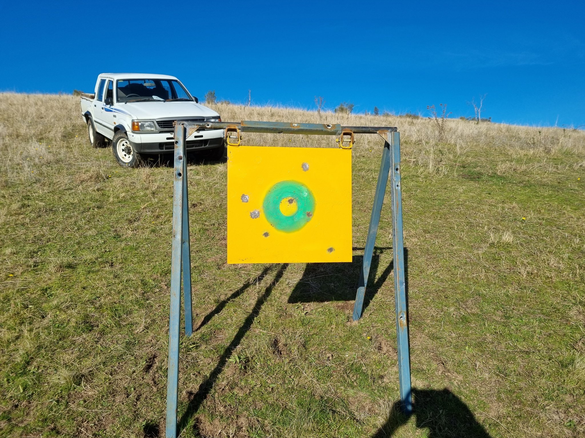

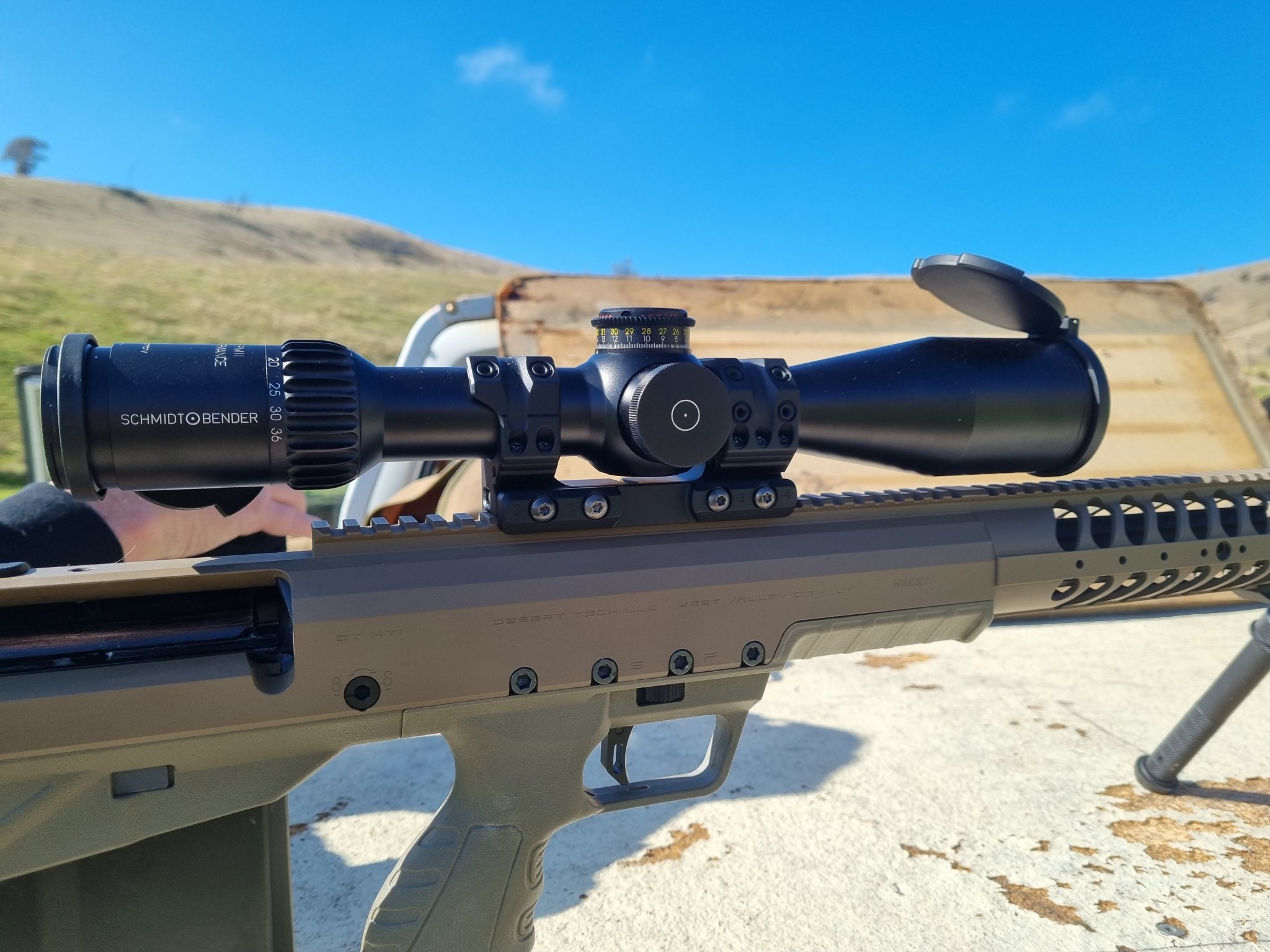

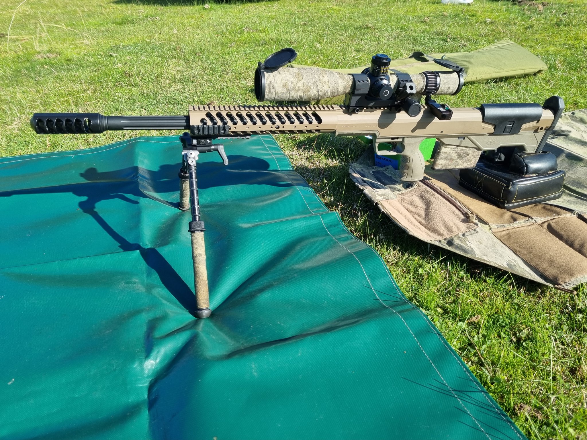

Well fitted the newly repaired 6-36 to the HTI 50 Bmg. Quick sight on...as per usual the HTI 50 produced a 3 shot ragged hole.

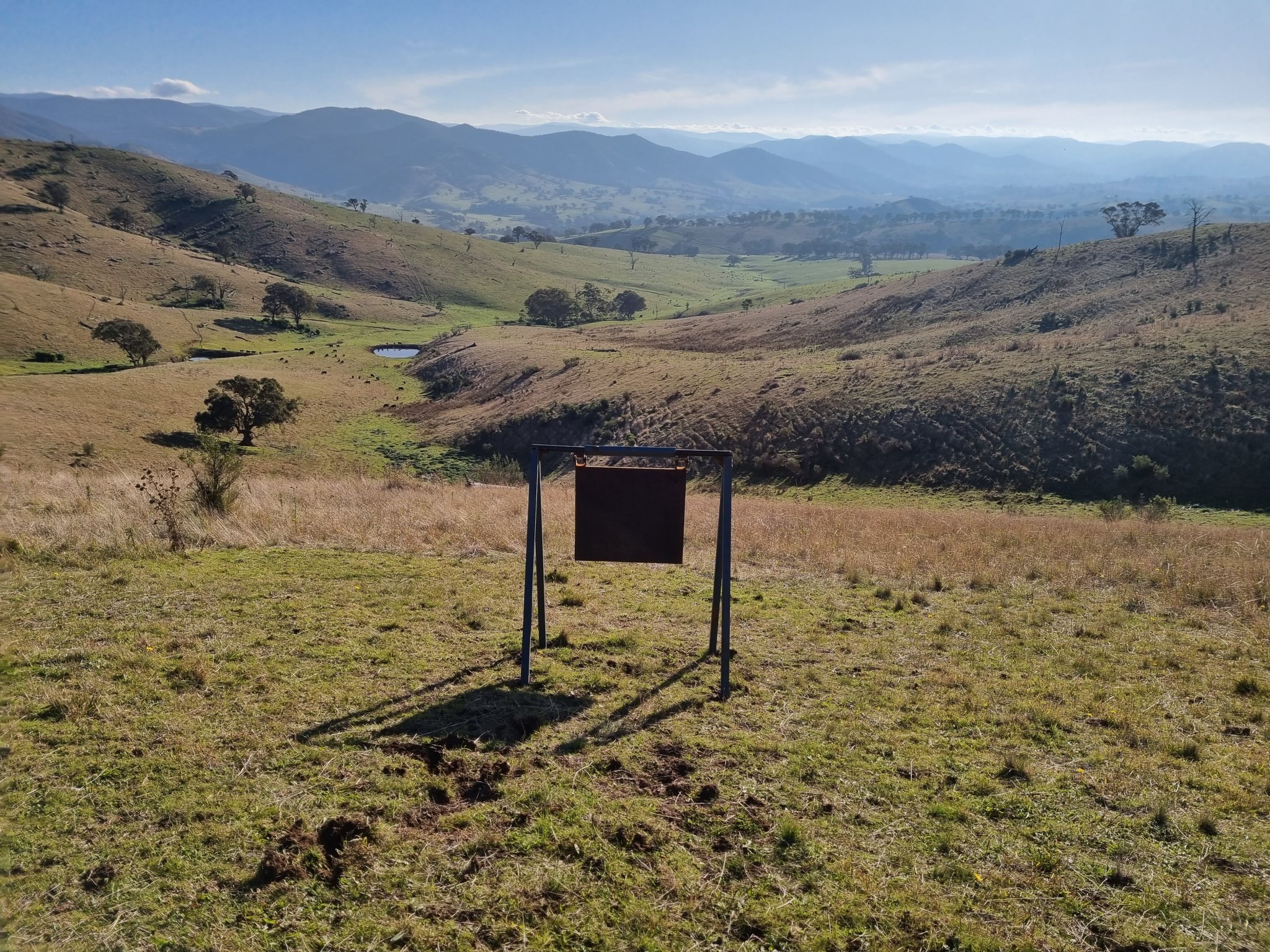

Then out to 2500 yds..
Gorgeous day to day......Both Desert Tech HTI,s ,each topped with the Schmidt 6-36,s performed superbly..
Only limitation in the equation was "us"...
We had some hits AND misses..
The sheer clarity of these optics is very very impressive....turning out to be one of the best optics I have ever owned...

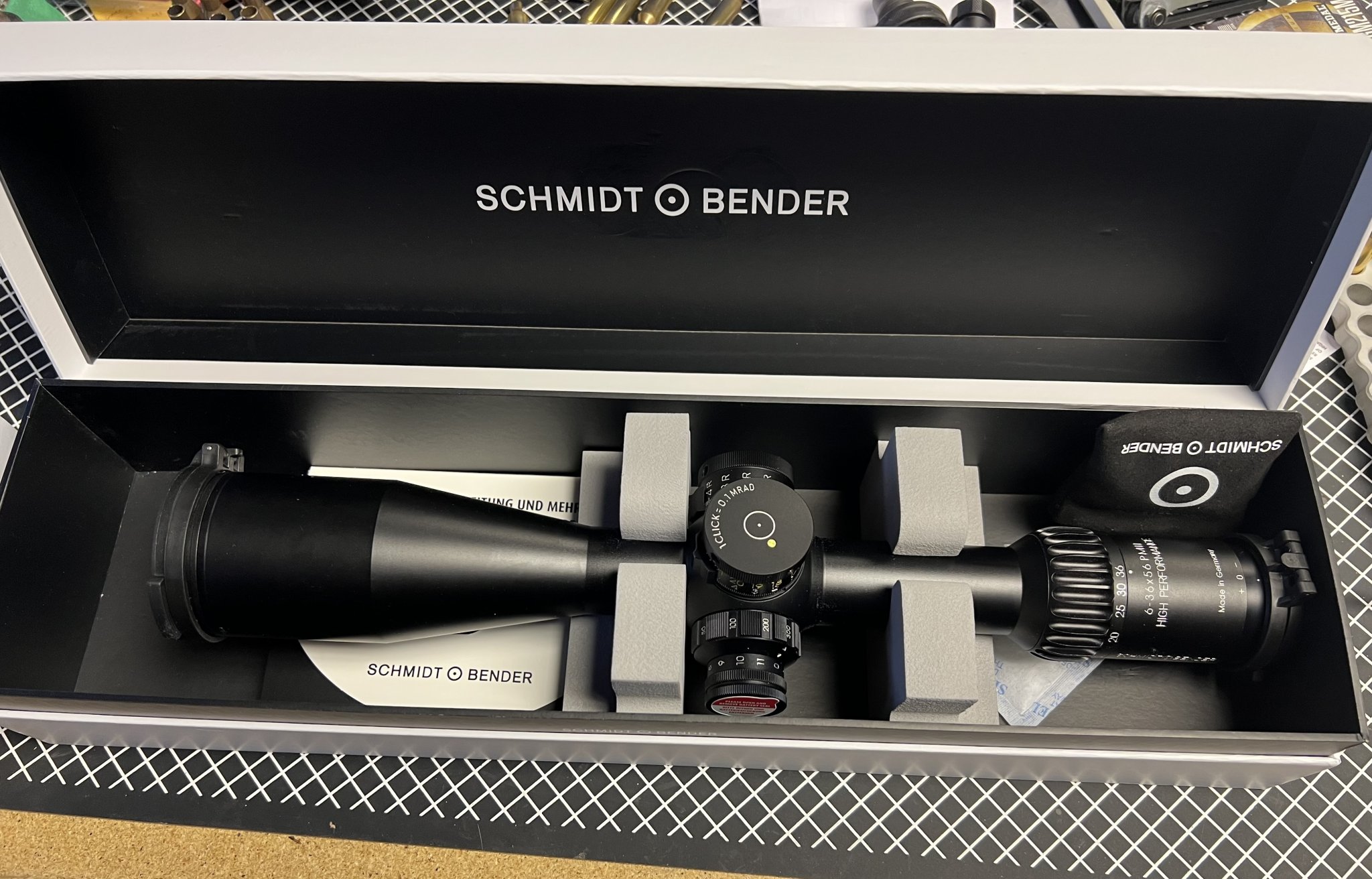

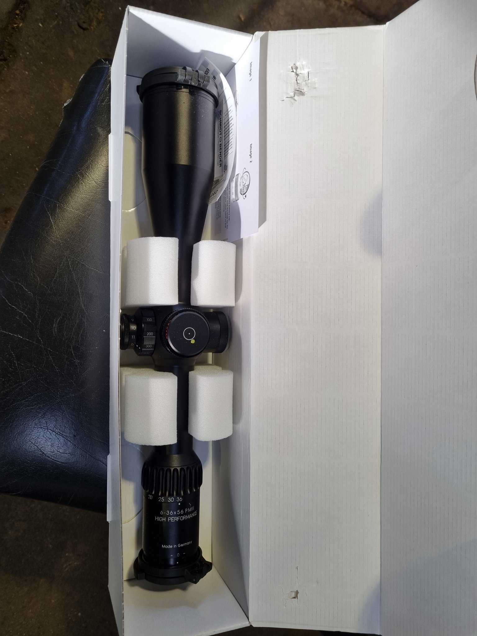

S&B has upped their packaging game
Length and weight is very similar

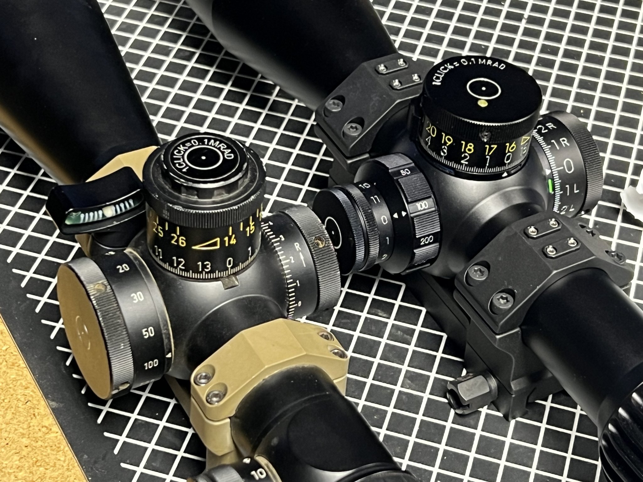

I’m a big fan of the DTII+ turrets. New illum/parallax is interesting.
The parallax indicator is moved off of the tube, but still in the 45 degree position vs the old 90 degree “I can’t see it” position

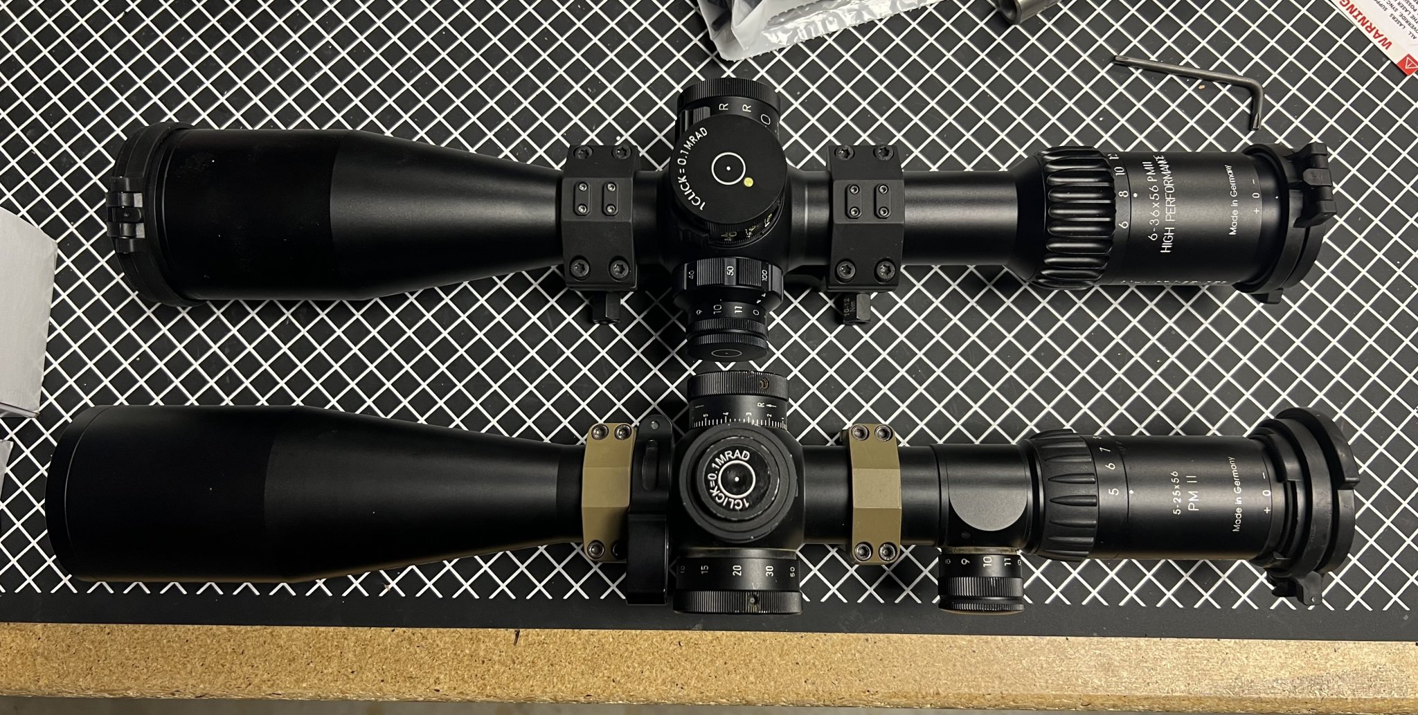

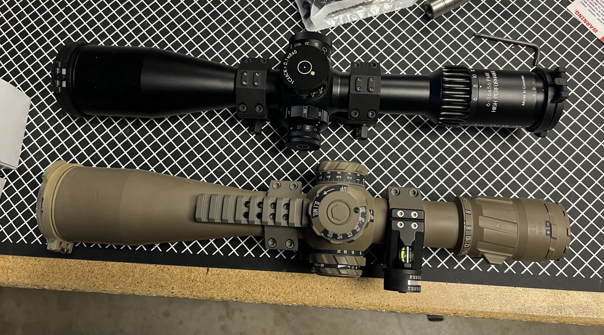

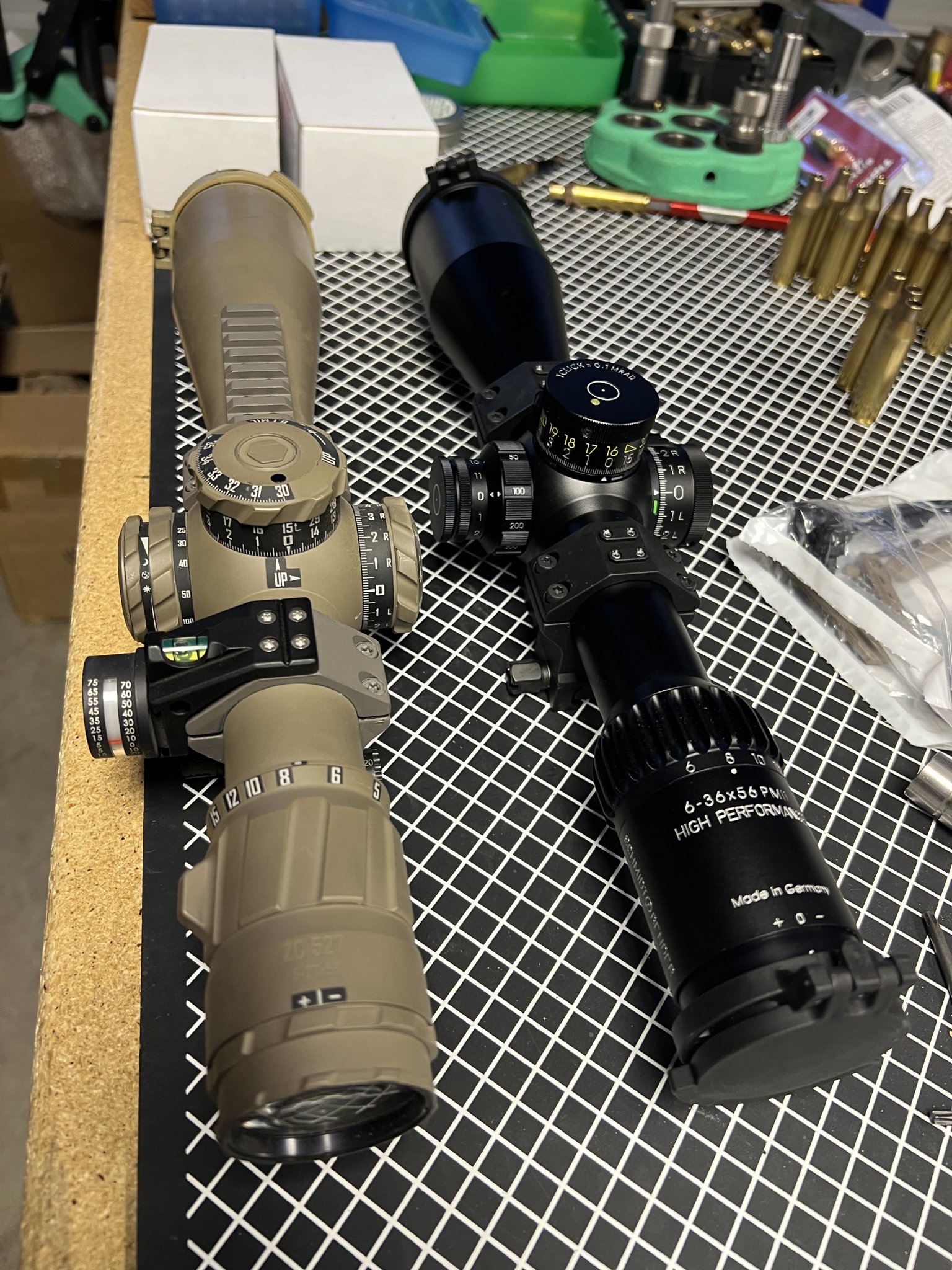

Comparison to my first S&B - 2008 5-25x
Dogs started freaking out…guess UPS came back
what does that illumination control knob do when carrying the rifle slung. it seems to really stick out there, at least on stand alone photos. next to that 5-25 it doesnt look quite as wide of center, - just a little wider. ive wondered if its gonna dig into the carriers back / side / belt / hang up in packs etc

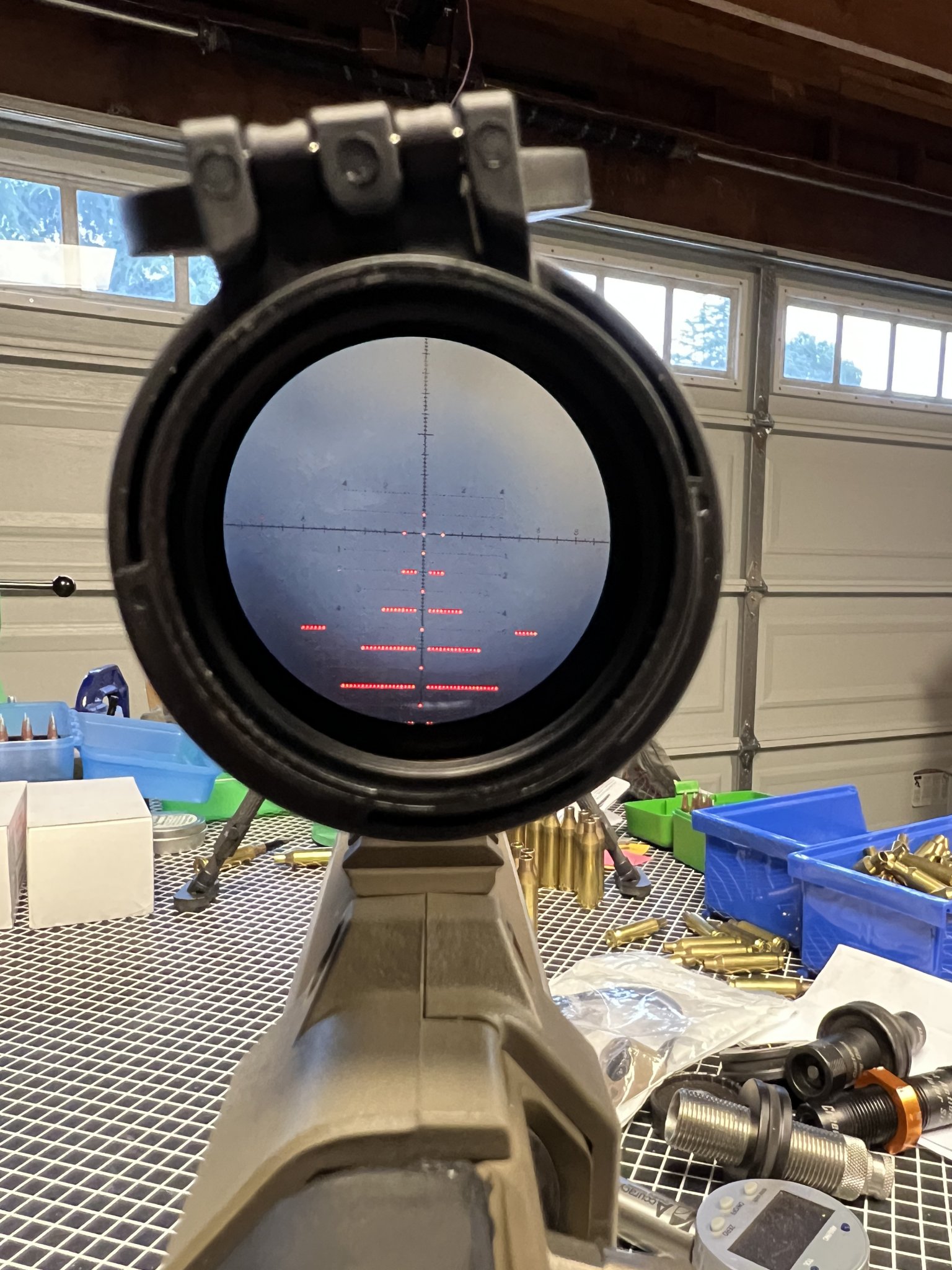

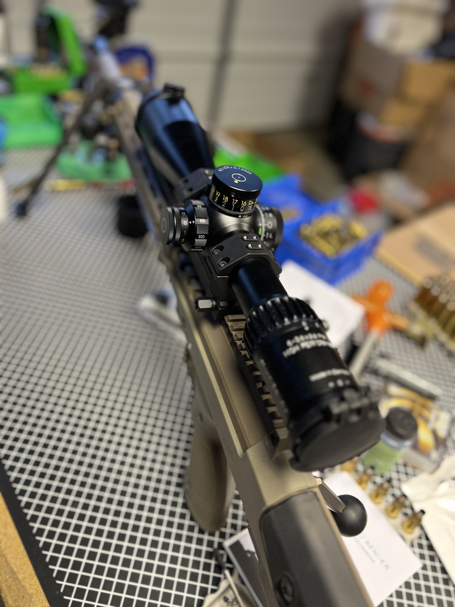

Up early, might as well get it mounted…

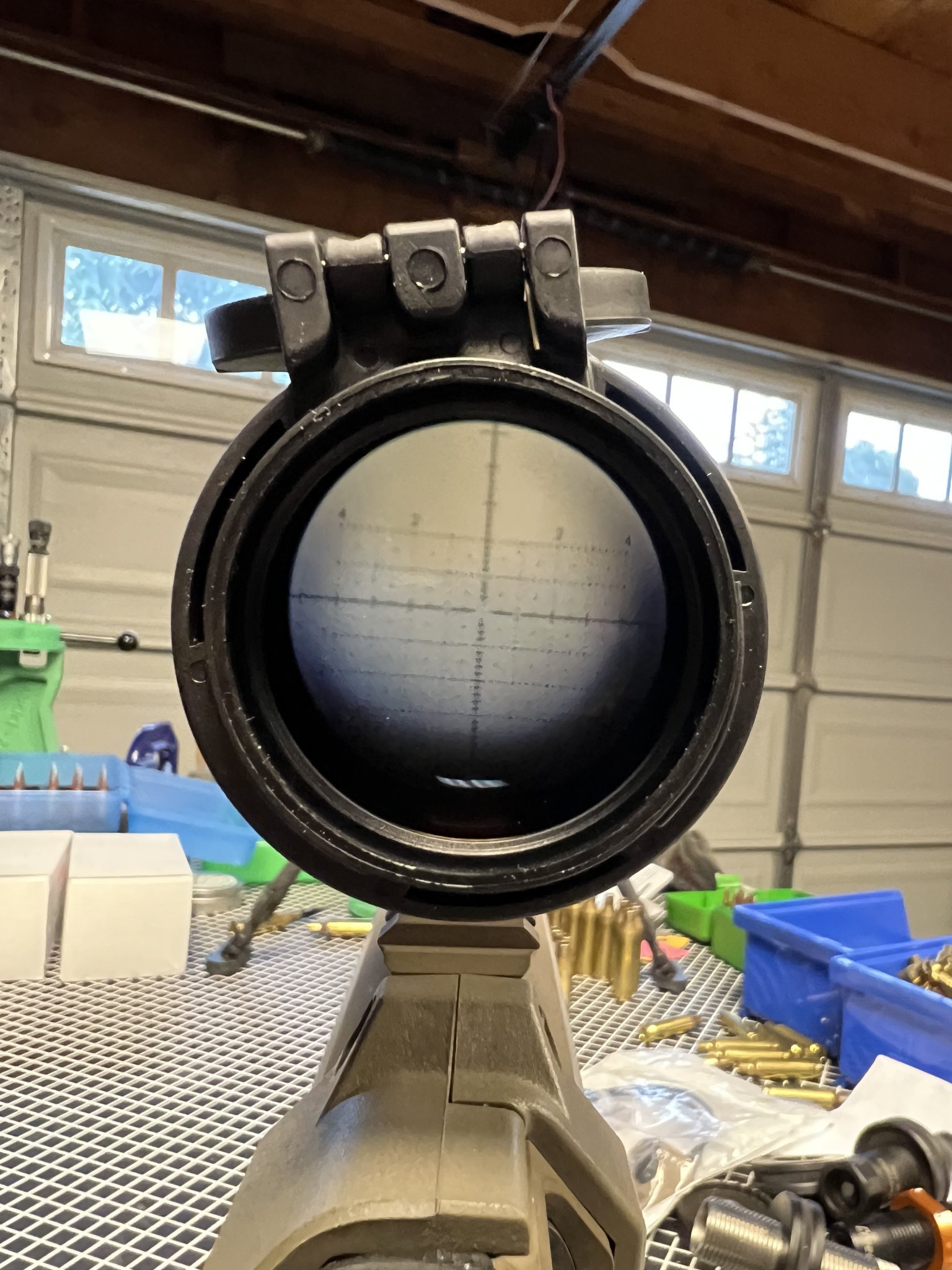

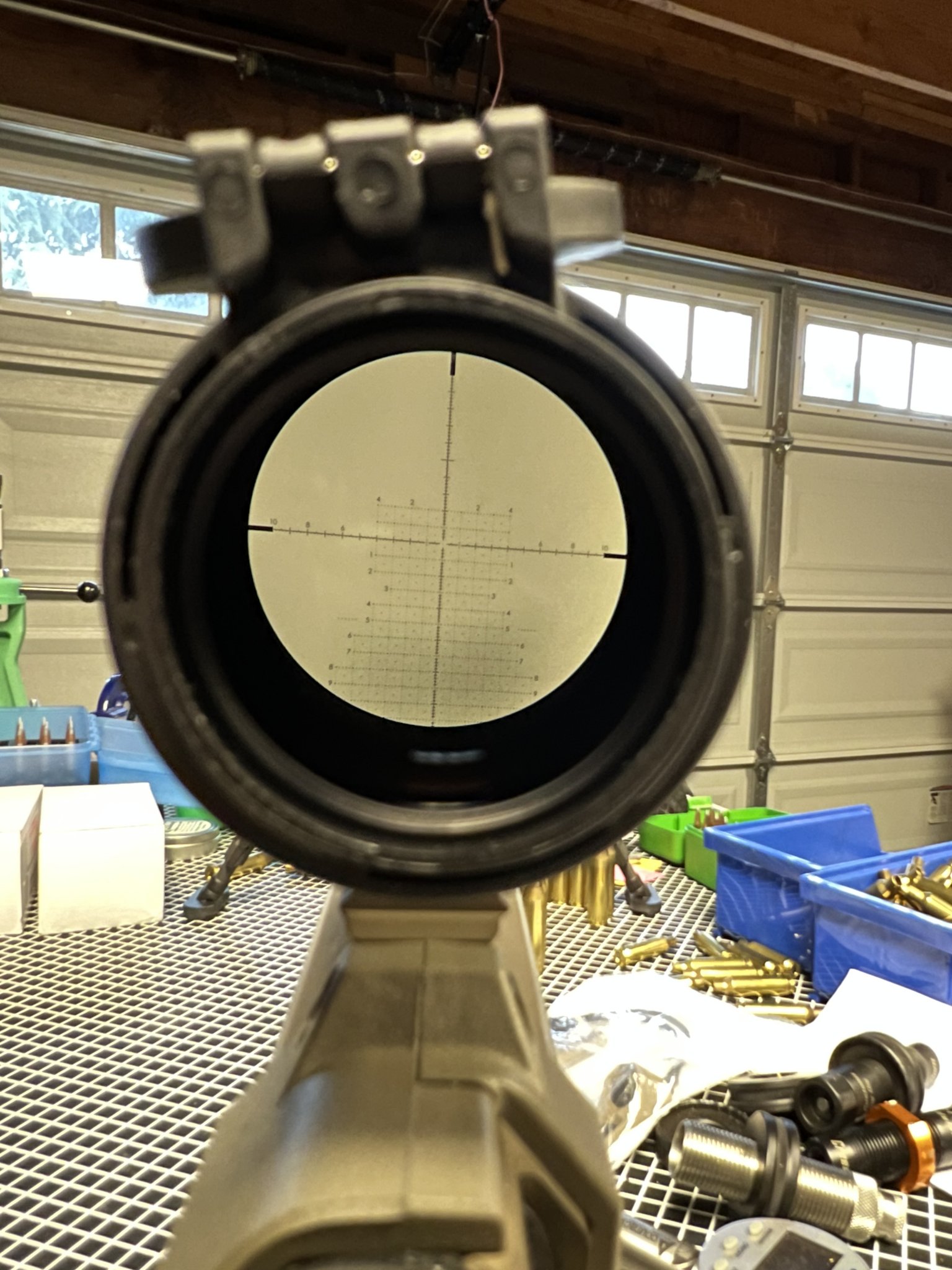

Really struggled to take some pics of the reticle - iPhone says “whuturyoodooing?”
New reticle is pretty nice, similar to MP3X but different, so not a big change there.
At 36x really fills the FOV
Illumination pattern is Xmas tree style.
Put it in a tripod to finally get behind it mounted, loopholed through the garage top windows to spot some trees at 250m and 600m. Eyebox seems a little more forgiving than the 3-20x US & 5-20x, so they may have done some improvements. Clarity is typical S&B. Will shoot it this weekend and have an ELR trip coming up to really put it through its paces. Overall it feels at least as good as my ZCO 5-27x.
