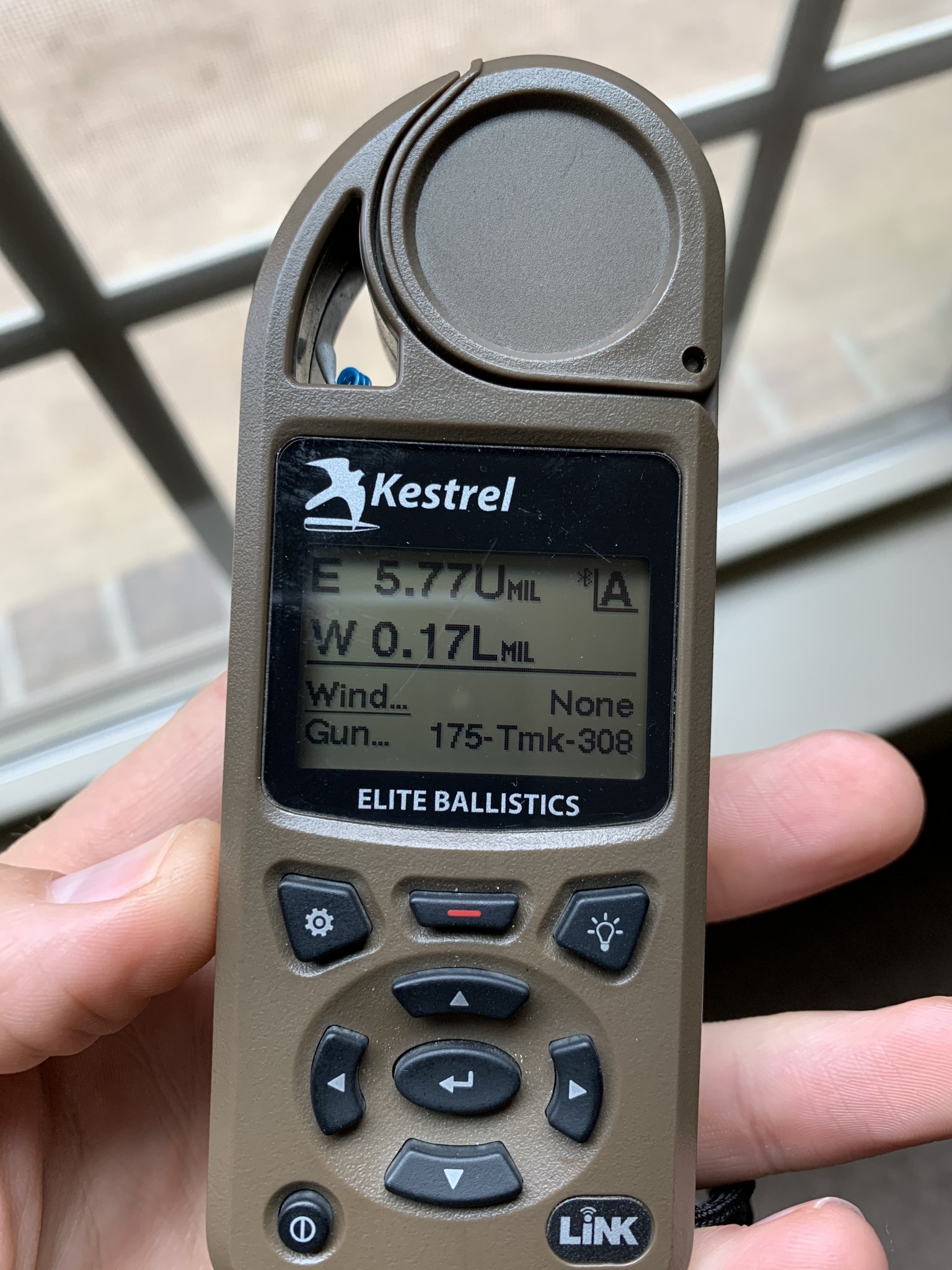

This is with the AB 175 TMK custom curve @ 2638.

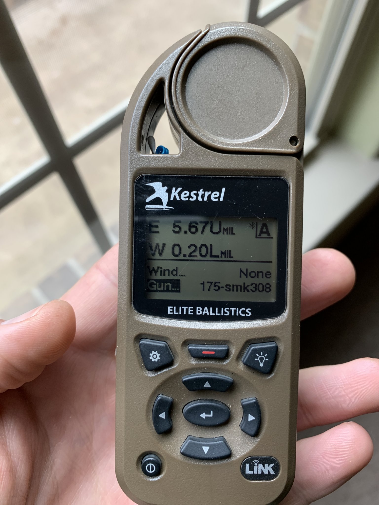

175 smk trued up at .264.

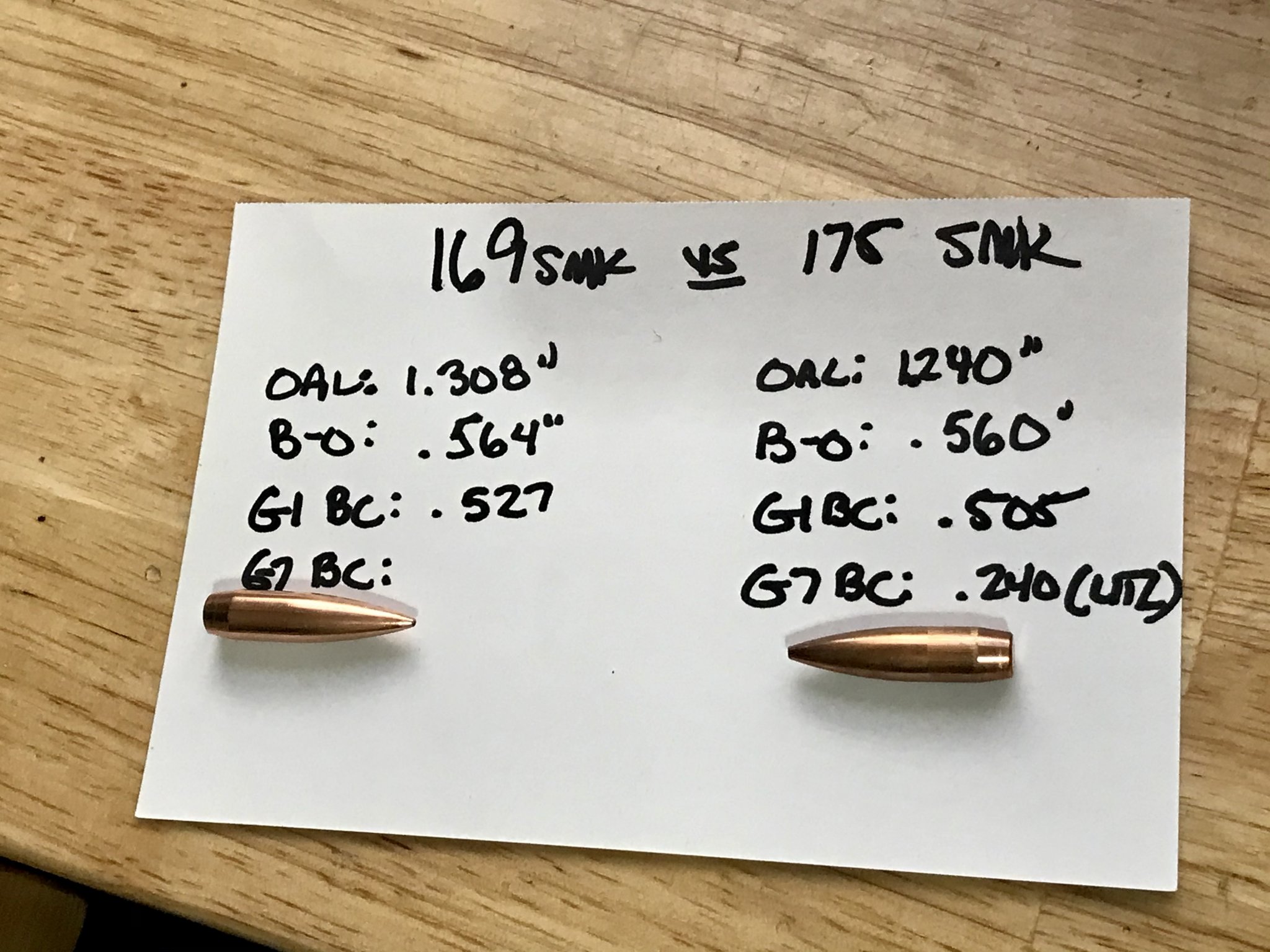

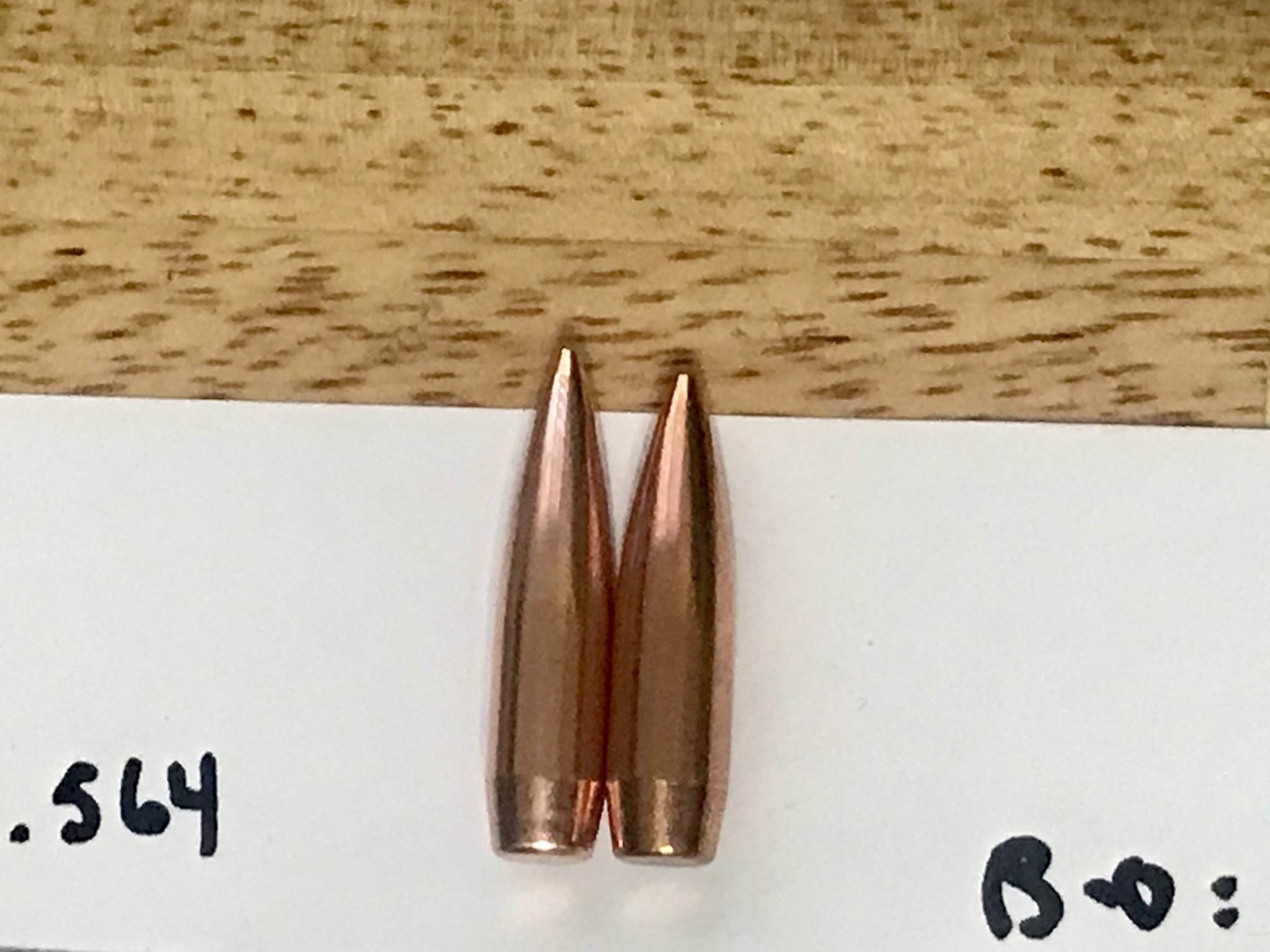

Here is the 169smk (left) next to the 175, with corresponding measurements.

Here is the 169smk (left) next to the 175, with corresponding B-O measurements.

That 169 looks slippery. Even if the BC only works out to be the same as the 175, or just slightly higher, it will be a winner. The 178 ELD, 175 SMK & TMK, berger 175, etc all have roughly similar BC & velocity potential. If you can get another 100-150 fps and a tiny bit more BC it would probably match the performance of the 176 atip without the added cost.
Yep, my thoughts exactly. If this bullet shows consistent, noticeably better performance at 700m in the Mk11, im switching over.
Yea I dont know why the hell my Kestrel is giving me that number when I selec AB CC..... My other inputs are right and 100% identical to my 175 SMK profile... Twist rate, height over bore, velocity, zero distance.. all the same.
When I select G7 for 175 TMK I get 5.71 mil and 1.64 W 9mph. Every time I select AB CC for the 175 TMK it goes right back down to 4.06.... somethings gotta be up with that AB CC for that bullet. Im using AB CC for the 175 SMK and I get 5.73 mil and 1.66 W 9mph... weird
Have you updated to the latest firmware 1.43? There was a bug in 1.31 that made some weird glitches. You might also try deleting the profile and sending it again with the kestrel link software, it could just be corrupted.
Yep 1.43 and deleted the entire profile from both my phone and kestrel and recreated 3x....same results every time
Yuck... Hopefully Kestrel can help you out.
Going to load some rounds today and test them tomorrow in my Mk11 over LabRadar. Components I’ll be using are Varget in a lake city LR 07 case, Remington 9-1/2 primer. I’ll report back.
I think you have the BCs reversed.

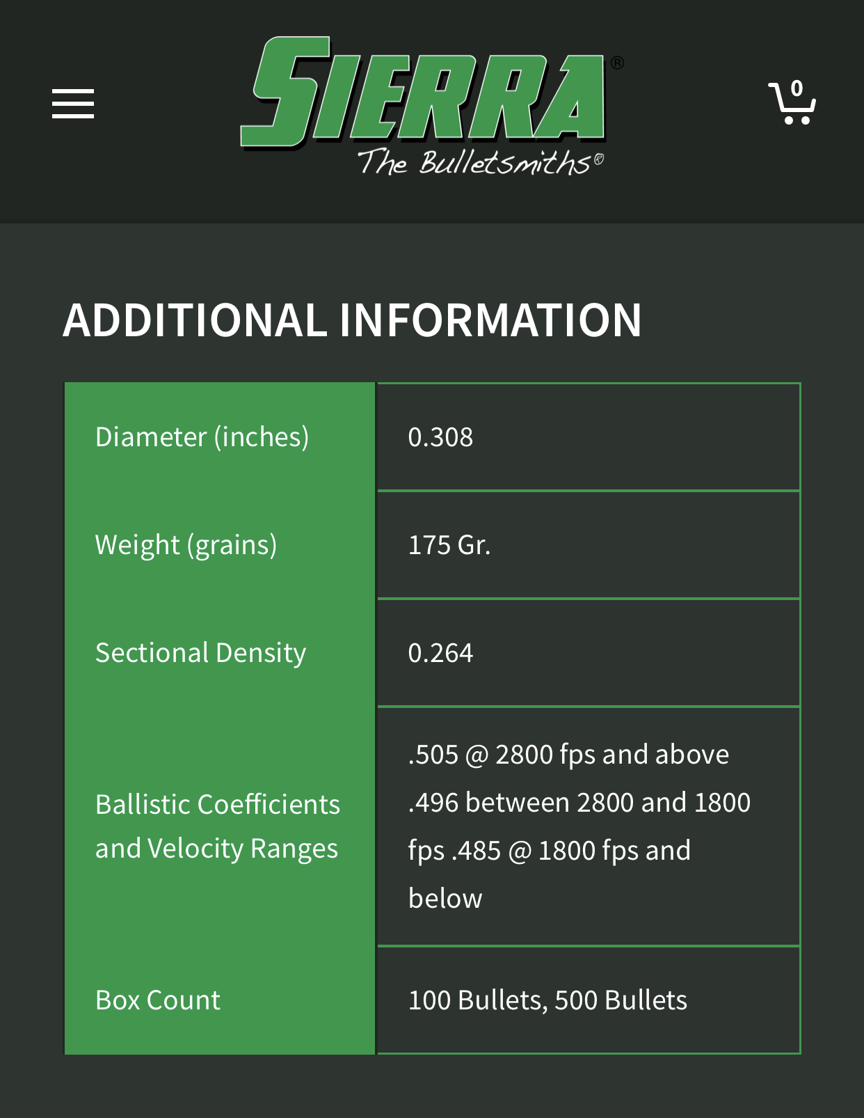

It seems the 175smk achieves its .505 G1 only when traveling in excess of 2800 fps, otherwise it has a min G1 of .496 as long as it’s moving at least 1800 fps.
