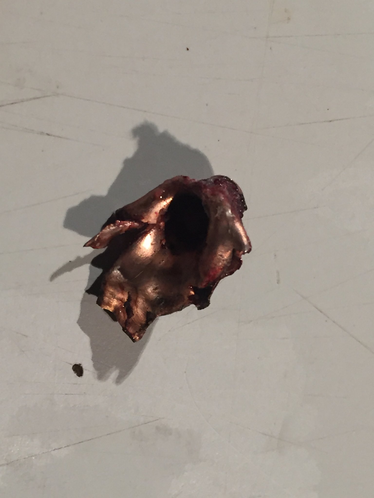

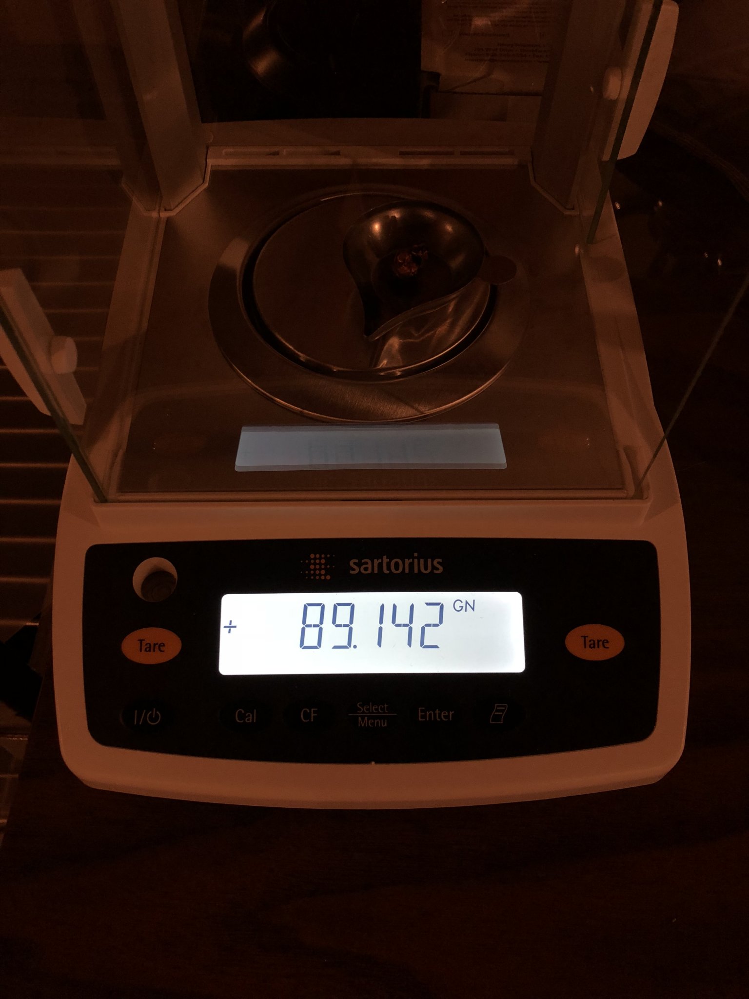

I’ve shot two deer with the 130 in a creedmoor. 410 and 499 yards. Bullets have blown up and complete jacket/lead seperation. Sucks ass at that distance, I would imagine closer would be worse. View attachment 6976044
The question I have is what happened to your deer? You apparently recovered the deer so I'm curious how quickly it died? Where was the bullet jacket in the deer? Did any part of the bullet pass through? Thanks for sharing your results.

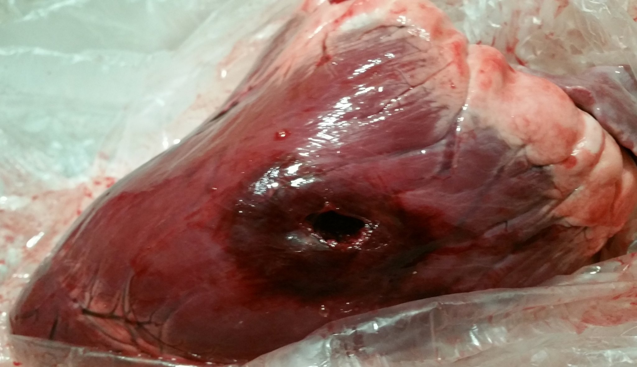

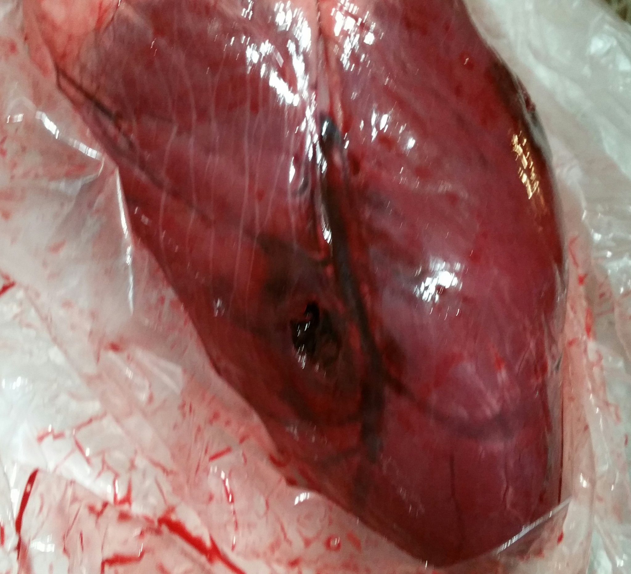

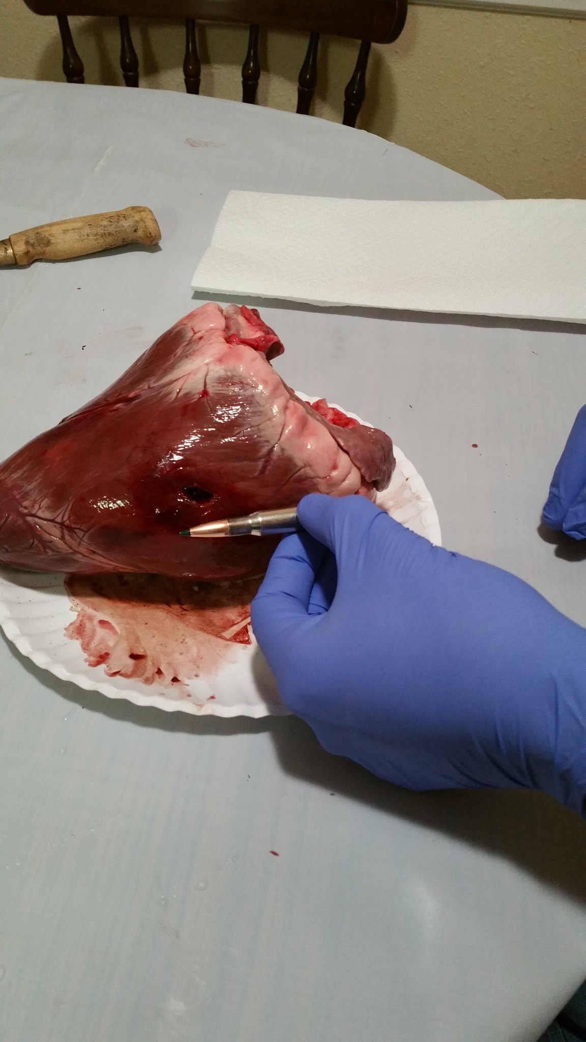

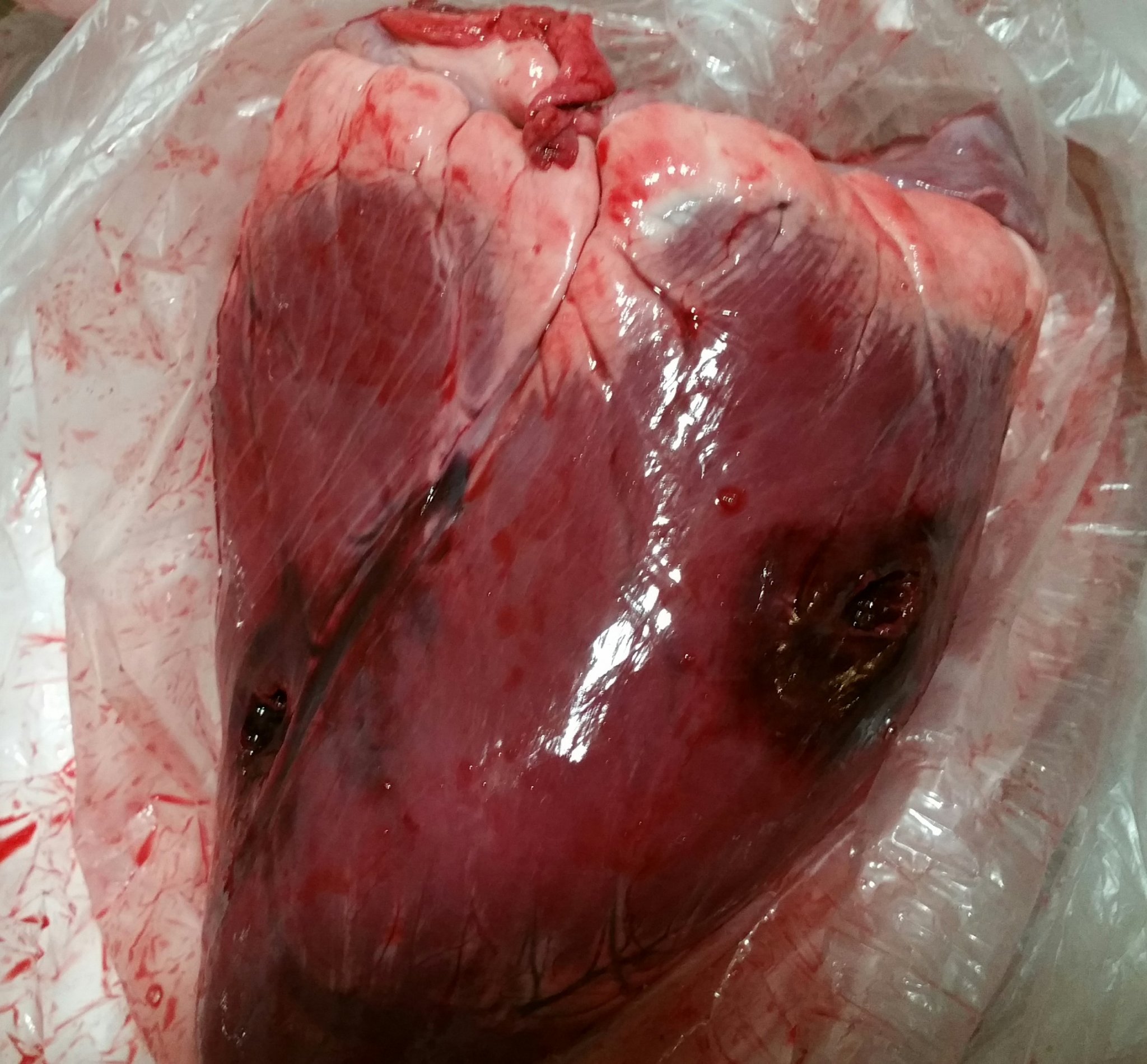

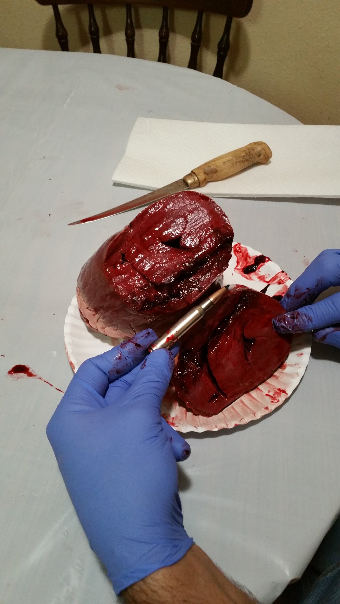

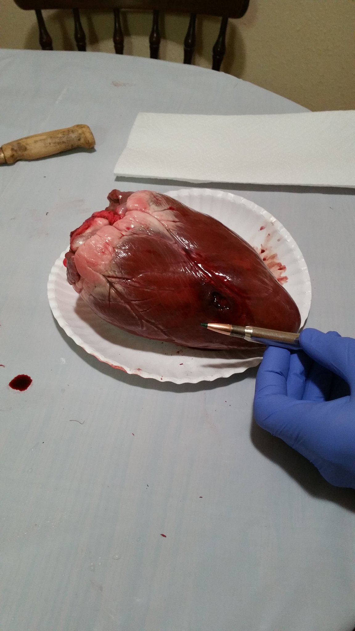

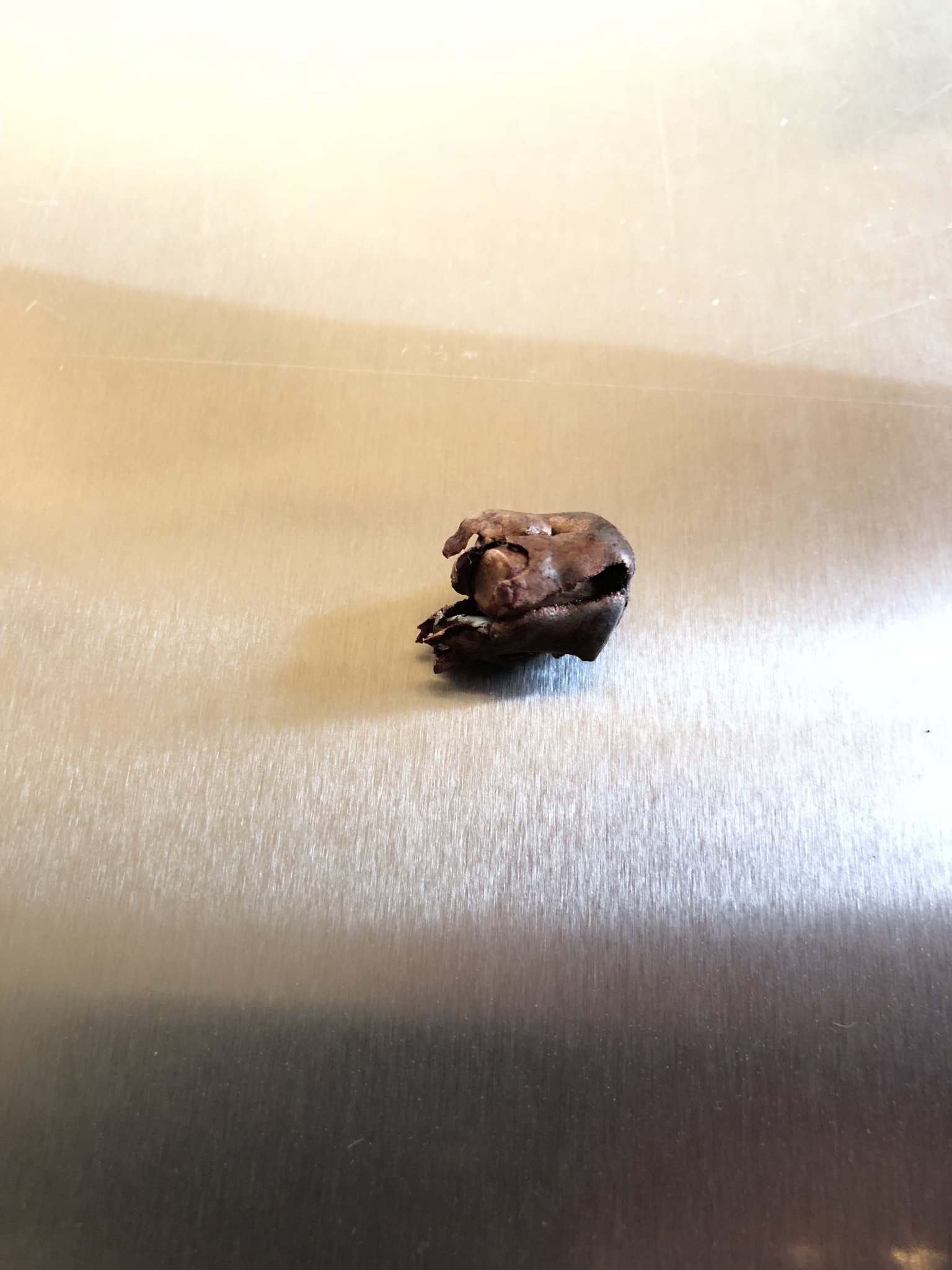

I have already said this on another forum but would like to share my experience here to. I shot a cow elk at about 100 yards with a Sierra Gamechanger just a few days ago. It was the .308 dia. 165 gr. bullet with 56 grs. of H4350 loaded as a 30-06. The bullet went right through the heart leaving a fairly small hole on each side. I did not recover the bullet. I have seen other brands of bullets do much more damage to an animals heart. See photos.
Just curious, did bullet have complete pass through? What angle was shot to get to heart?
Good questions! Right now I'm thinking it was a complete pass through. Granted it had gotten dark by the time I started to quarter it, and the heart was almost the last thing I got and the first evidence I found of where I actually got it. I did not notice the entrance or exist wound or bloodshot meat or broken bones/ribs. Best I can remember, it was mostly broadside when I shot. I'm about to process the meat/quarters and I might find out more.
They died of course but I’ve killed deer with a 22 lr also.... The bullets were more explosive than Bergers. Penetrated a few inches then completely fragmented. That’s a 500 yards from a creedmoor without hitting any bones. The 410 yard shot hit the spine high and didn’t even exit. Not a fucking game changer.
I finished processing the elk quarters and still did not see any signs of the entrance or exit of the bullet. No bloodshot meat or damaged bones. I did find a very small lead fragment in the heart near the wound channel. The fragment leads me to believe that the bullet did mushroom to some extent or that there might have been some separation, but without hitting bone it didn't cause massive damaged. I still think the bullet passed through. Here are some new photos of the heart. There is a 30-06 with the Gamechanger to give some perspective of size.

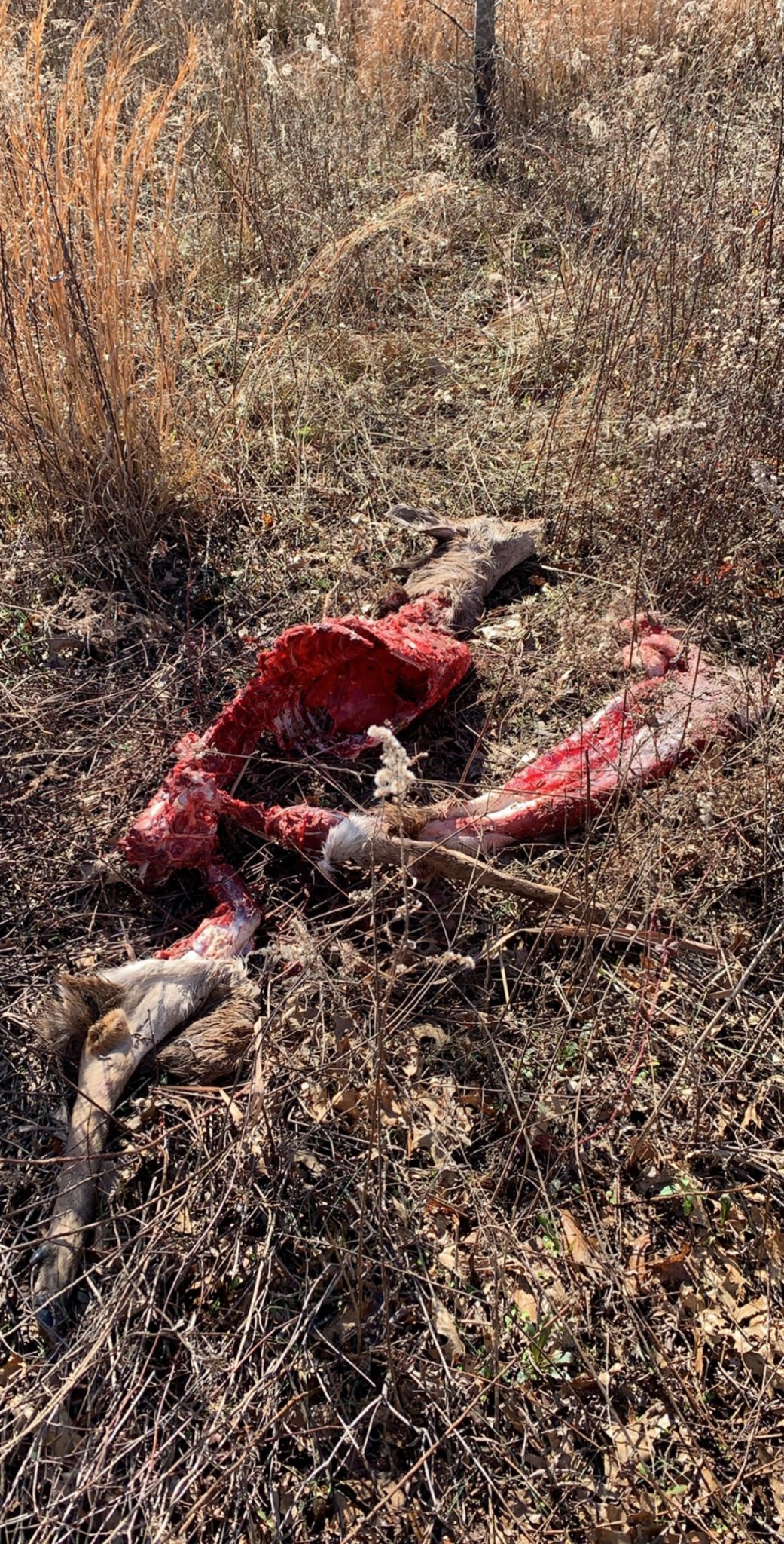

So my brother wouldn't shoot another doe to give me some performance of these rounds. I shot a doe this afternoon at 375yds. Looked like a perfect hit but wasn't sure where she went in on the CRP. She jumped straight up and tried to run around and run off but fell down and then got up and ran. Going to look in the morning, let her die if it is me and i pulled the shot a little back but i don't think i did. That way i'm not pushing her deeper into the thick stuff. It's 27F here so meat will be good. But i think the shot was fine.

I'll be curious to see what the outcome of the bullet performance is, and where the hit occurred.
Found tiny drops of blood today, specs like she was gut shot. Finally found her though. About 50yds in the thick stuff in the CRP so she ran probably 100-150yds. Yotes tore her up to the bone. Shot was perfect though behind the front shoulder. Should've kept looking last night we were close. Though again there is always that scenario that if she wasn't hit perfect she could've ran further. I'm going to run them out so, before season ends might see if i can take another one and see how it does but i was a little underwhelmed. I just expected more blood than that. I knew i didn't pull that and we had very little wind. Ranging where i found blood she was 400yds from where i shot. Idk could be just the case of that deer they don't all DRT it's not a given, but i'd have liked to have seen a lot more blood.
What did the bullet and damage inside look like? I'm guessing she was frozen and ate up by coyotes so you didn't bother getting in there to see. But if you had it would have gone a long way towards determining if it was the bullets fault or a wild animals will to live
I didn’t wasn’t much left honestly. I’ve seen yotes get after a deer before but noting like this. Literally devoured. Should’ve kept looking though last night though. All in all it worked blood trail was just strange to me.
