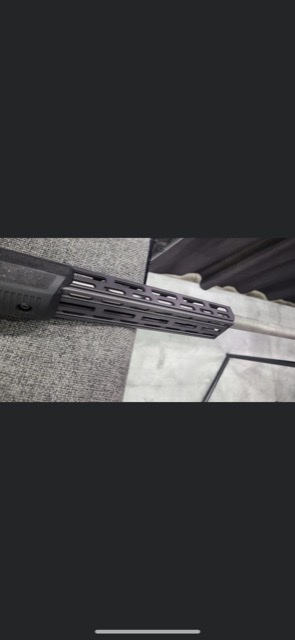

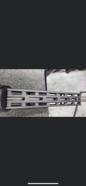

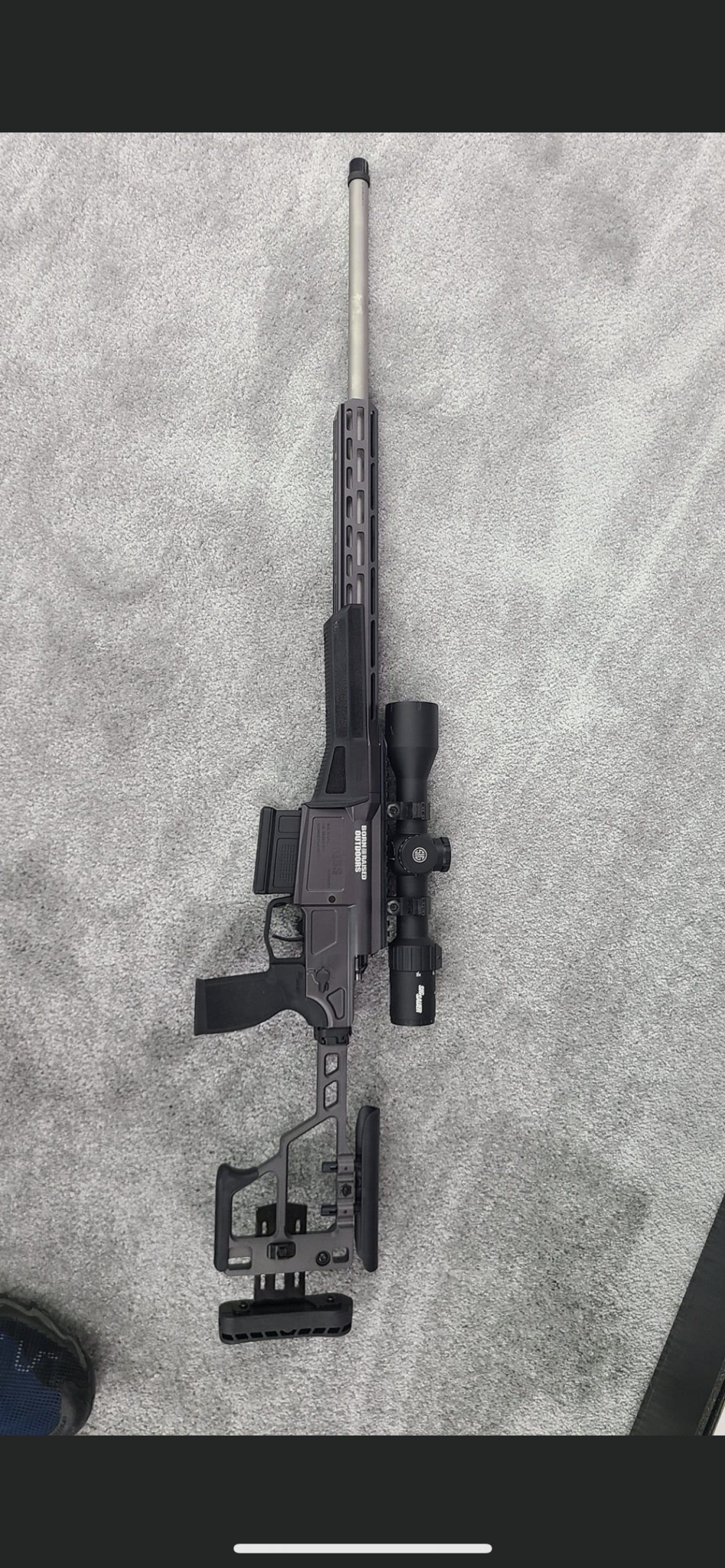

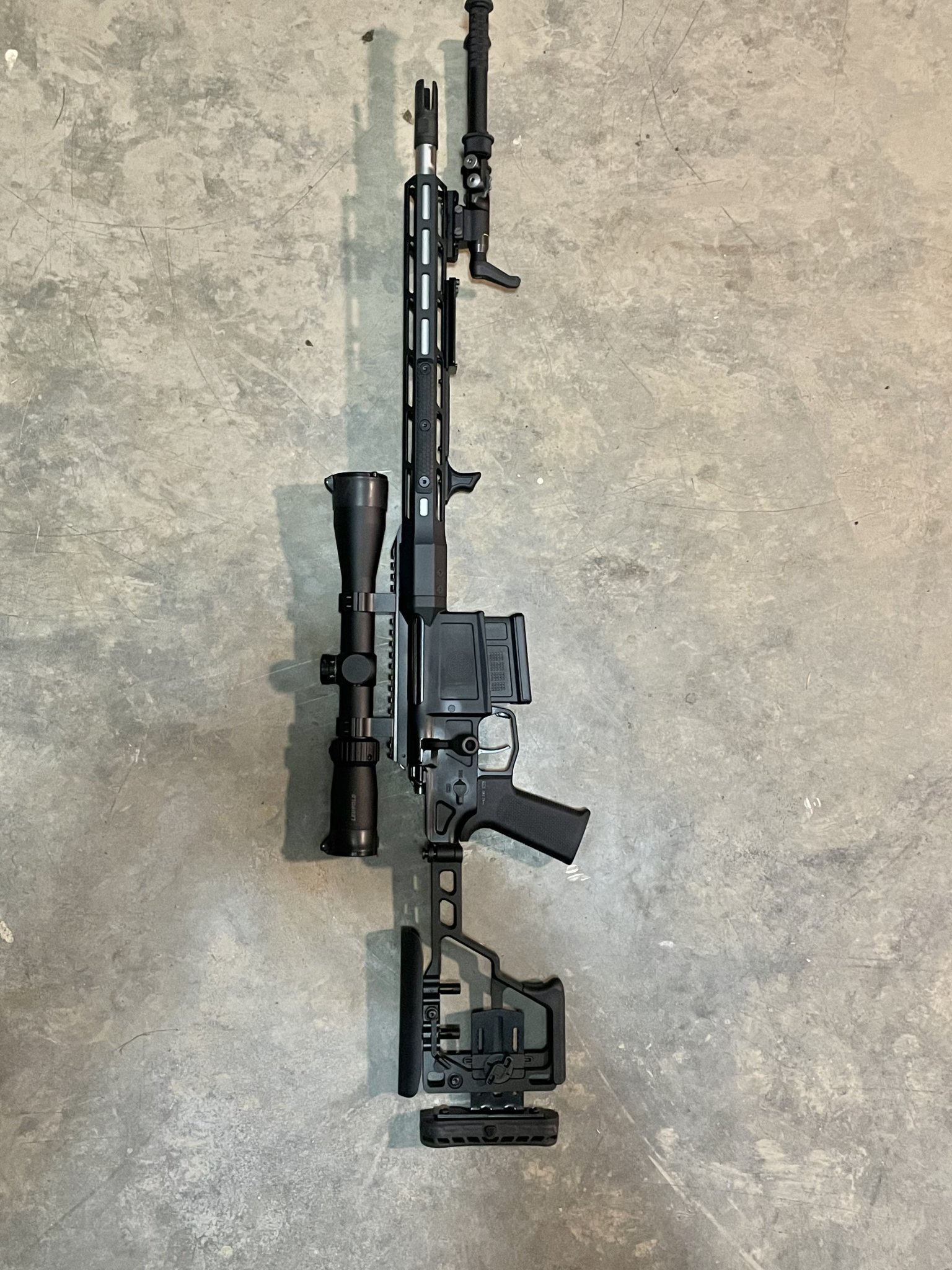

Got these off another group I am on. They are releasing one with a longer barrel, arca handguard and polymer grip.
Lol sorry guys I totally forgot I posted that. It’s from (from what I can guess is a Sig rep in one of our Facebook groups). @chutinlead you are correct they are not going to ShotShow. This was a show in Louisville a week ago.
Supposedly it’s called the Born and Raised Outdoors edition? (Wtf with the name).

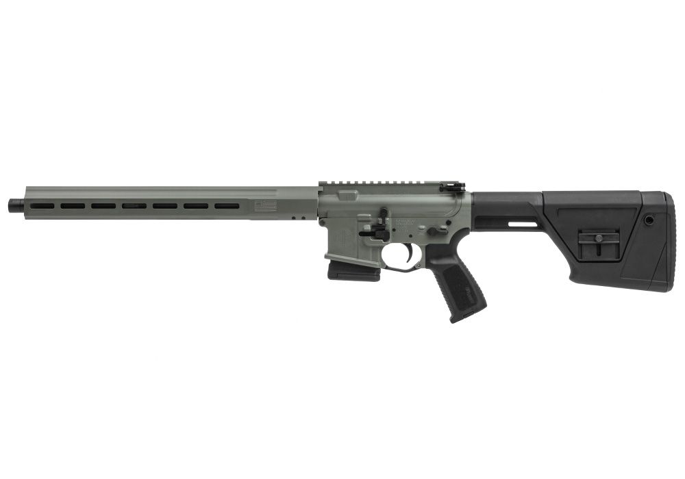

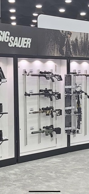

@Tx_Aggie you are correct that is the m400 predator.

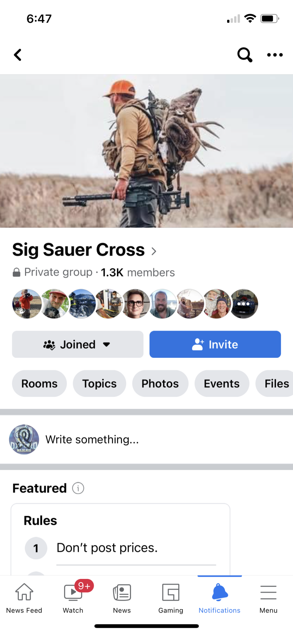

@Kline it’s the Sig Sauer Cross private group. I attached a screenshot of the group. It’s hard to find though cuz the photos and details are from a conversation we were having and he hasn’t expanded on them. Heck my buddy who is a master dealer for Sig didn’t even know about these lol.

Ok cool I guess. I have an ARCA rail mounted on mine and some milk Magpul rail covers that serve the same purpose. Doubt I would pay more than the price of those parts above the standard Sig Cross for it.
Curious that they didn't show off the shorter handguard version or any carbon fiber yet.
The born and raised outdoors model with the 24” barrel was discussed on here a few months back. I’d have to go back to find the post though.
The plastic hand guard cover thing is different, not sure what it’s purpose would be.

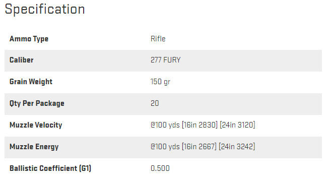

That translates to 3000+ at the muzzle
Working that backwards I see 2973fps at the muzzle from a 16 in barrel. I'm pretty sure the 3000 claim from 2 years ago was for a 140gr bullet, not a 150 as listed. I'm sure if you dropped 10gr off, you'd be well past 3000.
Really weird to give muzzle velocity at 100 yards. That's not muzzle velocity. That's 100 yard velocity.
Agreed...muzzle velocity when the projo is 300 feet downrange is exactly ZERO.
Very odd data to give instead of the actual MV.

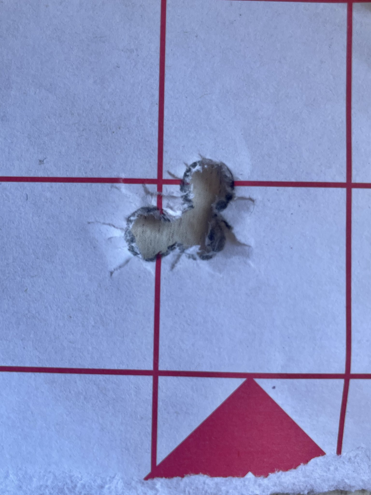

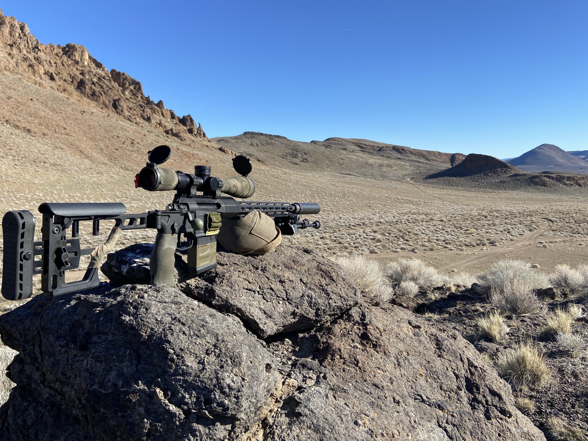

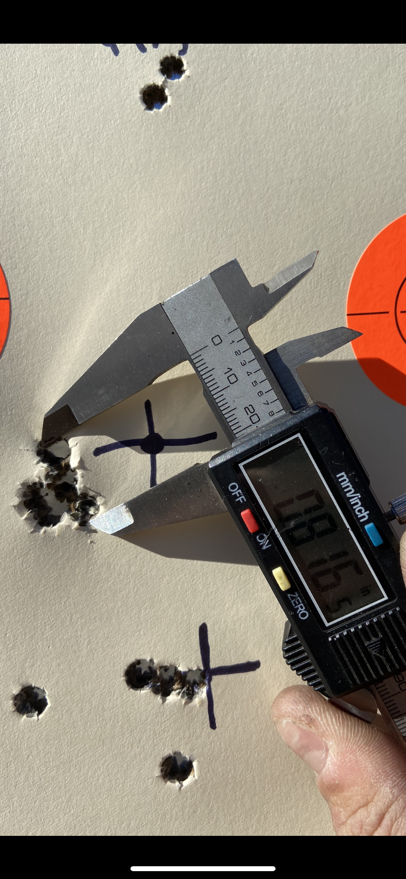

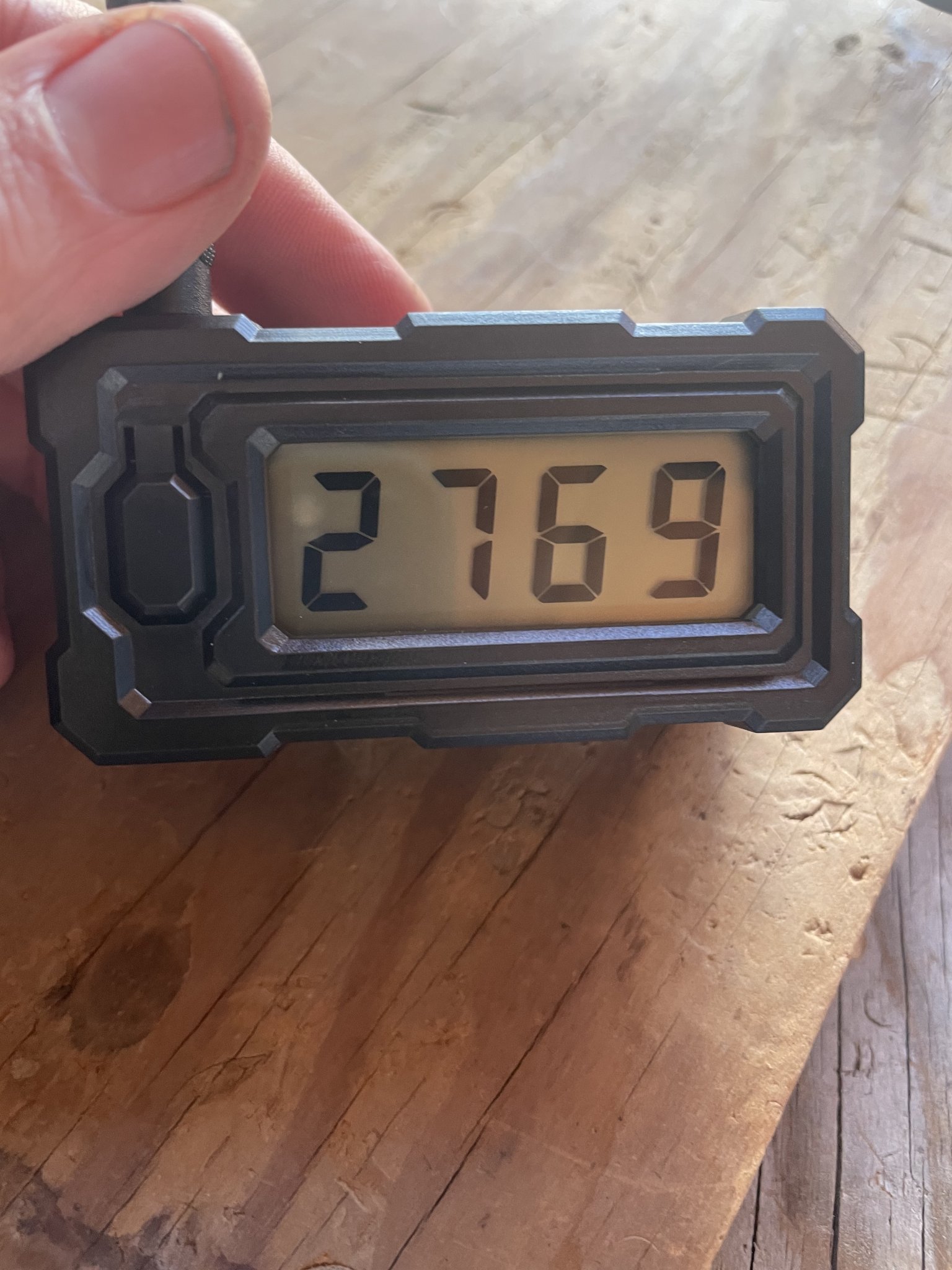

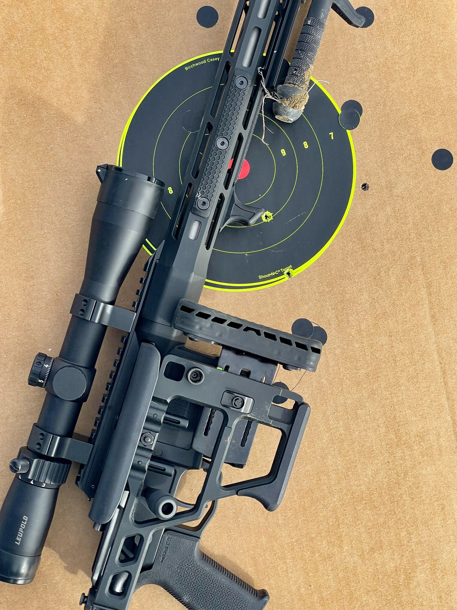

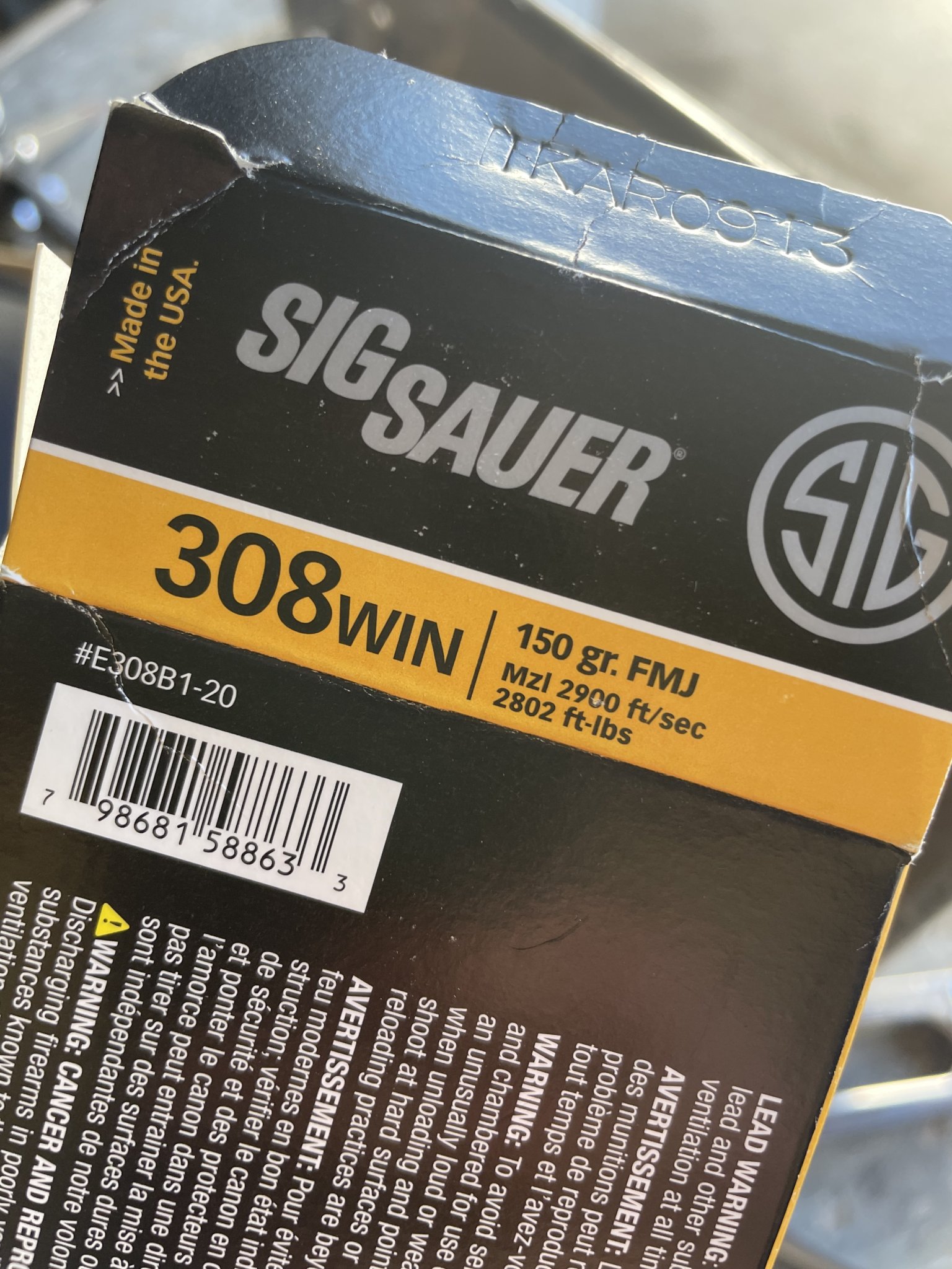

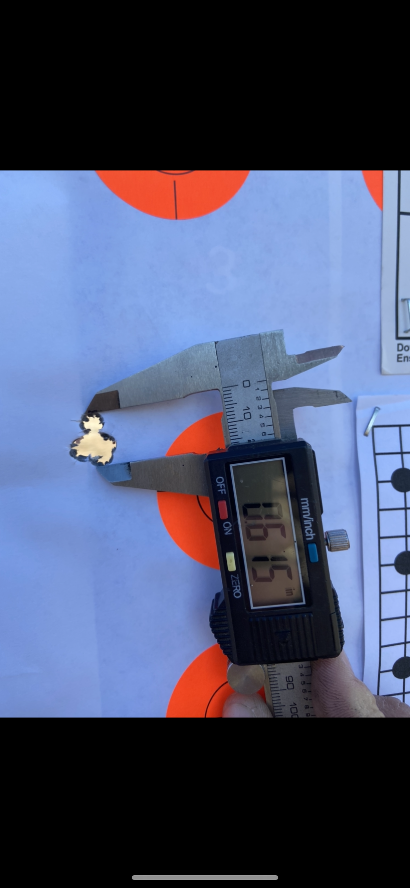

308 with 155 Sig ball during the barrel break in. First 3 shot group with the rifle. Waiting on the TBAC muzzle break then I’ll probably get a ultra 7 ordered
