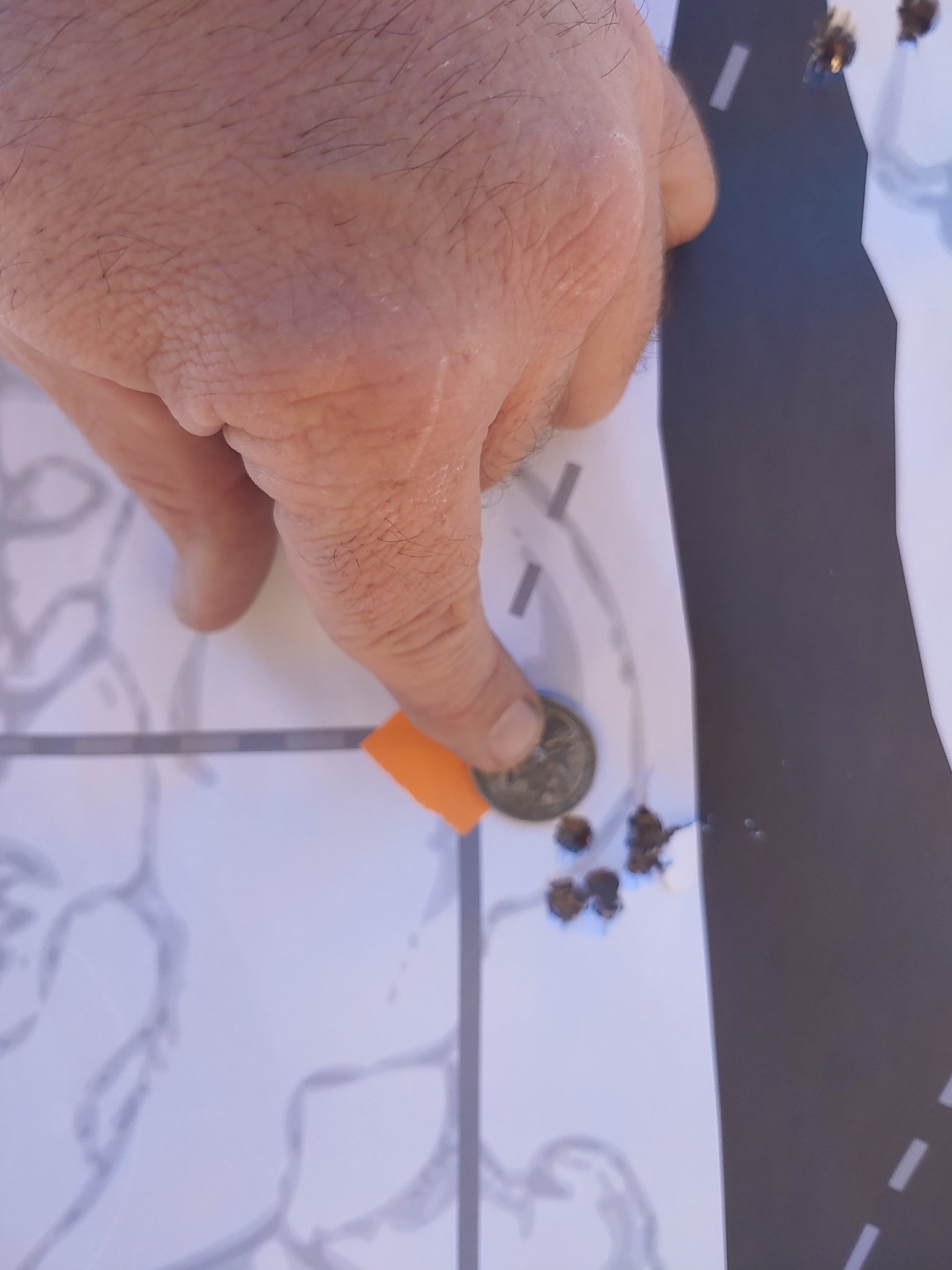

Well it's looking a hell of a lot better than it was. I tried some CFE223 and the old standard 44gr of Varget. This is with LC brass and CCI 34 primers. There a 3 groups with 3 different loads at 400yds. 2 of them are definitely under MOA. I have never seen a rifle go from shooting that bad to grouping like this like that. I'm going to switch to some CCI BR2 or 210M and stay with the varget and maybe even try some new Winchester brass or lapua and see if I can clean it up even more
Well it's looking a hell of a lot better than it was. I tried some CFE223 and the old standard 44gr of Varget. This is with LC brass and CCI 34 primers. There a 3 groups with 3 different loads at 400yds. 2 of them are definitely under MOA. I have never seen a rifle go from shooting that bad to grouping like this like that. I'm going to switch to some CCI BR2 or 210M and stay with the varget and maybe even try some new Winchester brass or lapua and see if I can clean it up even moreView attachment 7756456View attachment 7756459View attachment 7756460
When you get a chance list the bullets that your using and the load data for the last group with the coin.
I have had pretty good luck with the standard H4350 loads using Berger 140 gr hybrids. But those are hard to find right now.
Reactions: Ed123hawaii
Its a 308, but that load was 47gr of CFE223 and a 168 nosler CC. LC Brass and a CCI#34. That load was a little too warm though had a "hard click" at the top of the bolt lift. Plus it was like 40° that morning so I'm sure it would be way too hot when summer hits.

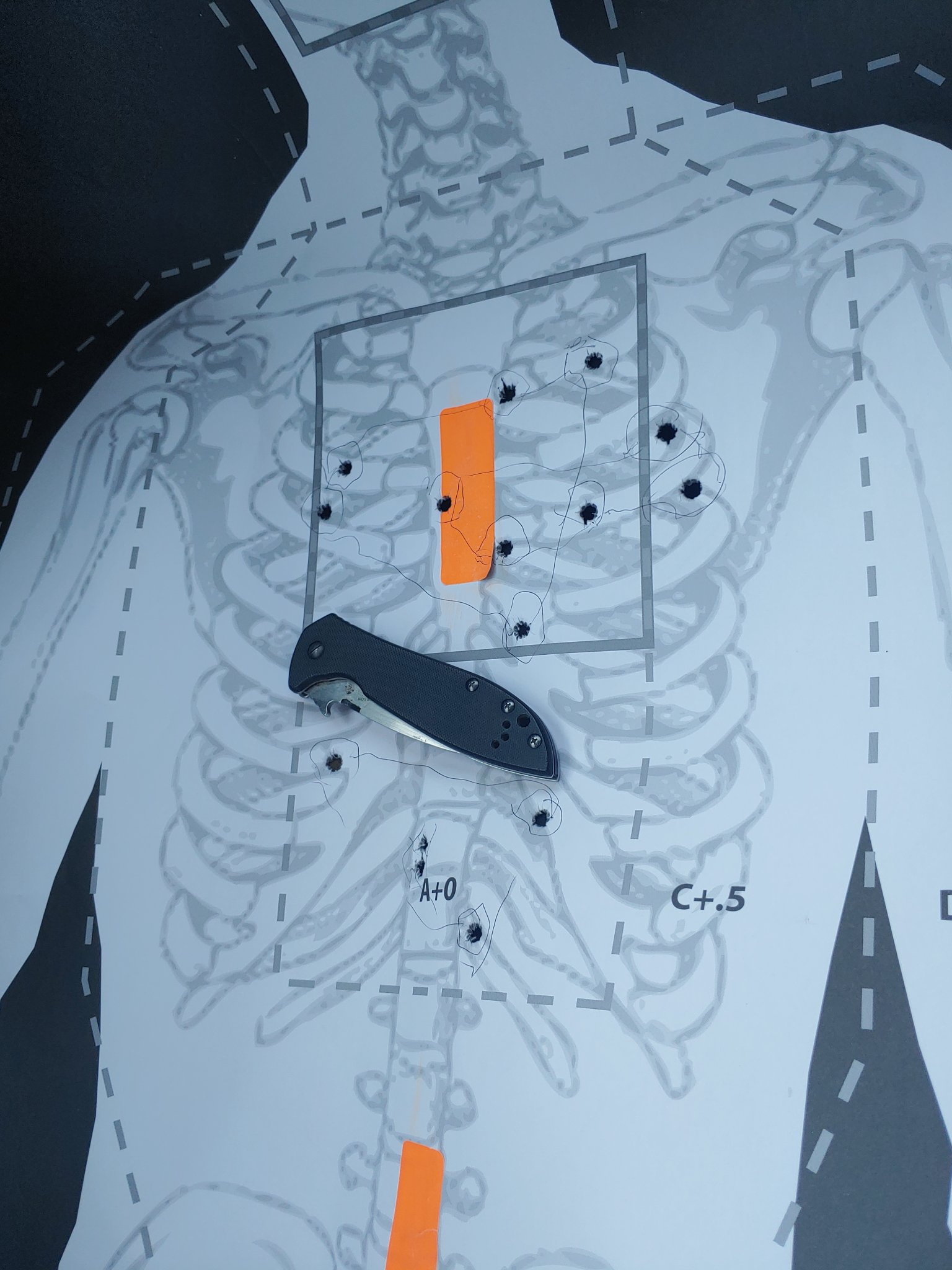

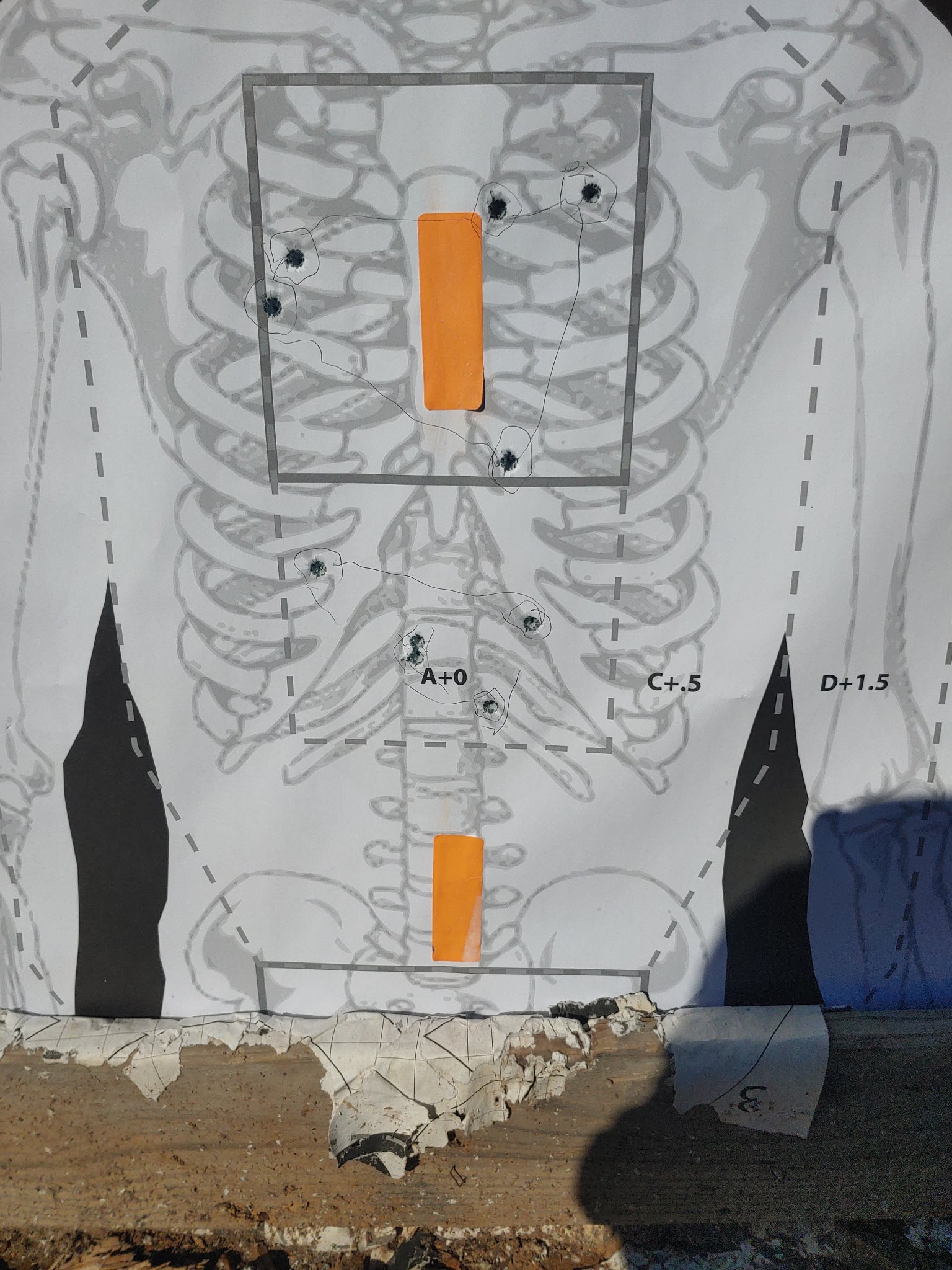

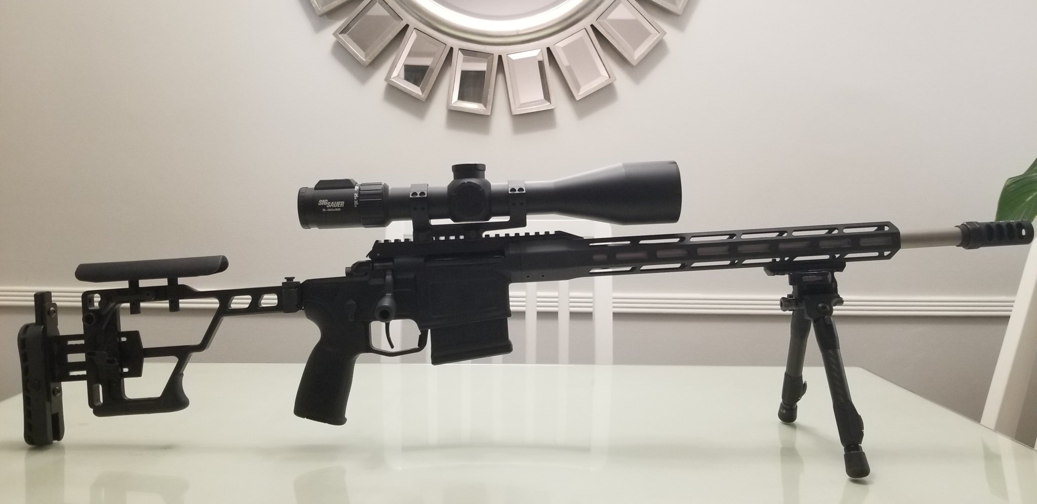

Off to a good start. More than anything it's me getting accustomed to this rig's lighter/less forgiving weight. Consistent/correct fundamentals like always are key.

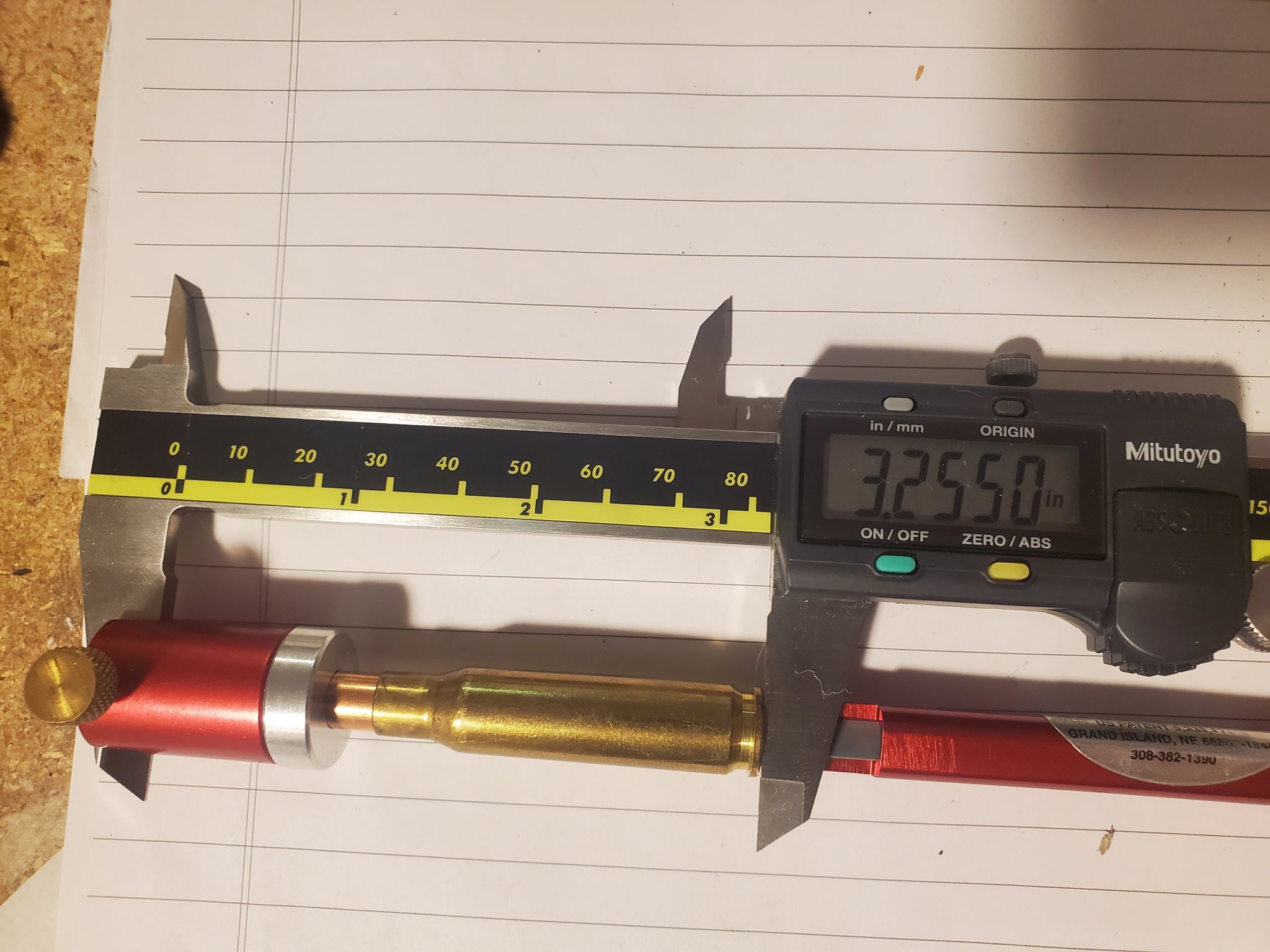

I need someone that has the 308 to measure the max length to ogive for any of these Hornady bullets:150 sst, 178 bthp, 168 eldm.
My gun shoots like shit and I measured my chamber based on length to ogive and it is really long.

I got the exact same measurement for my eldm.... 3.255 uncorrected using the ogive tool from hornady.
What cbto lengths are you loading to for your rifle, and is it accurate?

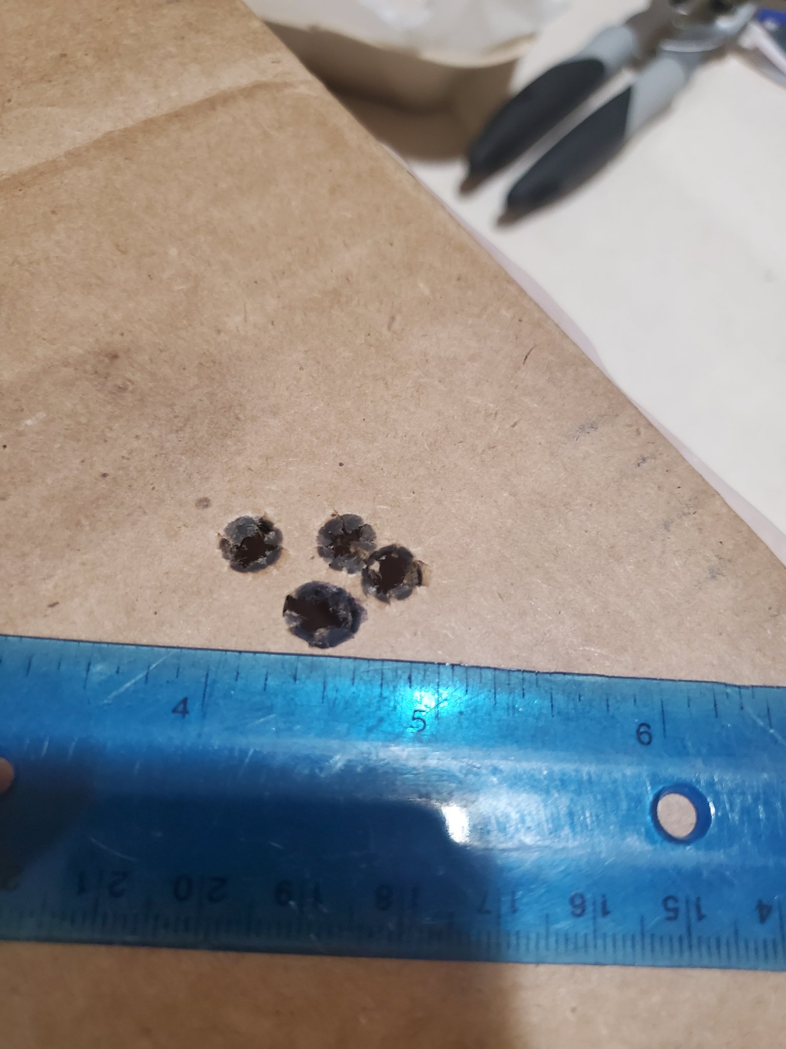

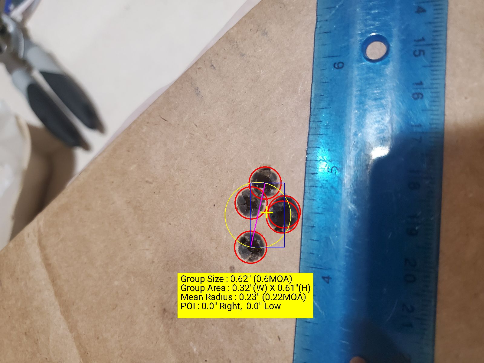

Also thought I would share some target images. This rifle is amazingly accurate for the mixed reviews it gets. Ammo used was Hornady match 120 AMAX, 147 grain ELD-M, and Norma Whitetail 140 grain at 100 yds with no wind. Optic was an EOTECH Vudu 5-25.
3 shot group with 120s, 5 shot group with the Norma, and 4 shot group with the 147s. I was breaking in the rifle in these images. My real desire was to see how the 140 grain, Norma shot as it’s my Mule deer ammo selection.

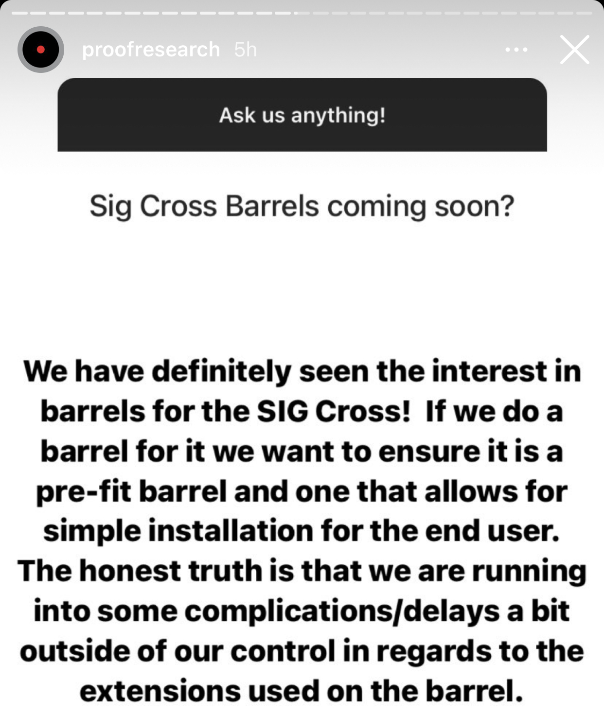

Sounds like Proof has the same issue getting extensions as other barrel makers seem to have had. I wonder if Sig wants to be the only barrel supplier and won't sell any off, or if they are onboard with the aftermarket, but due to supply constraints just don't have enough extensions to go around?
Probably hoarding them to only sell with their barrels. The only one I've heard of that's able to get them is Dave Tooley.
