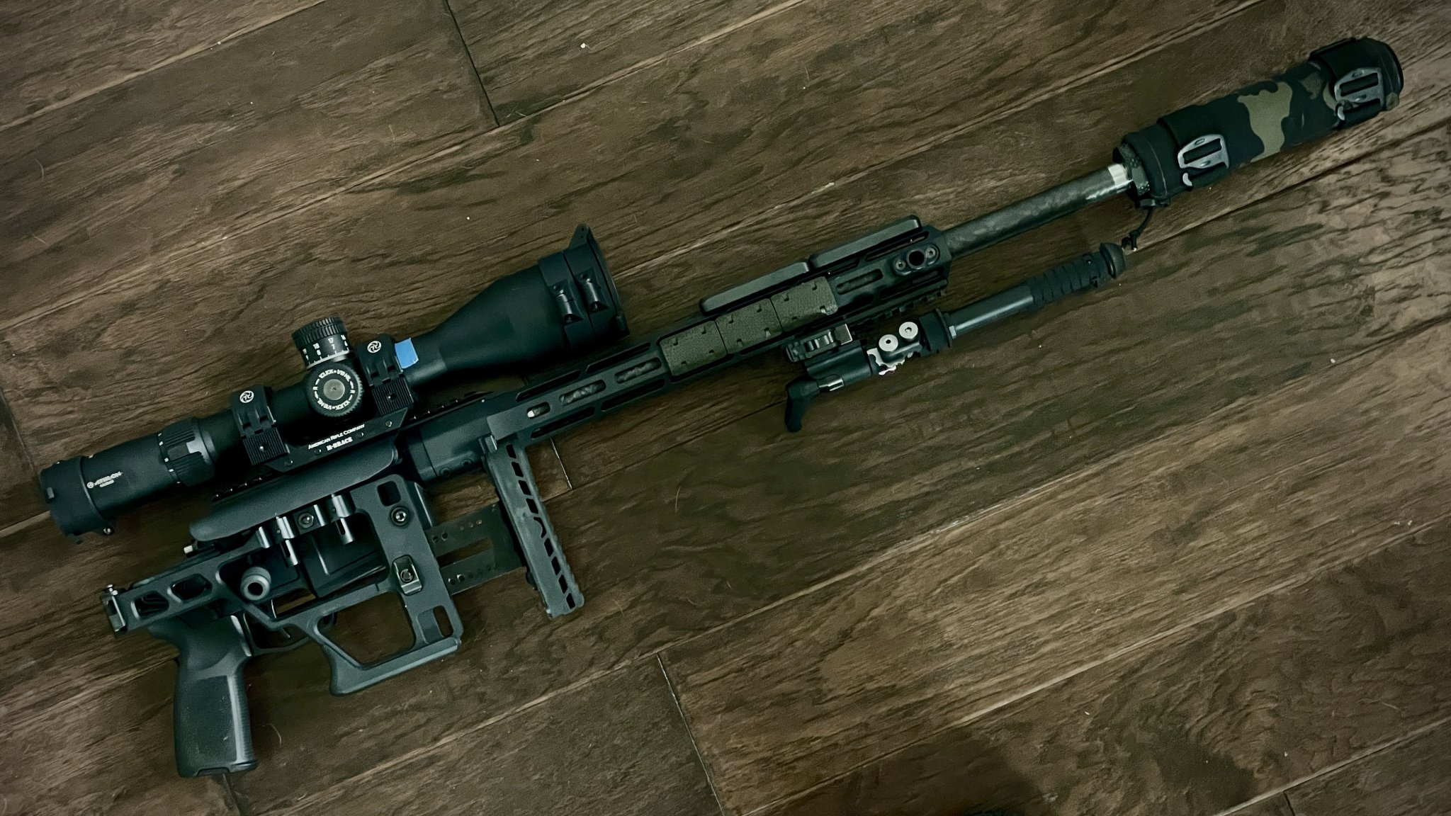

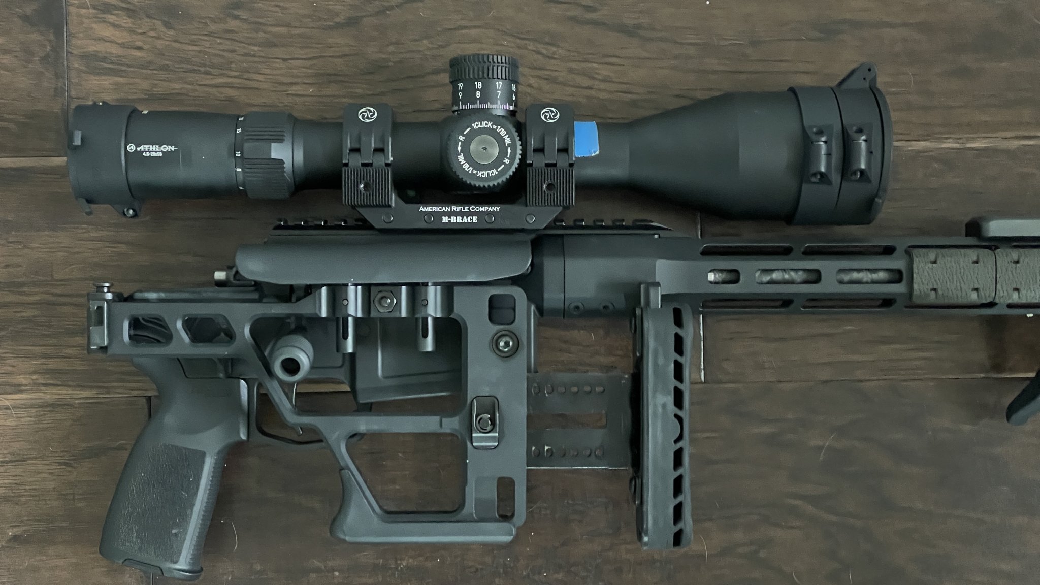

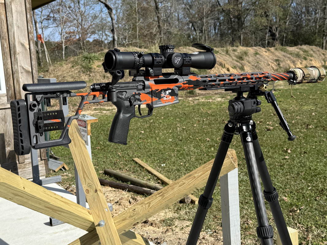

1.26" American Rifle Co. M-Brace mount.

1.25 with plenty of room to spare.

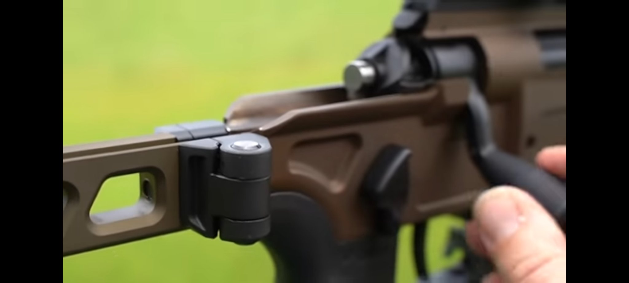

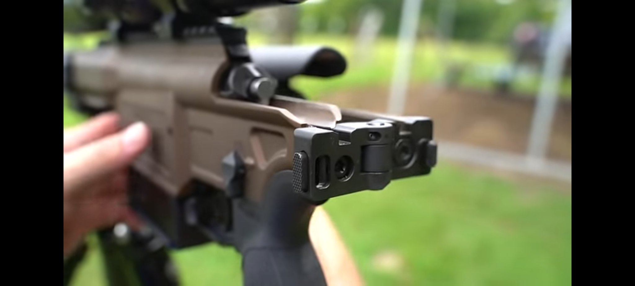

I'm waiting for the new magnum caliber Cross hinge to be released as a part. I prefer the conventional locking design over the standard. The magnum version looks like a direct swap

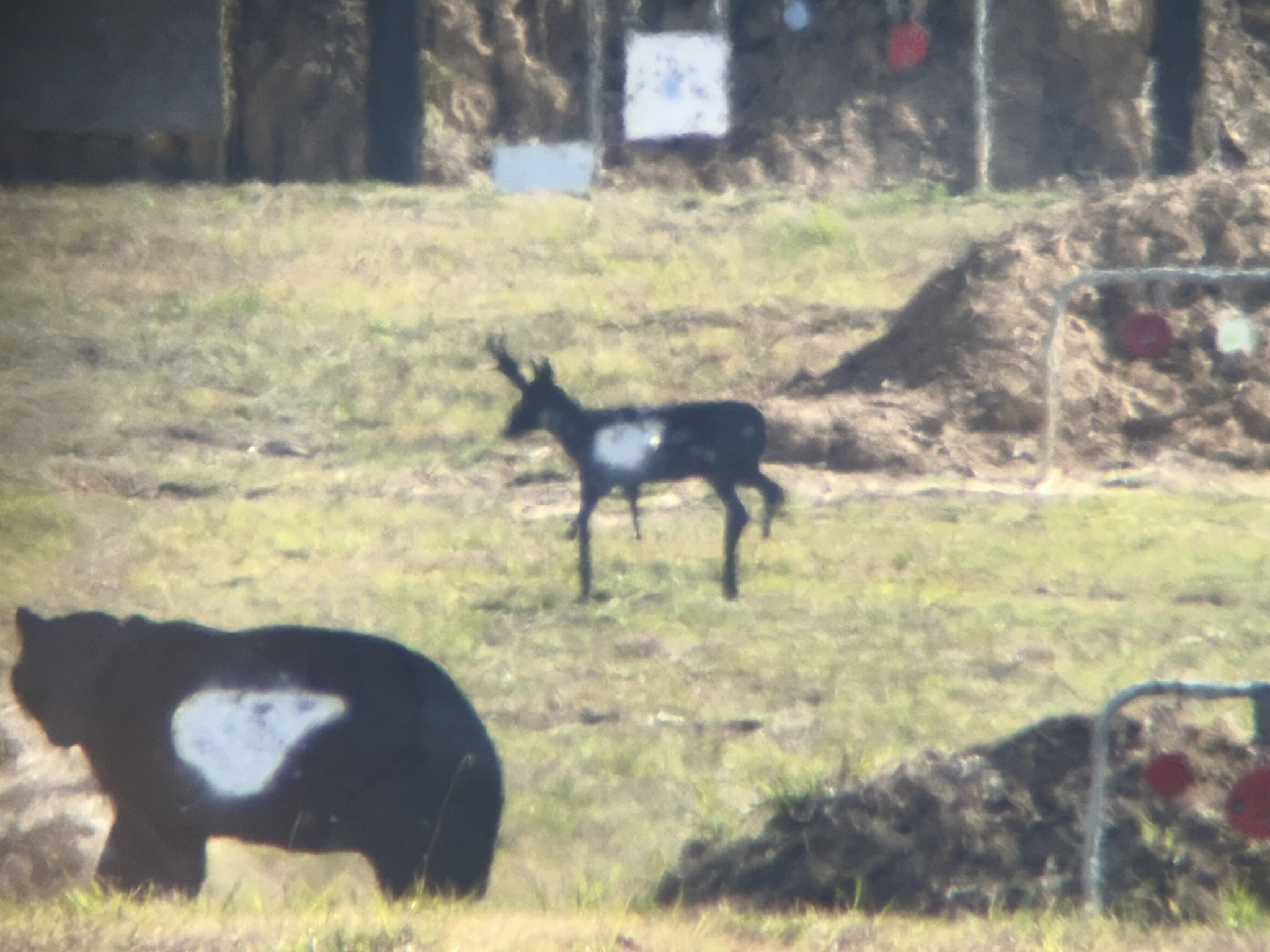

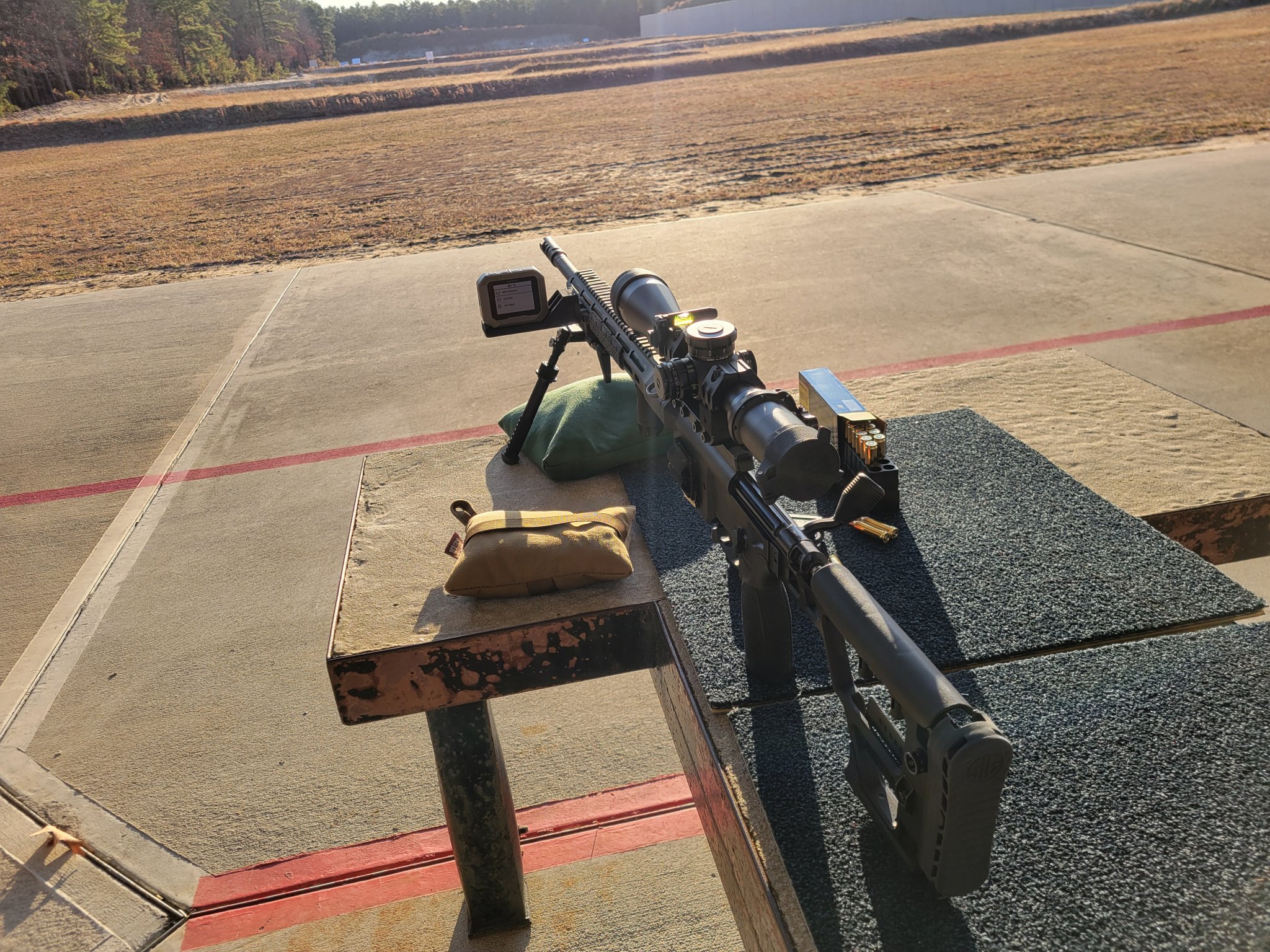

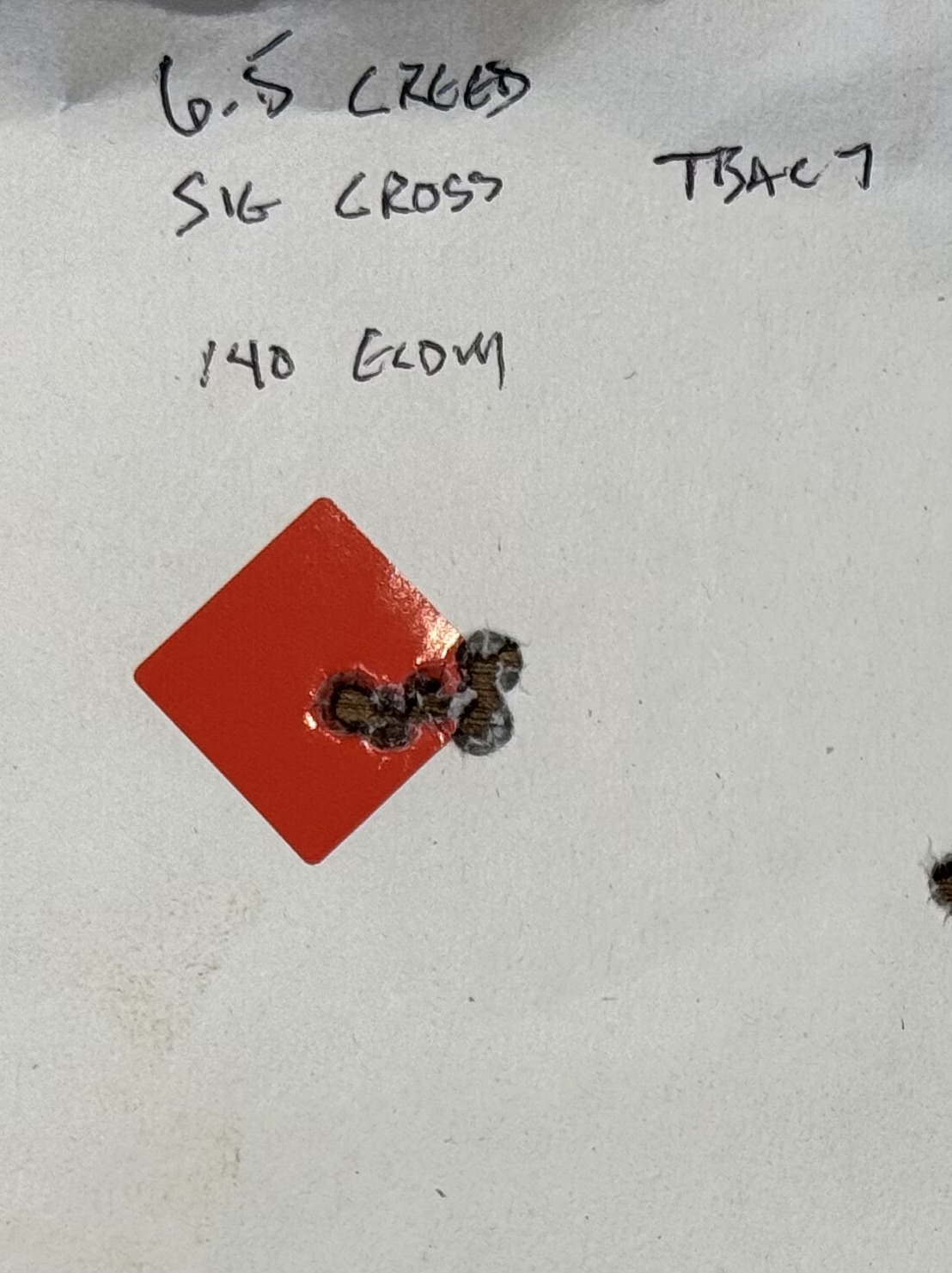

Just managed (3) 5 shot groups @ .65" - 70" with Berger 140 Hybrids just after a break in session. With a Bushnell 4.5-18 LRHSi. Not exactly a great optic for groups. Wind was all over the place as well. I'm fairly confident I can tighten that up .

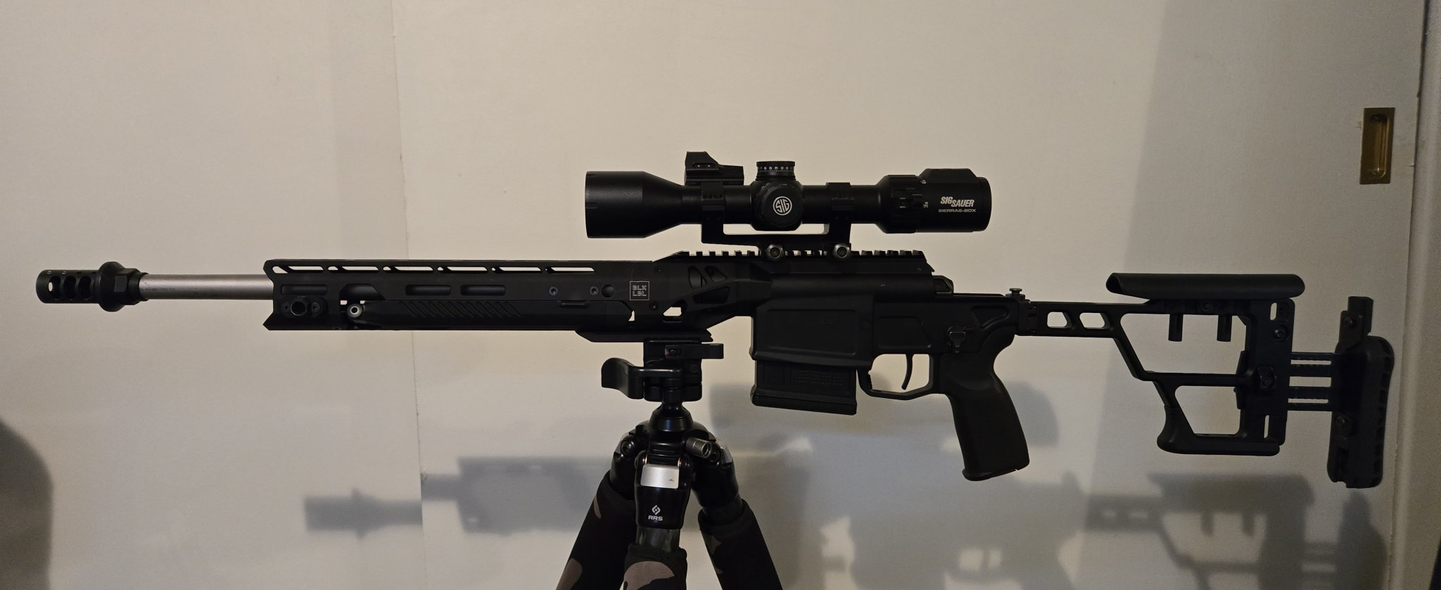

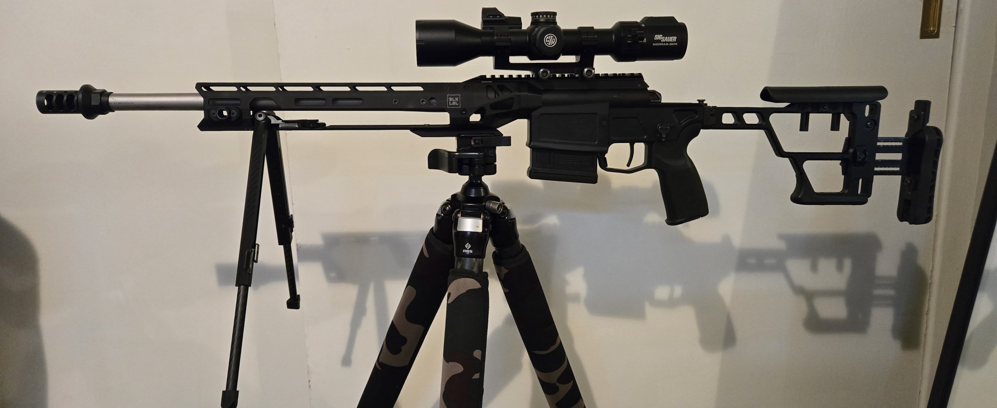

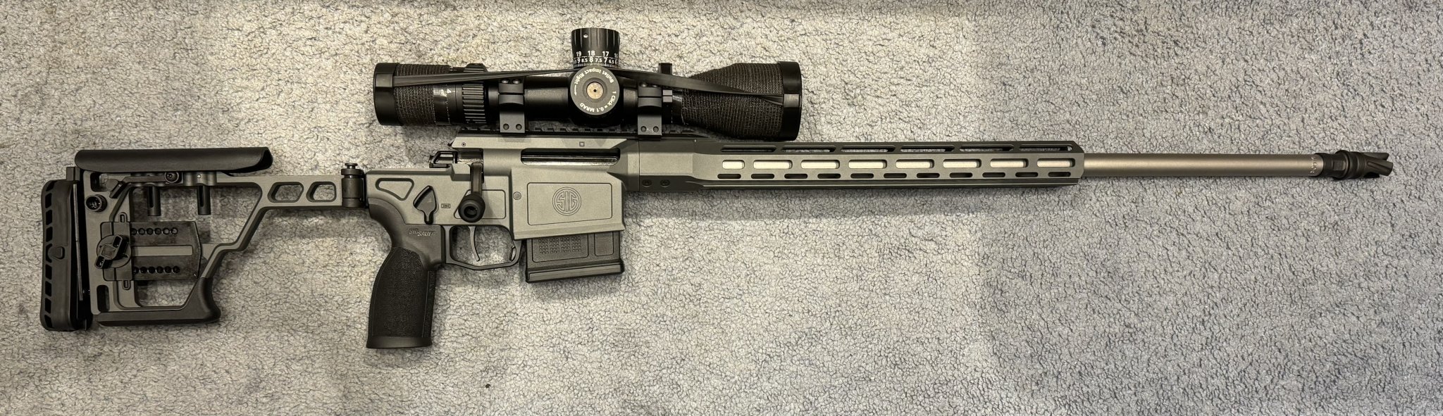

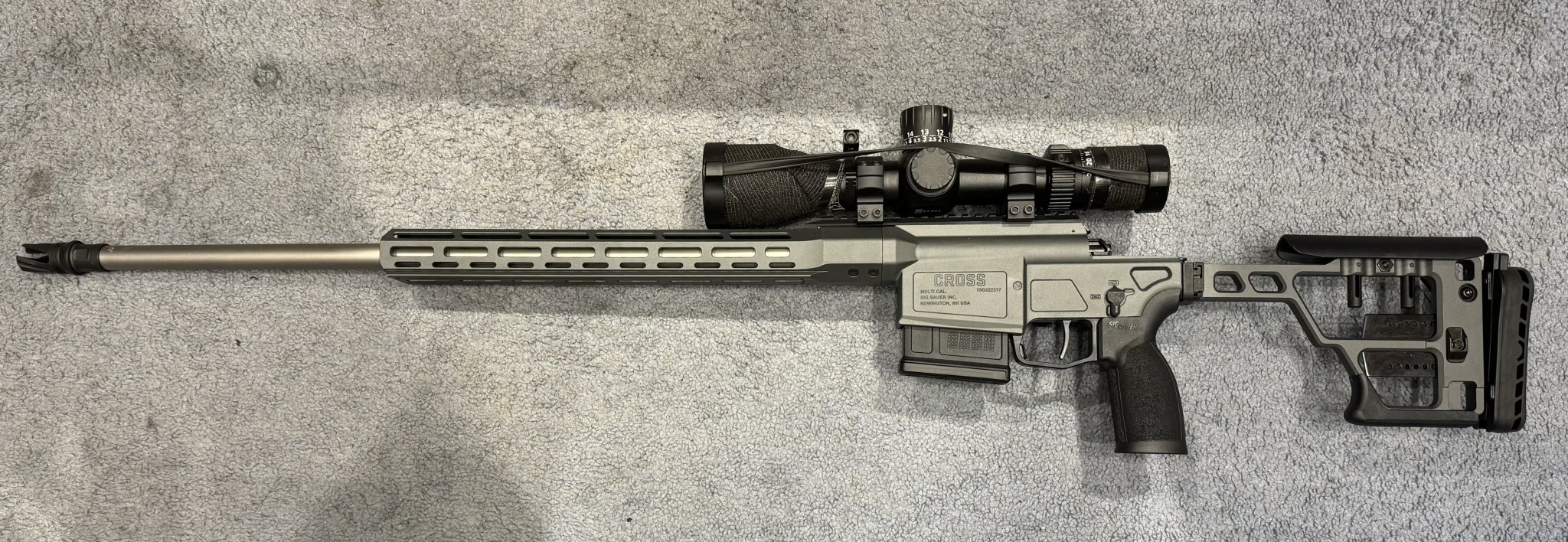

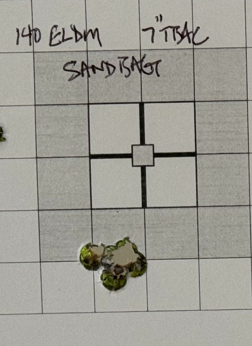

Sig HTX 6.5 Creed
Sig STX 6.5 Creed
Same load. 42.8gr H4350. Lapua SRP brass. CCI-450. Hornady 140 ELDM. Factory barrels. Zeiss scopes.

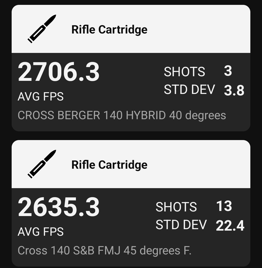

20" 6.5CM STX just after 50 round break in.

1. Looks like my STX with a 20” barrel gets 2700 fps with my 140 ELDM load and 2725 with my 130 TGK load. I looked it up, and this load ( 2700 fps x 140grs) in my STX will not make NRL power factor. Of note, the HXT with the 24” barrel does make power factor. 2800fps x 140gr.
2. Yes, barrel has a tapered shoulder. Since the rifle is sold with a tapered three prong flash hider, no muzzle shoulder ring included. The HXT does not come with the flash hider, so it does include a shoulder ring.

You'd only have to get ~2,585 fps with 147gr though right? That's pretty easily doable with Staball 6.5 or RL-16, even in my 18" Cross, unless you're stuck with factory loads or something like that.

Not that I’m an expert, im not, but the velocity x weight must be 380000 or greater. 140s need to go 2715. 147s need to go 2585. You can decide what works best for you. Plus a pad for temperature, variations like es/sd, and the phase of the moon.

If you shoot factory division, power factor not applicable.
Are you planning to shoot Factory Division?
Yes! Thankyou - you guys are correct. 18" version it is then! Carry on.
c. There is no minimum Power Factor (PF) for the Factory division, however the Factory Division hunter’s PF will be used in the case of a tiebreaker. Factory rifles chambered in 6mm/.243 or greater, with a cartridge overall length of 2.700″ or greater (per SAAMI-ANSI Max cartridge length standards), with a maximum muzzle velocity of 3275, will be allowed only in the Factory Division.
